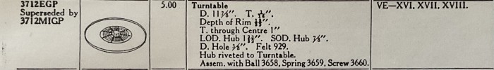

Re: Electrola Turntable Dilemma
Lime,
According to the listing “Victor Repair Parts by Tyoe and Serial Number” your VE-XVI should use a turntable with the spring and steel ball, not the type for the cross pin. In fact all serial number VE-XVI’s I use the same turntable, at least through SN 16042
Part number is 3712EGP superseded by 3712MIGP which is the same other than the brown felt.
Here is the parts listing and description.
Mark (real name)

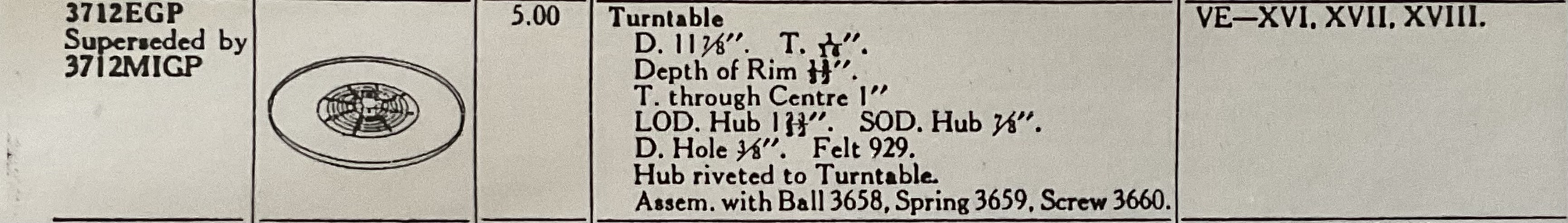

Mark (real name)
Thank you for the information.MarkELynch wrote: Mon Mar 10, 2025 11:07 am Lime,
Mark (real name)
In that case, I'll keep looking for a replacement ball and spring turntable.
