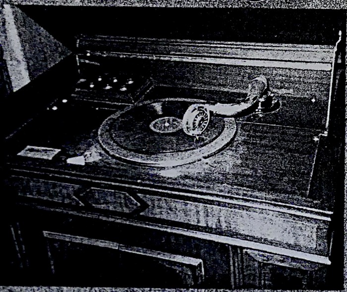

It appears to be from one of the Pathephonic machines. Here's a (poor) photo from the Copeland/Dethlefson book. Hard to tell for sure, but I *think* the stylus bar is angled there.

Thanks for your reply but to be honest your scan appears to show a more typical Paillard soundbox of the period (common to Decca machines amongst many manufacturers) with 90 degree lateral cut steel needle type arrangement. I'm not sure it is the same soundbox?

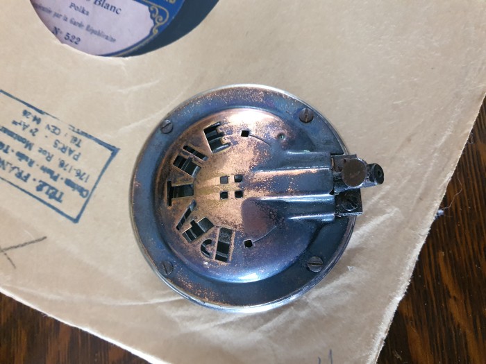

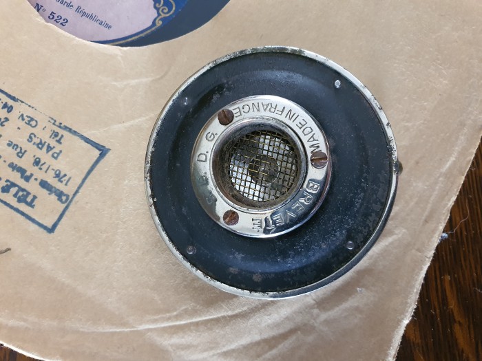

Steve, the one I have is similar, but not identical, see photos below. The fascia on mine is uniformly domed, while the one on eBay has a bulge in the center. Otherwise, they look the same. The one on the ad is most likely genuine, being just another Pathé variant, gold-coloured while mine has a copper finish.

CarlosV wrote: Mon Mar 24, 2025 8:07 am Steve, the one I have is similar, but not identical, see photos below. The fascia on mine is uniformly domed, while the one on eBay has a bulge in the center. Otherwise, they look the same. The one on the ad is most likely genuine, being just another Pathé variant, gold-coloured while mine has a copper finish.
Okay, thank you, Carlos. So as it appears in the Ebay listing as well as your example, these do not have any pot metal parts and they do have a 45 degree stylus bar for hillandale only? I was hitherto unaware that Pathé made late era aluminium diaphragm soundboxes for hillandale records. Every day is a school day!

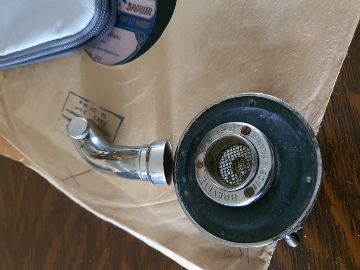

Here is the elbow that belongs to the soundbox. The photo is misleading, both ends - elbow and soundbox - have the same diameter, and are connected via a short rubber tube, that perished on mine, and I did not find a suitable replacement yet. As Iñigo says, it rotates to allow both types of records.
Thank you Inigo and Carlos. So, apart from being stupendously overpriced, the Ebay example is missing the elbow piece? Or should that be part of the tonearm? The seller doesn't ship to UK anyway so this is purely academic interest now for me and future reference.

Steve wrote: Tue Mar 25, 2025 5:11 am Thank you Inigo and Carlos. So, apart from being stupendously overpriced, the Ebay example is missing the elbow piece? Or should that be part of the tonearm? The seller doesn't ship to UK anyway so this is purely academic interest now for me and future reference.
Steve, the elbow should be part of the soundbox, as the rubber connector is glued (or pressed) at both ends. Mine was hardened and cracked, and had to scrape both sides to remove the rubber.
