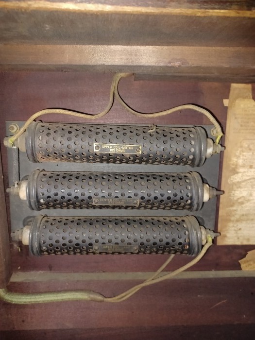

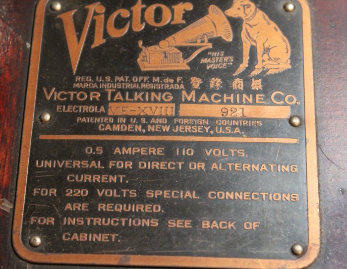

JerryVan-Thanks for your post and advice. So, regarding the wiring label...it is aged to the point where it is not readily legible. I took a photo of the label, enlarged and enhanced it...managed to read it well enough to feel it is properly wired. Also, considering it was sold new at a shop here in Louisville, which is where we acquired it last week, I assume it was and still is wired for 110volts (barring, of course, a shoddy repair attempt). Here is a photo of the resistor pack and the current wiring configuration:
Thanks also for your suggestion regarding the variac. Our goal here is to use the player so I am thinking I would like a modern voltage supply system for daily driving (I assume that resistor pack might get a little hot). Out of respect for the machine, I would also like to restore the original electrical system as well.
