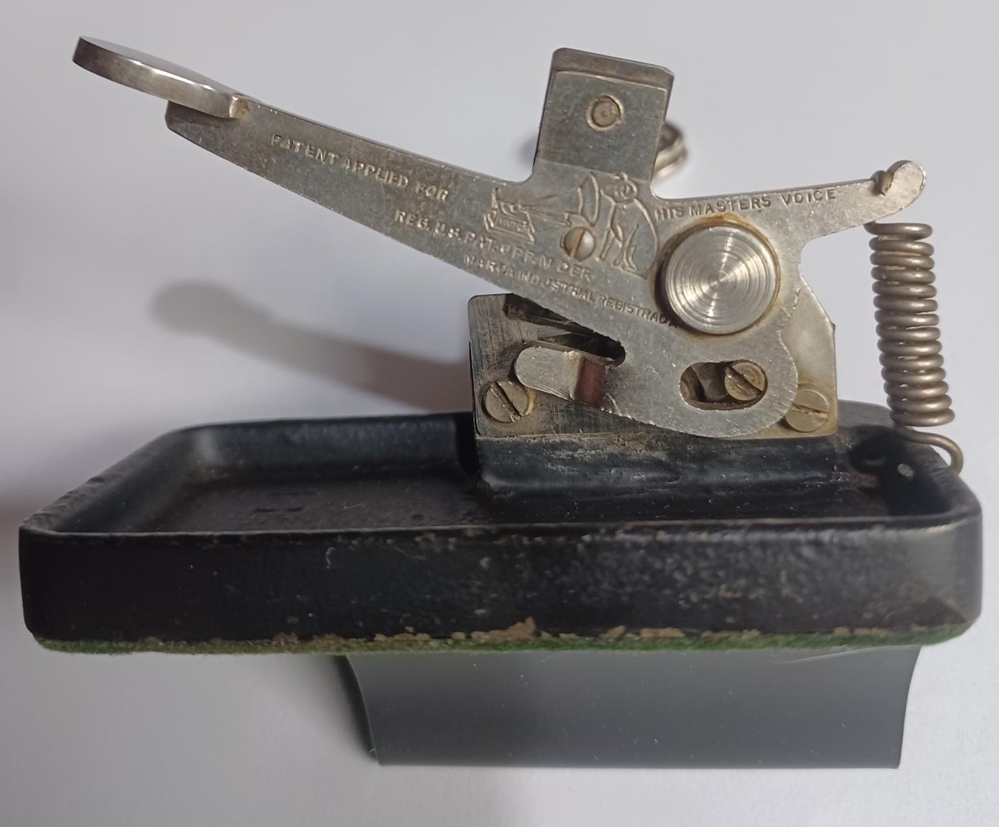

Good morning! I recently acquired my first victrola. A very nice VE-XVIII in excellent original condition. Included in the sale was an HMV fiber needle cutter. I am interested in experimenting with bamboo needles. Would anyone happen to know of a good source of bamboo needles? Thanks in advance for your comments and input.
