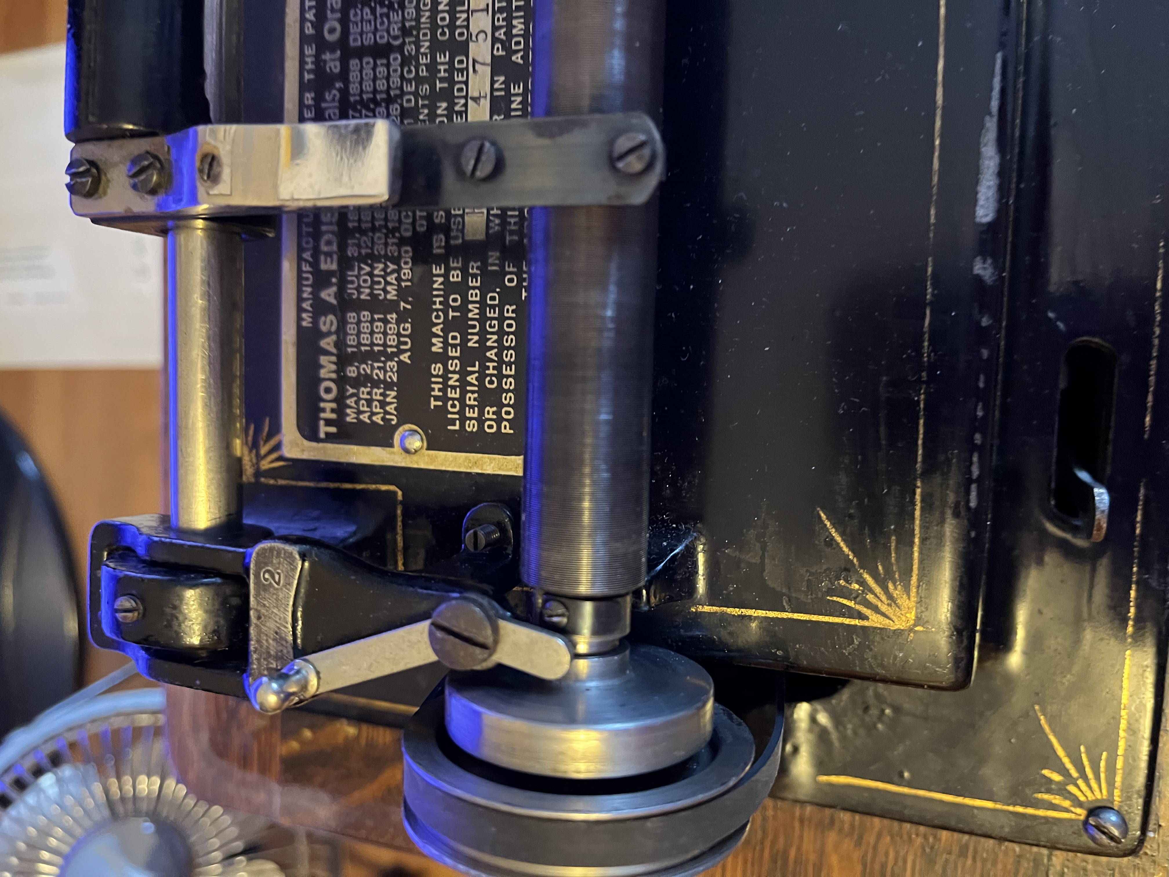

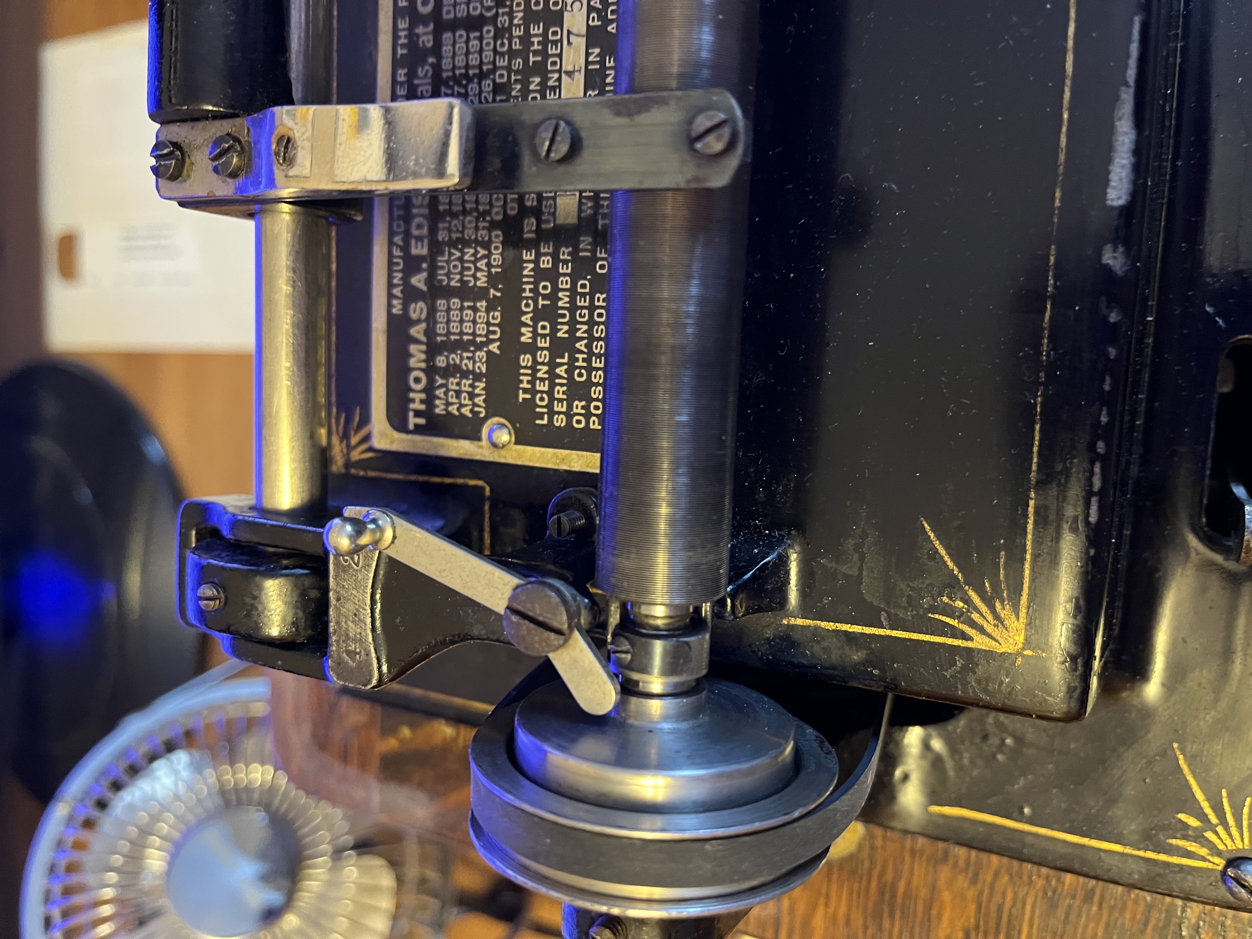

Thank you, that helped align things and the top piece now fits perfectly into the bottom piece. After doing this and making a few more adjustments, the machine played half way through a cylinder, the furthest it has ever managed. It still bogs down after about 15 seconds, with or without a cylinder loaded, for reasons I still can't determine. I also think I may have some kind of gearing problem with the 2 to minute 4 minute adjuster mechanism. When set to 4 minute, the mandrill has a pretty hard time rotating. Here are photos of the mechanism in each position (sorry, I could not get these pictures to align properly despite rotating them a few times before uploading):
I did also realize that the cylinder I've used for testing has some material missing from the inside. I don't know if that would make a difference, but I'm guessing a non-damaged cylinder (I have a few) would be far better to use.

Have you oiled anything? The leadscrew needs a light coating of oil. Also needs a bit of oil at each end of the leadscrew, especially when geared for 4 minute records, since the mandrel shaft is spinning within the leadscrew at double the speed of the leadscrew itself. Any drag between the two will bog things down. Also, a thin coat of oil on the rod that the carriage slides on

Posts: 6381
Re: Edison home question...
How far are you winding it up? Many times, people who are new to wind-up phonographs do not wind them up enough to complete a record.
