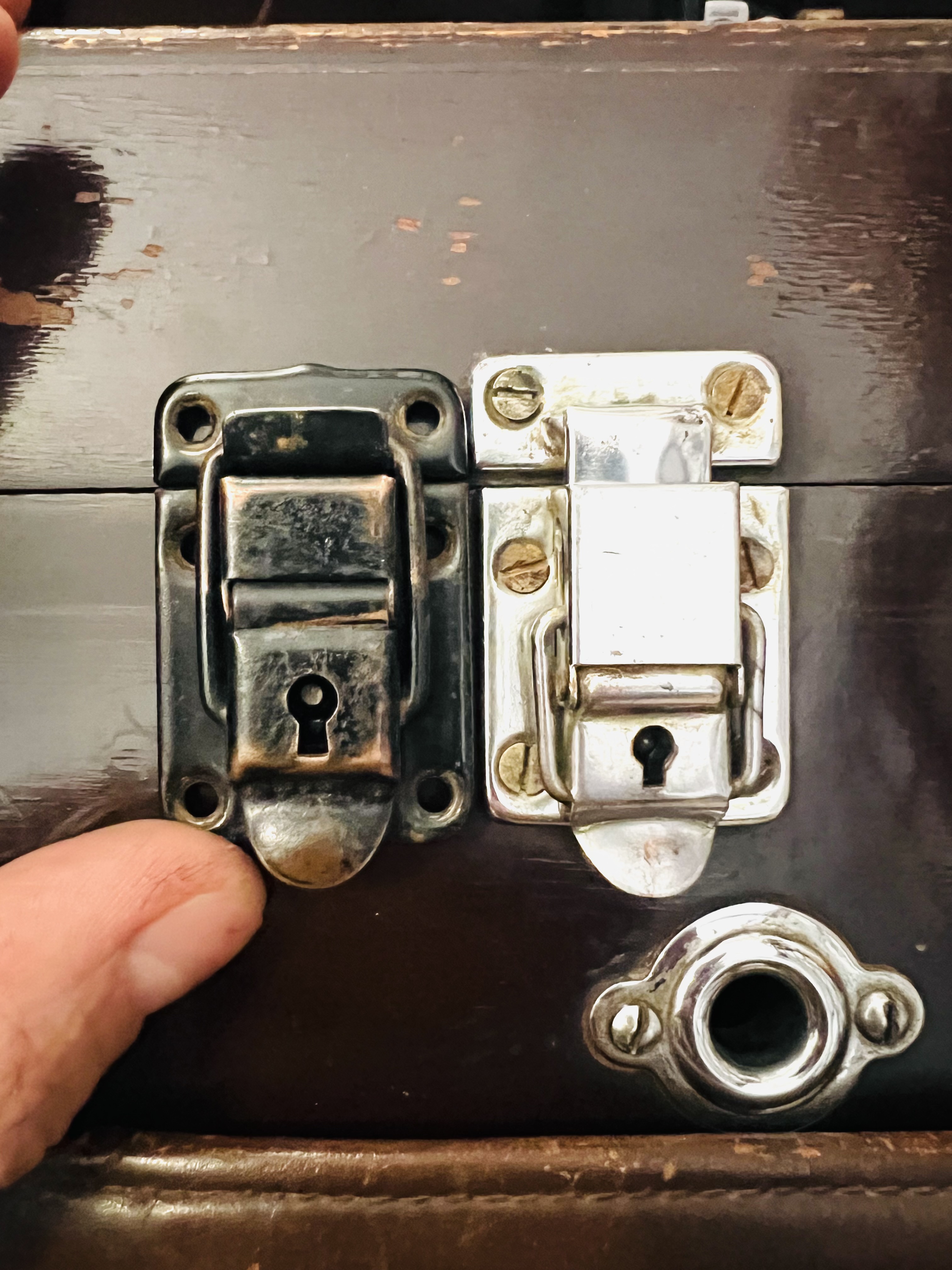

Motor was not a problem, had most of the mechanical parts in my stash. The most difficult part is the 118-only tonearm clip. Gonna make it next and have chrome plated with rest of the shiny parts. The fact that I also got a pristine 118 makes it possible for me to replicate the needed parts. Modified speed control parts from a HMV 109 to match the 118 specs. Eduardo kindly made copies of my original 118 transfers. The Calcutta dealer decal is particularly a nice one. Usually they are in very poor condition and missing big chunks. For some reason some of the photos upload sideways, can’t figure out why. Sorry about that.

My two 118’s have some small interesting differences. I call them early and late models here, even they are made only a few years apart. Early model is probably made 1935 or before as it hasn’t got the new 1936 onwards tags and year code, later one is from 1938. Late motorboard has got extra holes for regulator and autostop lever. Autostop lever from a 109 works perfectly on the early one and matches olds screw holes. Early model has a chrome motorboard lift knob (this one is from a 109 and need chrome plating), late one is florentine bronze. Lock latches are different. Luckily had a black one (yes, gonna be chromed) that is identical to the long lost original and fits the screw holes and indentions of the original case.
Late madel also hasn’t got locating pins for the lid. Mahogany tinted nitrocellulose lacquer on the late model has lost most of its transparency on the outside. Motorboard shows the original luster. Early motorboard is has been coated with a black tint. Inside the cases early one is also blacked, late one is the same as top coats.
