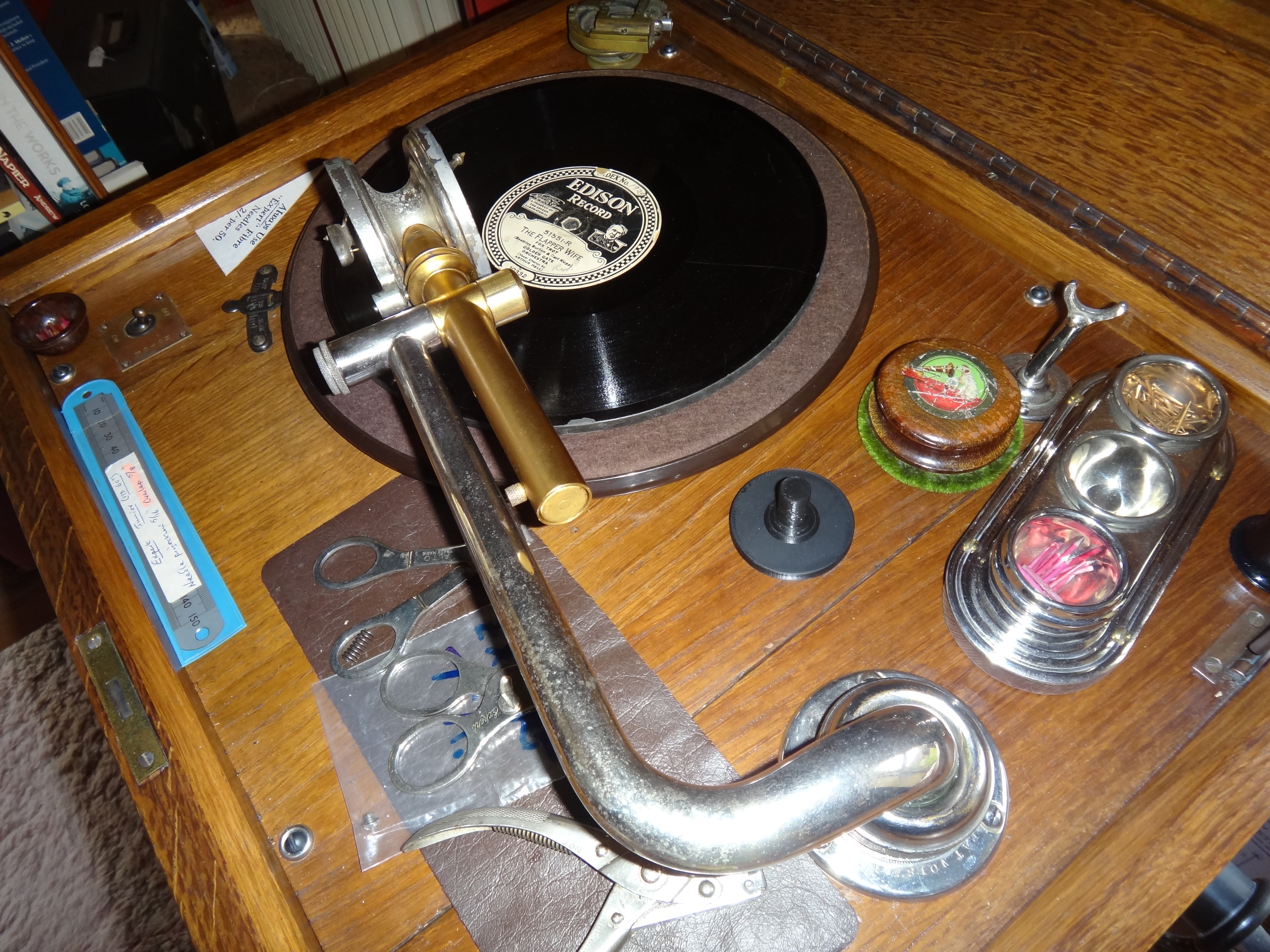

Some years ago I made a few adaptors to enable an EMG to play a multi-purpose twin-head Brunswick Ultona soundbox and thus Hill and Dale records. This Brunswick creation is an item of great genius in my opinion, even incorporating a counterweight. All types of shellac records can be played---lateral-cut and Edison/Pathé vertical-cut by simply twisting the soundbox to the appropriate position. Here is one in action playing an Edison Diamond Disc:

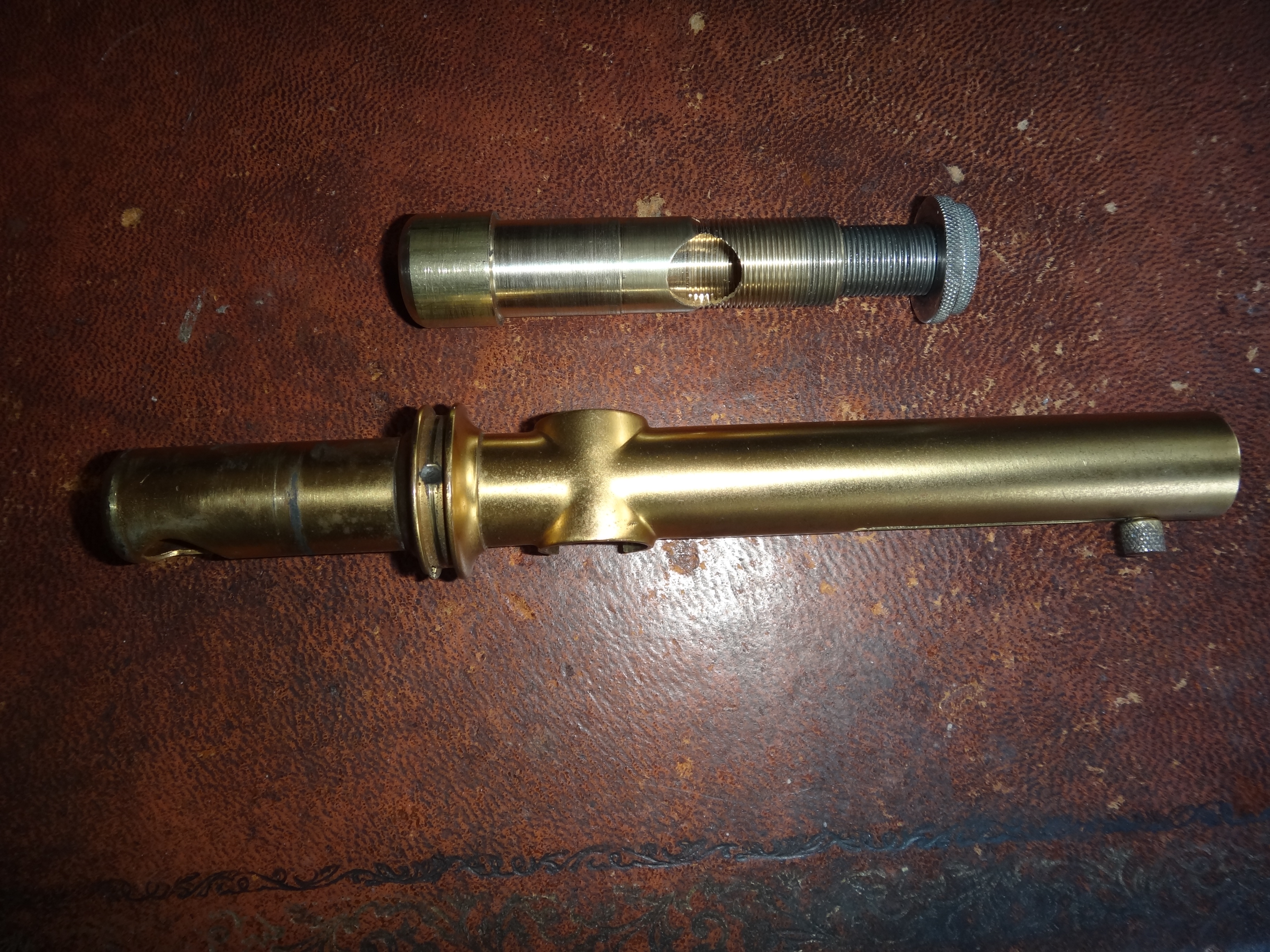

I was asked recently by a friend if I could do the same for the Expert system. This is not so easy as the tonearm for the Experts Senior/Junior/Minor (All Range is half an inch longer) which are all identical was designed differently in “goose neck” form compared to the EMG’s "swan’s-neck”. By definition, this means that to achieve a similar facility it is necessary for the sound to traverse, not one, but two right-angles. I was unsure how well this might work but keen to find out.
On an Expert, the goose-neck is threaded (⅝” X 26 TPI) into the tonearm which has a mounting section at right angles to the main part of the tonearm. One of the reasons this was done was to allow the incorporation of a Quincke tube (see discussed elsewhere). However, in the EMG system, the swinging swan’s neck is tubular without thread and simply pushes straight in without a right-angled section. The Expert adaptor also has to be internally threaded (½” X 26 TPI) to accommodate the Quincke tube. Here is the result on an Expert Junior compared to an EMG Xa :

I am pleased with the result and wonder what others might think ? I have always found it amazing (but counterintuitive) that sound seems to negotiate right-angled bends without too much degradation and this is an interesting demonstration of that fact I think. Percy Wilson pointed to his findings that the quality of sound was relatively unaffected at small diameters of tonearm.
Brunswick Ultona soundbox playing Edison Diamond Disc on an Expert Junior.
EMG and Expert tonearms plus adaptors compared.
Brunswick Ultona arm plus adaptor showing hole to Expert tonearm
Brunswick Ultona arm plus adaptor showing hole to Ultona soundbox.
EMG and Expert (left) adaptors showing Expert hole to Ultona soundbox.
EMG and Expert (left) adaptors showing Expert hole to Junior  tonearm.
Complete Brunswick Ultona adaption in parked position on Expert Junior. It was necessary to shorten the counterbalance weight grub screw to clear the Junior tonearm.

Great work, Graham! The Edison records sound very good both on the Expert and on the EMG. The Brunswick Ultona is indeed very ingeniously designed.

Fantastic Graham - and having heard the results in person, I can attest they are stunningly good through a large EMG. I agree, what a brilliant piece of ingenuity, to have all three different playing modes specifically provided for. As are the adapters - chapeau!
I'm reminded to try and find my Ultona head which is currently lost in storage. It's one of what seems to be a minority which have a different diameter where the adapter would fit.
