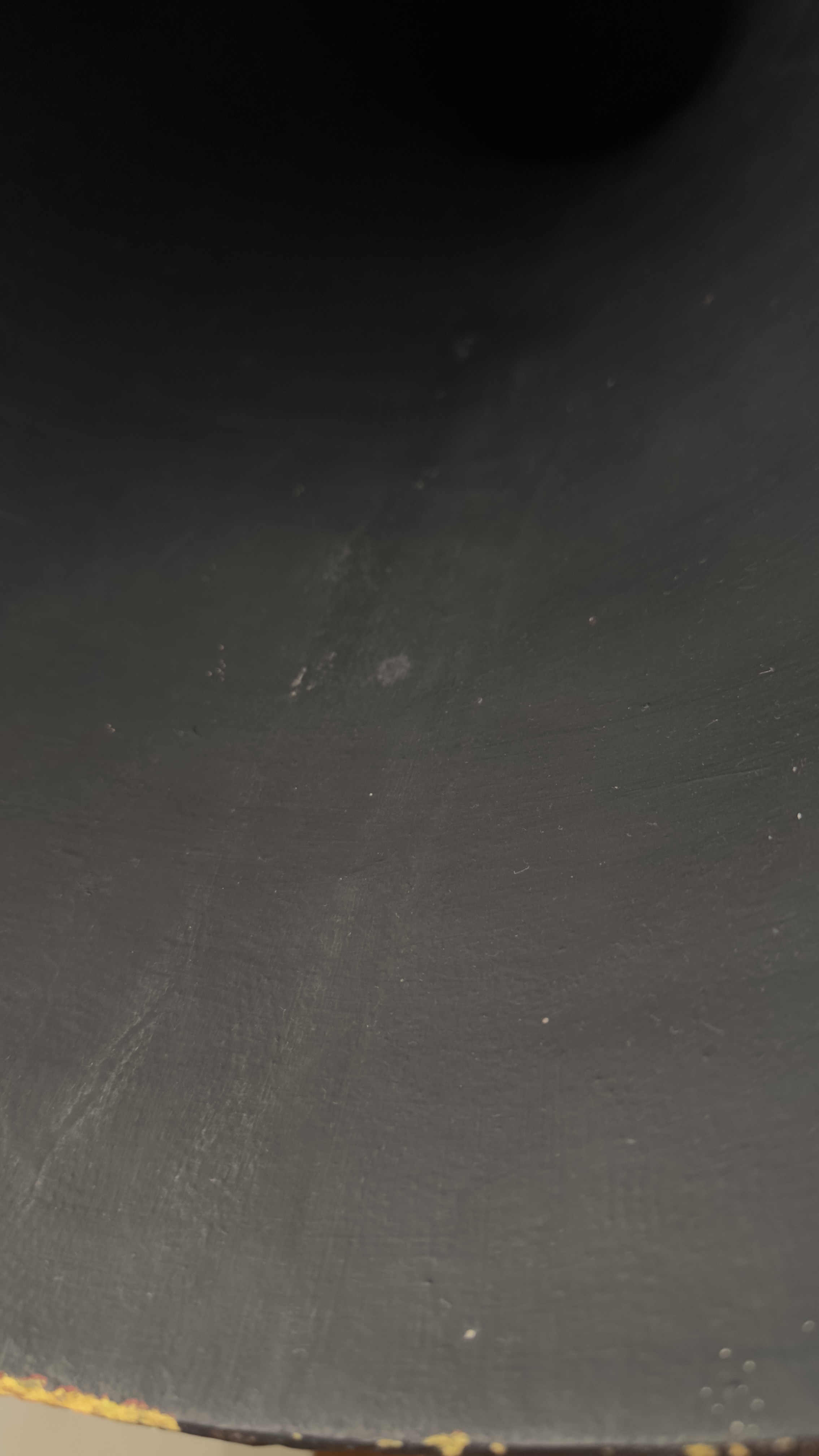

3 - The horn is in very good condition but has been at some point painted over (outside surfaces in brown, inside surfaces in black). I can definitely see in some areas where the pain fell off the original "Python" finishing paper cover. Do you think it worth the risk to try remove the paint?

The most important part of a Mk IX has always been the horn and its condition. Yours seems particularly upright---well done. Regarding the paint, I would be inclined to leave the finish as it is so long as the sound satisfies you. You may get into trouble if you try to remove it ? The internal finish should never be reflective or you will lose the magic.

Regarding the horn, please consider the attached pictures. I agree with you on not removing the paint - my major concern is the risk of damaging the horn yes but also lack of uniformity of the underneath python paper cover although the exposed area looks in marvellous condition. Additionally what you mean exactly with "reflectiveness" regarding the paint? (like glossy paint, multiple paint layers)?

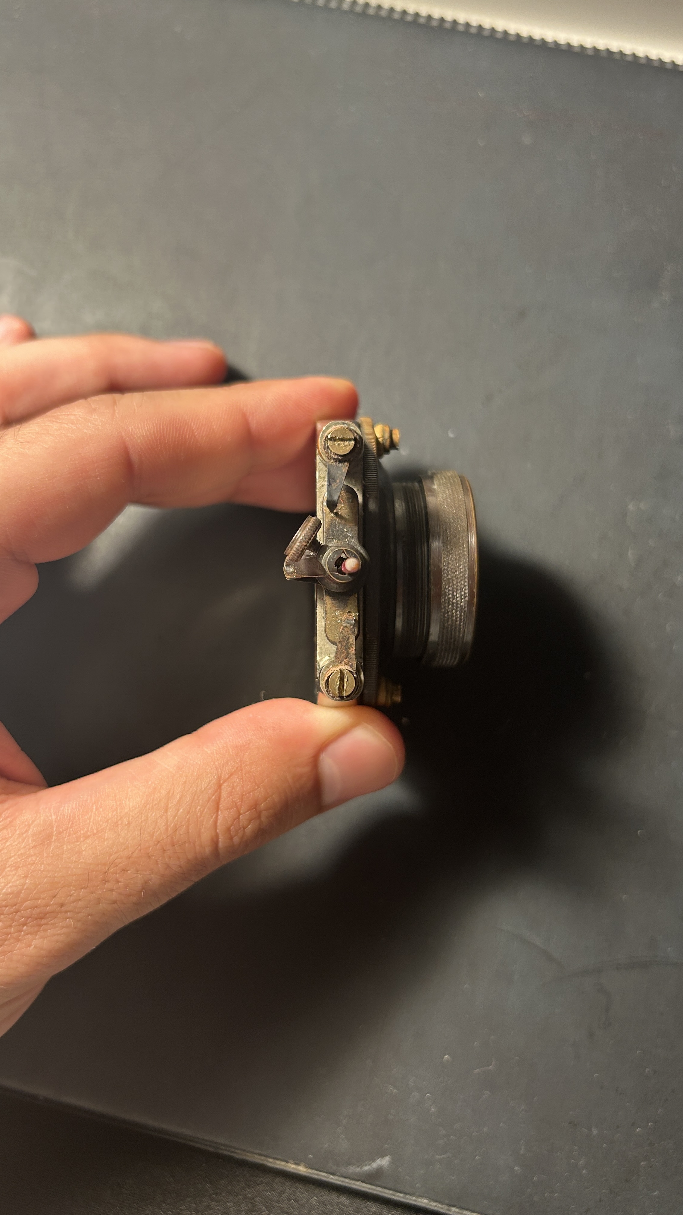

I am also debating whether to rebuild the soundbox or not as performs quite well despite the original hardened gaskets - as mentioned there is distinct lack of bass response (especially at low volume). I might upload soon a quick video on Youtube testing the unrestored sounded.

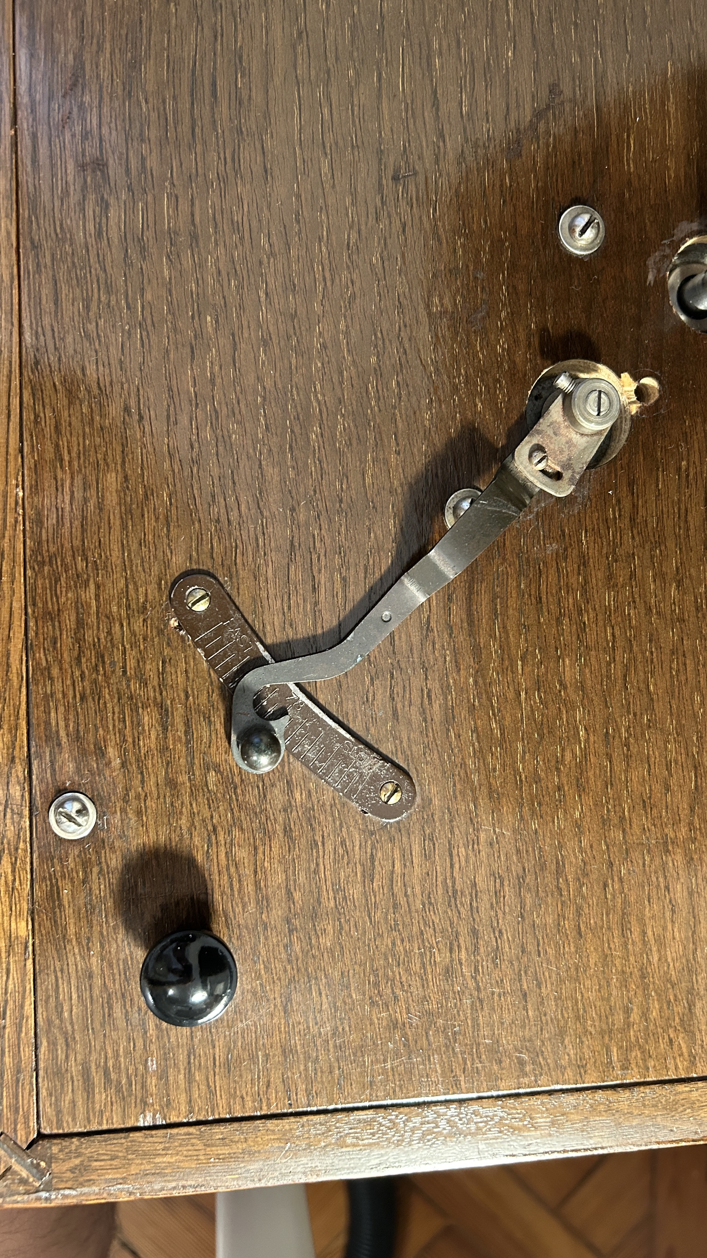

I have another question, that is about the serial numbering impressed at the base of the tone arm. Why do these do not match with the machine's one? The original tonearm has serial 787.

I would recommend to replace the gaskets, it is an easy operation particularly with the EMG soundbox, and it will not only improve the reproduction but also reduce the wear on the records. The other perishable items in these soundboxes are the leather rings: I never replaced mine, they feel still flexible, but if they are also hardened it would be a good idea to replace with new ones, also an easy task.HMV130 wrote: Sat Jun 28, 2025 8:56 am

Yes, experience tells me that the horn needs to be structurally strong enough not to vibrate in general (good wall thickness) but also to have inertness internally so as only to allow the pure, even and uninterrupted propagation and reproduction of the frequencies from the record and nothing else. A reflective glossy paint would be complete disaster bouncing the sound waves all over the place. Slightly stippled paper such as EMG used is ideal---softish surface and non-reflective acoustically.HMV130 wrote: Sat Jun 28, 2025 8:56 am
Additionally what do you mean exactly with "reflectiveness" regarding the paint? (like glossy paint, multiple paint layers)?

Yes, it does seem odd doesn't it ? Having by now seen and sometimes taken to bits perhaps one hundred EMGs, I have never come across one with a tonearm base flange number which corresponds in any way with the wooden case general manufacture serial number. These two parts would have been made by different craftsmen in diverse places with varying skills. The tonearm engineer would probably have numbered his products simply for his own records and EMG probably kept a general stock and used them on an ad hoc basis ?HMV130 wrote: Sat Jun 28, 2025 8:56 am

I agree with Carlos---new compliant gaskets, and leather/felt washers if necessary, have to be a good idea or you will never derive the magical sound these instruments are capable of delivering.HMV130 wrote: Sat Jun 28, 2025 8:56 am I am also debating whether to rebuild the soundbox or not as it performs quite well despite the original hardened gaskets
