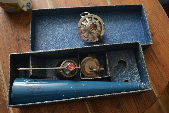

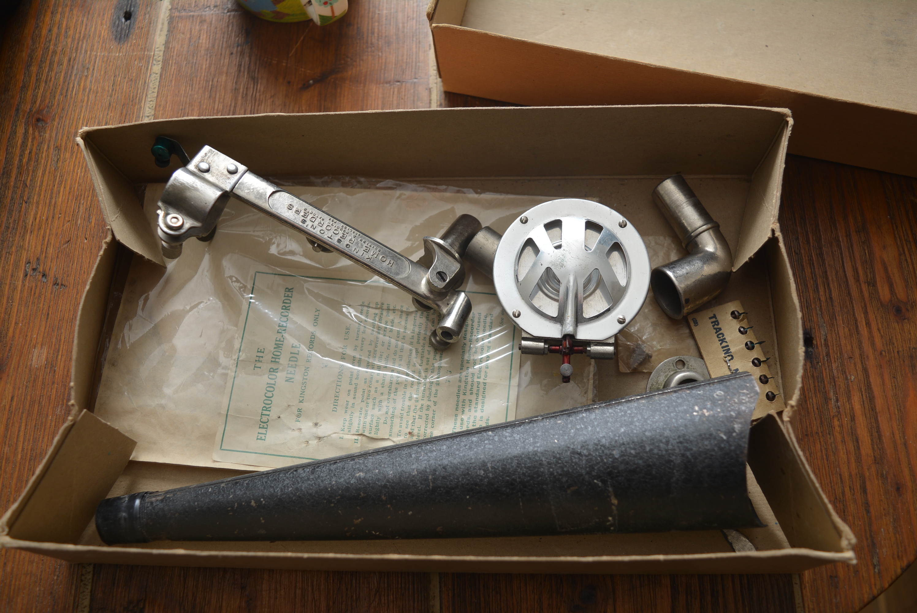

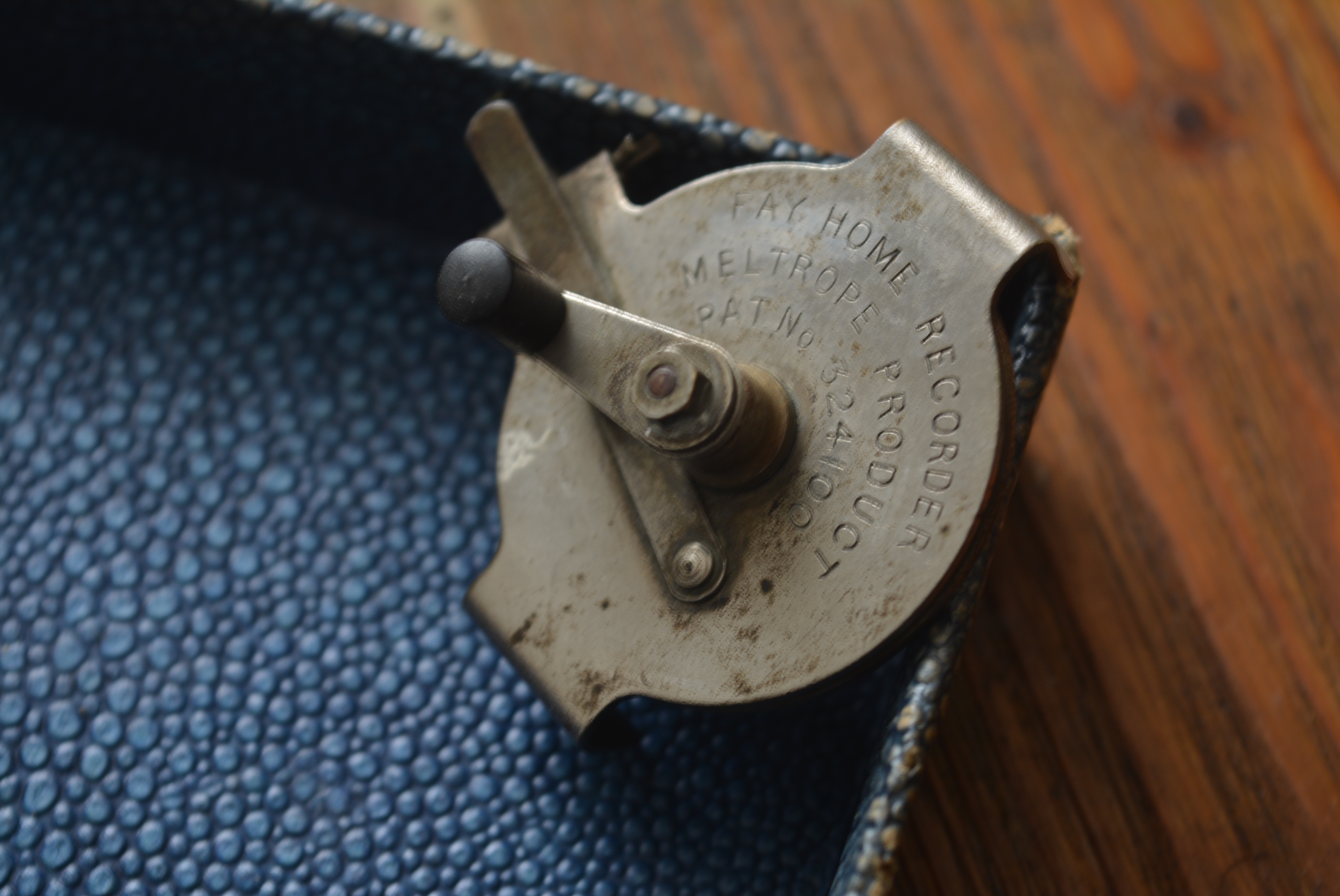

Iv'e been given 1 of these & it lacks any instructions, although it doesn't look too difficult to fathom how it works, wondered if anyone has a digitised copy of the instructions please & what type of needle needs to be made with which angle to cut a sound onto the surface of ....What ? Aluminium ? Thanks.

Did you get this to work in the end? It’d be great to see how if so. I also have one of these but I think there may be something missing or incorrect. I can’t figure out how the tone arm works in conjunction with the part that fits on the spindle to guide it properly.herrickpickups wrote: Tue Jul 01, 2025 8:09 am Iv'e been given 1 of these & it lacks any instructions, although it doesn't look too difficult to fathom how it works, wondered if anyone has a digitised copy of the instructions please & what type of needle needs to be made with which angle to cut a sound onto the surface of ....What ? Aluminium ? Thanks. DSC_0014.JPGDSC_0013.JPG

That's really helpful thanks! I was able to see how the central boss worked. It had totally seized (part of it being the dreaded potmetal), but I didn't realise that I'd only freed up the bottom section, so more work and it looks like its spinning as freely as it can. Also the small ball bearing to hold the bar is missing along with the spring, but that should be easy to replace.poodling around wrote: Thu Jul 10, 2025 6:30 amI have a set of these too - I sometimes wonder if I could 'over-write' a 78 record.herrickpickups wrote: Tue Jul 01, 2025 8:09 am Iv'e been given 1 of these & it lacks any instructions, although it doesn't look too difficult to fathom how it works, wondered if anyone has a digitised copy of the instructions please & what type of needle needs to be made with which angle to cut a sound onto the surface of ....What ? Aluminium ? Thanks. DSC_0014.JPGDSC_0013.JPG
