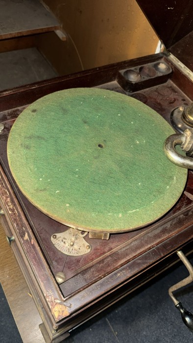

I just bought a Victrola VV-IX. I think something was jarred loose during shipping. I've contacted the shipper and am trying to get a discount for my troubles but meanwhile wanted to ask the experts if any of you know -- would this be a really difficult thing to fix or is it relatively easy? If it's something easy, anyone who can give me some pointers, I'd greatly appreciate it. It looks like the rod in the center somehow dislodged during shipping. There's a wheel shaped thing under the platter and I saw a loose screw. It also seems like the arm is blocked and won't move all the way over on top of the platter.

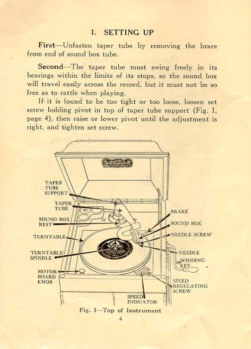

This will help you identify the basic parts found inside the Victrola's playing compartment --

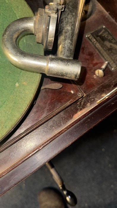

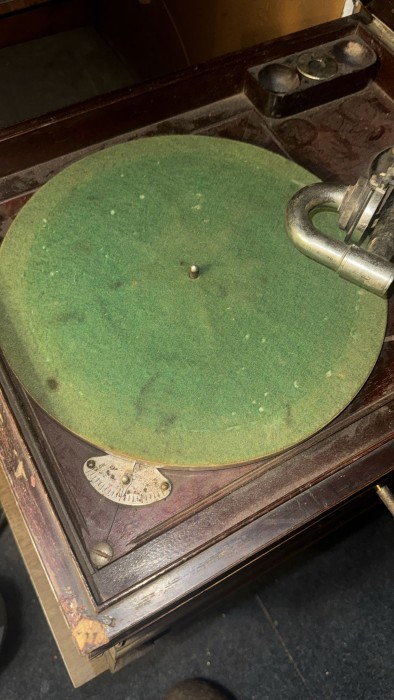

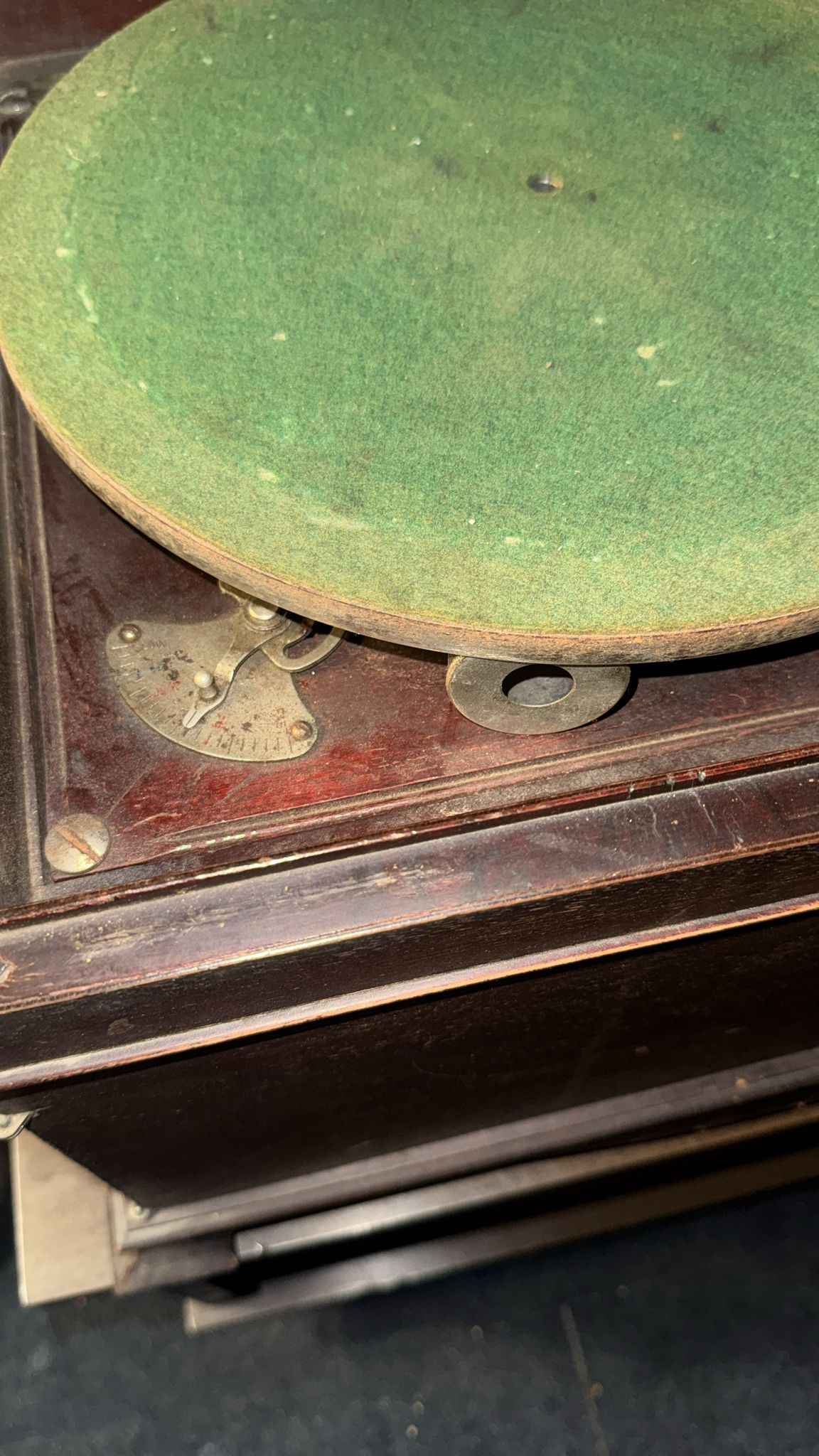

Judging from your photos, it looks like the turntable simply came off its spindle and is now seated slightly wedged off-center alongside the spindle. (The turntable just sits in place on the center spindle, so if nothing was placed inside the playing compartment to secure it during shipping, it would easily pop off if the package were tilted or placed upside-down.) That round "thing" seated under the turntable is a used needle cup which will fit in a circular hole near the tonearm.
Try this:
Move the break lever, which is visible under the tonearm crook in your second photo, toward you in case it's pressing against the inside of the turntable. Try moving the tonearm to the right as far a possible, then pulling up on the turntable and if it's loose, move it slightly sideways and up and you should be able to remove it. Most likely the turntable's spindle is okay, since it's firmly attached to and is part of the motor, itself.
Once removed, insert the turntable back onto the turntable spindle, and pinching the spindle with your fingers, move the turntable around until it "catches" on the spindle's support post, which you will see once the turntable is removed.
PLEASE post back with the results.

Is that a needle cup under the turntable platter?

Seeing is believing. We have pictures from two different angles, and that is definitely a needle cup turned on its side that needs to be removed. They should be able to just lift the platter off and take the needle cup out

Thank you. Thank you. Thank you. You probably saved me a long trip and a few hundred dollars to bring it to a place to get it fixed.
Now I have two more questions:

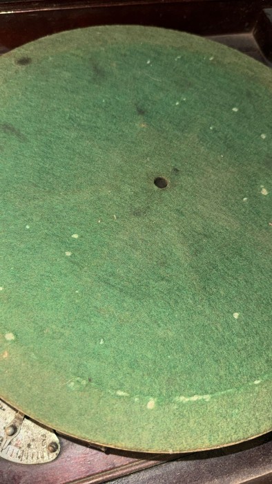

1. When I got the platter spinning it makes a kind of scraping sound as it's spinning. Is this normal? Did I put the platter on incorrectly?

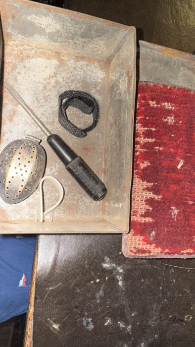

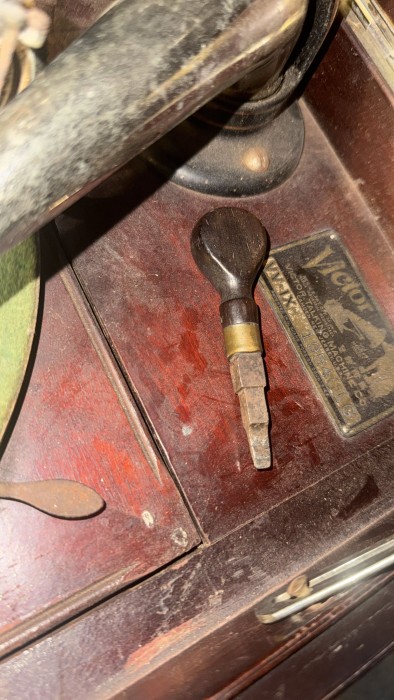

2. What is the screwdriver like thing for in my second photo?

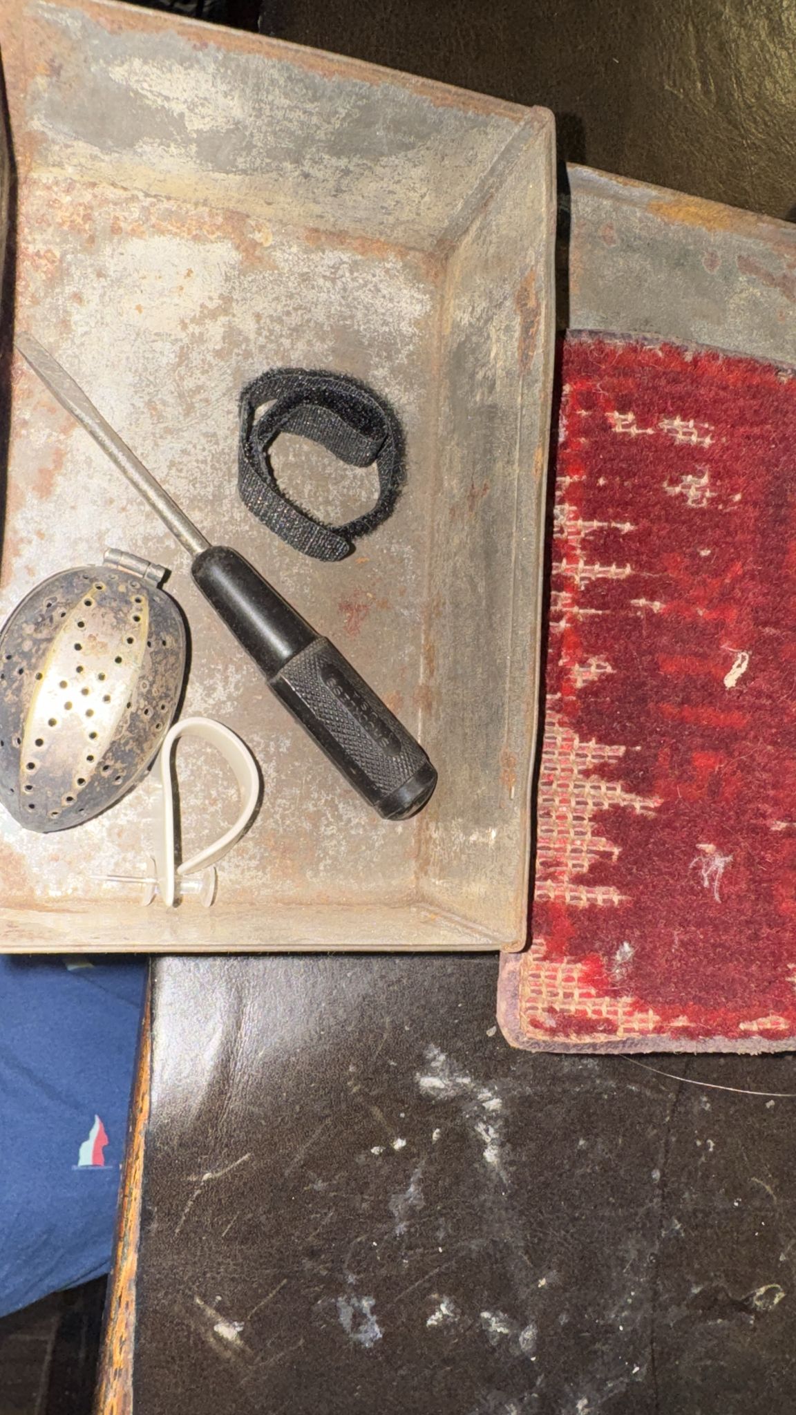

3. The items in the third photo came with it but I don't know what they're for. Any ideas? I mean, I'm guessing the brush like thing is meant to be used to clean it somehow but I haven't a clue what the other stuff is for.

It sounds like the brake is rubbing the underside of the turntable or the brake leather is missing. Lift the turntable off to investigate.
The wayward parts are a guitar thumb pick, a tea strainer, a Velcro strap and two screwdrivers, they are not part of your Victrola.

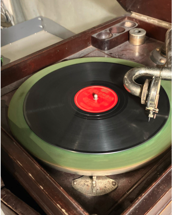

The quick fix MIGHT be as simple as tightening the large screw heads under the turntable (if they have worked loose, the motor will have dropped a little underneath, making the turntable correspondingly lower, hence scraping). Don't tighten them too much, just nip them up evenly for now. Later on, the rubber washers between the motor and the motorboard will probably need replacing.MarkELynch wrote: Sat Jul 12, 2025 9:50 pm It sounds like the brake is rubbing the underside of the turntable or the brake leather is missing. Lift the turntable off to investigate.
