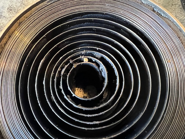

Here is something I have done for several years to get the springs to go on the arbor hook. I create a space behind the hole in the spring with a toothpick. This allows the arbor hook to engage the spring. I would think that eventually the toothpick gets shredded. I haven't had any issues doing this.
