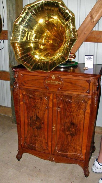

Paul Baker has made "new" Auxetophones. One was in Circassian Walnut.

I made two. The other one was ribbon striped African mahogany. I planned to make more but couldn't generate enough interest.

Here's the Circassian one, at Union in 2004. What a stunning piece of work. And it operated exactly as the originals.
