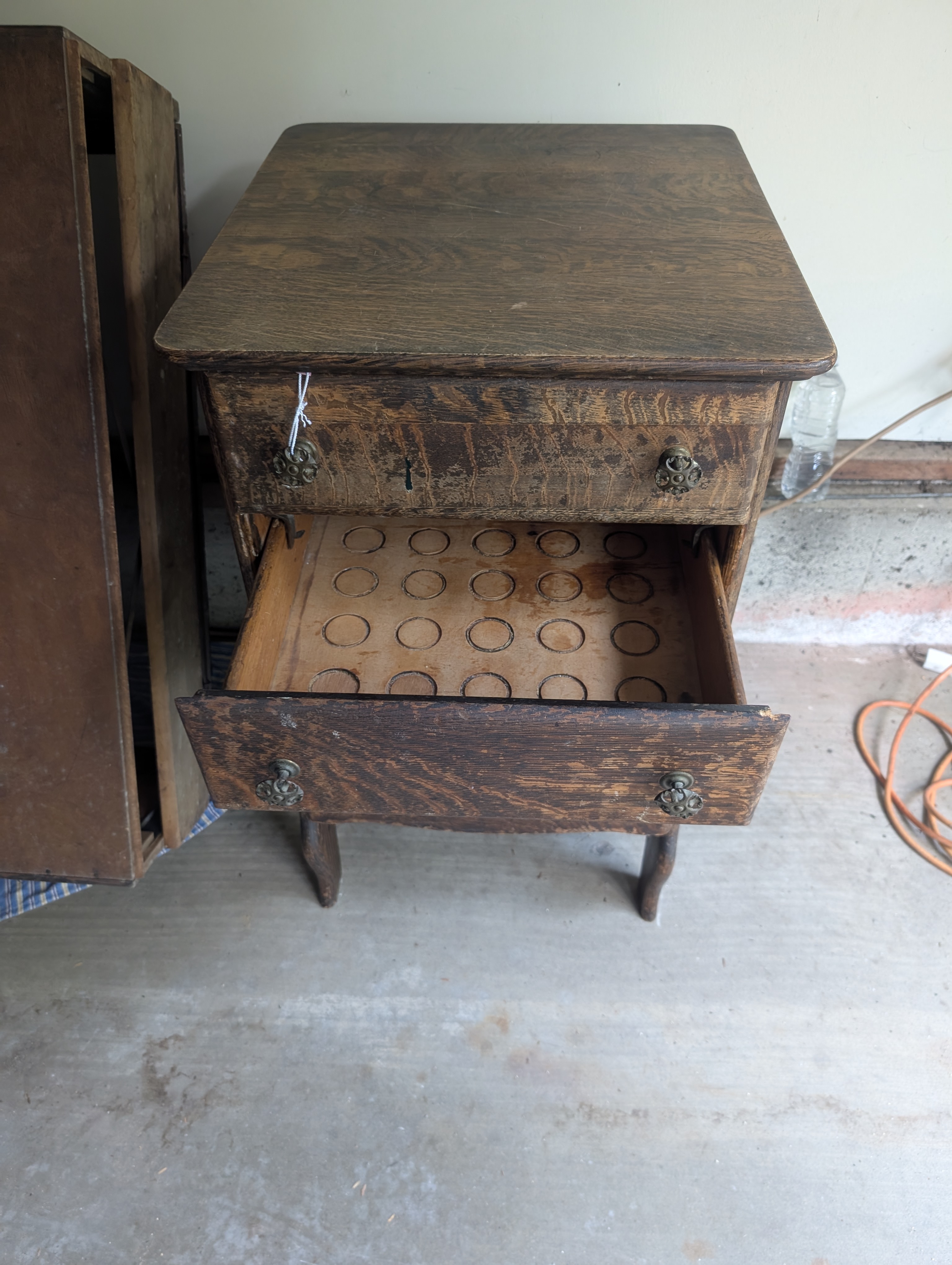

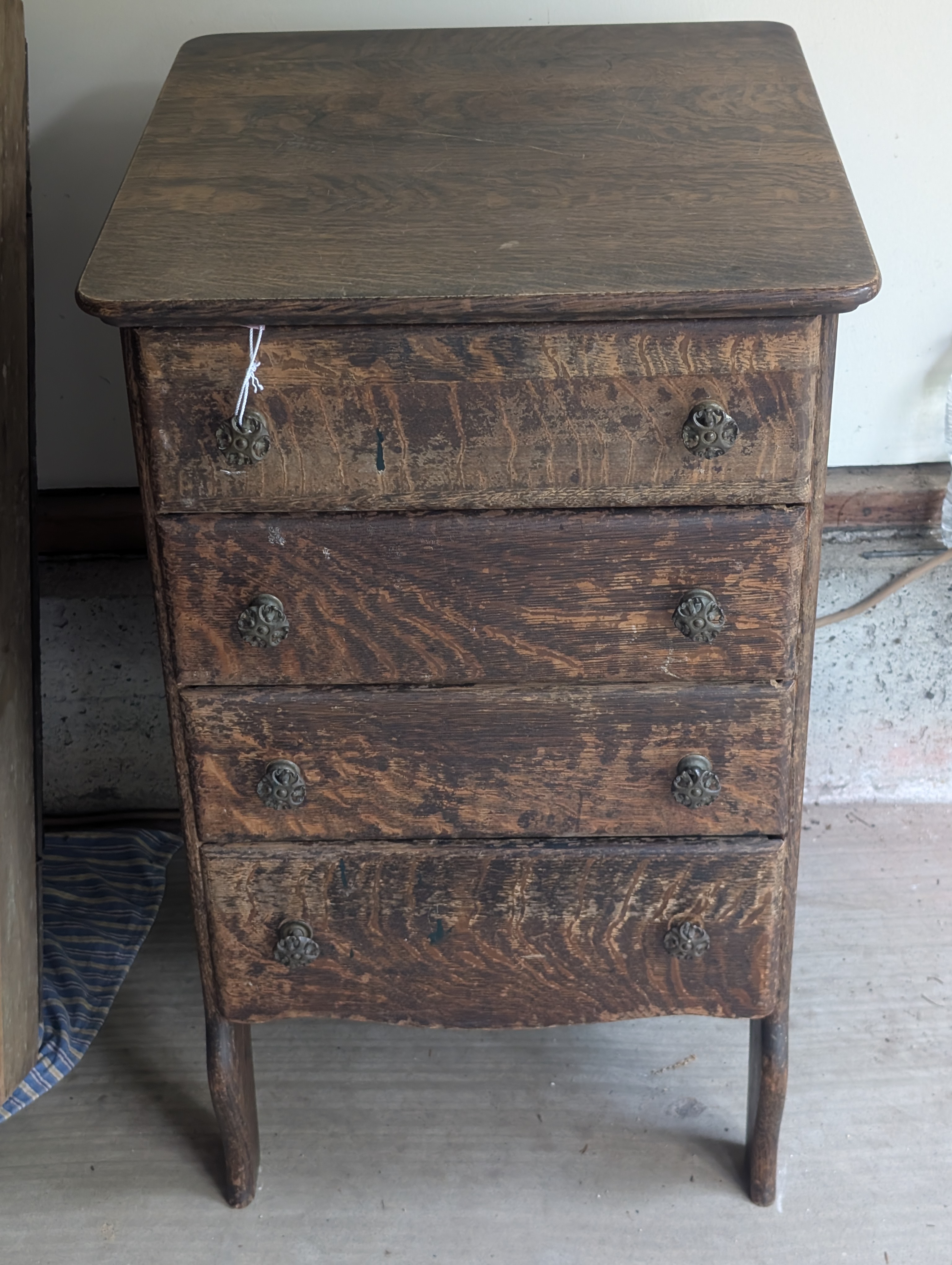

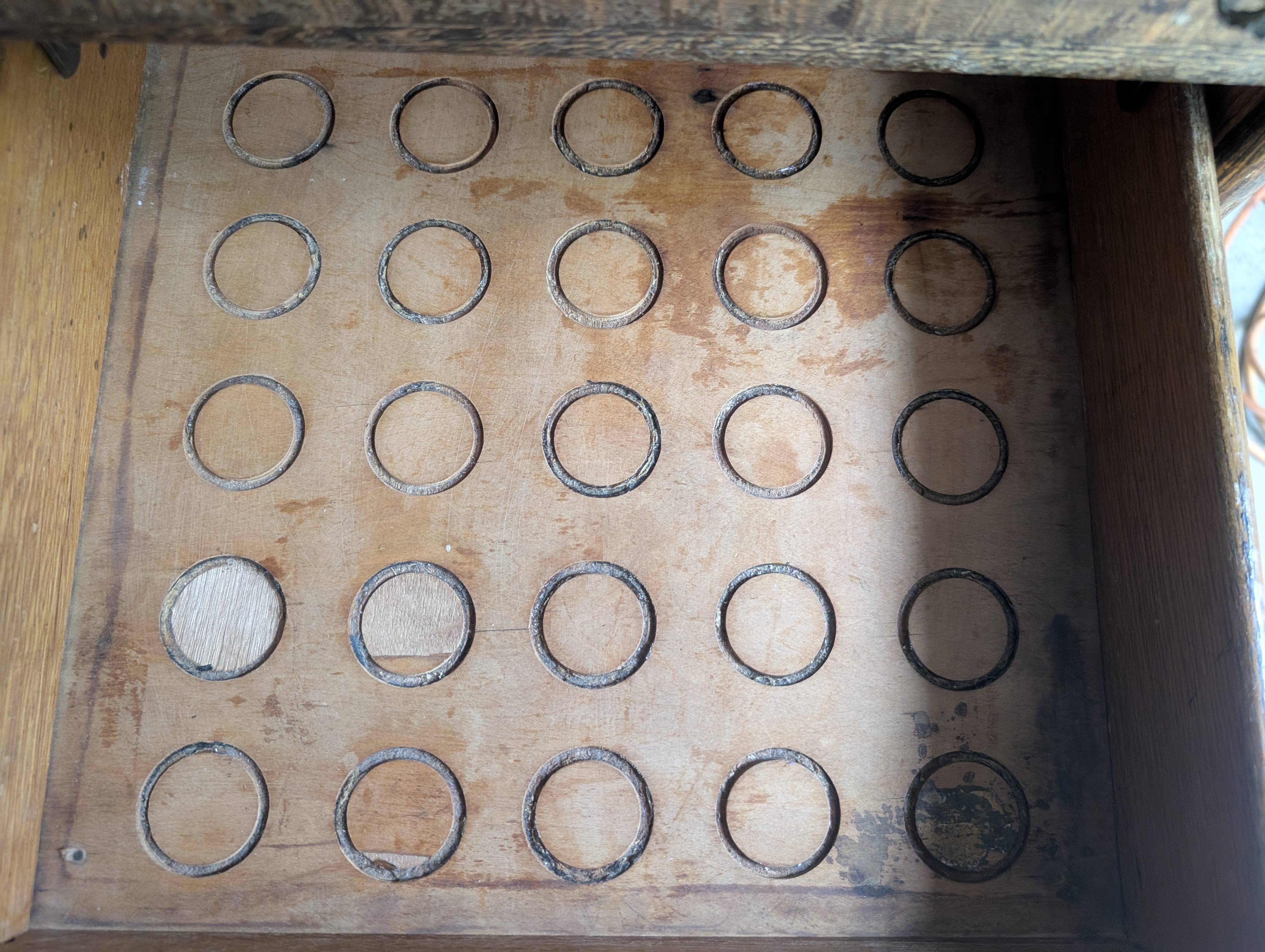

I recently picked up a humble (but heavy!) solid oak cylinder cabinet; the price was right, and I was happy to have it because all my other cylinder cabinets are mahogany. A few questions:
1. Can anyone say with confidence who made this cabinet?
2. Does anyone make and/or sell replacement pegs?
3. Any theories on what happened to the original pegs?

Hi- I believe it was made by Columbia-- but don't take that to the bank- I know others here will know for sure-
Justin Schwab-- JAS Antiques -- https://jasantiques.com/ -- sells the cardboard pegs. He usually has some on Ebay- I just looked and he has no listings-- There's a note in his store that he is away until Aug 4th. The last time I saw the pegs on Ebay, he was charging $75 for 100 ppd.
Pegs got removed by owners so that the drawers could be used for clothes, socks, papers, etc--- I've had numerous cabinets over the years and only a few still had original pegs inside.
You've got a nice cabinet that will look great once it is restored-
To remove remnants of the old cardboard pegs, use a 1 ⅝" hole saw-- If using the drill by hand, run it in reverse and it will ream out the old cardboard without cutting deeply-- If you have a drill press and can accurately set the depth, you can use the holesaw in forward mode-- just don't cut any deeper than the existing grooves or you'll bore through the bottom of the drawer.

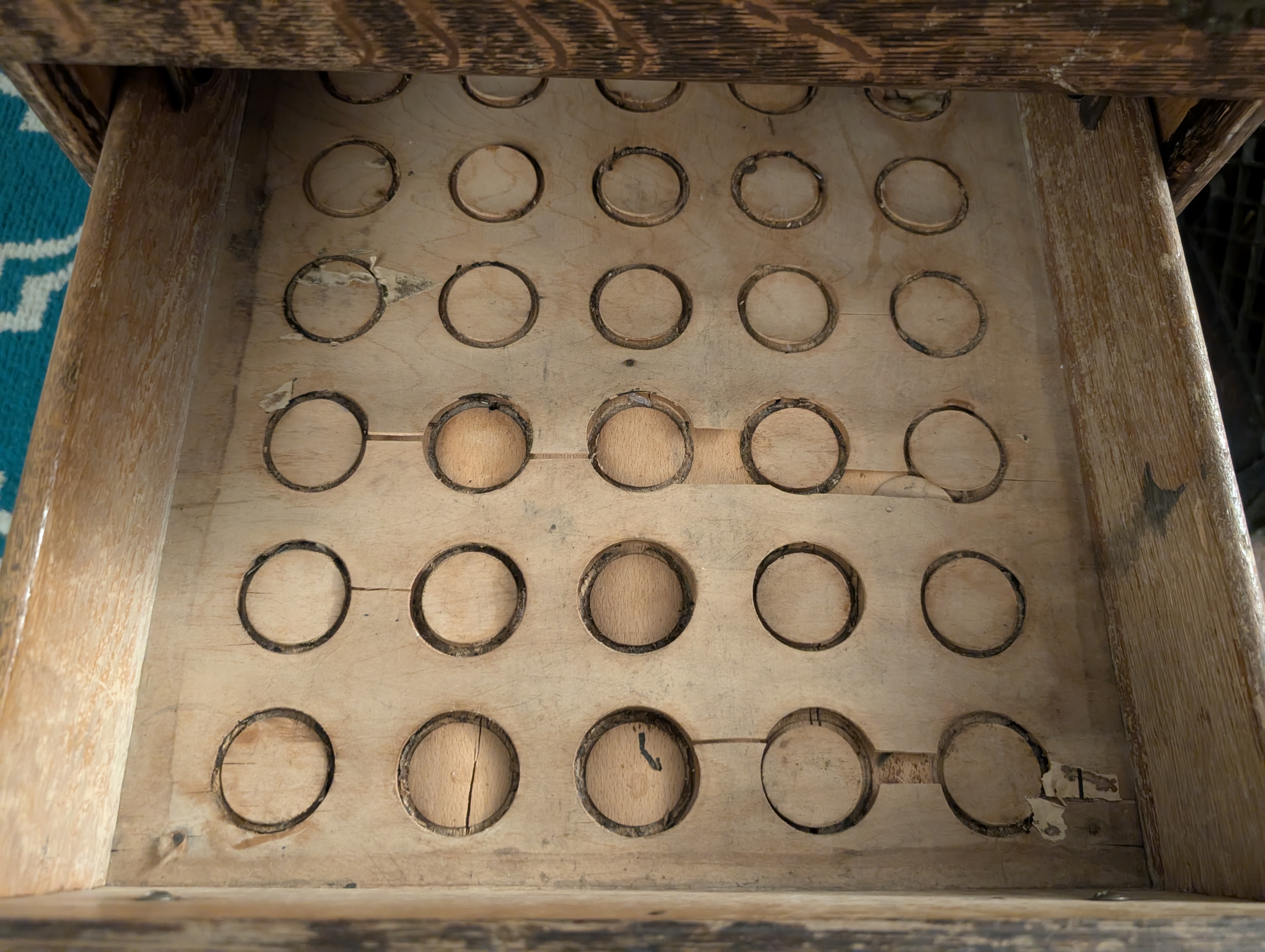

Thanks, Brad! That's all very helpful. I think, though, that I won't be able to restore the pegs, because the bottom of each drawer has buckling in it that would have to be fixed first. The photo is of the third drawer, which is by far the worst, but even though the buckling is not as severe in the other drawers, it is there to the extent that I cannot store encased cylinders in the for fear that I will not be able to open the drawer with them in there. This has already happened to me a couple of times, and I was very fortunate in that I eventually managed to get the drawers open again without damaging any cylinders, but for now I am storing the cases in them lying down. Eventually I will glue down the warped wood, but I will probably not replace the pegs -- I think that would be too much work. I am fine with storing the cylinders in their cases; I found the cabinet at an estate sale and it was very inexpensive.

To Zenger-- If the lamination on your drawer bottoms is beyond repair, you can purchase ¼" birch plywood and make replacements. I have made numerous shelves and drawer bottoms using the birch. It works well.
