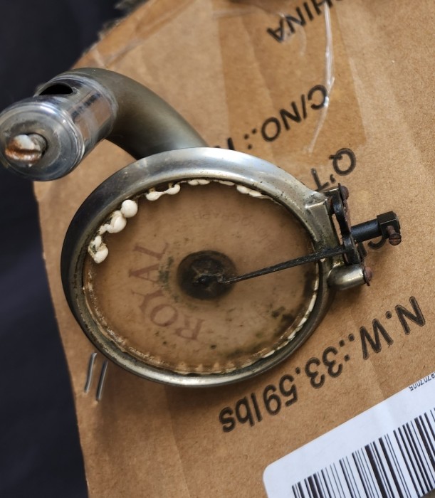

Well, I bought it. And to my surprise it works rather nicely. The motor mech is very gummy and greasy, but nothing that a good cleaning can't remedy, and it's all there. It works and it was $25.
It needs a felt mat, and the reproducer needs to be rebuilt or replaced. The reproducer is a "Royal" brand that definitely requires rebuilding. This leads me to my next question: should I spend for a No 2 or spend to rebuild the Royal? Authenticity isn't my goal, casual listening if anything, and probably not all that often is what this player will be used for.
Opinions, please. I know the player only cost $25, but I still want to do what's smartest. Thanks

If you don't care for authenticity.. this reproducer properly restored and adjusted can do a great job... It's like a period improvement over the original smaller Exhibition soundbox, replaced by this Royal, with a larger mica diaphragm which will give more bass if properly rebuilt. Kind of a mid 20s replacement. Besides that, its needlebar fulcrum arrangement is very similar to the Exhibition: the bar has a plate supported on two knife points protruding from the reproducer body or front ring, by means of two leaf springs and screws to regulate their pressure.
It looks like you'll need new rubber gaskets and a new mica diaphragm, as the current one looks like a plastic circle attached with glue or something... You should clean it carefully and examine it, as it could be still better than it looks now...

Good info, and no, I don't care for authenticity, so I'm more than ok with this reproducer, so long as I can get parts needed to refresh it. Are the parts easy to get?Inigo wrote: Sat Aug 09, 2025 4:14 pm If you don't care for authenticity.. this reproducer properly restored and adjusted can do a great job...

Yes, and not expensive... Although the machine was so cheap that maybe the parts cost more...
Seriously, a new mica diaphragm if needed, of adequate size, and gasket tubing for making new rubber gaskets can cost less than a meal.
The rest for making it sing again and look decent is cleaning, regreasing, oiling, a bit waxing, patience, love and care.
Here you'll find many colleagues advising you and leading you along the work to do, and you'll get an enormous satisfaction from doing all this work yourself and ending with a lovely machine that plays records very well...
As others have said, if you're patient and have some basic mechanical abilities, it's an easy machine to repair and make it look and work nicely.
