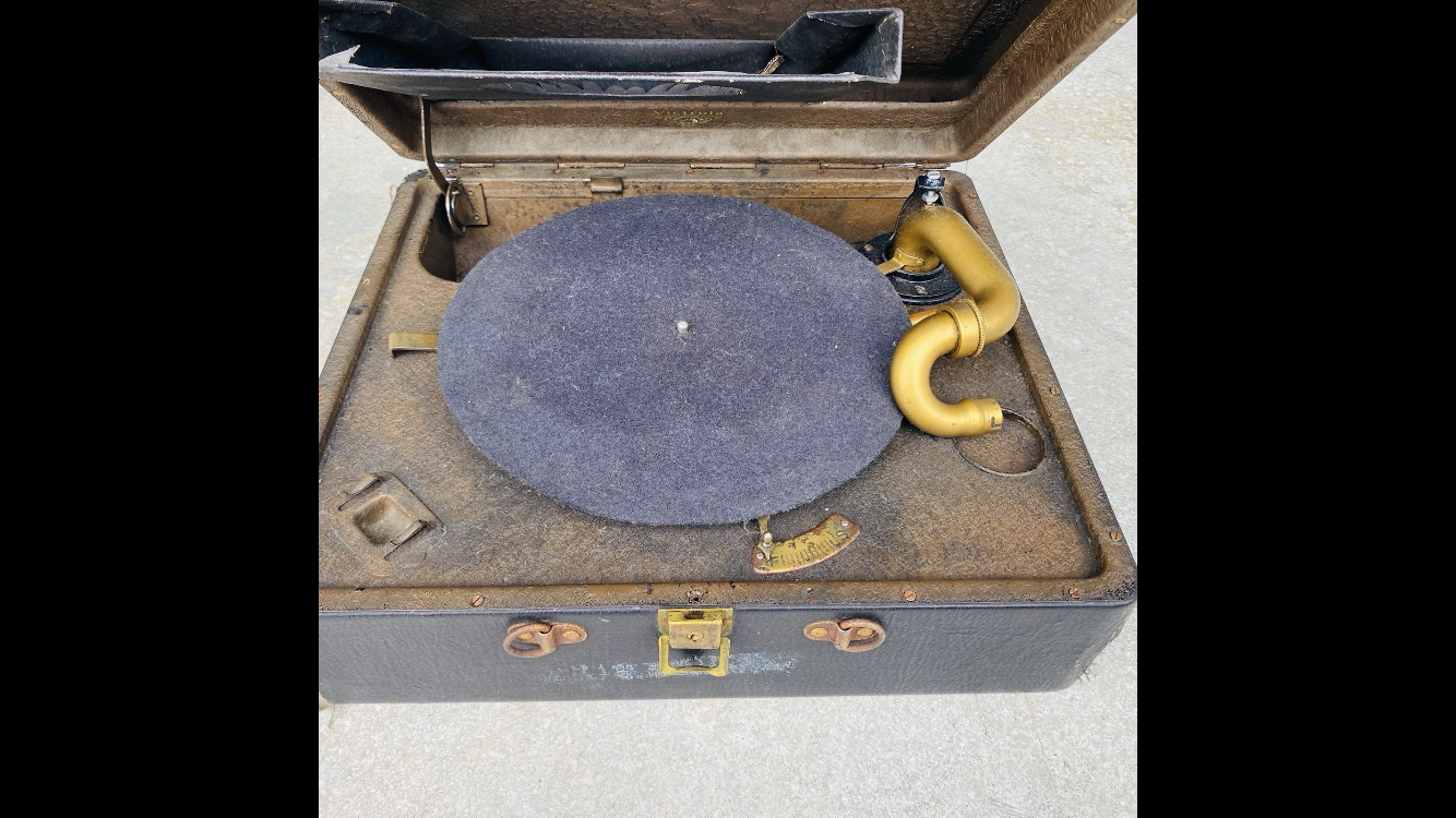

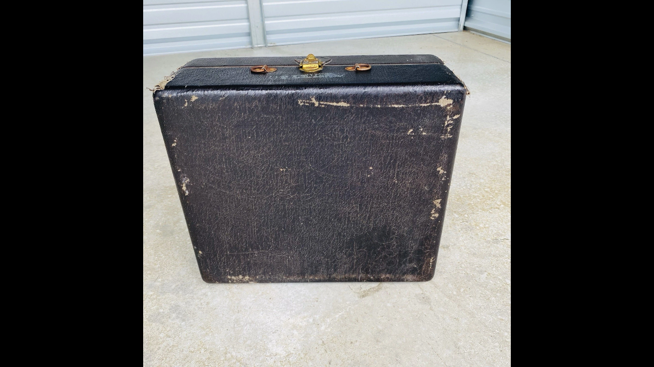

Well I successfully sanded off the rivet holding the auto stop mech on my parts tonearm, now all I gotta do is wait for the second 2-55 to show up and I can do some case/motor/hardware swapping with both to make a good working 2-55! (Hopefully the lid catch and record holder stay intact with this one)
This is the second machine ill be Frankensteining with the other VV 2-55 with.
Looking at the photos, the turntable and speed control will be swapped from the other machine to this one.

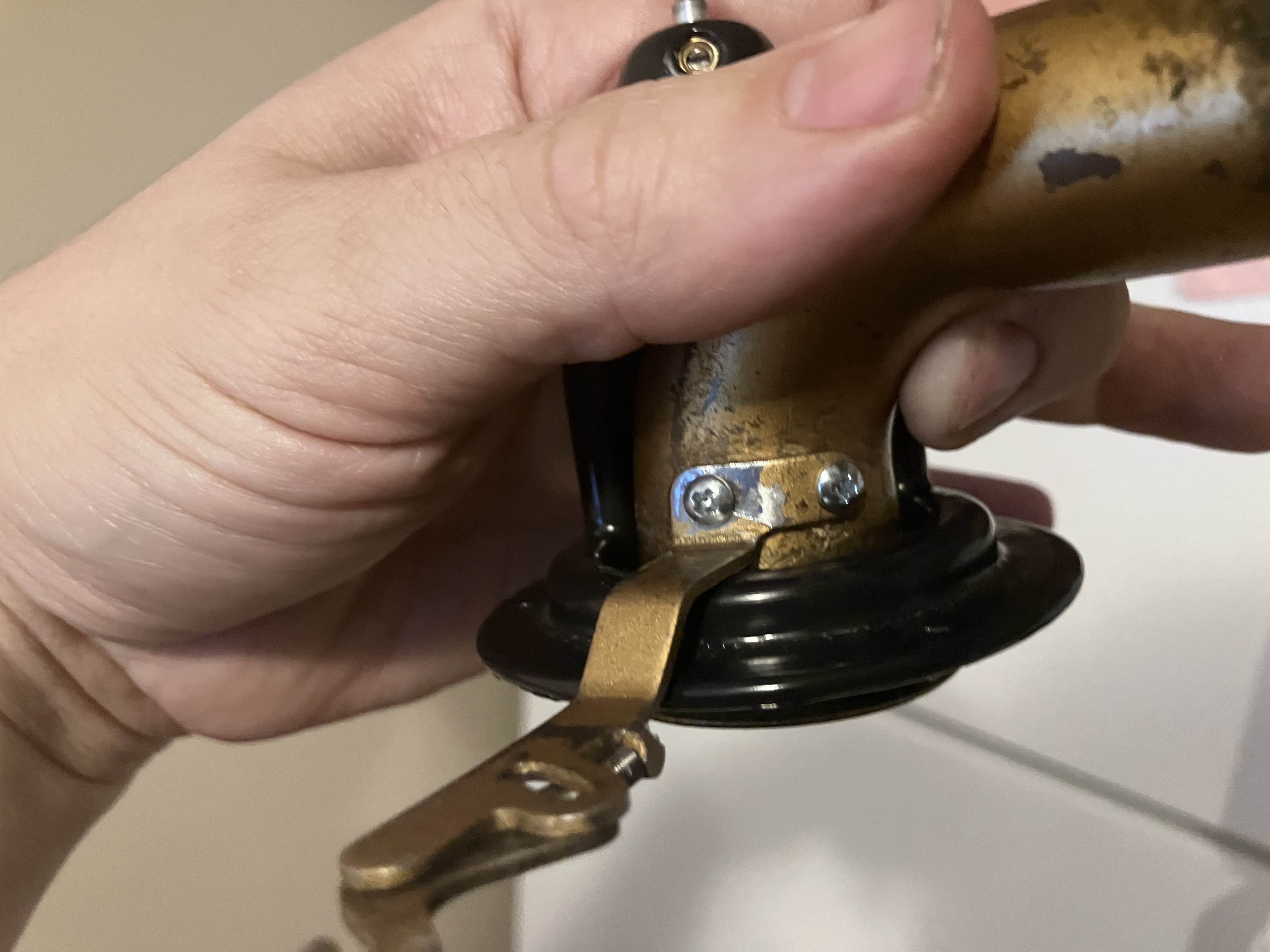

Well I got the auto brake mechanism on... Not the neatest job and I'm not sure it's gonna hold. But I will find out.

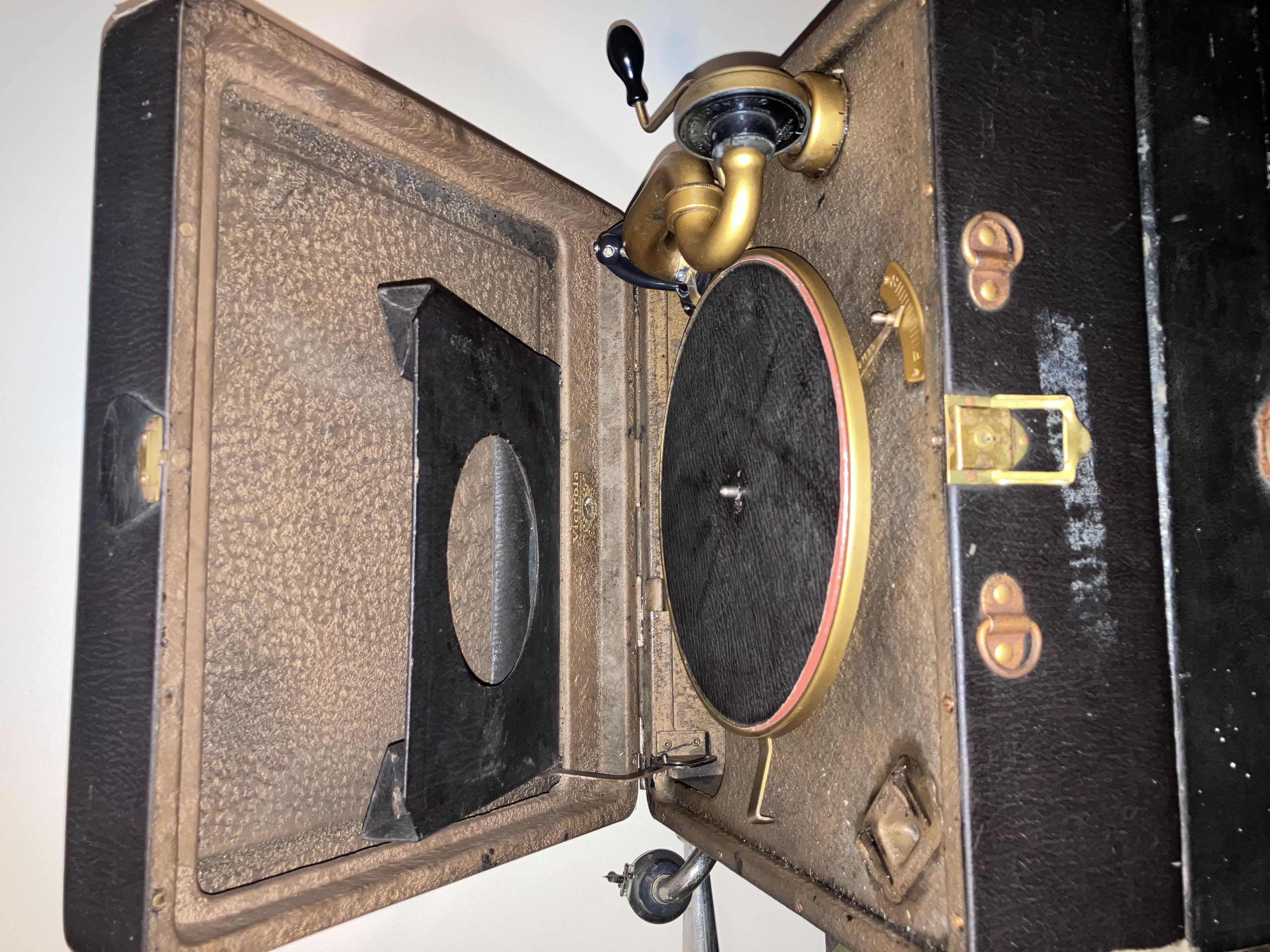

Ok, I got the second machine and I was able to transfer hardware from machine #1 to machine #2. Including the turntable, speed indicator, Tonearm rest, crank, which was in better condition on machine #1 than machine #2. Plus, I installed the tonearm and 3d printed support.
Now. I also wanted to transfer the motor and bottom from machine #1 to machine #2 BUT there are two stubborn screws holding on for dear life on the case. So until I get those out I’ll settle for the filthier motor.
The stop mechanism on the tonearm doesn’t completely auto stop on a record but it shuts off when I move the arm.
I need to get a better C-clip because sometimes when I stop the turntable the motor still wants to spin under the turntable so I hear THUMP THUMP THUMP!
And of course, I need to send out my orthophonic soundbox out for a rebuild because it needs it bad!
At least I now got the machine I SHOULD’VE GOT 7 YEARS AGO!
Here’s the before and after pics

AmberolaAndy wrote: Tue Aug 05, 2025 3:34 pm Well I got the auto brake mechanism on... Not the neatest job and I'm not sure it's gonna hold. But I will find out.
While the Phillips drive screws are functional and will certainly do the job, bear in mind that that Phillips screws did not come into general use until the 1940’s so they are a bit out of place on your 1928 machine.
