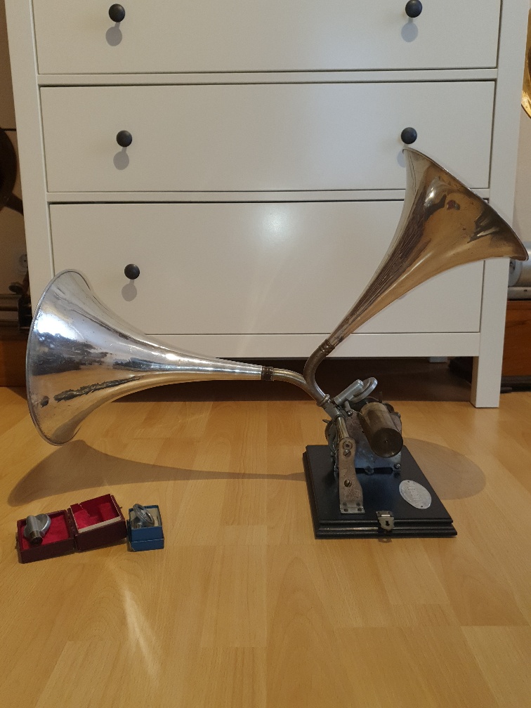

1901 Lioret also sold machines from other Phonograph manufacturers. Sometimes cases and/ or technical elements where modified. Here a French Graphophone Eagle variation (measurements are slightly different to the Eagle) sold by Lioret.
The most funny thing here is the reproducer. The Sahire is sitting on a spider system with 28 feet glued to a wooden mica.
The two horn device can be found also in combination with recording devices.

A very interesting and scarce Lioret. I've never seen that reproducer before. What a fascinating twist on the Bettini spider design! How does it sound?

To be honest. Sound with a Graphophone type reproducer would be better. I think that the wooden sound plate / mica has wound/ became dis-formed within last 120 years.

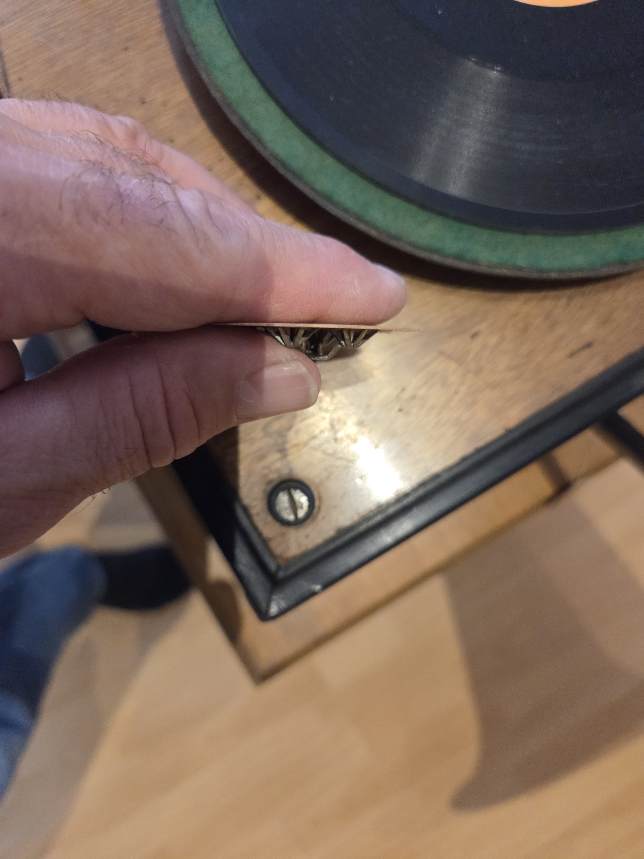

I just dissesembled the Castan Reproducer. The resonator is just 0,5 mm thick piece of wood.
