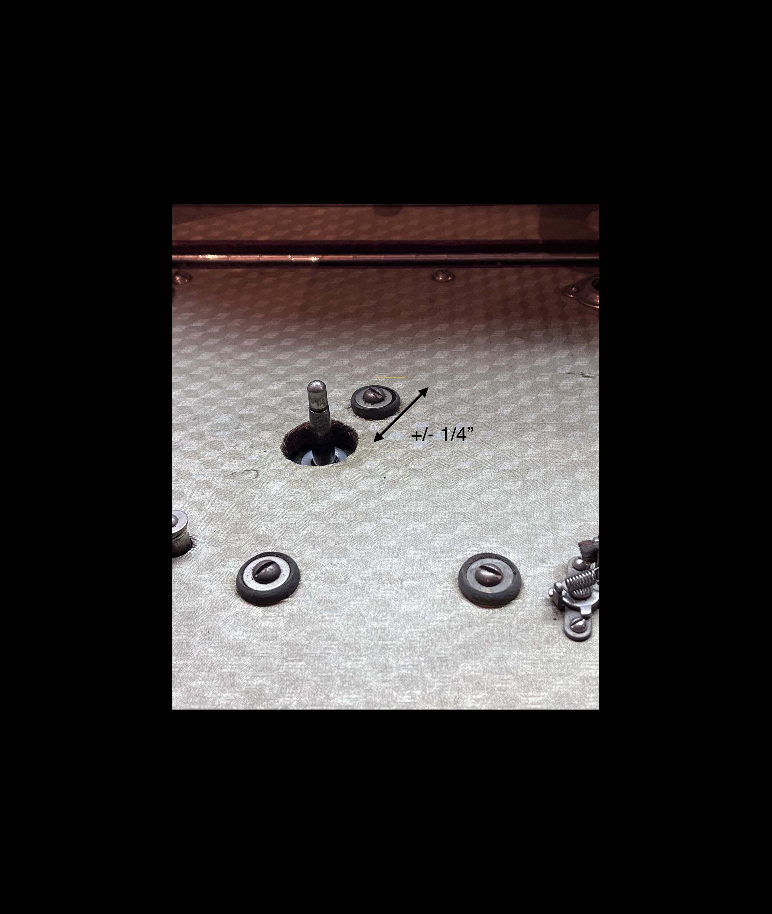

My new-to-me Columbia Harmony Portable No 2 has a wobbly turntable. The spindle seems fine. When I tighten the rearmost of the three screws that connect to the motorboard it shifts diagonally about a quarter of an inch.

Do you mean these rubber grommets under the screws on the top side of the motor board? The ones in my photo?

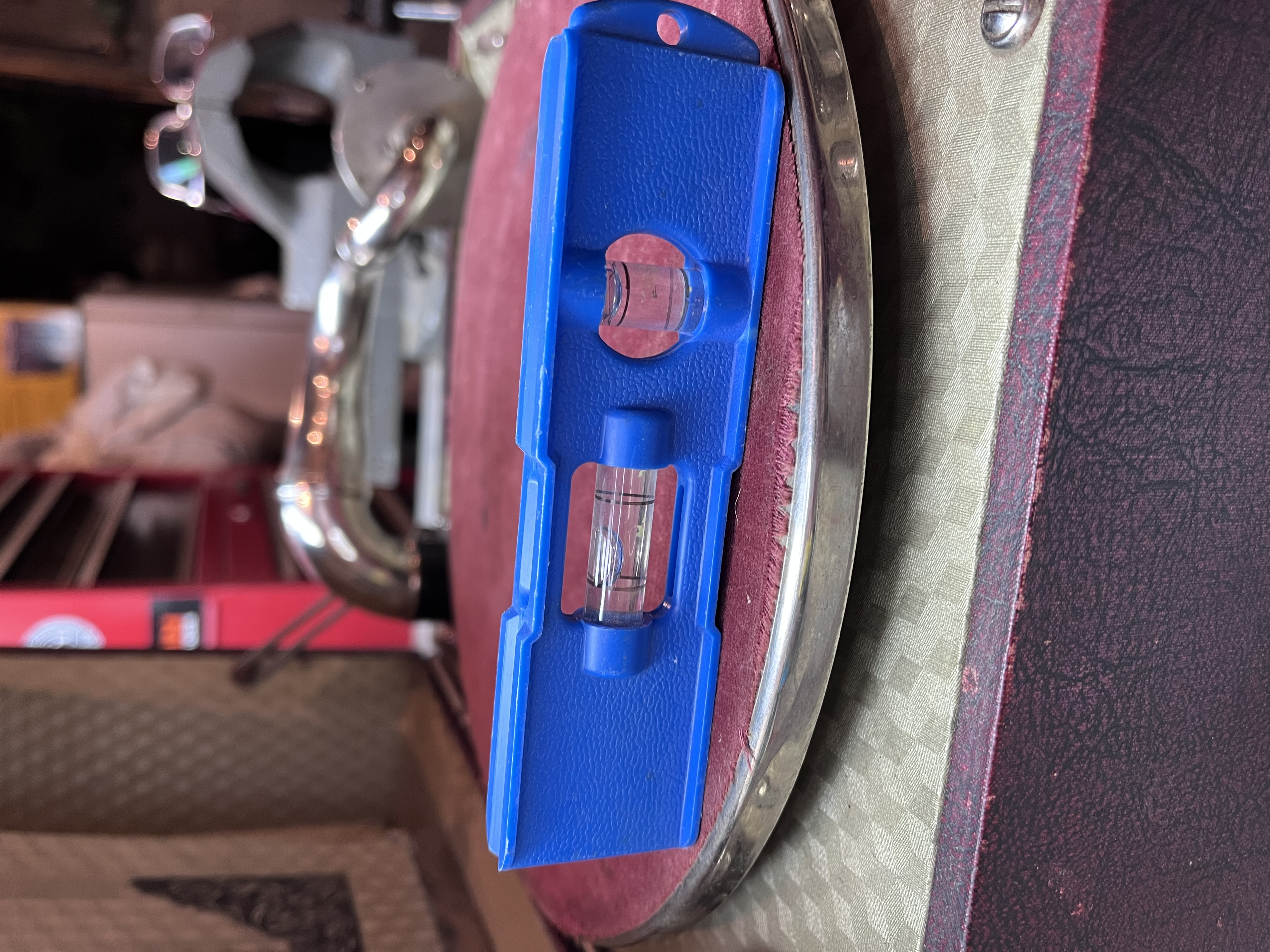

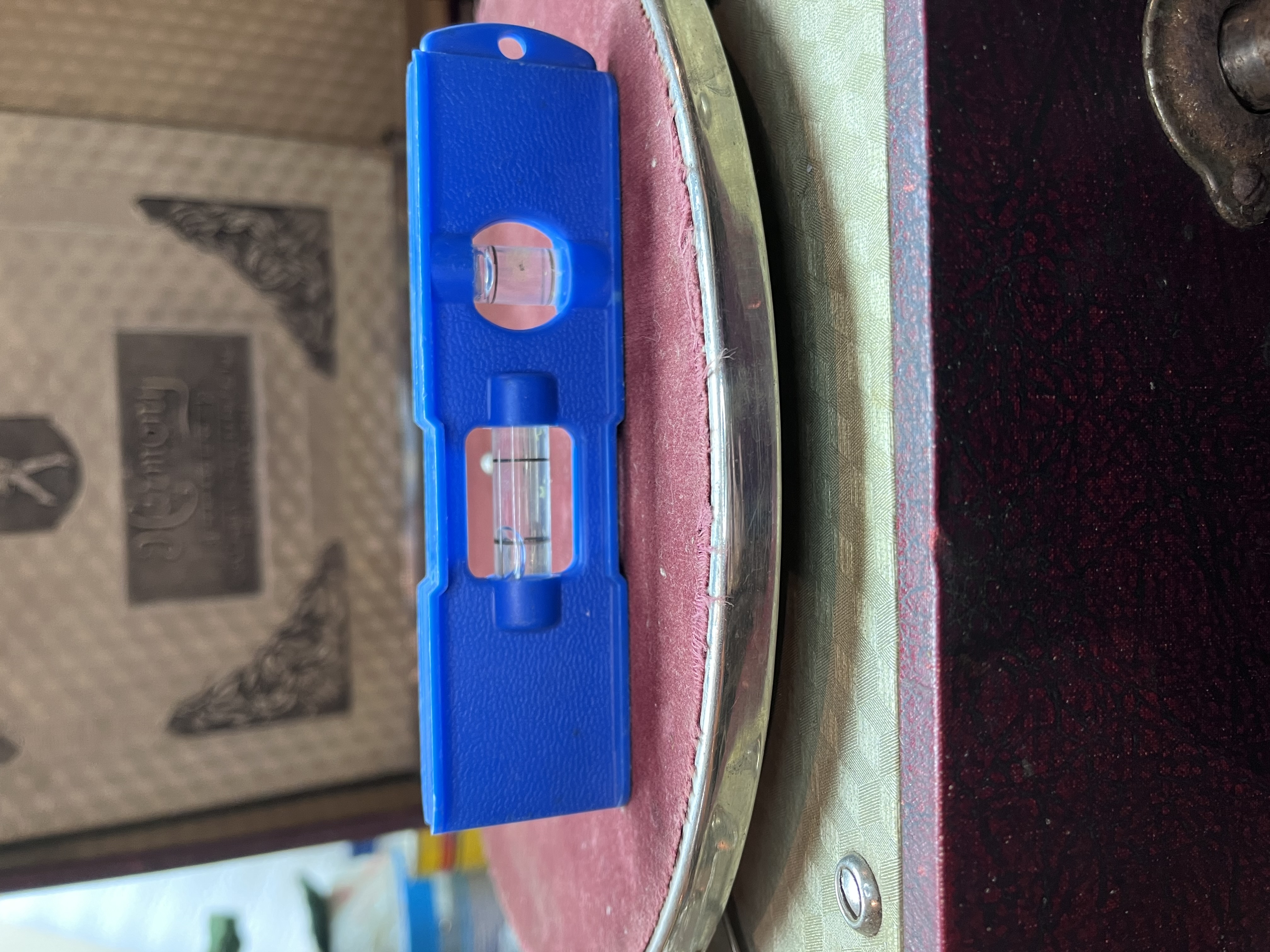

With a level on the turntable it looks to be low toward the front and the right hand side (like this
Any advice on how to shim, what to use, etc?
(BTW, sorry if I ask simple questions, I’ve never done anything like the before so I’ve got a whole lot to learn.)
