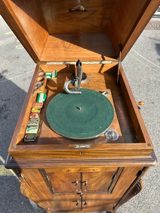

What is this amazing looking HMV ?
poodling around
Posts: 2500
Post by poodling around »
I haven't seen anything quite like this before.
More doors to open and close and half close than you could wish for and some kind of special horn ?
[urlhttps://www.ebay.co.uk/itm/257122091751?_skw=gr ... R_CGzM-vZg][/url]
Posts: 6923
Re: What is this amazing looking HMV ?
It's equivalent to a U.S., Victor "L-Door" XVI, but with a special wood. Some species of walnut, but I believe not Circassian.
Posts: 4049
Post by Steve »
It's a Style No. 14 from memory. I've seen a few in my time. The mahogany version was a No. 13 but otherwise identical. I have the No. 12, also in Circassian walnut but it is the first machine to have a cast iron internal horn behind a louvred grille. The 'L' door models were simply a continuation of the Gramophone Grand / Junior Grand style / range from the previous 4 years.
The horn is very much the same as those early models.
They do turn up infrequently but then frequently make no money! A bargain at £100 either way.

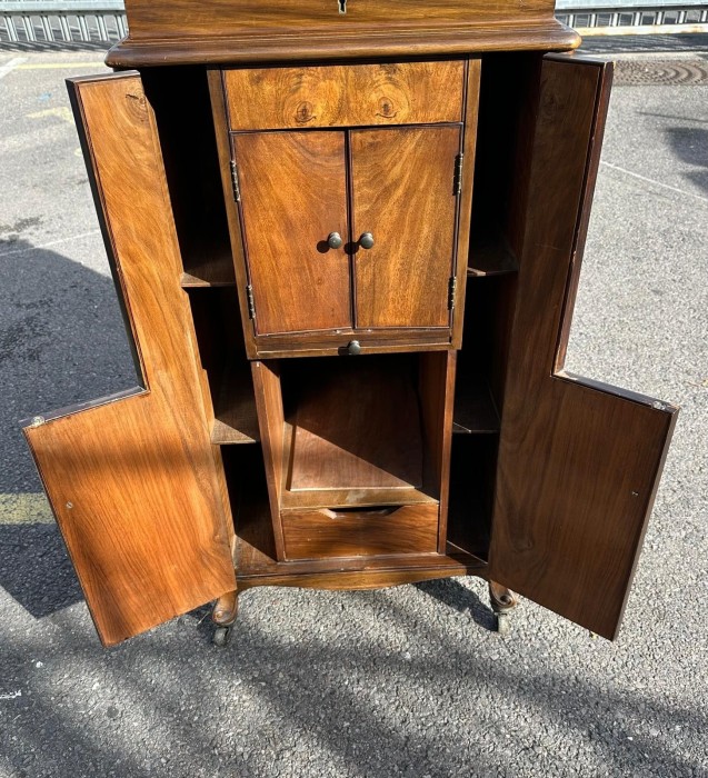

Oh, if anyone is actually still looking at this thread, is this piece of wood original I wonder ?
It just looks kind of added at a later date maybe ?
I wonder, if it is added later ........... why would that be ?
kiwiatlarge
Posts: 159
Location: Oregon
Post by kiwiatlarge »
Added at a later date - 4 X 12" record boxes or albums slide into that space. 6 X 10" go in the outdoor slots. The walnut finish makes this one more desirable than Mahogany or oak version.
Michael
ChesterCheetah18
Posts: 464
Post by ChesterCheetah18 »
It doesn’t appear to be attached, rather just sitting there. I would be more concerned about the possible damage that may have been done due to the horn opening doors being pushed beyond their stops.

ChesterCheetah18 wrote: Thu Sep 25, 2025 12:39 pm It doesn’t appear to be attached, rather just sitting there. I would be more concerned about the possible damage that may have been done due to the horn opening doors being pushed beyond their stops.
Agreed regarding the stray spare piece of timber. I doubt it has anything to do with it.
The doors do not appear to be damaged by the clumsy handling though.
