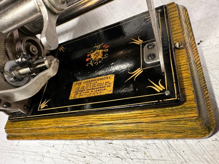

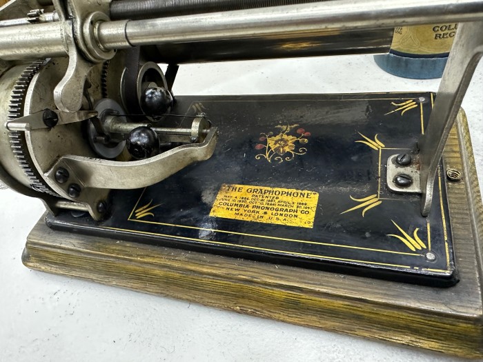

Below are pictured results I had my a Columbia Q.
