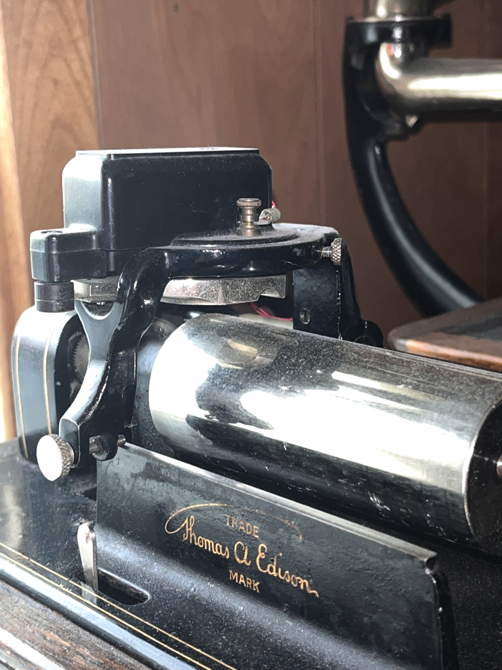

I remember at one point reading about these being patented in Britain around the early 30s. I don't recall much else, though. Does anyone know if these were actually manufactured or existent?

you are referring to the Sykes Electrograph reproducer made in England mid 30's. They were made to play Blue Amberol cylinders. The only electric pickups manufactured by Edison were for his disc phonographs the C-2 and C-4

GroverOverton08 wrote: Wed Oct 29, 2025 2:19 pm I remember at one point reading about these being patented in Britain around the early 30s. I don't recall much else, though. Does anyone know if these were actually manufactured or existent?
If interested here is the patent for the Sykes reproducer.
Sykes Patent-SM.pdf
(1.05 MiB) Downloaded 44 times
The patent also covers a unit for Diamond Discs and one for lateral cut discs. Never seen one those or even heard of any produced.
I have one mounted to an Edison Standard, it plays well but the only drawback is that it is very sensitive to out of round cylinders or with any imperfections.
The best cylinders I have found to play for demonstration are Indestructible cylinders they seem have the best "roundness?"
A cylinder that sounds great on a acoustic Diamond B will have a very noticeable periodic thump where the cylinder is slightly out of round when played on the Sykes.
Sykes Patent-SM.pdf
Chuck

ChuckA wrote: Wed Oct 29, 2025 3:17 pm...I have one [Sykes reproducer] mounted to an Edison Standard, it plays well but the only drawback is that it is very sensitive to out of round cylinders or with any imperfections.
A cylinder that sounds great on a acoustic Diamond B will have a very noticeable periodic thump where the cylinder is slightly out of round when played on the Sykes. ...
That tracks with my experience playing cylinders on the electronic Wilson Home, which isn't limited to 4-minute celluloid. I had the impression US Everlasting gave the best results (although I don't have enough of those for a statistically valid sample), followed by Indestructible (ditto), with Blue Amberols more often than not having pitch stability and thump issues. As you noted, those sorts of problems are much less noticeable on acoustic machines. Wax cylinders, 2- or 4-minute, were more consistently satisfactory for electronic playback, but the wax Amberols have their own problem, the tendency to be excessively worn or damaged from acoustic playback.

I find the best sounding records using this device are the Edison acoustically recorded Blue Amberols providing they are in good shape and don't have and surface irregularities like Chuck said. I feed the signal from mine into an Edison C-2 so I can get a really authentic sound. It's fun to listen to cylinders electrically.
