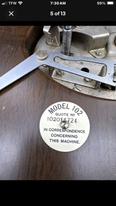

- AmberolaAndy
- Posts: 2746
Re: HMV 102 production numbers
Yesterday I purchased 102 #14724 from eBay. I believe this is the first generation model from 1931 from what I am reading?
Oedipus
- Posts: 343
Yes, that is the first type of 102, with the Universal Automatic brake.
