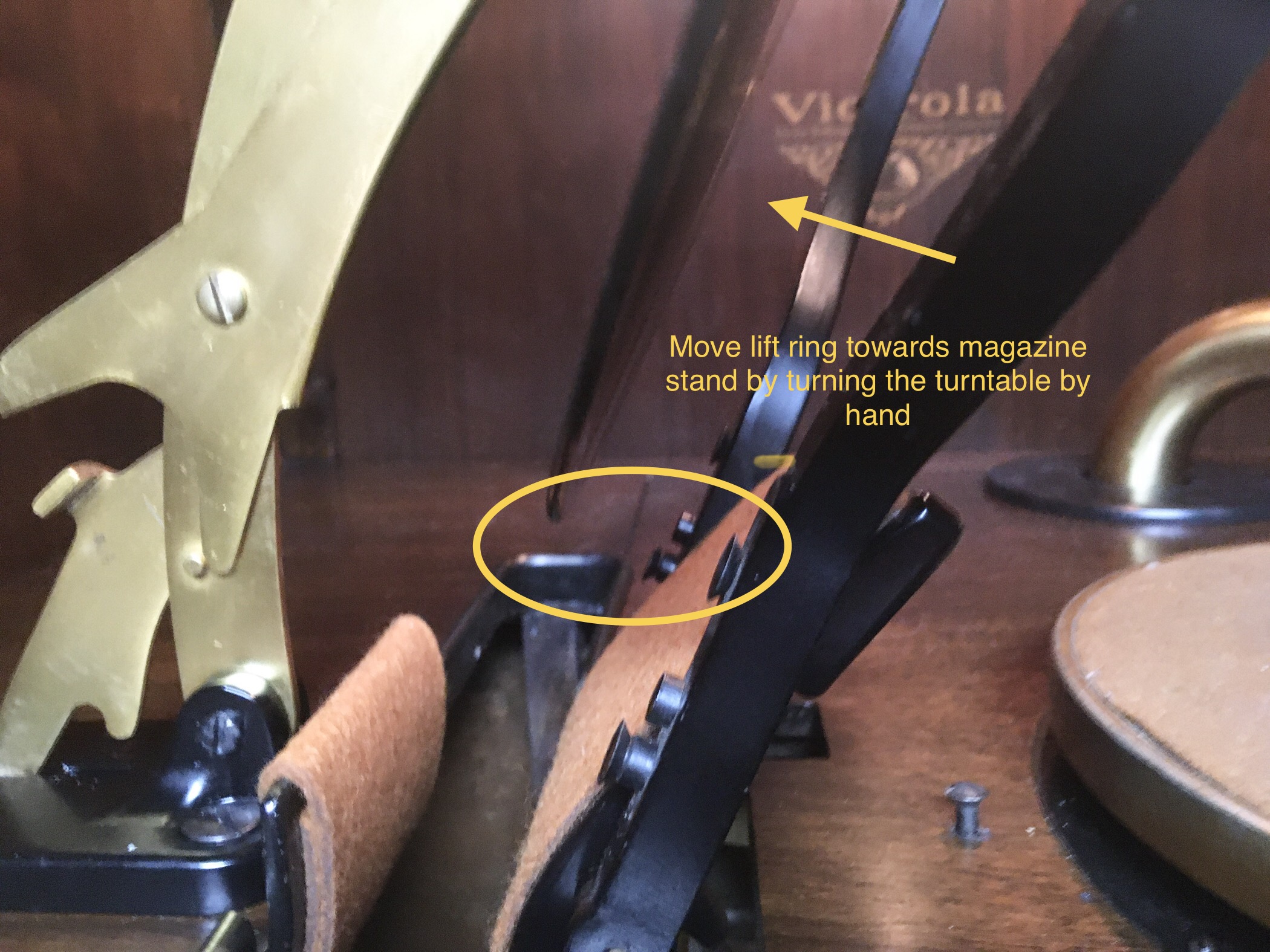

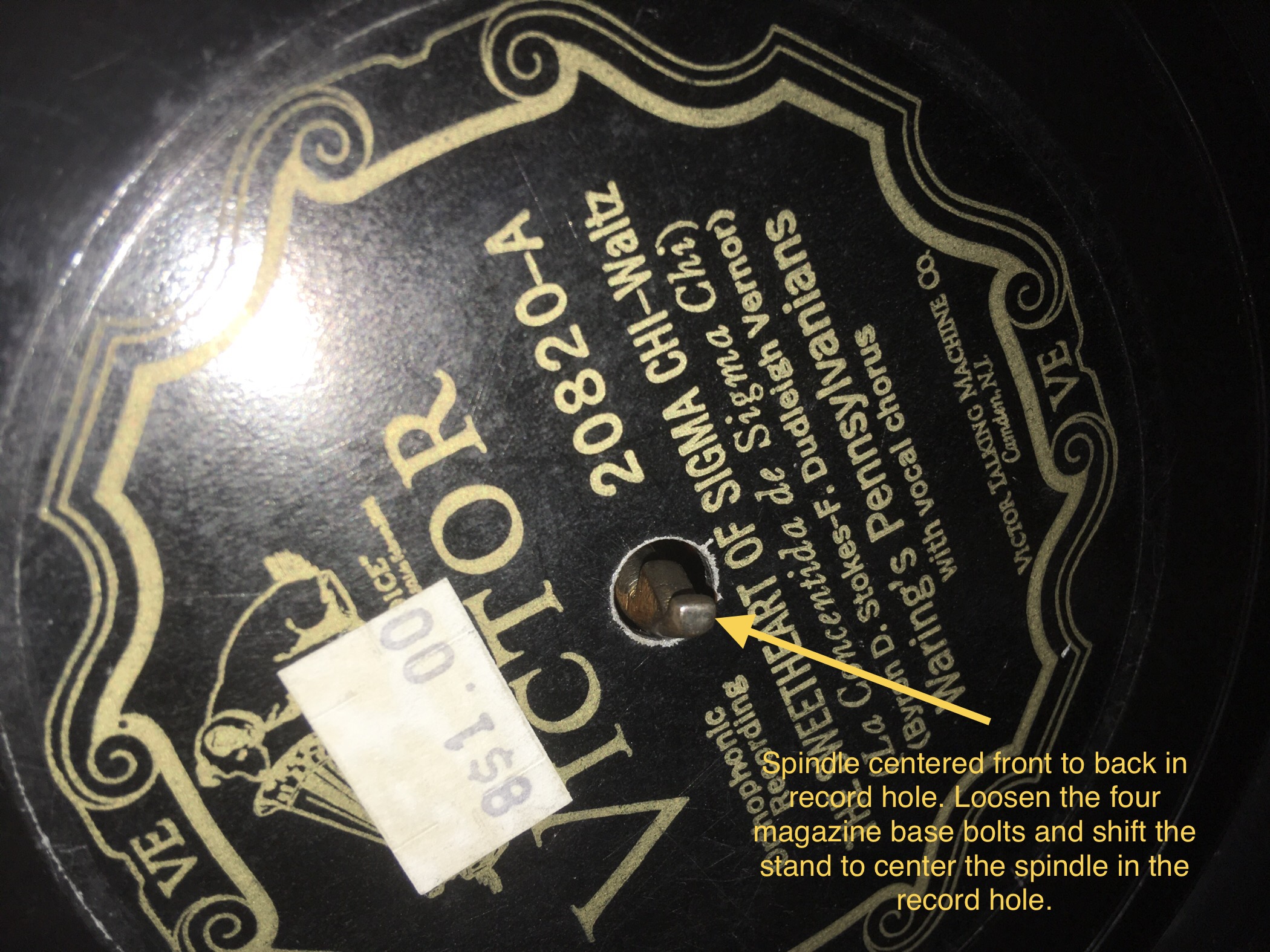

In preparing for the introduction of the new Victor Automatic pot metal replacement parts and creating an instruction guide I had the opportunity to put together some photos that explain how to adjust the magazine stand and how the record transfer operation works. It is always amazing that the machine can pick up only the bottom record from a stack of twelve hanging to the left of the turntable.
Maybe some of these tips will help with adjusting your 10-50, 10-70 or 9-55. A word of caution, the adjustments only work if the parts are not swollen and out of spec. Most magazine bases, the black part that holds the gold upright stand, are deformed or broken. The top of the base that has the hook is often sunken down which causes the magazine arm to stand too vertical. In this condition the record lift ring cannot reach far enough to the left to retrieve a record. A new base will easily fix this condition.
Let me know if you have any questions.
Mark

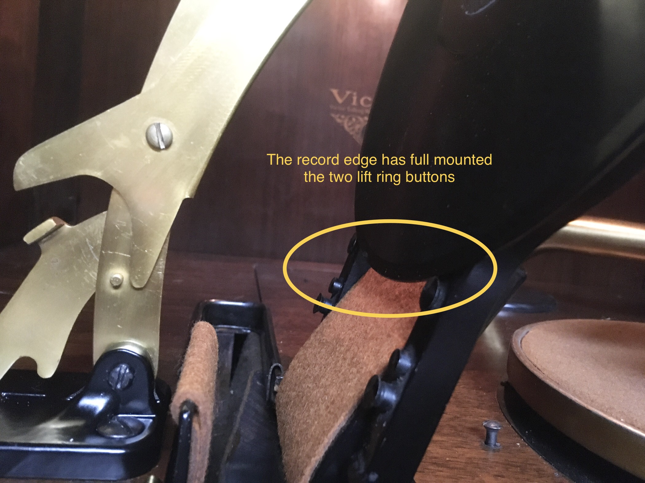

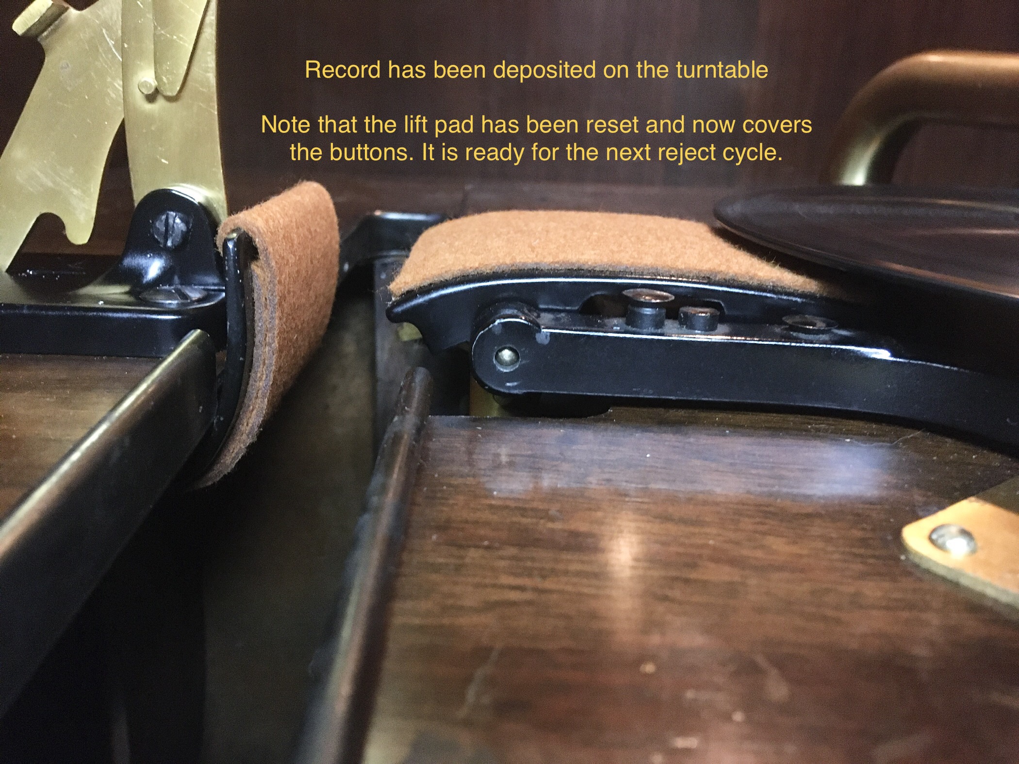

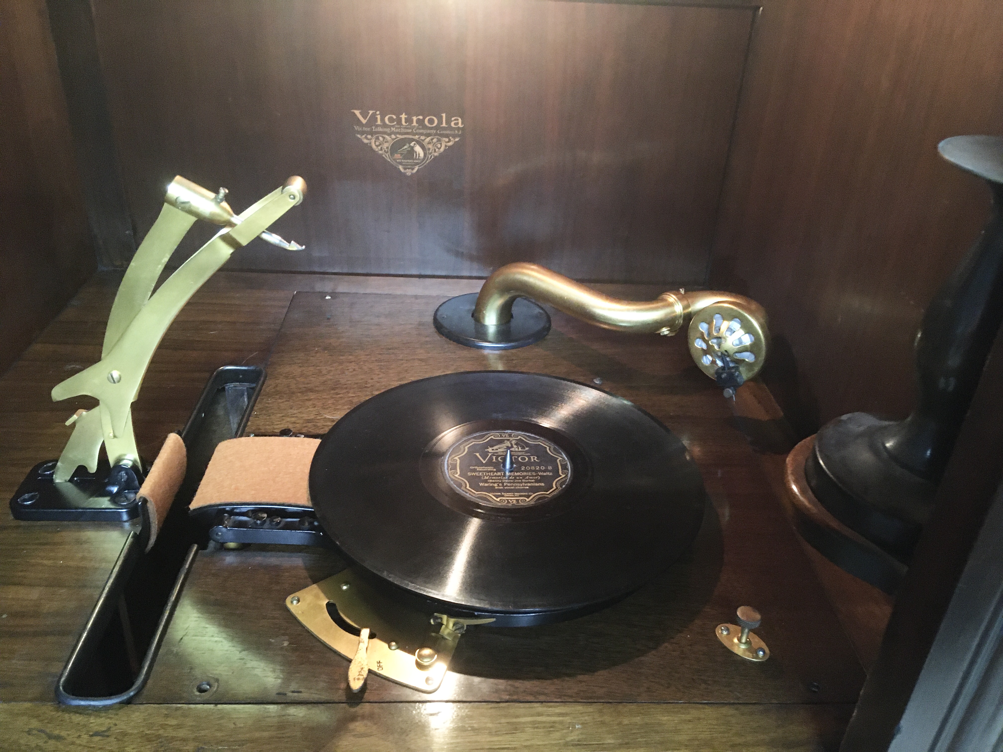

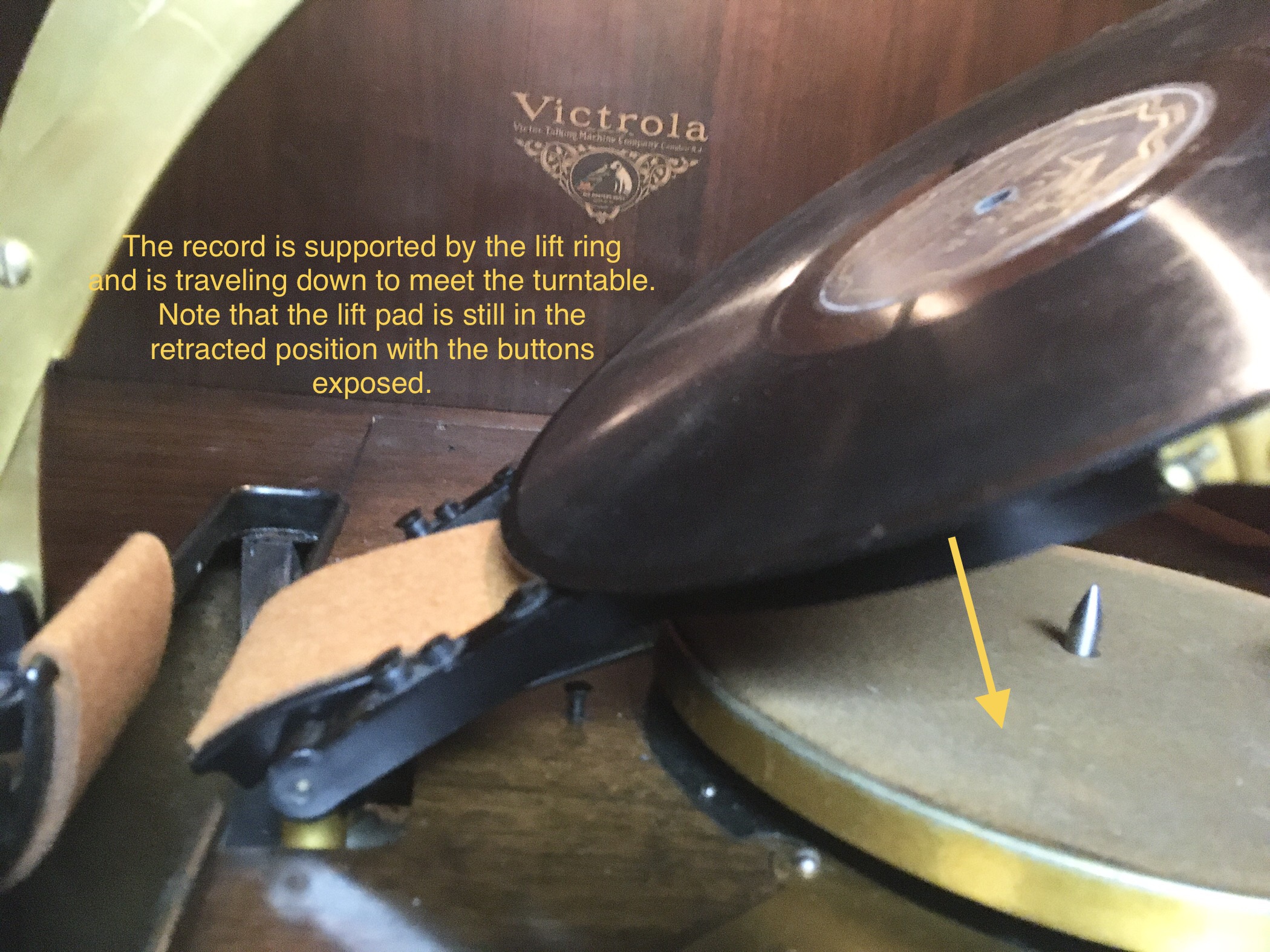

Start by placing a 10” record on the turntable. Note that the Lift Pad is in the reject position, raised.
The sound box is not needed for this adjustment and can be turned back.

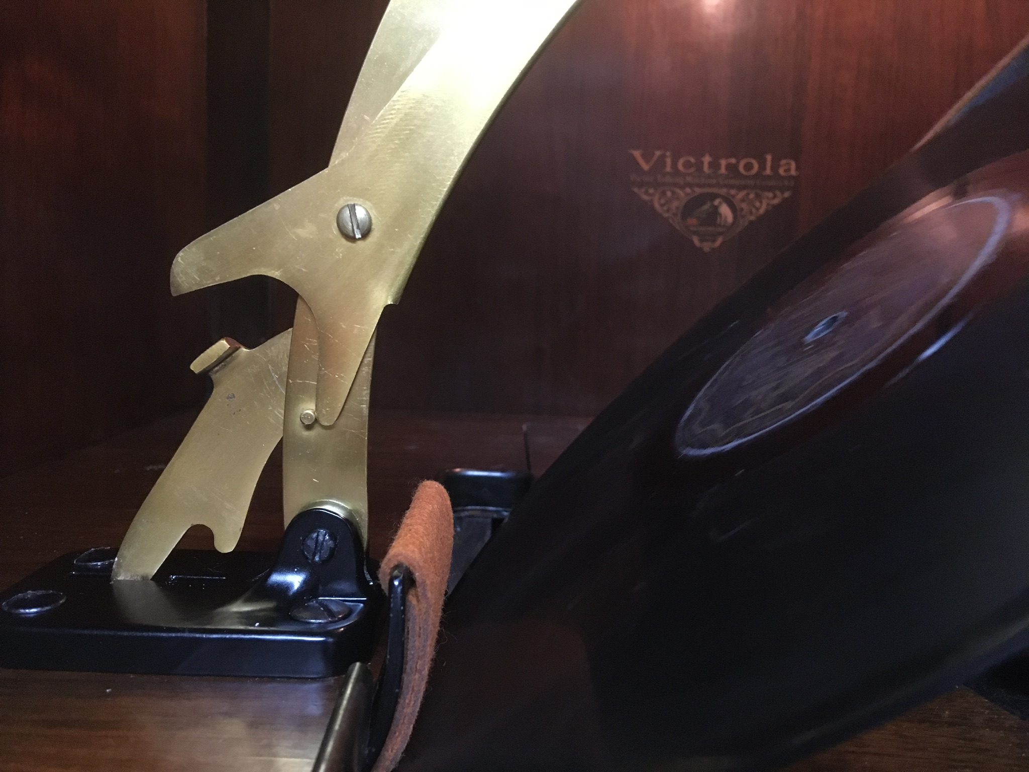

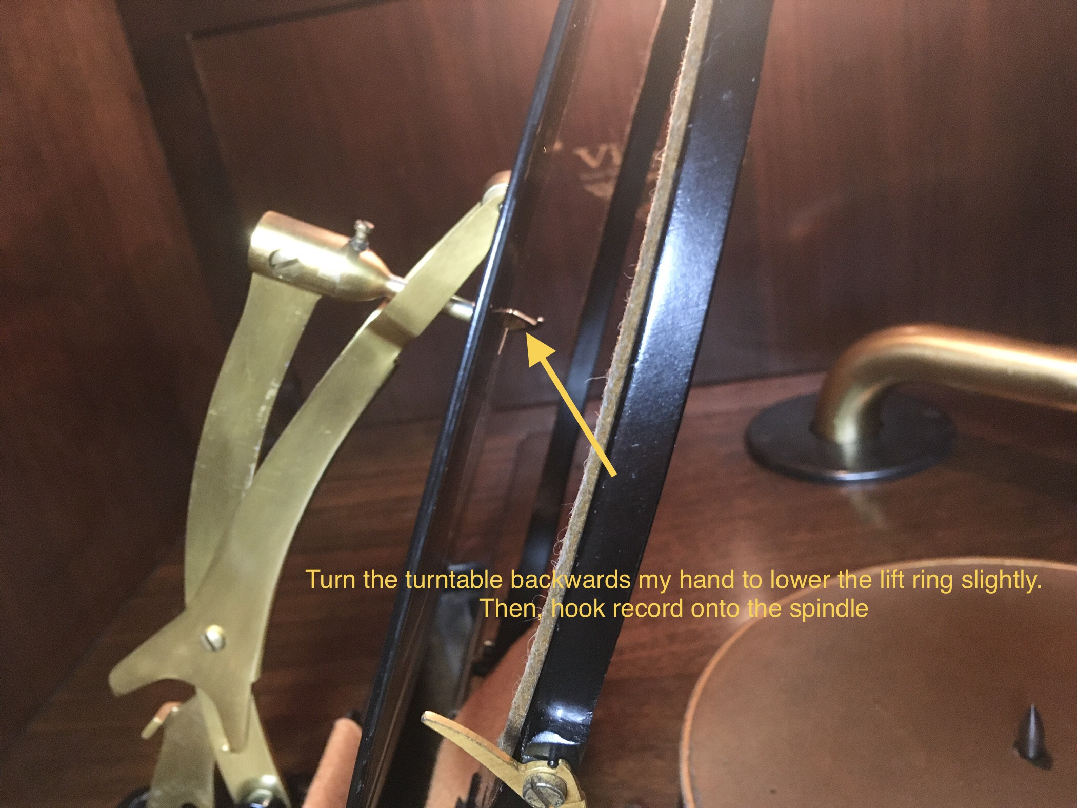

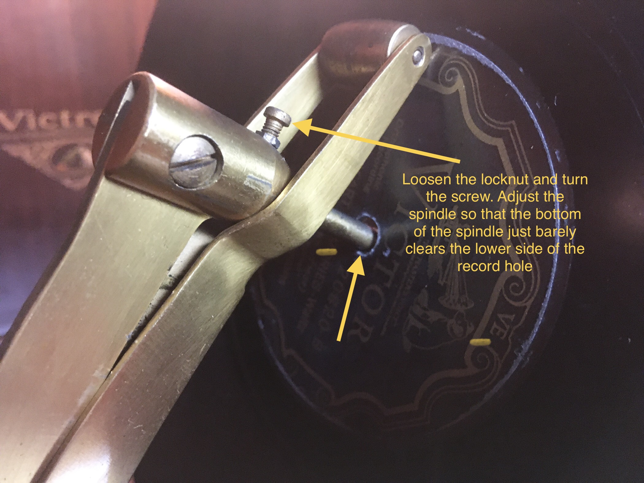

Readjust the screw on the magazine spindle slightly as needed so the record can mount the button securely.
Check that the record is removed from the spindle cleanly. The design does not allow much room for error so it might take a few trials to get it right. Retest with other records, retest with a full load of records.
Rejecting the record into the drawer!

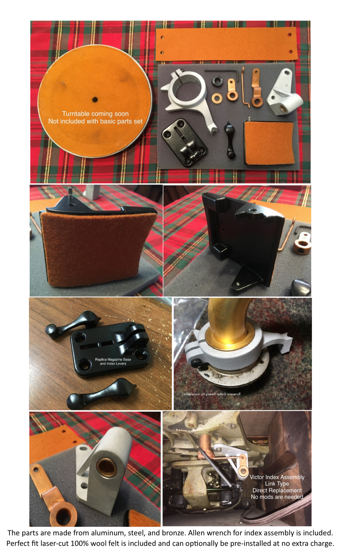

The pot metal replacement parts came out beautifully and the collectors who have been patiently waiting have given us very positive feedback. Everyone seems very pleased. Several of the changer parts were made with a manufacturing technique called “selective laser sintering” which effectively makes solid aluminum parts from finely ground aluminum. The finished parts are solid aluminum and you could never tell they were ever anything else! This new method is the only way they are remotely affordable now, it also produces a high grade part with a fine surface finish and great dimensional accuracy.. Over the last 30 years working on this project all the other methods either produced very crude parts or the parts were very expensive. The last quotes, about 8 years ago, to mill parts via traditional machining made the replacement sets so expensive that no one would want them. Close to $3000 for the set. As much as I wanted parts to restore my own machines I realized it was a non-starter. The new method really came to the rescue and allowed some extra room for the final finishing and powder coat painting. The goal was to make parts that are ready to install and I think we have succeeded.
Most of the first 25 sets have been claimed so we are planning a second group and are offering a SHOW DISCOUNT through July 15. Check in at the table for a changer demonstration and a sale flyer.

Bringing this thread back into the foreground in case there are some new 10-50 owners. So far we have sent out about 40 Victor First Style Potmetal Elimination Kits to collectors in the US and Canada and the feedback has been very gratifying. More 10-50’s seem to be showing up, about one more every month or two.
A few unclaimed parts sets remain if you have a machine waiting for restoration. The replacement parts come with full documentation and unlimited email support to get your machine working like new again.
We are always happy to answer any questions or concerns about restoring or adjusting your 10-50, 10-51, 10-70 or 9-55.

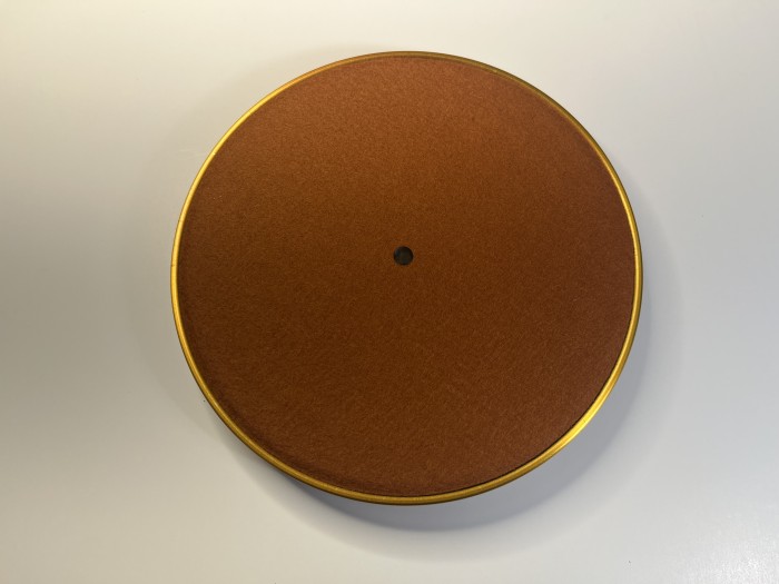

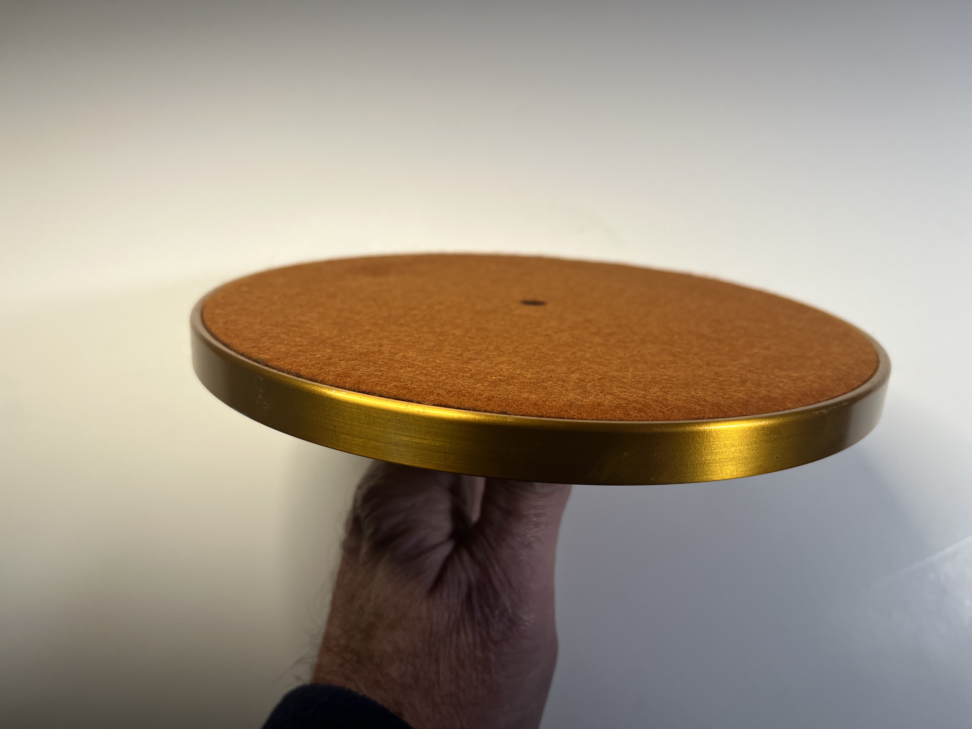

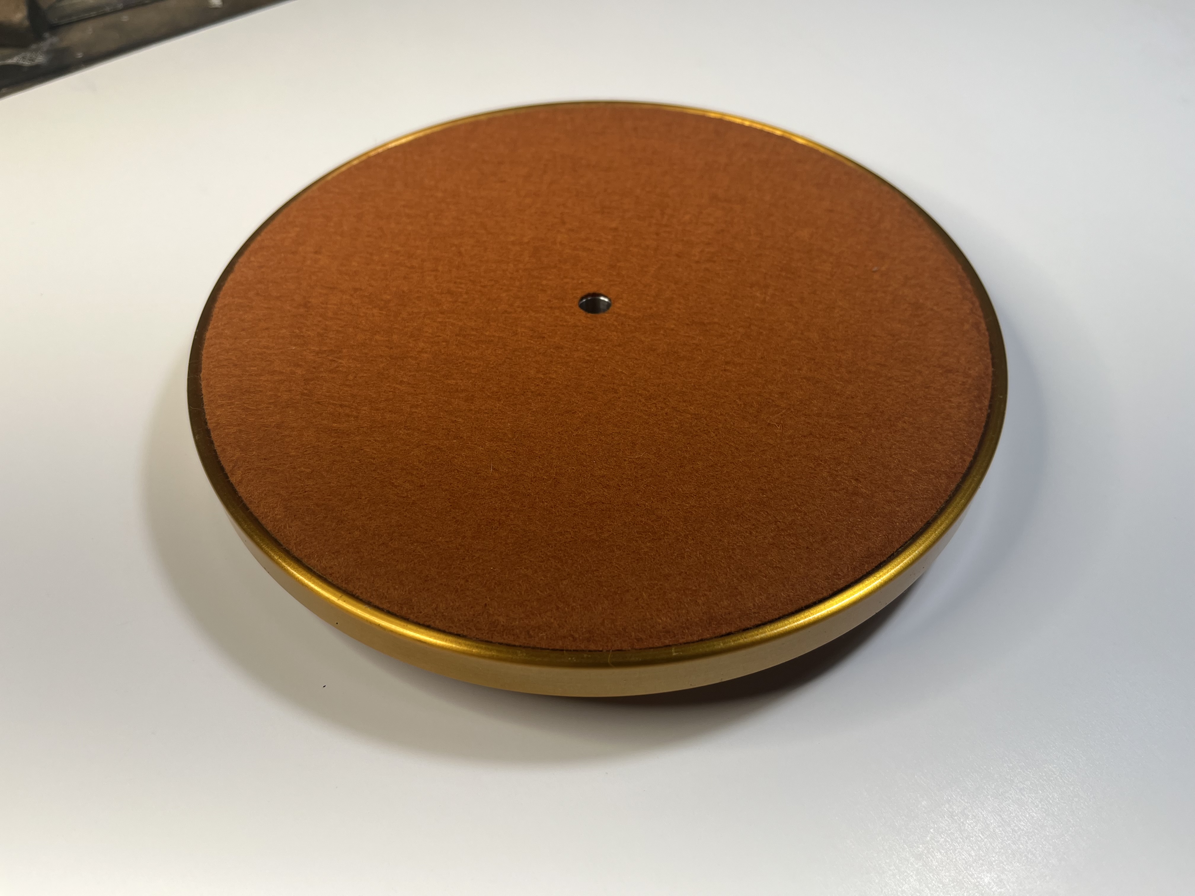

Bringing this thread back to the foreground. There have been quite a few 10-50, 9-55 and 10-70’s discovered in the past year and thought this may be of interest. We’ve sent out about 65 “Potmetal Elimination Kits” so far to various collectors, it has been a real treat to help restore these marvelous machines! The stock is running low and I’m not sure how much longer we’ll continue. It you need a set I would encourage you doing it soon while kits are available. We recently added replacement turntables to the offerings as all but the earliest 10-50’s have potmetal turntables that are often warped. Contact me directly for ordering details. [email protected]

WOW!!! The turntable looks great. Thanks for all you efforts with supplying these parts.
