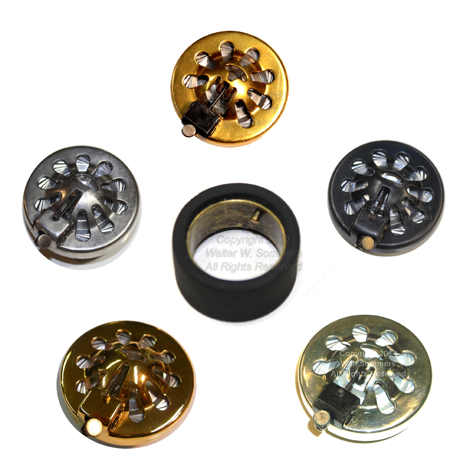

They're mounted in place by two screws in the sound box's throat, so if the pot-metal is in good condition, removing the screws shouldn't be too much of an issue. (knocking wood) Removing the collar, itself, may be a challenge if it's stuck; some careful chipping away of the hardened rubber may be needed once the screws are removed.mikeverrechia wrote: Tue Dec 23, 2025 4:42 am
Orthofan.....Is it straightforward to change the soundbox throat gasket please? Also, I like your "Rule of thumb" method of checking the spring strength.....brilliant!
Some people make a new gasket or collar out of silicone, but I know that they are available from some eBay sellers, for instance -- https://www.ebay.com/itm/366060593083?c ... =view_item OrthoFan
