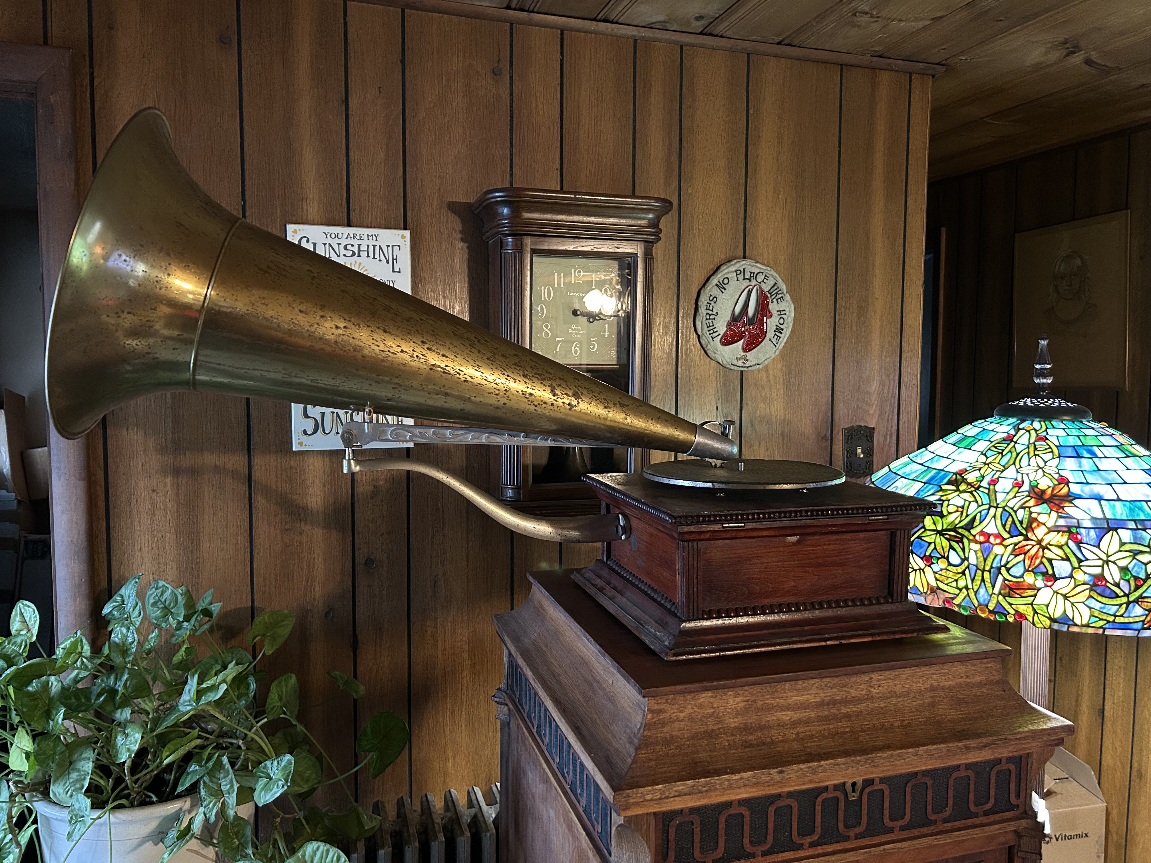

Have not been on the forum for quite a while. Been doing a lot of metal detecting so my phonographs were put on the back burner. However got the bug again since it’s a frozen mess out there and I bid on and won a Talk-O-Phone last night at a local auction. Never owned one but this one is in exceptional condition except for a broken mainspring. Looking forward to replacing it and hearing it sing again. The horn only has one small dent but has blackish tarnish spots. Would you clean them, is yes how or leave it as it is?

Nice looking machine. If mine probably would polish up the horn. If it had an even patina without the blemishes would most likely leave it as is. What is the length of the horn and bell diameter?

Horn is 29” with a 13 ½ bell diameter. I am leaning towards polishing the horn although not sure how to do it without leaving polish marks

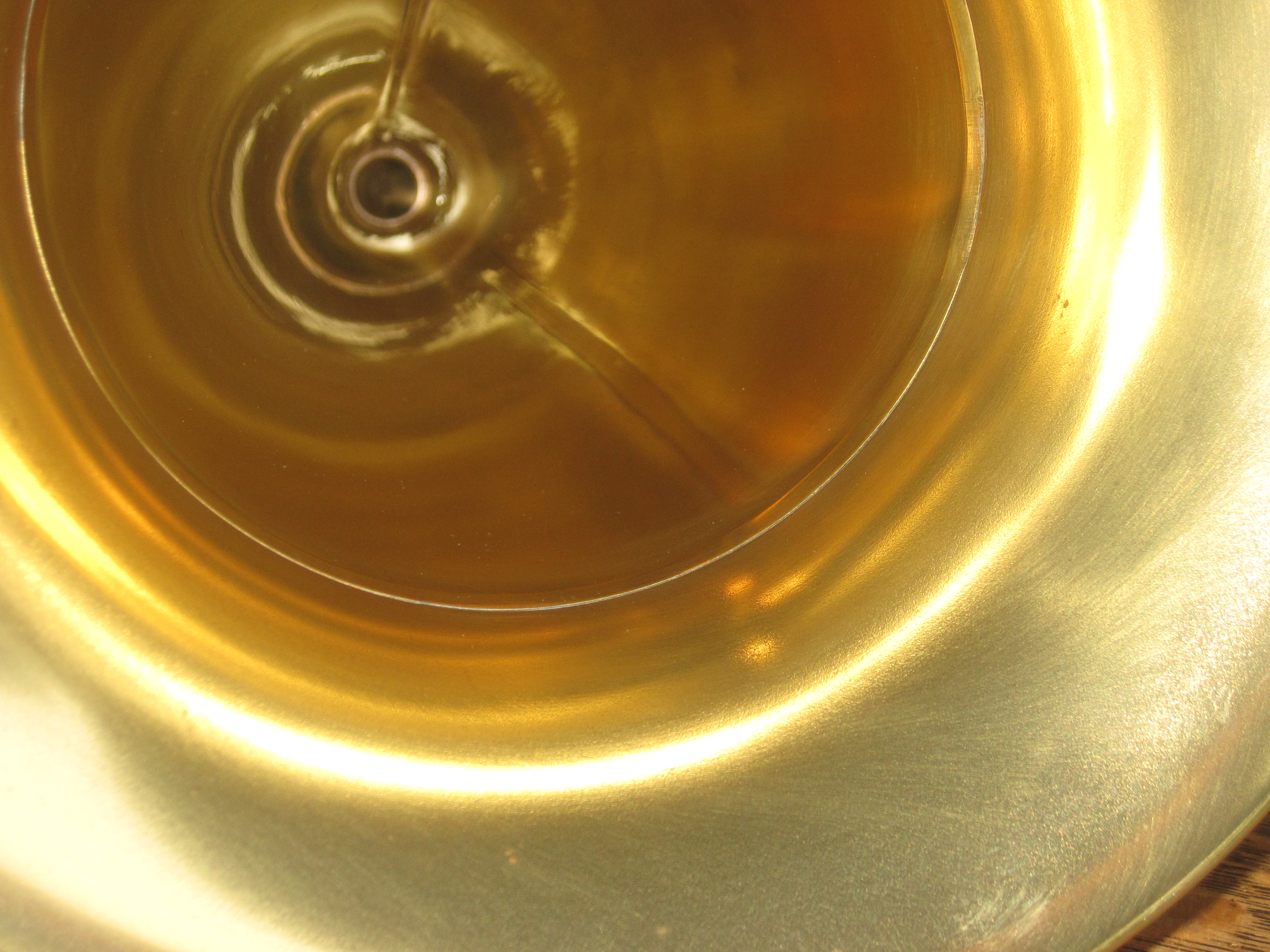

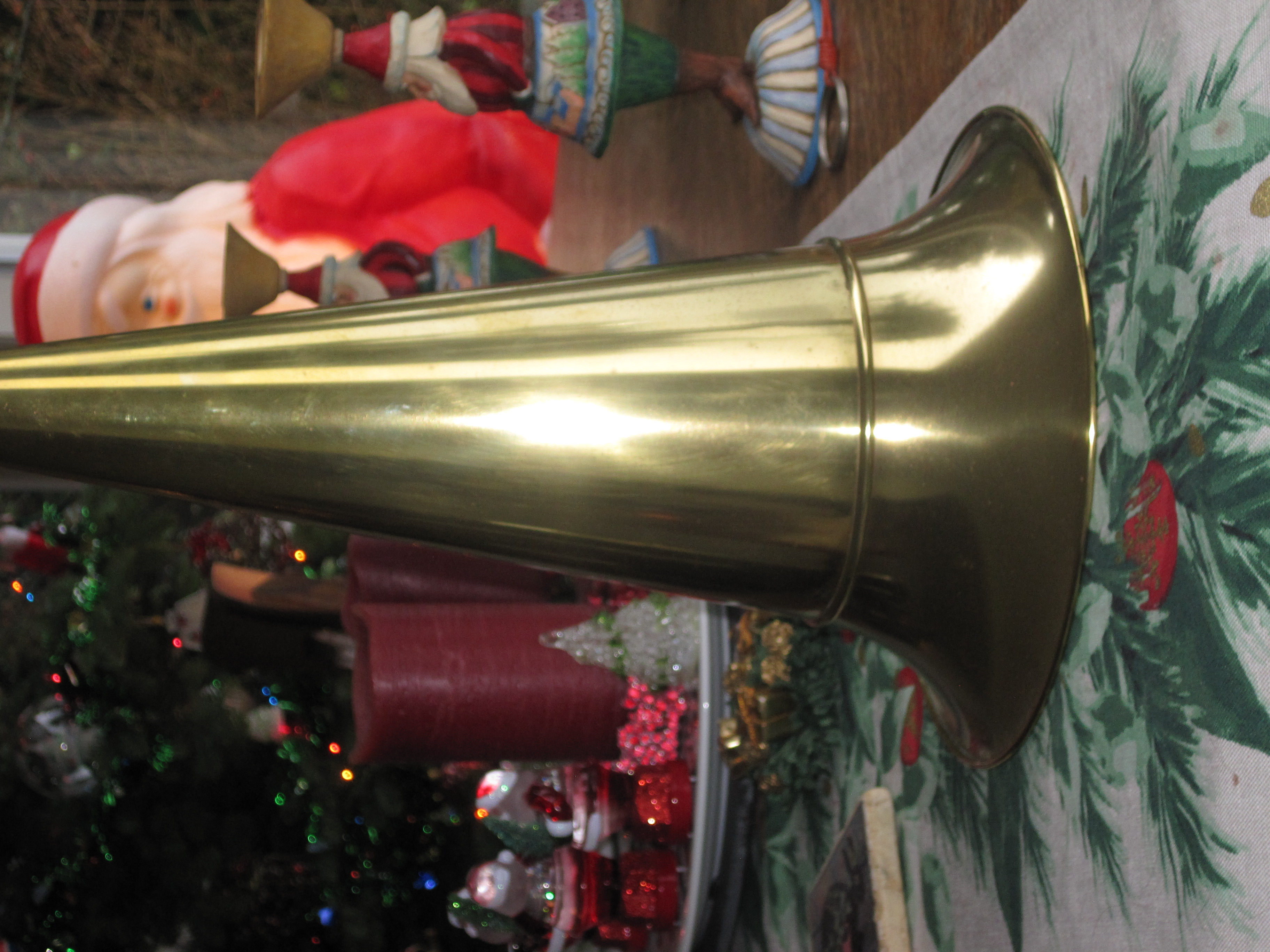

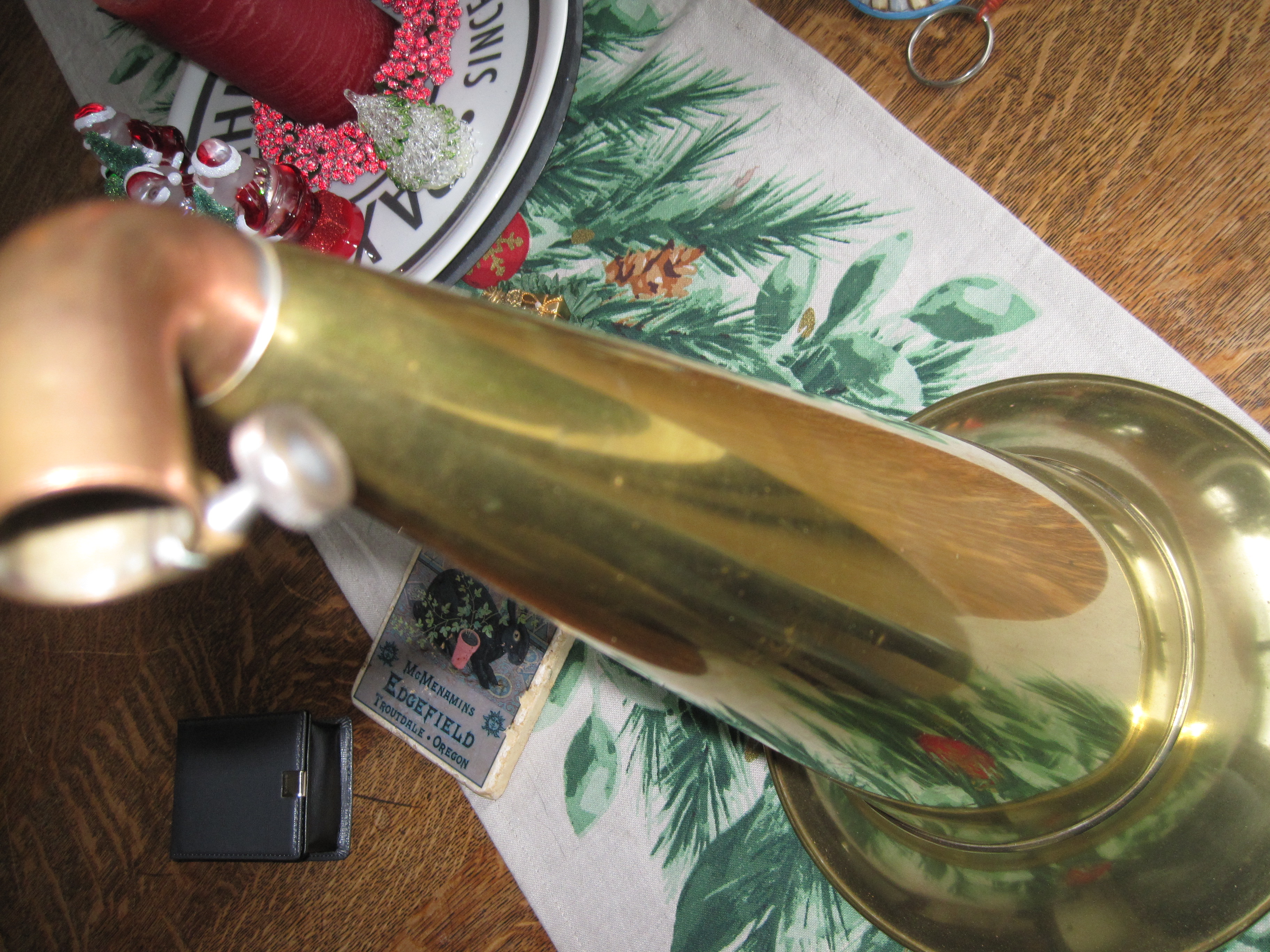

Kevin Clark
Posts: 167
Re: New to me Talk-O-Phone
Post by Kevin Clark »
Was wondering how long it would take for someone to post, never use steel wool on a metal horn. As a general rule of thumb this is correct. When using just paste the discoloration spots can be very difficult to remove, plus the additional rubbing on the horn puts additional stress on it. Earlier this year I used 0000# steel wool and mothers metal polish on a repro Zonophone horn that had a very heavy patina, discoloration and some sort of crud on it. A final polish with just the paste and a soft cloth gave me a result I was happy with, at least to my eye. Hard to really see in the photos if there are any scratches from the steel wool. Under magnification one most likely will find something but by the naked eye looks to have a nice polish. The elbow turned out to be copper but looked to be brass with the same heavy patina as the rest of the horn. Can see some fine polishing marks on the inside of the bell but can polish it out better with just the paste. So yes steel wool is not generally recommended but can provide good results if done with the right grade of steel wool, polishing paste and effort.
