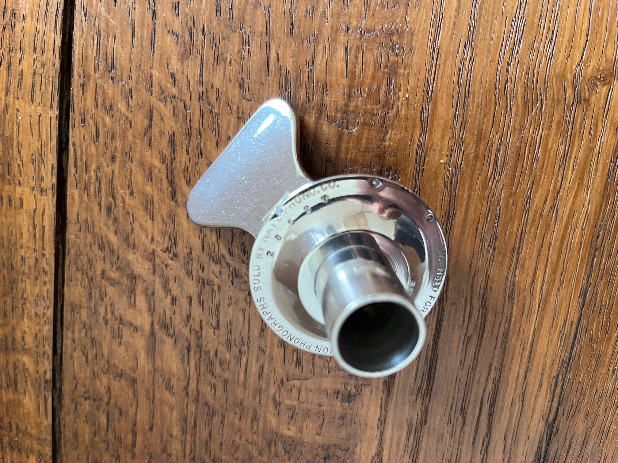

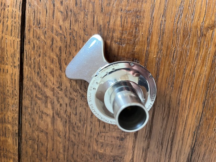

Here is a different style clip that came in on a U.S. Phonograph Co. Spring Motor.

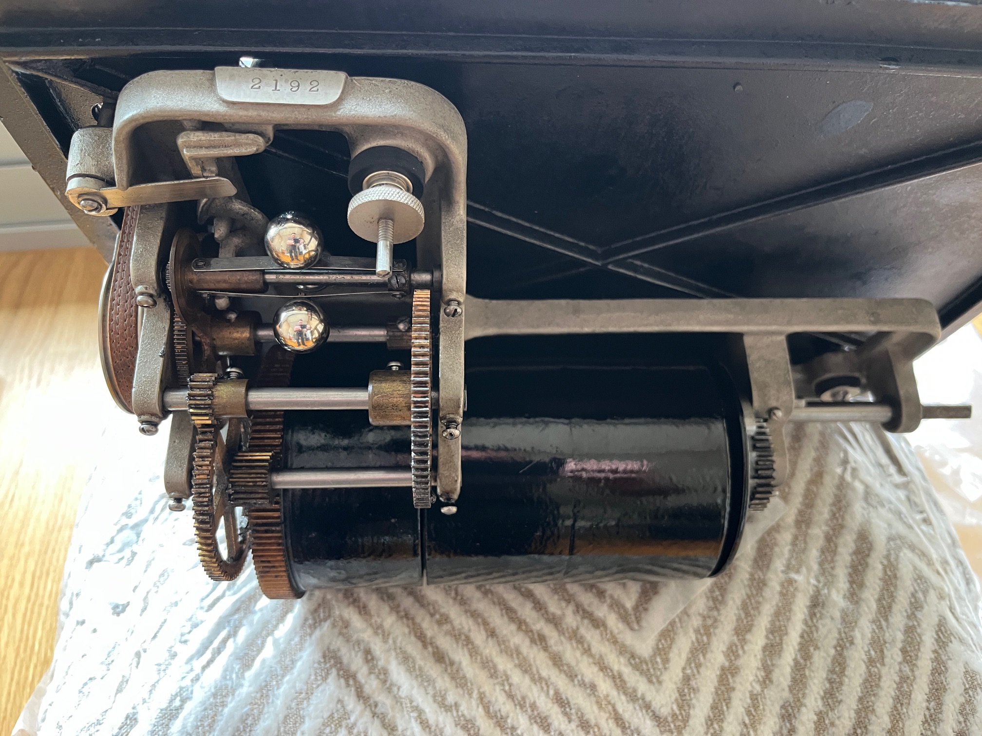

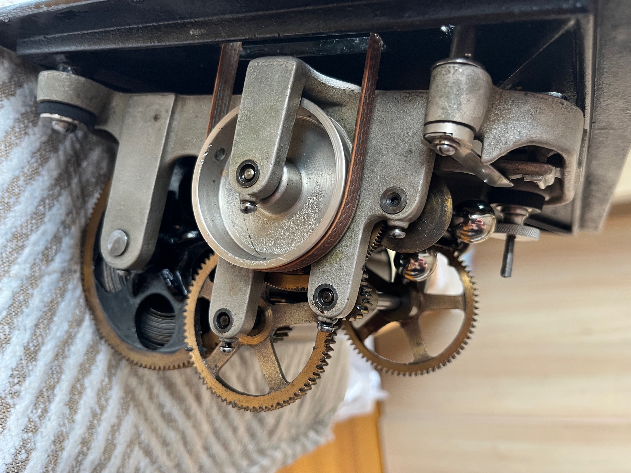

Re: Edison Spring Motor
Post by Aristophane »
Aristophane wrote: Fri Feb 06, 2026 6:42 am
phonogfp wrote: Wed Feb 04, 2026 2:58 pm A very nice example of an earlier Edison Spring Motor!
It's difficult to date these as specifically as the Gems, Standards, and Homes, but yours can be dated with confidence to 1897; probably the latter half. Your machine's motor should have spherical governor weights and spoked gears - signs of the U.S. Phonograph Company motor.
Thanks for posting!
Thanks. I will take some pictures of the motor this weekend and post them.
phonogfp wrote: Fri Feb 06, 2026 11:20 am
JerryVan wrote: Fri Feb 06, 2026 9:14 am Mine is 24380. Maybe yours and mine knew each other at the factory :)
Maybe, but the Spring Motor was a slow-moving machine at that time. Selling 60 of them may have taken a couple of months!
Andersun wrote: Fri Feb 06, 2026 4:32 pm An Emerson clip is a device that makes it easy to take off and replace reproducers. The factory used brackets with 4 screws to hold the reproducer on. Your clip is missing a small piece that acts as a stop when rotating the clip. The United States Phonograph Company used them and stamped their name on them. See pictures provided.....
Thanks, oh, yes, missing is the little part... Not sure I can find one, it's so small. I have another other reproducer et a recorder but not sure they not sure if they are contemporaries of this spring motor

JerryVan wrote: Fri Feb 06, 2026 9:09 am
Aristophane wrote: Fri Feb 06, 2026 6:44 am
Andersun wrote: Wed Feb 04, 2026 4:37 pm That's a beauty! Has an Emerson clip on it too. What's all in the drawer? I see a screw driver....
Thanks, not sure what is an Emerson clip? There are 3 screw driver in the drawer. Not sure about the paper because it's a bit worn. I will look at it and let you know
The Emerson clip is the "question mark" shaped clip that retains the reproducer. I believe it's the far less common style.
Ah! Merci
Aristophane wrote: Sat Feb 07, 2026 5:52 am

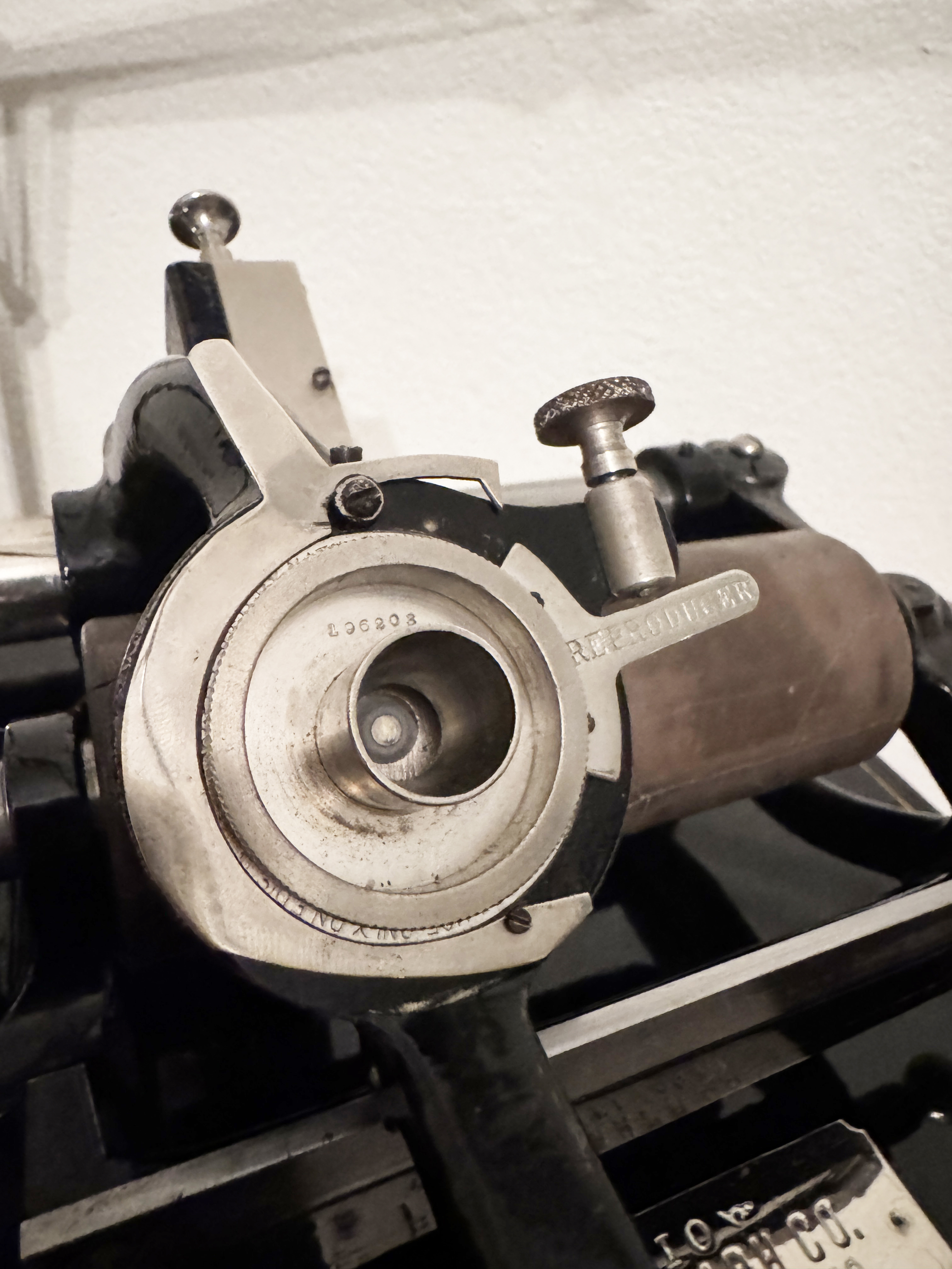

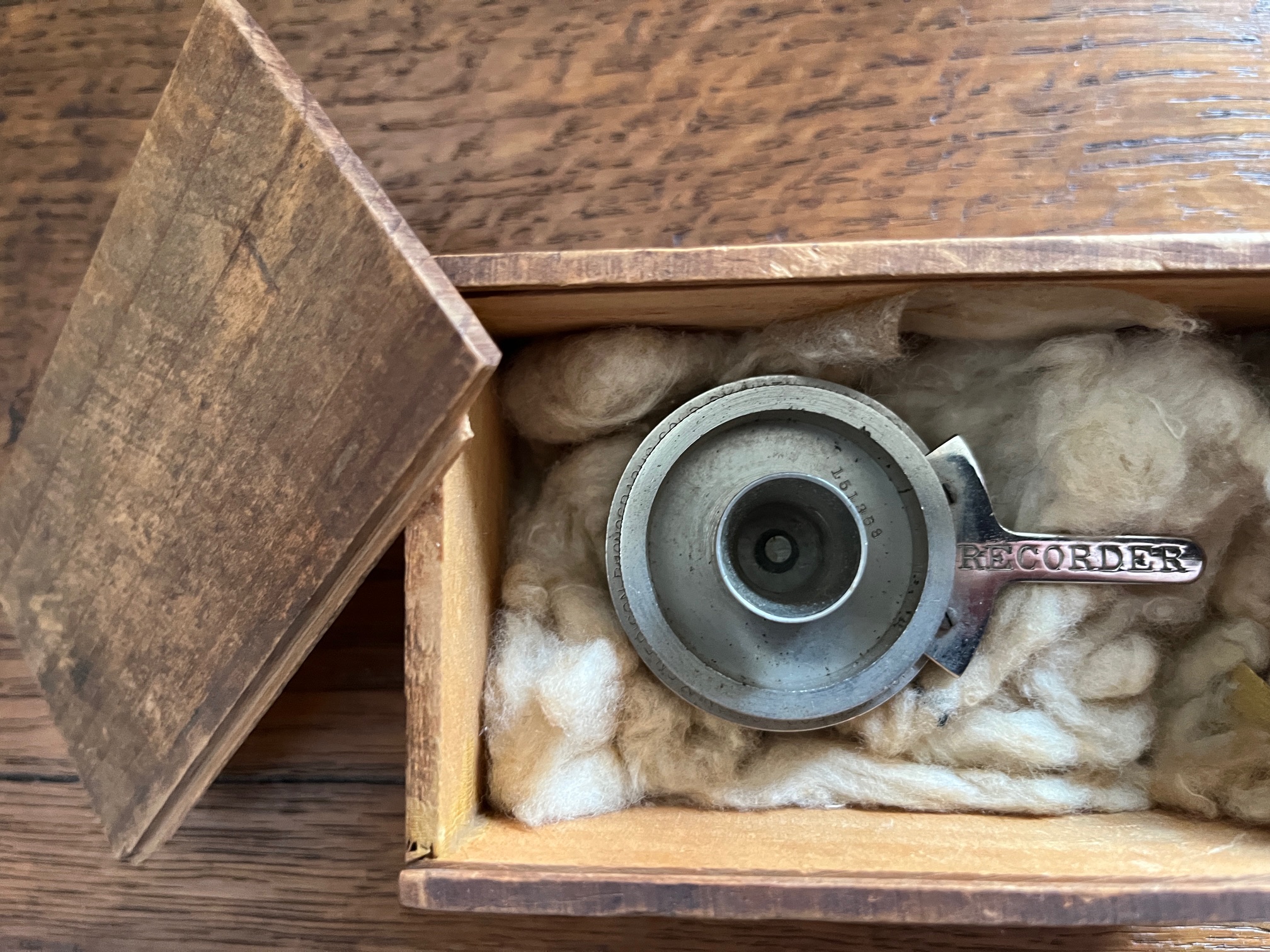

Aristophane
Posts: 20
Joined: Tue Apr 08, 2025 10:40 am
Aristophane wrote: Sat Feb 07, 2026 6:00 am
oups wrong picture... better now

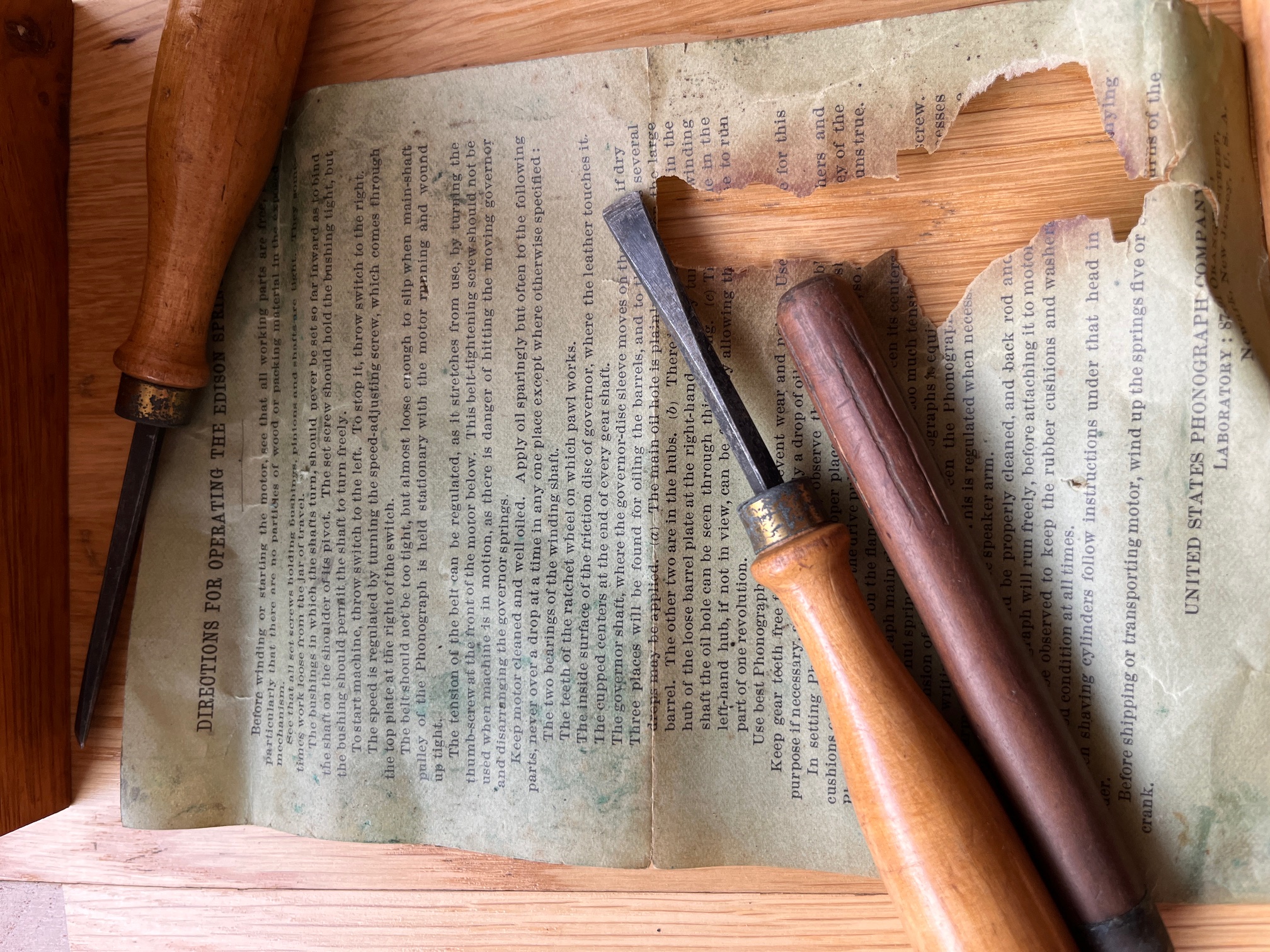

Aristophane
Posts: 20
Et voilà !

Online
Posts: 8260
Prior to Edison absorbing the United States Phonograph Company in October 1897, the latter company was Edison's sales agent for Homes and Spring Motors. Sales were quite sluggish. As noted in The Talking Machine Compendium, only 774 machines had been sold between March 1, 1896 and February 28, 1897. National Phonograph Company's total sales (including records) for this period was $103,565.29. National's sales from March - December of 1897 (the period from which our Spring Motors originate) was $110,673.23. From this, we can estimate that machine sales for 1897 were not significantly higher than 1896.
Based upon my research on Spring Motor/Triumph Phonographs (noting production benchmarks), I believe that Spring Motor #24671 dates from November 1897. I wish we knew monthly production figures, but this is as close as I can come to estimating the age of Spring Motors from this period.
