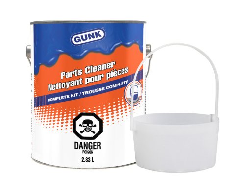

Next I need to get a clean paint tin or something similar in which I can immerse the drum in solvent and leave it sealed up in the tin for a long while. The grease isn't as much waxy as it is grainy. The graphite seems to have formed chunks.
In the US anyway, auto parts stores sell solvent/carb cleaner in gallon paint cans, with a strainer basket inside. If that's available in Canada, it may be just the thing for you.

JerryVan wrote: Mon Feb 16, 2026 5:04 pm
Lah Ca wrote: Mon Feb 16, 2026 4:48 pm
Thank you.
This type of convenient seeming product does not appear to be widely carried here; however, I can find Gunk's version at Canadian Lordco stores.
2026-02-17 06.39.17 lordco.com 66fe445d3e9b.jpg (26.15 KiB) Viewed 1717 times
Unfortunately, it costs $90.62 CDN (which at today's exchange rate is about $66 US).
The most effective solvent I have found from among the many I have now tried with ancient hardened grease is white-gas/naphtha/camp-stove/lantern fuel. I assume that there are probably better solvents (or at least widely divergent opinions on this matter ;) ), but from all the numerous ones I had readily available, it was the absolute best.
I can buy a large tin of it for under $40 CDN. It is usually part of my emergency supplies kit. My existing tin needs to be used up now anyway as it is stored in an unheated shed and its metal is beginning to rust. There haven't been any emergencies (or camping trips recently). ;)
Most paint stores sell empty tins. They were extremely cheap the last time I bought one, but in today's climate, who knows?
WOW! I find it locally for $40 US, which I would have thought was expensive... but not now.

A sign of the times. A sign of the times.
