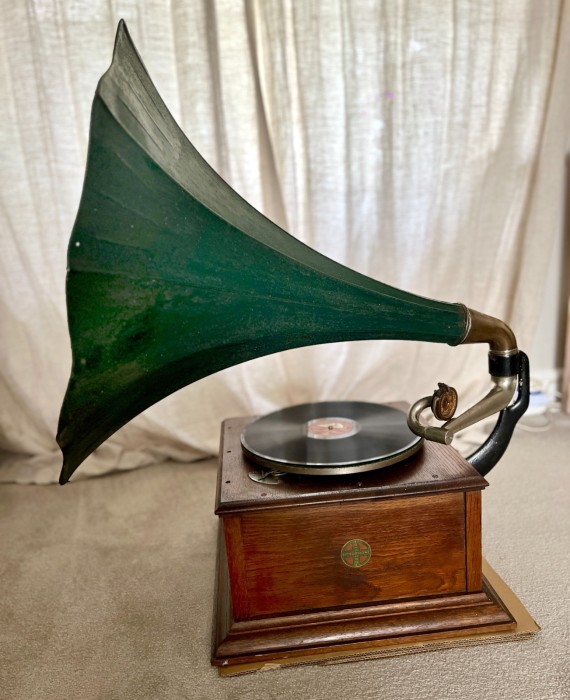

So what has happened here???
I don’t have the HMG book to hand so I’m not sure if this is an original Zonophone base that fell apart at sometime and the sides were put back in the wrong order as the winding handle is now on the wrong side and the trademark should be at the front. It certainly appears to have lost the top moulding underneath the motor board. Alternatively it started life as a hornless model with new panels added to disguise the entry and exit of the internal horn. That being the case it is strange, perhaps coincidence, that its back bracket and horn would be correct for a late Zonophone horn machine.
All the same the late Gramophone Co. back bracket complete with tonearm and plug in elbow are worth the money especially with the, albeit rather poor, MG horn. A Saturn soundbox is a bonus as is a working motor and fittings.

Wow - very interesting indeed.jamiegramo wrote: Fri Mar 20, 2026 7:25 pm So what has happened here???
I should buy it, Stevenage is close by.
Thank you for so much great information.
I hope that you do buy it and reveal a few more of it's secrets !
