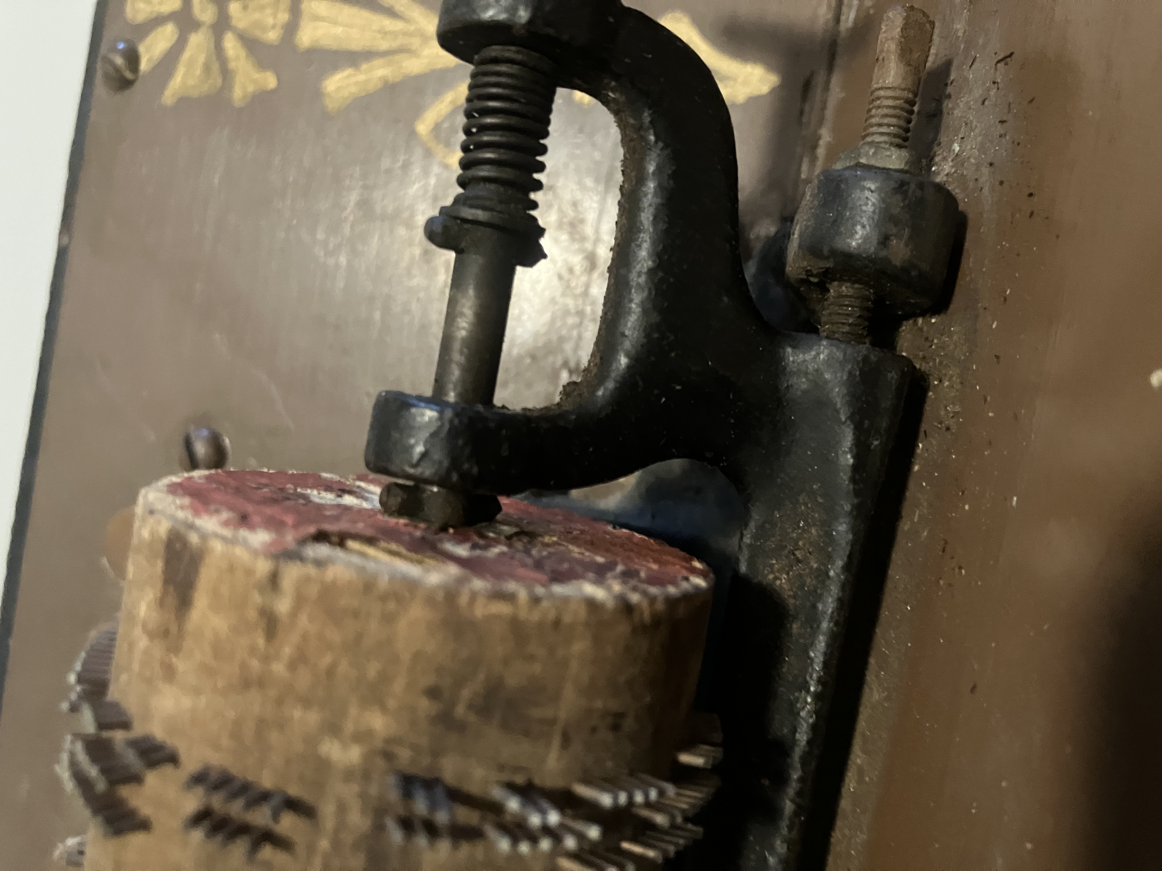

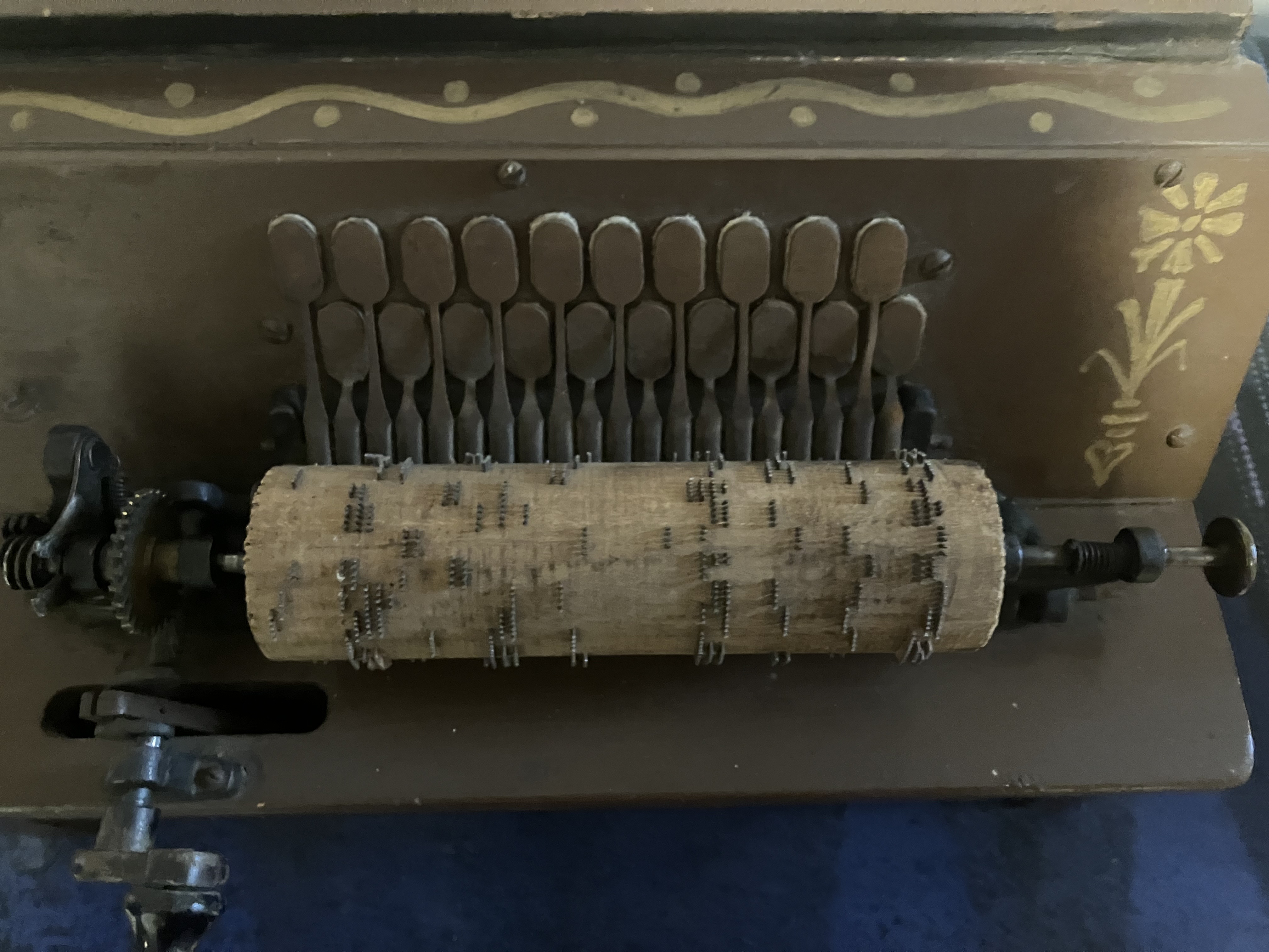

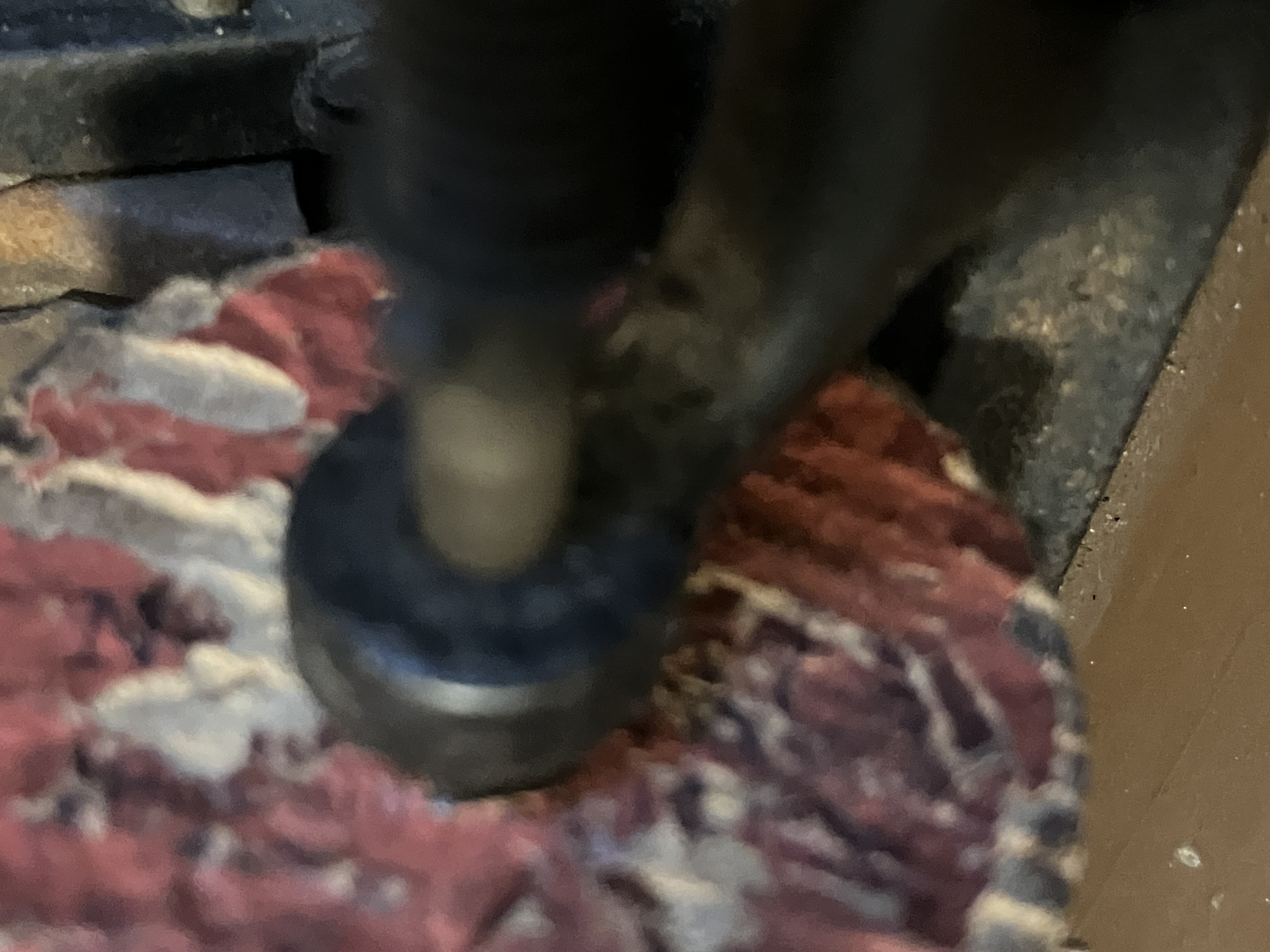

Thank you both for the guidance. I played the cob until I heard the "click" and saw it jut to the left. However, while pulling on the stopper and pushing the cob to the right, it still isn't coming off, it creates a lot of room on the left side including the second hole used as a guider, but the cob still can't be removed.
Sam Seka
Posts: 4694
Re: Roller Organ Cob Removal
Photos or a video would be most helpful...
paradroid1793
Posts: 387
Personal Text: His Master's Voice
Location: Midland, Michigan
Post by paradroid1793 »
Inigo wrote: Sun Apr 12, 2026 4:52 am Photos or a video would be most helpful...
There's 3 attached, give the forum a minute to load, it's been very slow recently.
