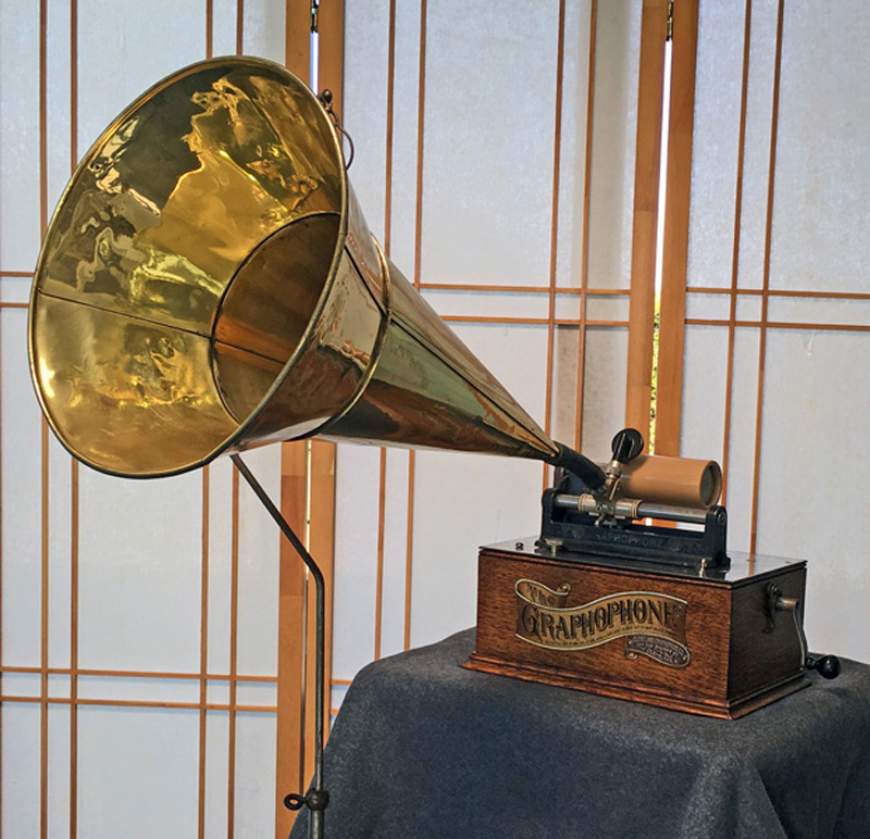

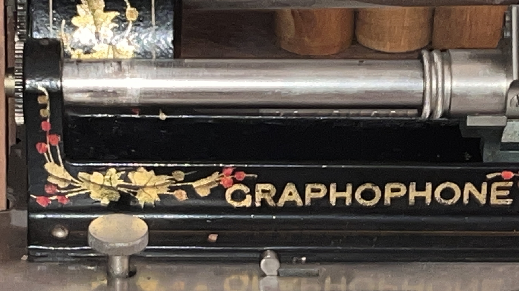

Added a Columbia Type AN to my collection Serial Number 70015. I understand these originally were offered late 1896 maybe first of 1897 but for how long did they offer them? I think it is about ⅔'s up the serial number ladder for AN's and I know they share serial numbers with the Type A's both Washington and New York varieties. My serial number tag says New York on this one and the upper works while faint has gold leaves and red berries. Just trying to get a feel for what the end date was for the AN, or even the A's for that matter. I understand from the Hazelcorn book these were more or less made to burn off inventory of parts. Were they still selling them come 1898-99 1900?
Hard to do Google Searches successfully on some of these types of machines since it thinks A and AN are words not descriptors....

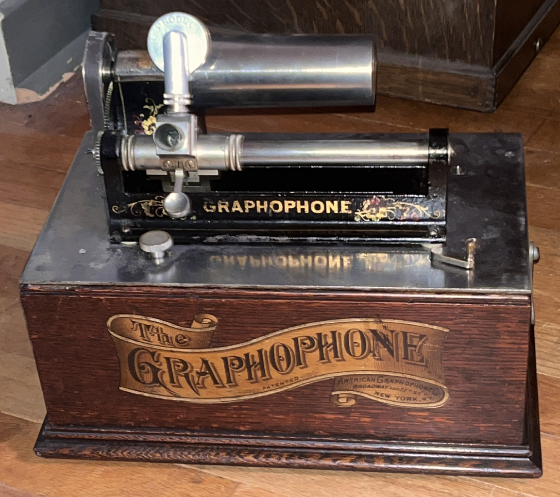

Here's mine, with a wonderful metal dealer tag from the Cleveland Graphophone Co. The serial number is 73607.

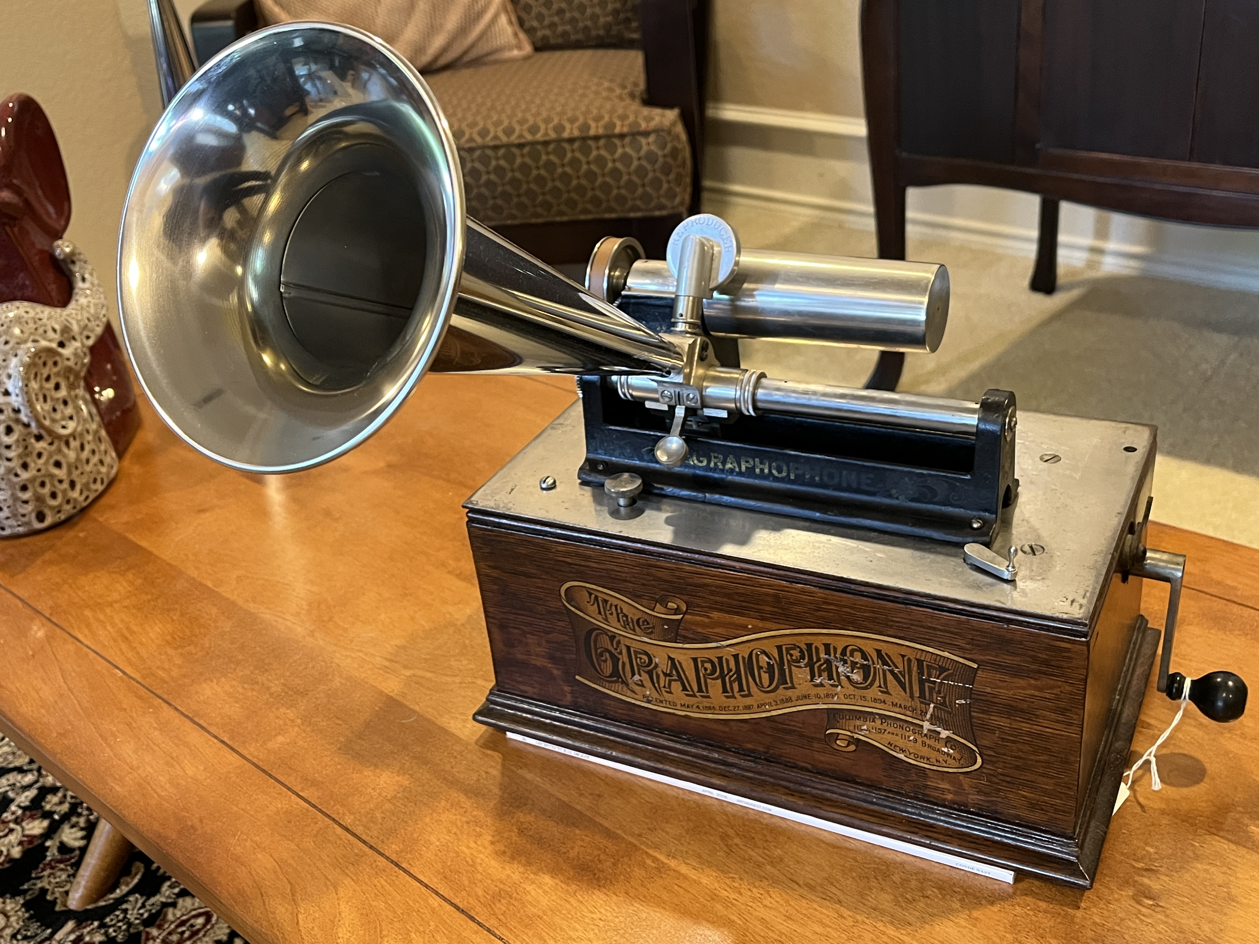

You have the NY chassis on your machine. I've seen a few AN's and all I've seen have NY chassis with the flowers and vines.Couch Potato wrote: Mon Apr 20, 2026 2:34 pm My serial number tag says New York on this one and the upper works while faint has gold leaves and red berries.
The Washington chassis looks like this: The other thing I have noticed is the case coloring, I've seen them in light oak like a normal A and also in a dark oak finish.
Mine is dark oak finish, serial #60432
Chuck

ChuckA: Yes, I stand corrected mine does have the NY Chassis. after closer inspection, I must have gotten carried away with the red berries still present on my on the back and side of the chassis. Your chassis is pretty exquisite and I appreciate you sharing pictures.
