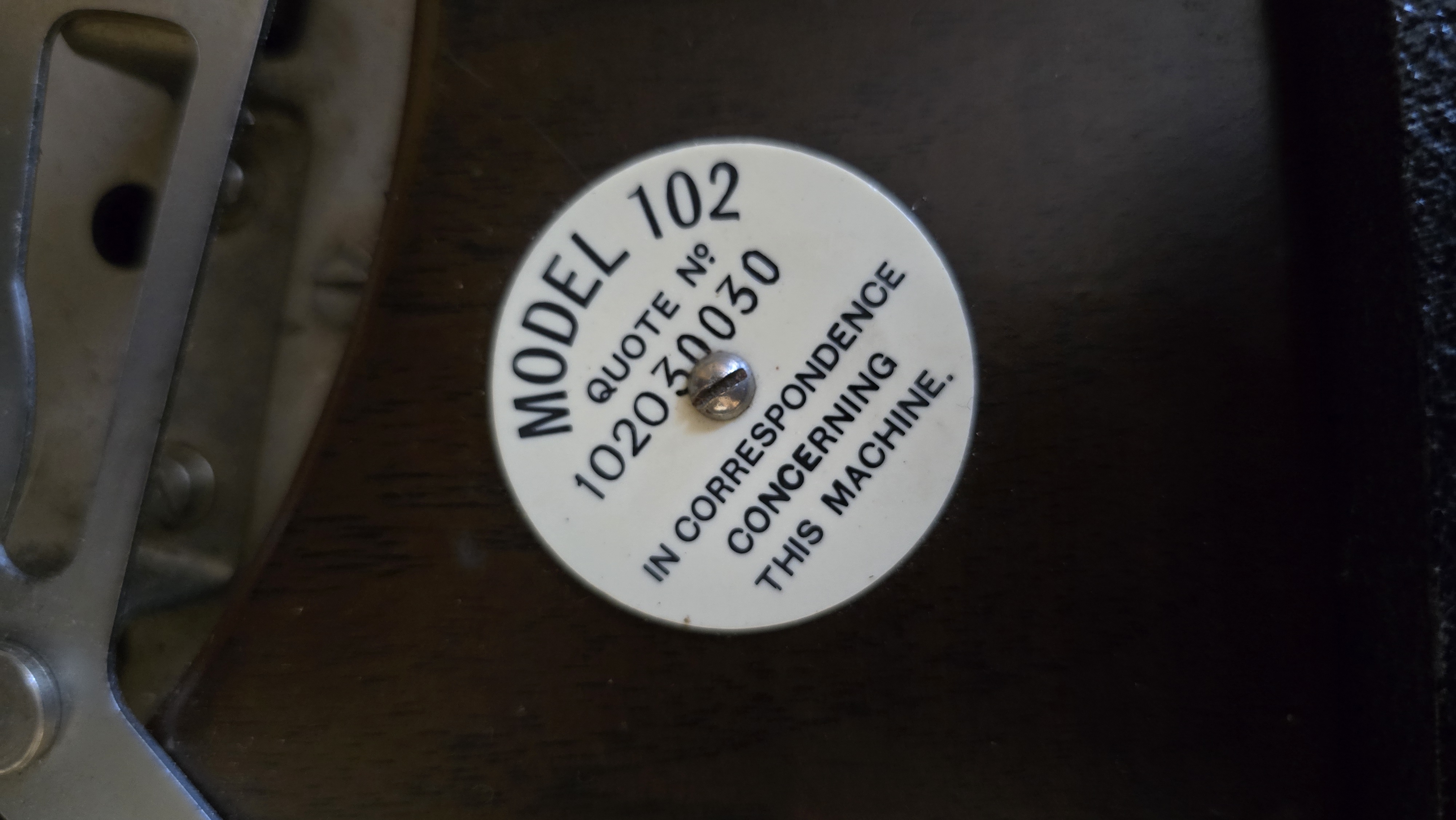

Does it have a metal motorboard? If so, its an early version and the No. 16 is probably correct for it. What is the model / serial no.?
A photo would help!

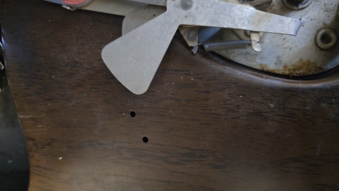

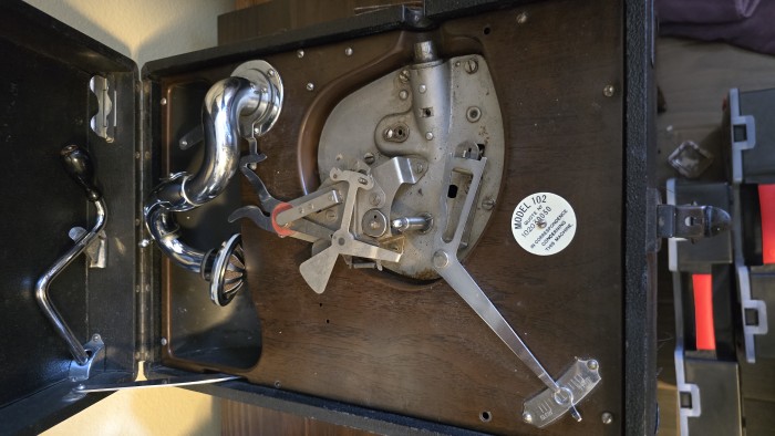

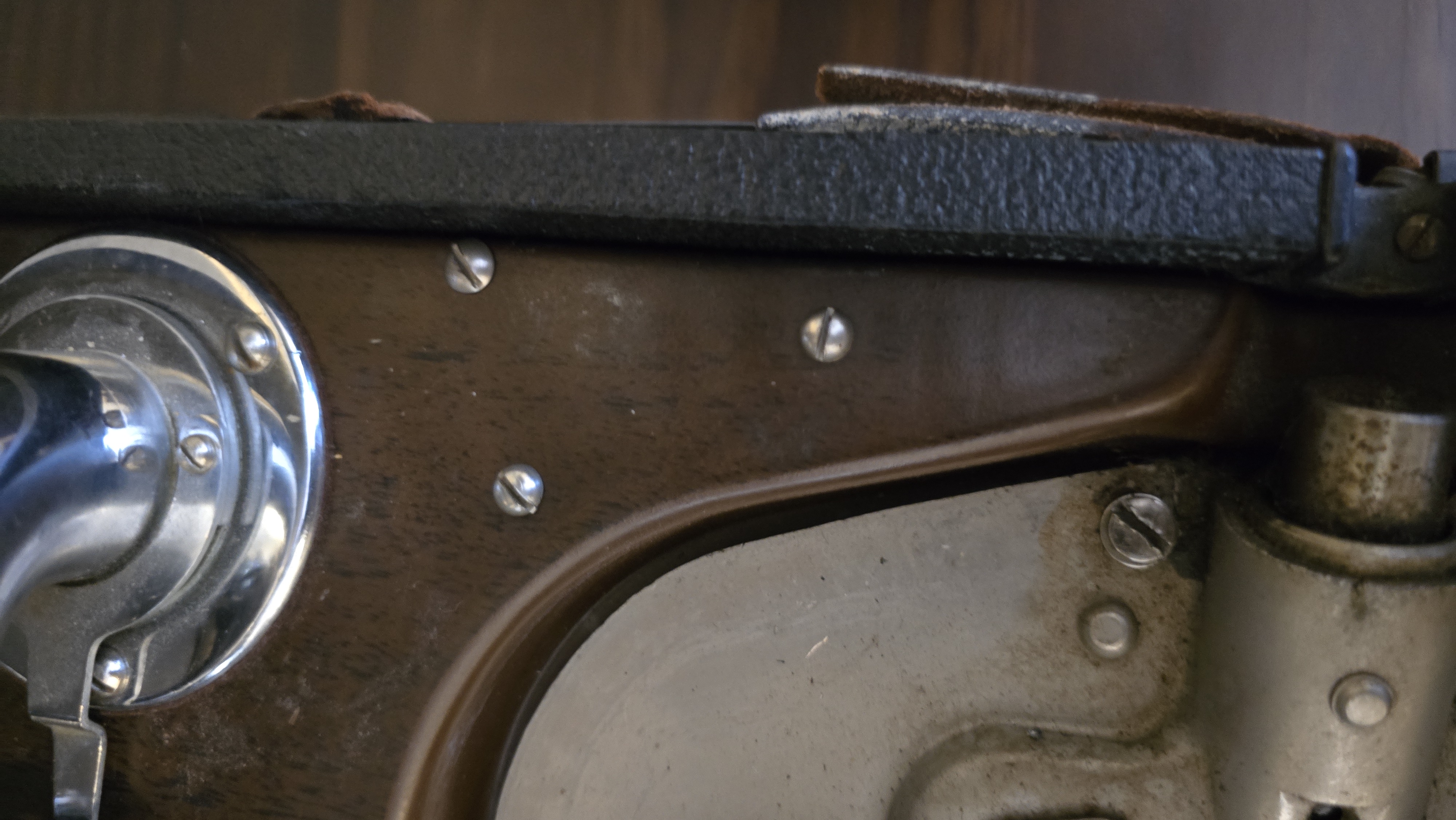

Here are some pictures that I should have posted. I believe that even though it works its probably missing some parts. The brake and maybe some parts of the auto break since there are two small screws with nothing underneath them and the two chrome pegs are also missing.

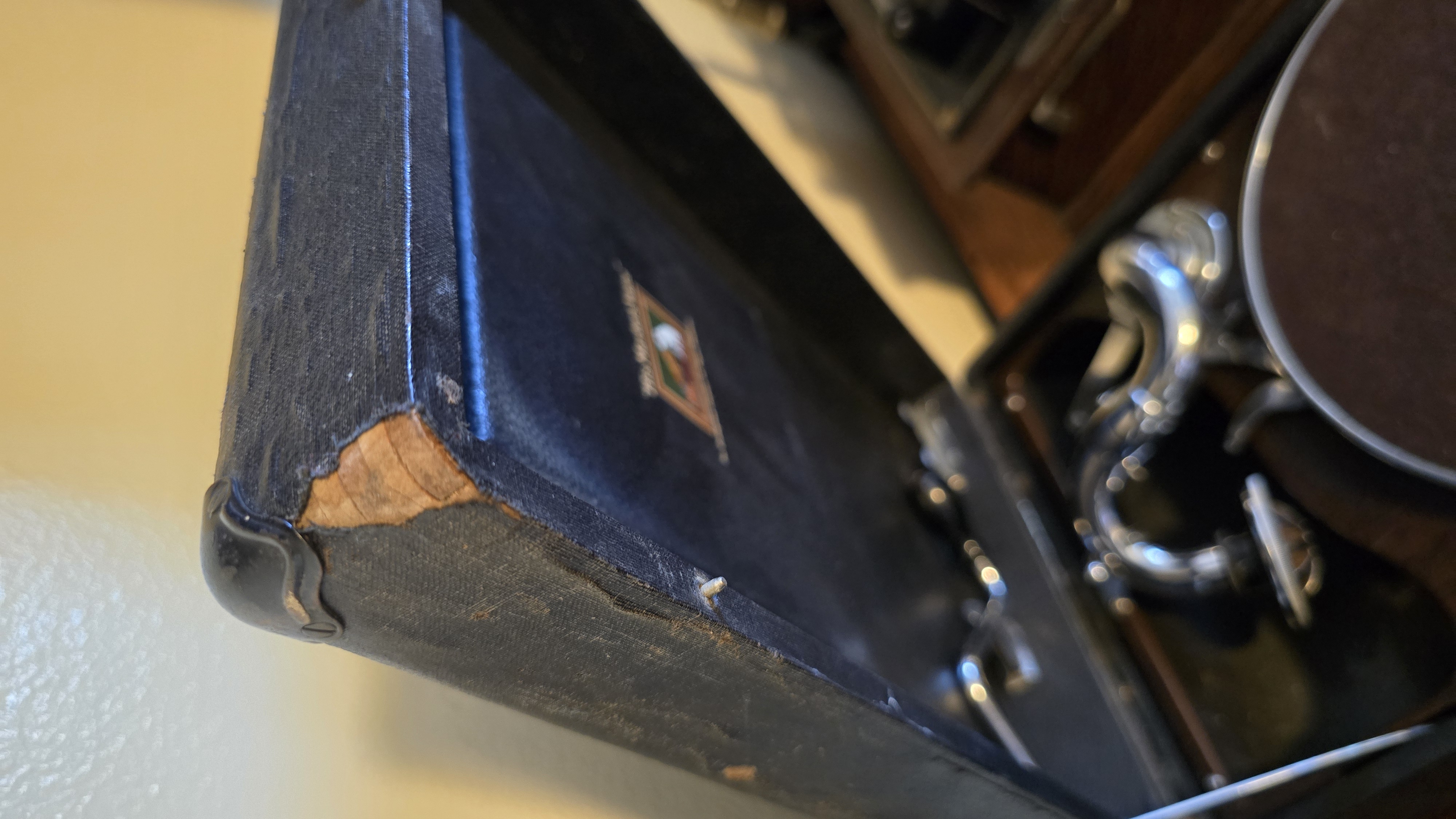

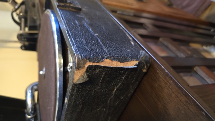

Here is where I need to replace the missing cloth that has fallen off.

That's the earliest, and apparently, most problematic brake you've got there. The No. 16 soundbox would definitely have been fitted to it originally.

The "Universal Autobrake" fitted to the earliest 102's proved to be unreliable in service. It was quickly replaced by a simpler design which included a manual brake. Many early 102's have had manual brakes added, and the two redundant holes in your first picture are probably evidence of this.

Ok that's understandable but now I have to find a manual brake too. I really would like to know if anyone has fixed the missing cloth issue. It would display much better with that fixed. Any suggestions?
