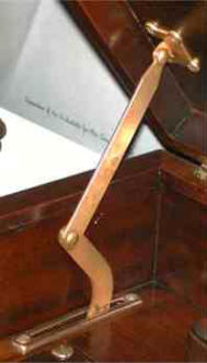

I take it this just has a conventional sliding lid support lever--
-- as described on this page -- http://www.victor-victrola.com/lid%20Support%202.htm ?
On the larger models, a double, spring loaded lid support was used --
--but I don't think the Consolette was ever fitted with that.
