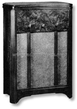

Hey there Greg, the old teacher in me brings out the visual aids.....

Thanks for that RCA ad pic, Lenoir. I don't have a picture of the R-99, but attached is a color pic of the D-22. Note the two big speakers visible behind the grille. The record changer is inside the top of the cabinet. This is a massive set.
RCA model D-22 radio/phono.
