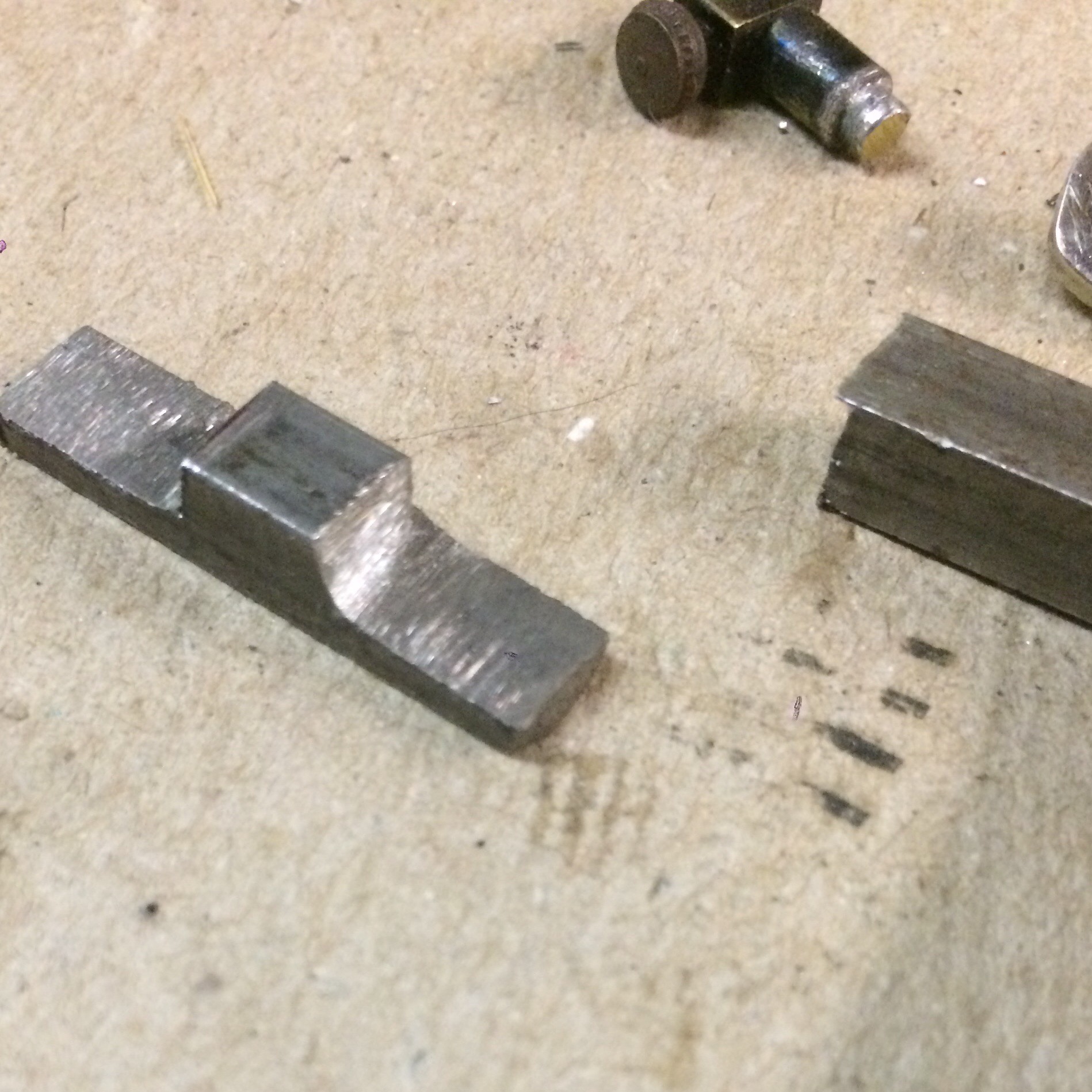

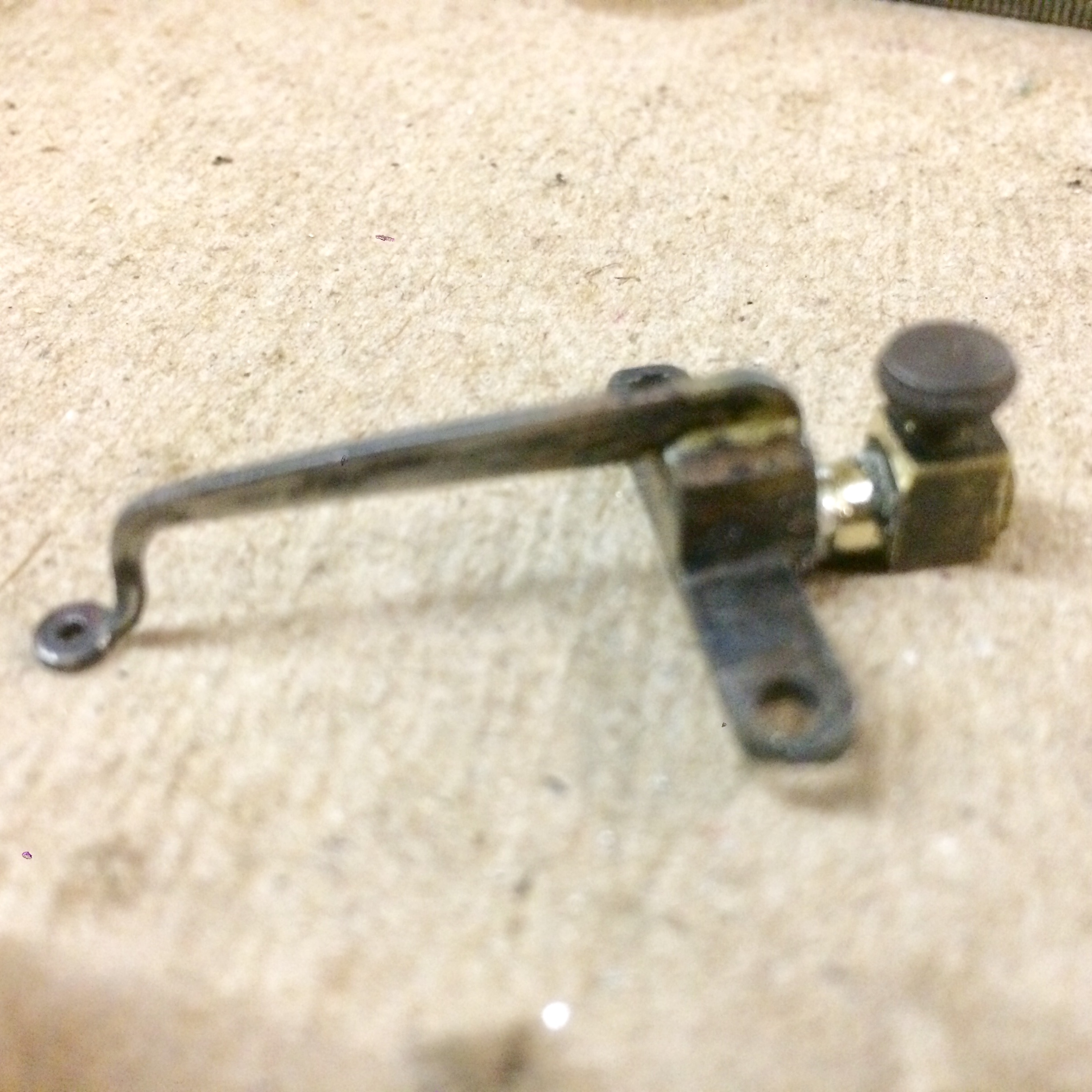

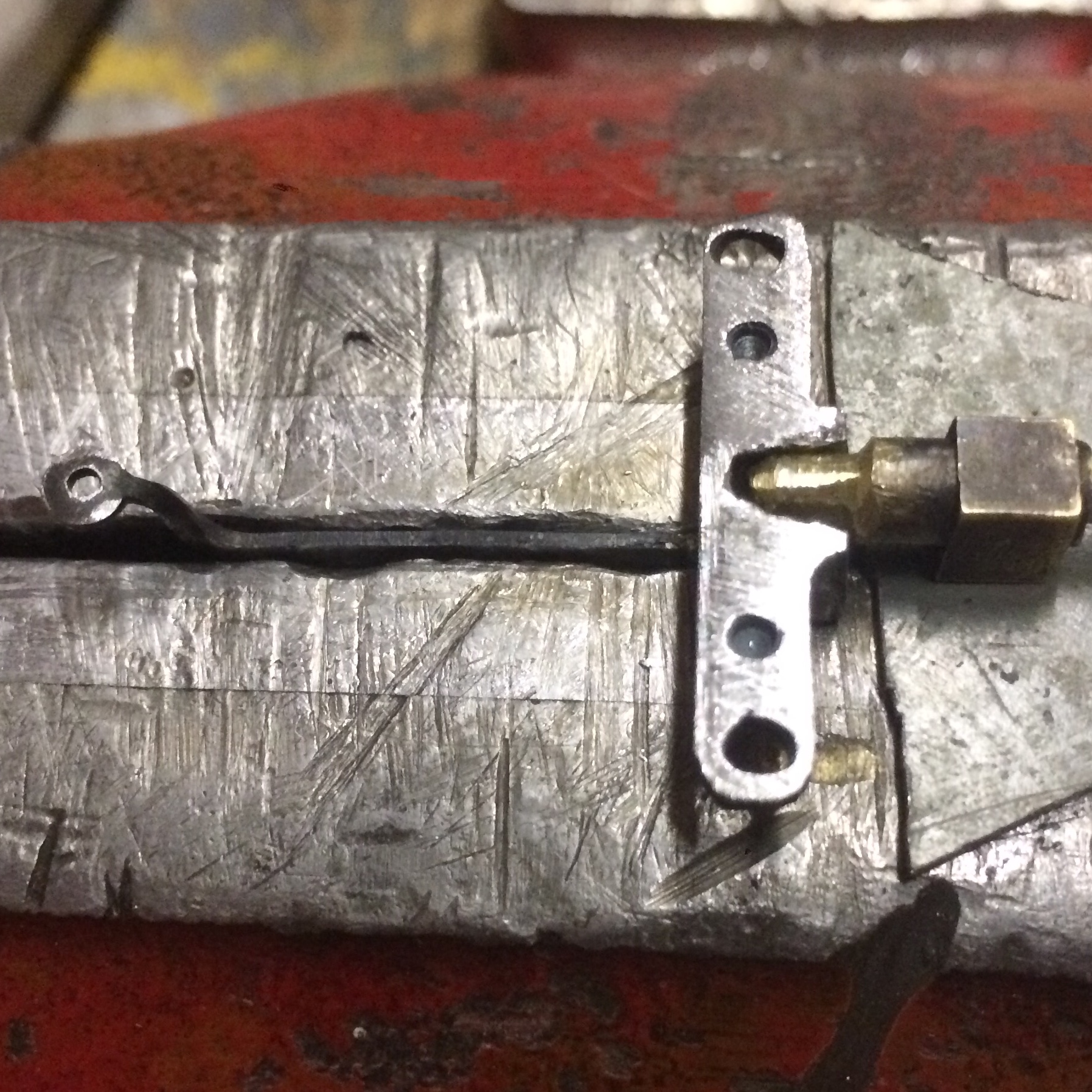

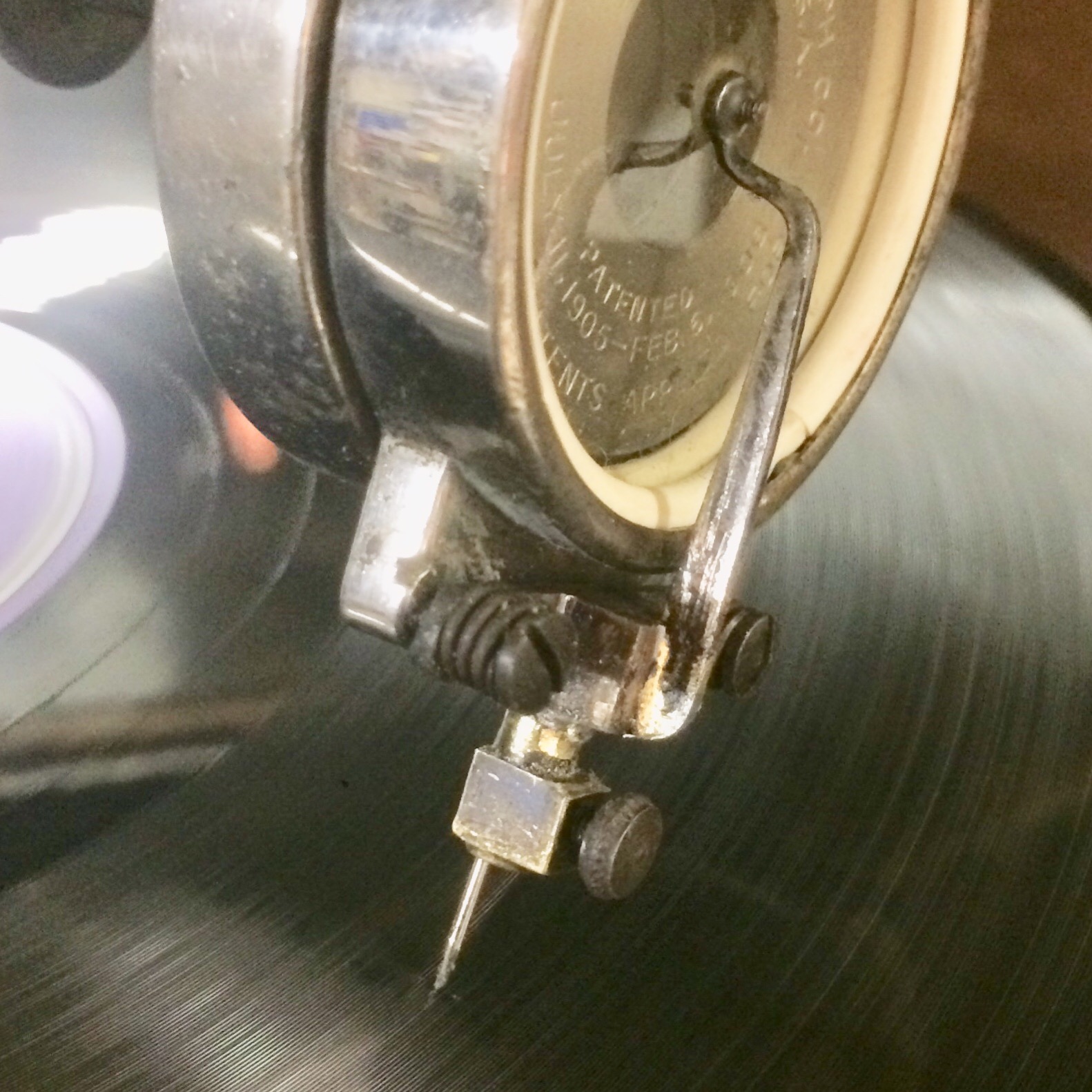

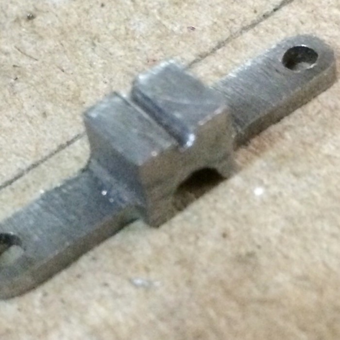

I own two machines with thumb lever-type Columbia Analyzing reproducers, a BI and an Open Works, and neither will hold a soft tone needle very well, the BI not at all in fact, so using such sophisticated tools as a hack saw, a file, a hand drill and a propane torch I made a new needle bar assembly out of a piece of ¼”x1/4” steel and parts from an crumbling, pot metal off brand reproducer I had.
I have kept the original intact and it could be reinstalled in minutes, but for now I am enjoying being able to use soft tone and triangular bamboo needles where previously I was stuck with loud tone only.

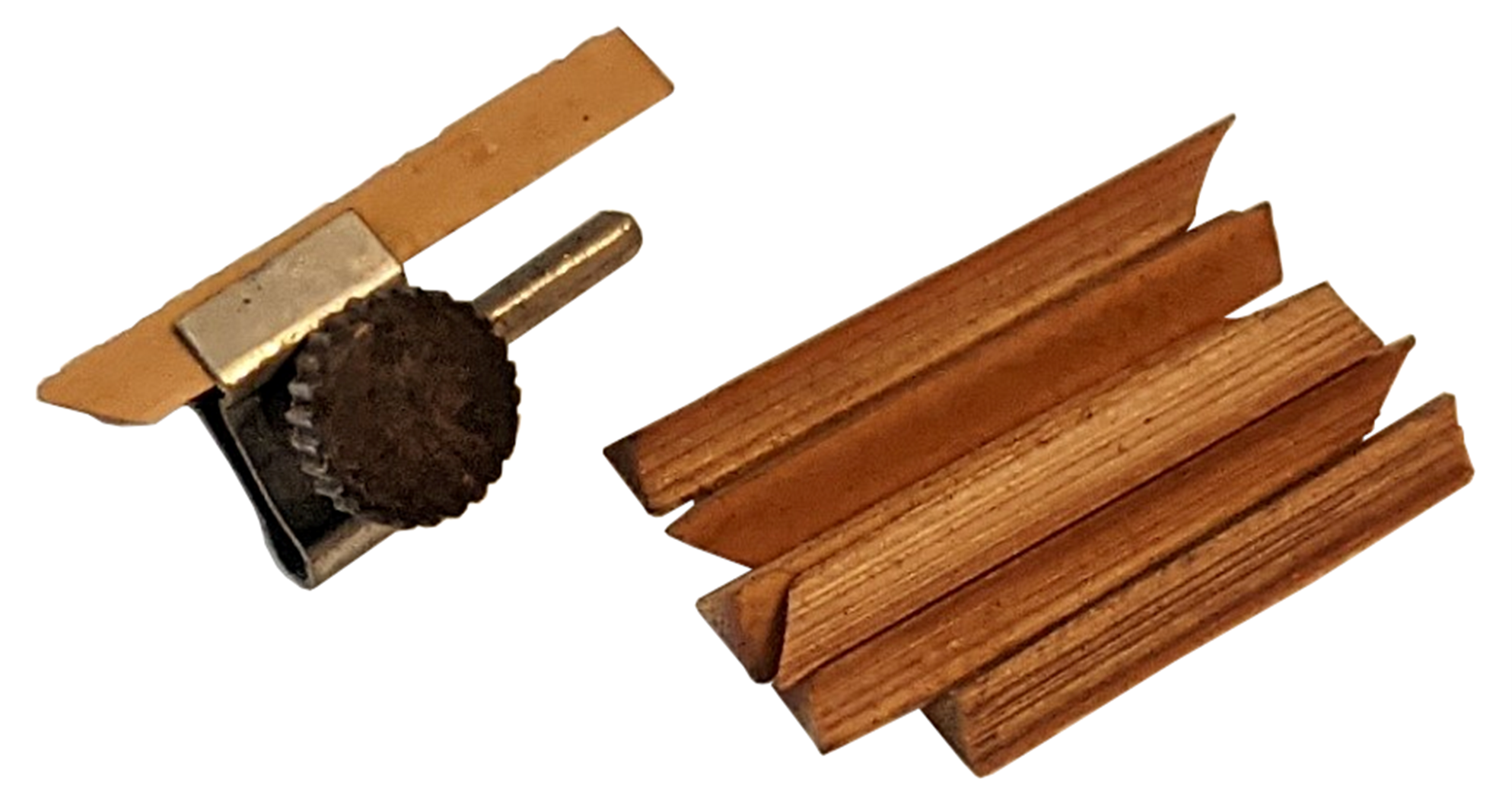

Or, you could look for this accessory, though I've only ever seen one in over 30 years of collecting!!!
Shawn

Oooh, that little bamboo side mount thingie might be my next mini project for the open works machine. Such a good idea.
