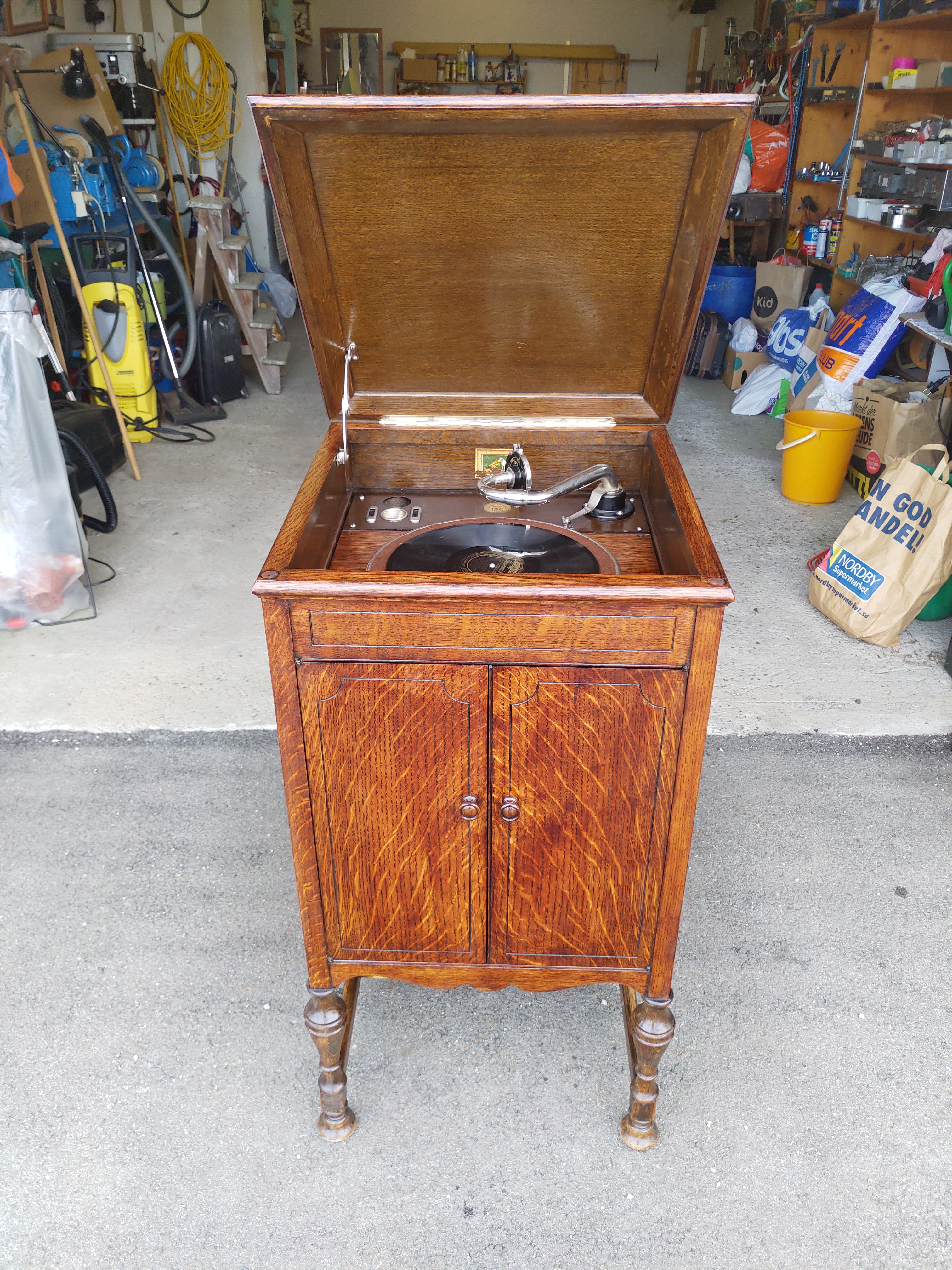

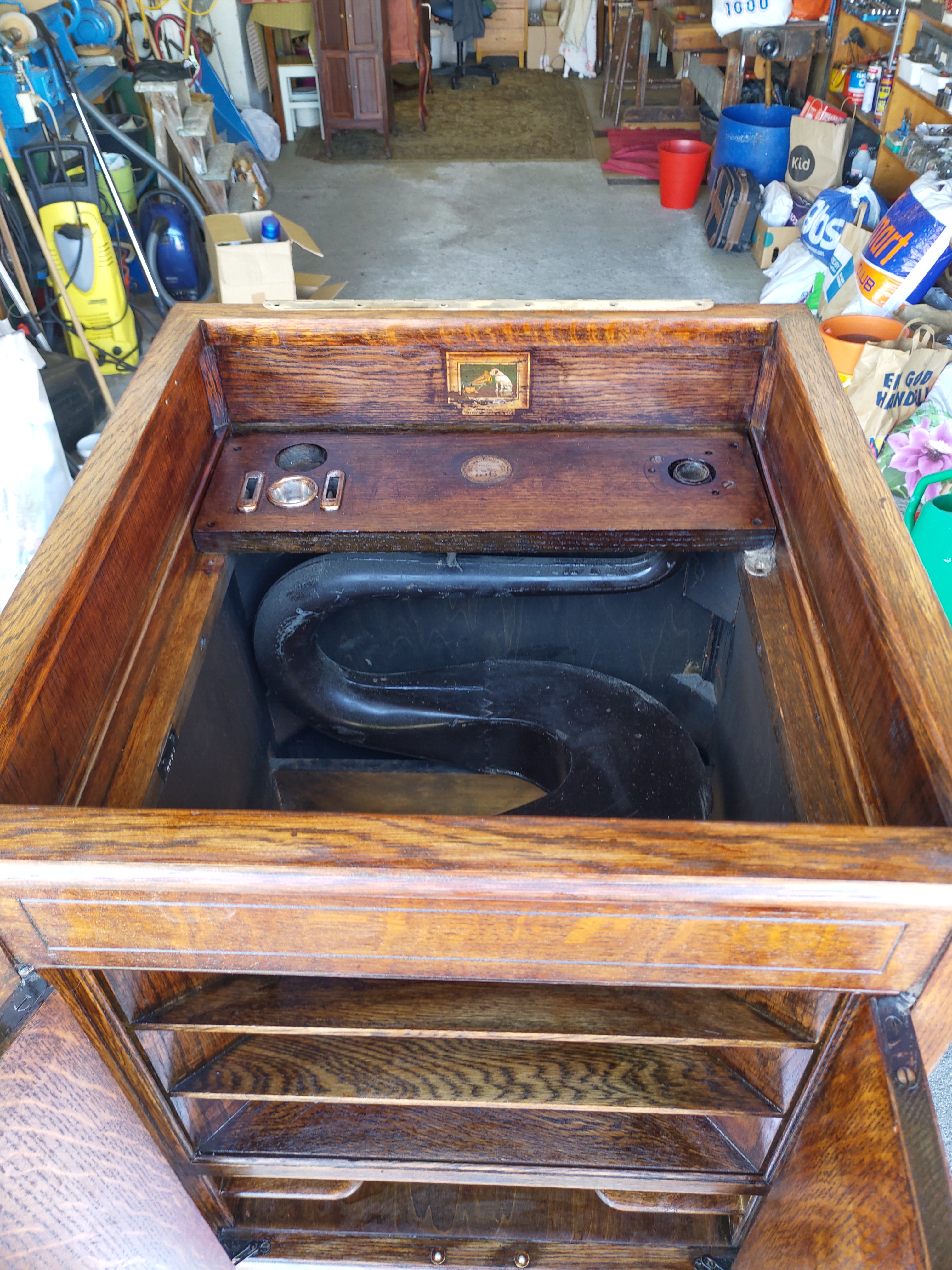

Update: I am adding a photo of my HMV 145. On the photo it has just received Liberon Wood Dye Dark Oak, on the top lid. This was my first machine, bought back in 1990, but the lid always looked terrible before I decided to strip it last summer, while the rest of the cabinet looked very good. (there is a big lamp in the ceiling with yellow light that makes the lid look a bit yellowish, while it is really impossible to see a color difference from the rest of the cabinet) As we can see the color matches well the rest of the cabinet. However, a top layer has also not been added to the machine, again because I am not sure what product would be best to use. I know it it possible to get shellac in a solution that is said to be easy to add on, since I have no experience adding shellac the original way.

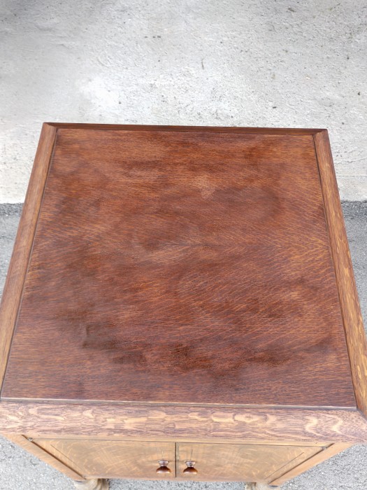

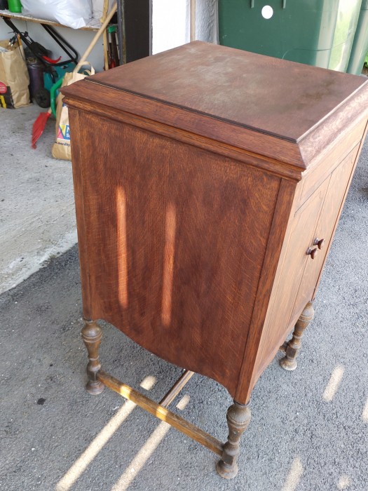

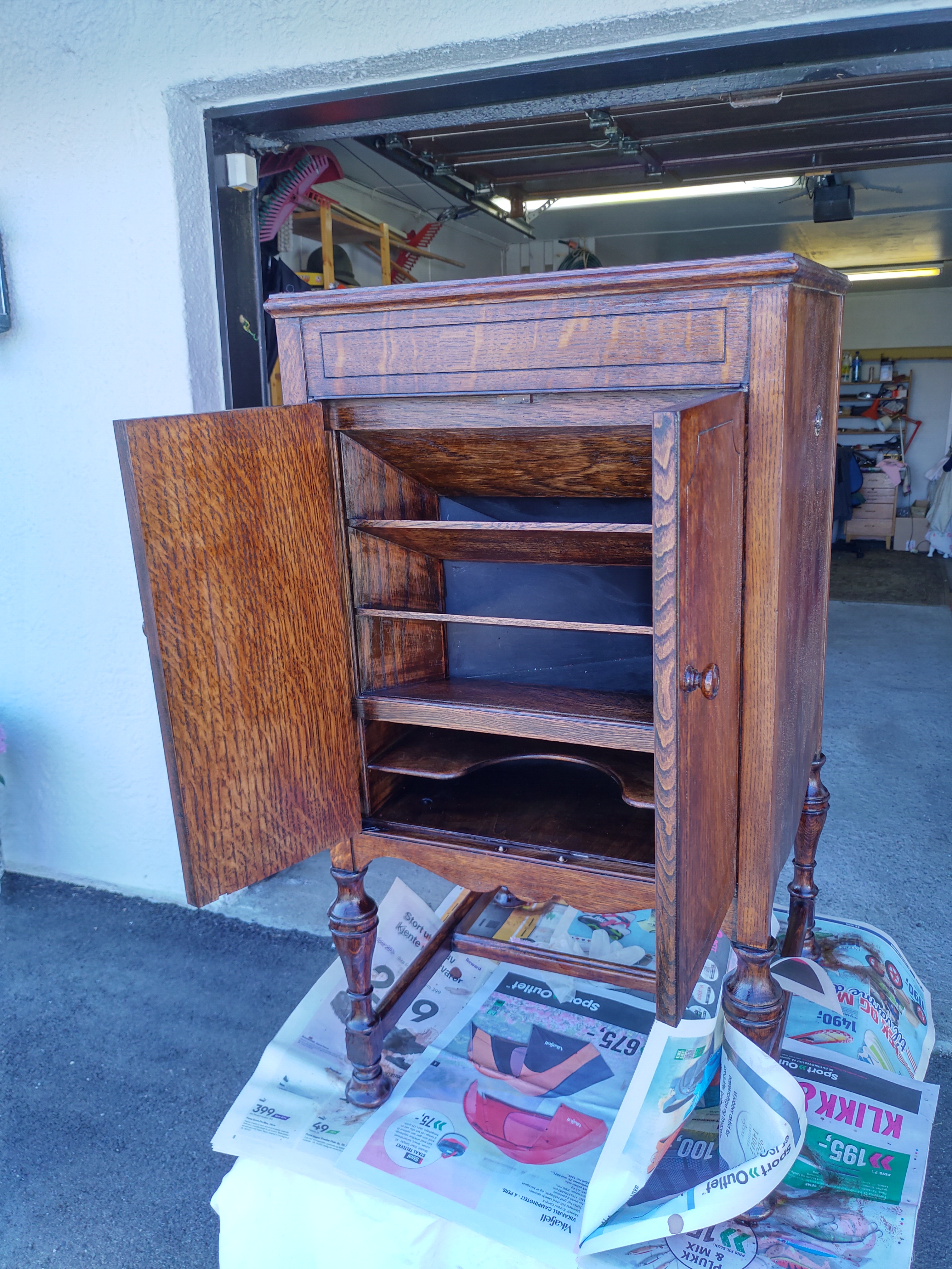

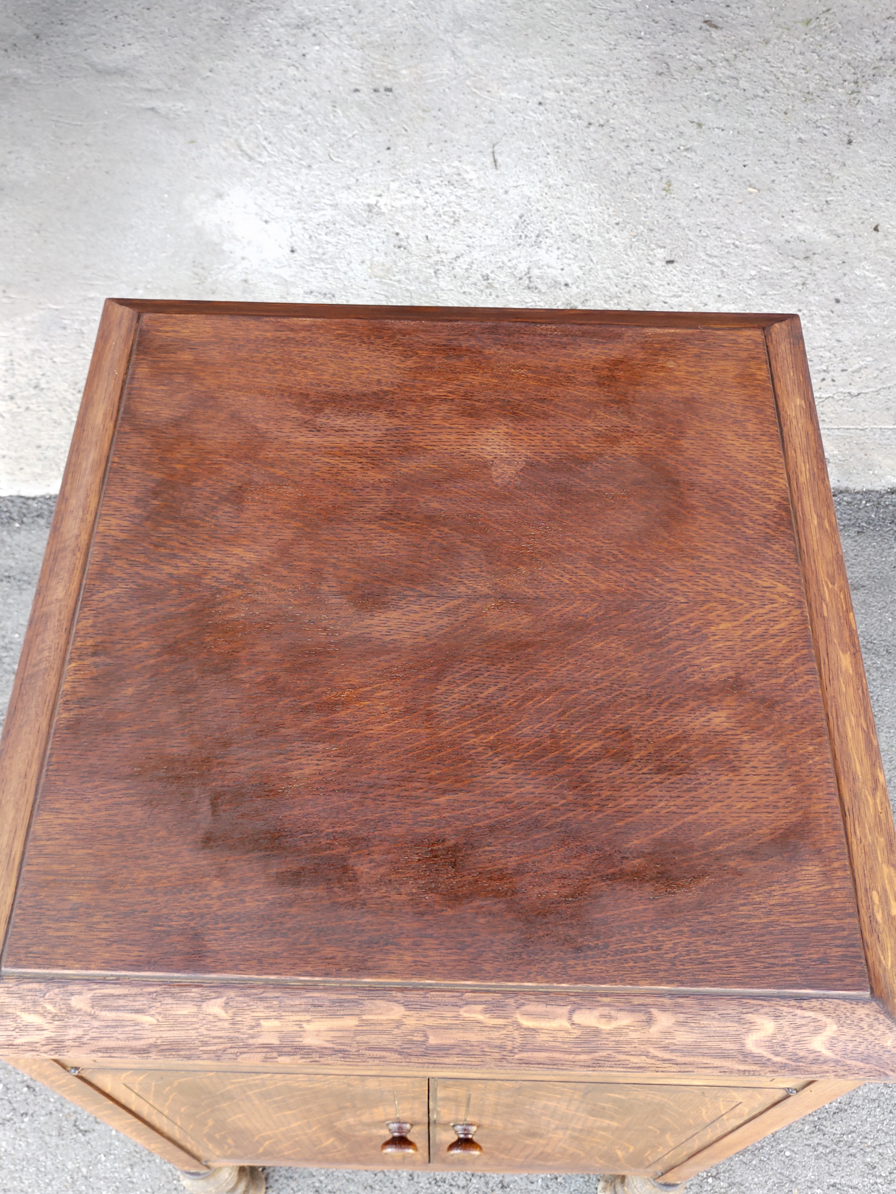

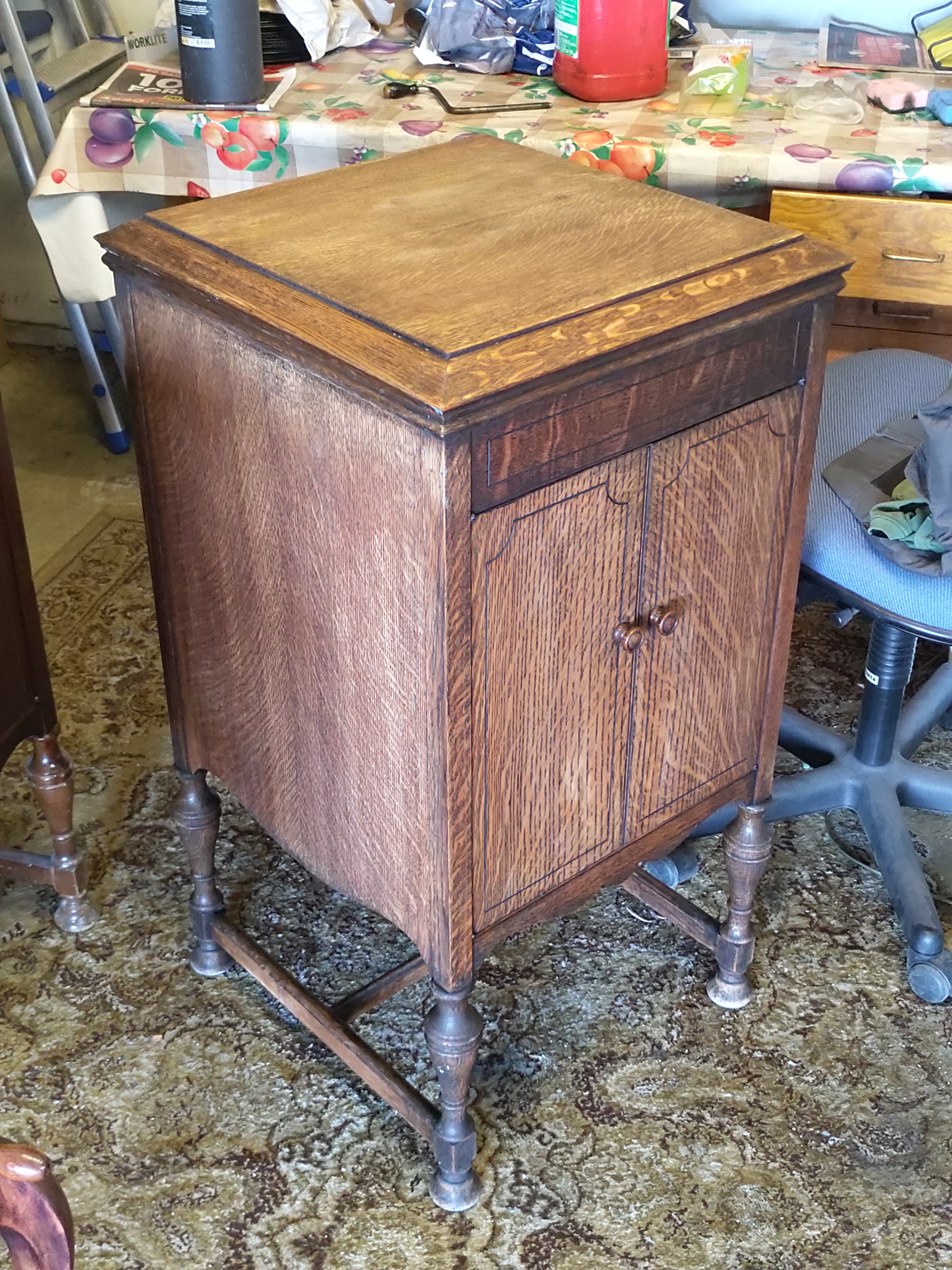

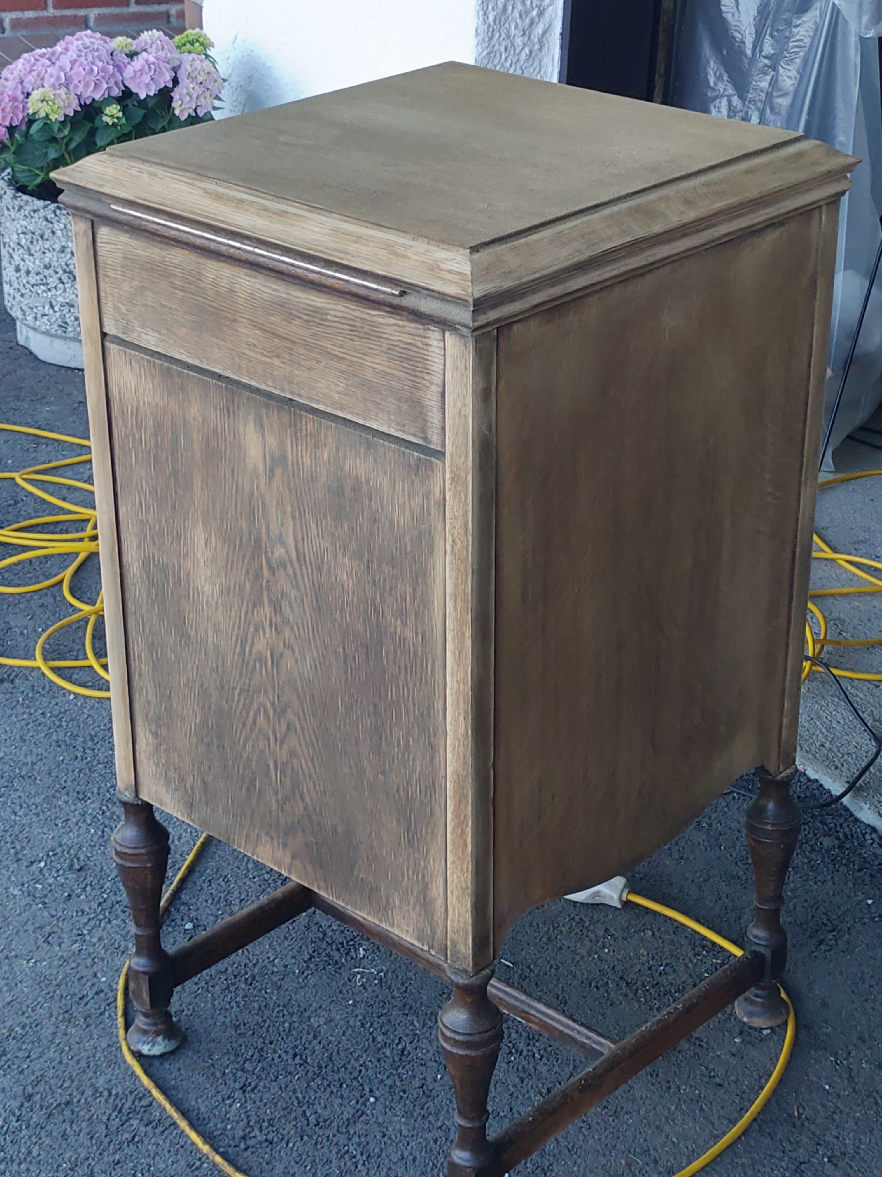

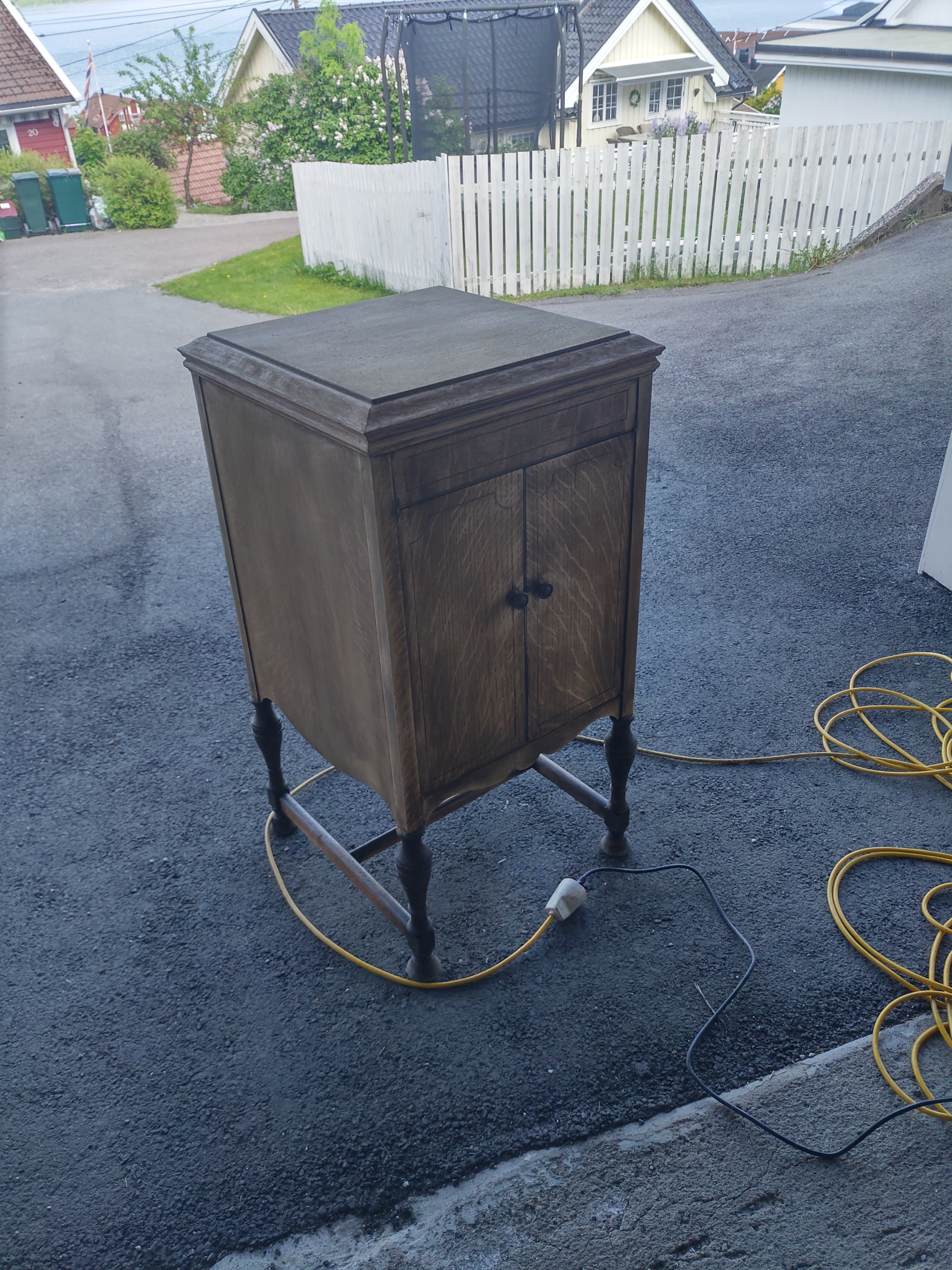

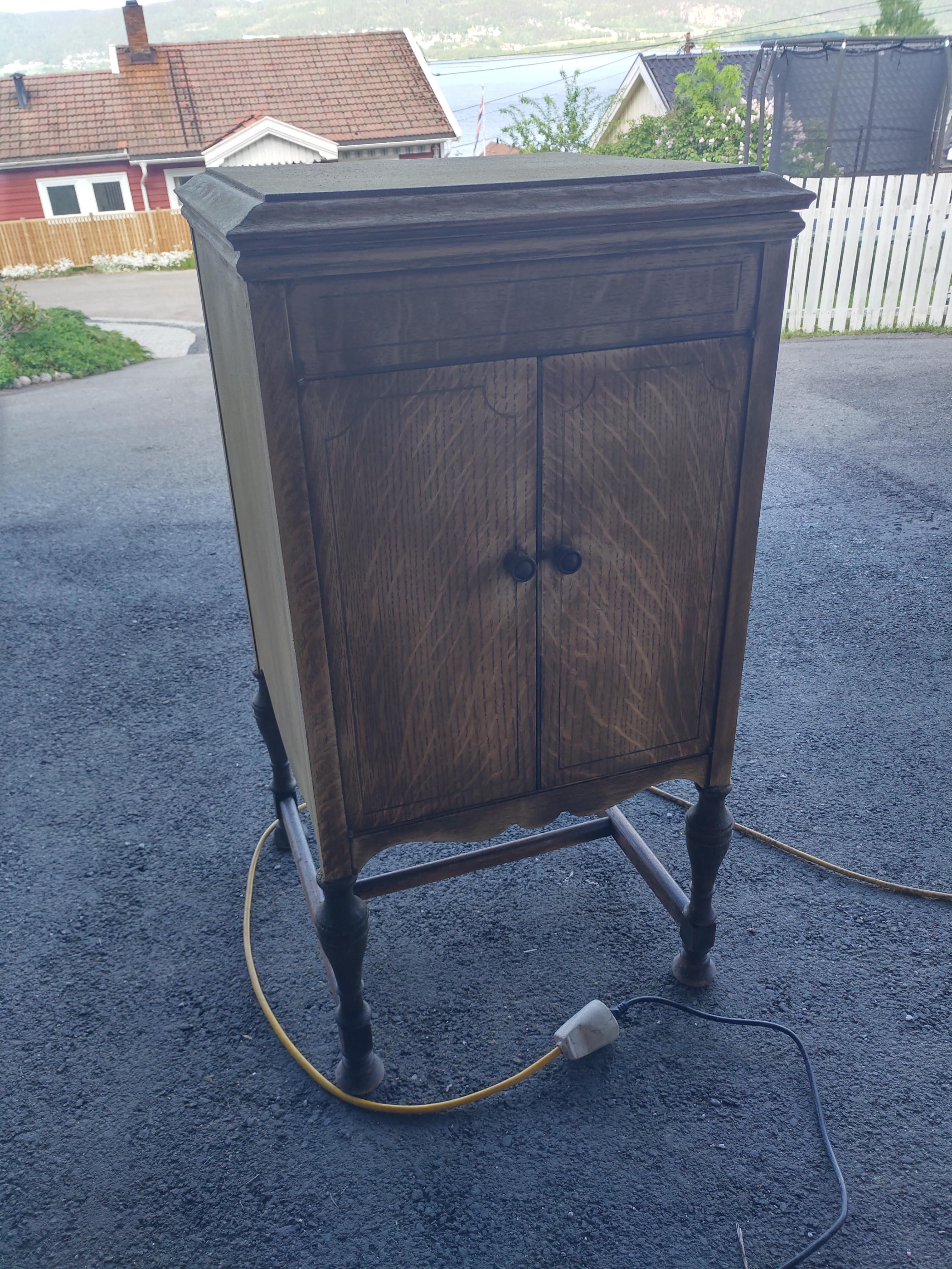

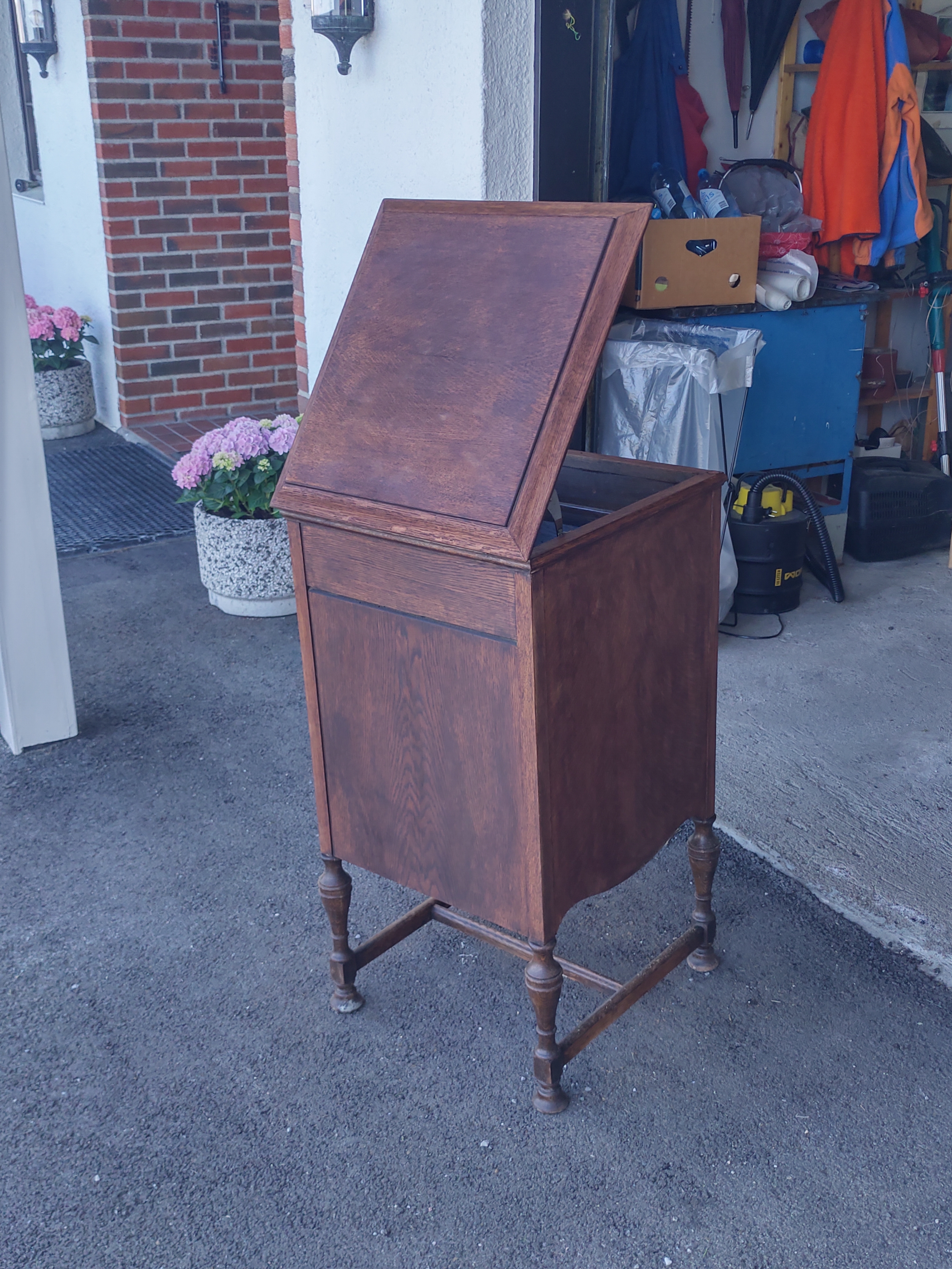

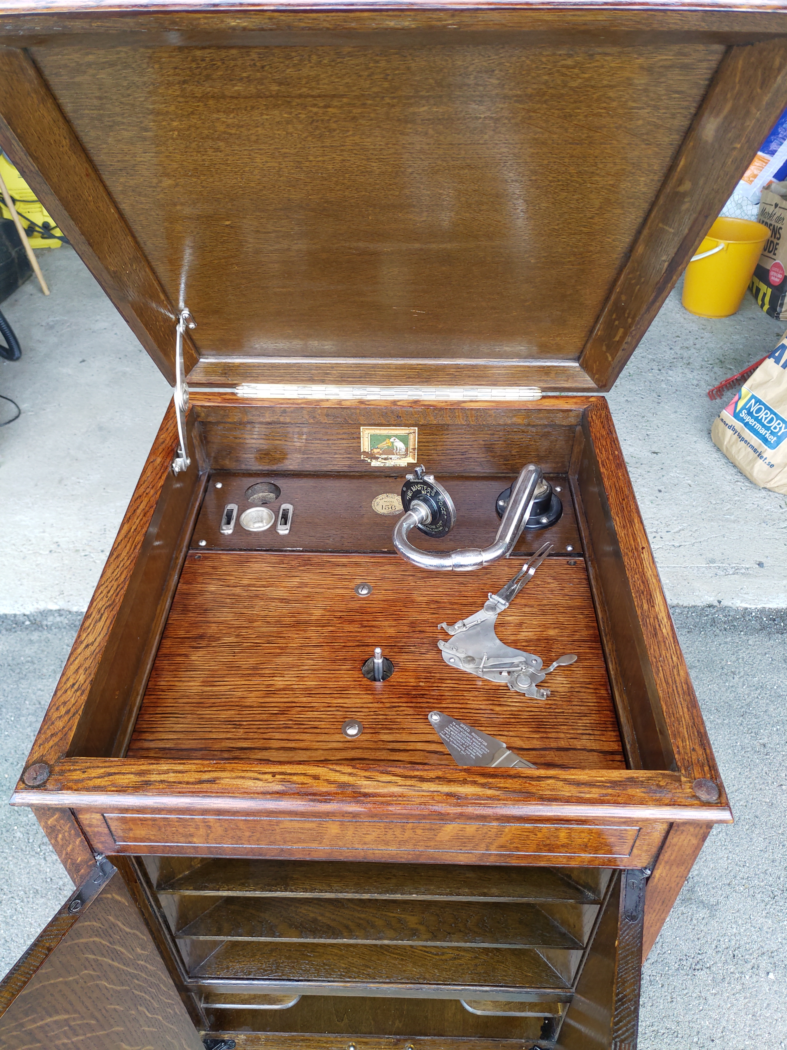

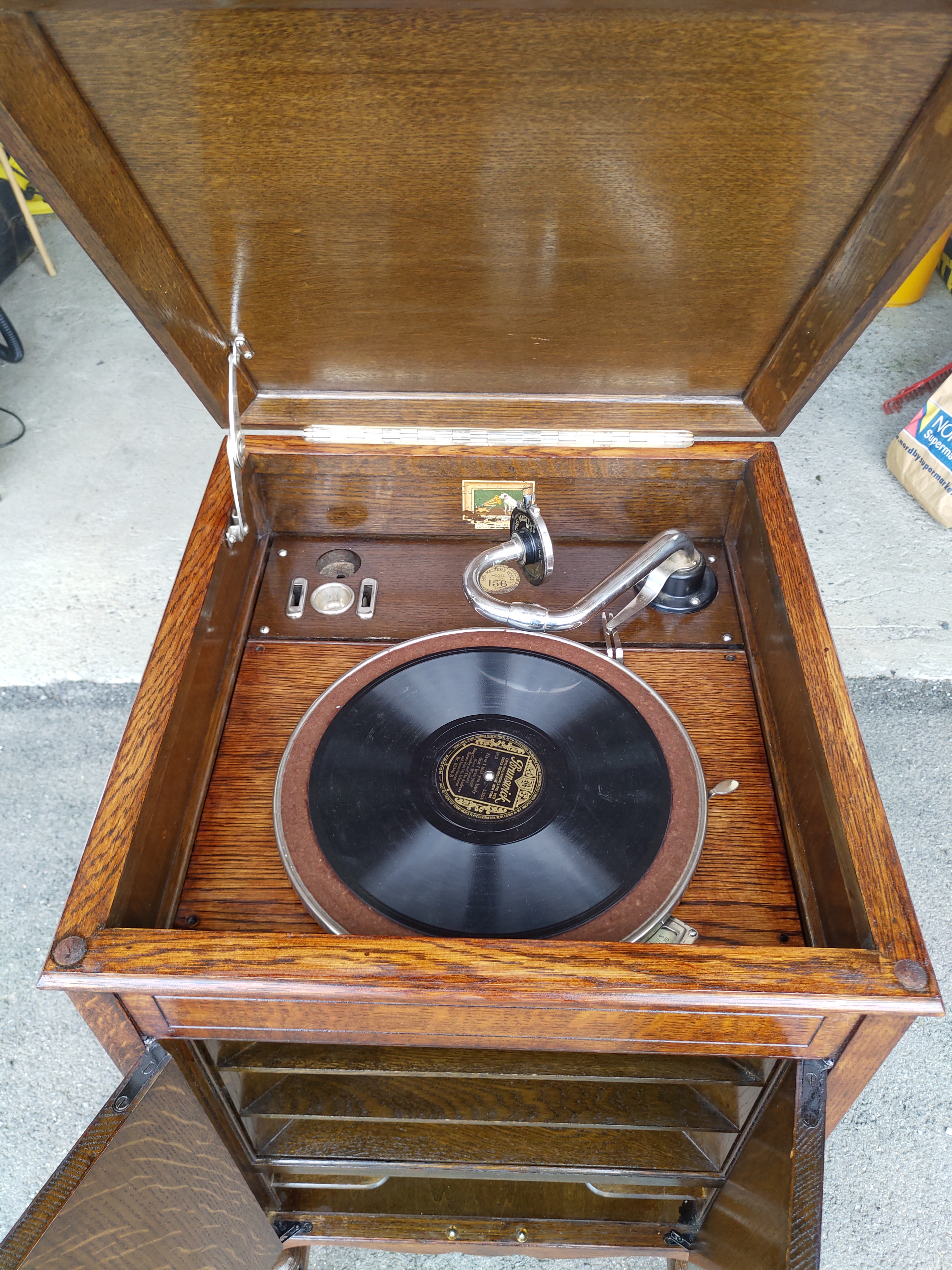

Okay, now it is done. I have stripped my first HMV cabinet, the oak 156. :shock: The finish were all gone, and something had to be done to this cabinet, I am also adding a photo, also shown on page 1 on this thread, to show how it looked before being sand papered down.
I am uploading several photos. Since I have not discovered how to add text to photos since the forum was changed, I am posting twice.
In this first post, you can see the cabinet before being stripped (bottom photo), and also the cabinet after it has been stripped (next three photos).
The upper 5 photos show photos of the cabinet after it has been stained. As we can see the Liberon dark oak is somewhat lighter than the original dark oak in the interior of this HMV cabinet.

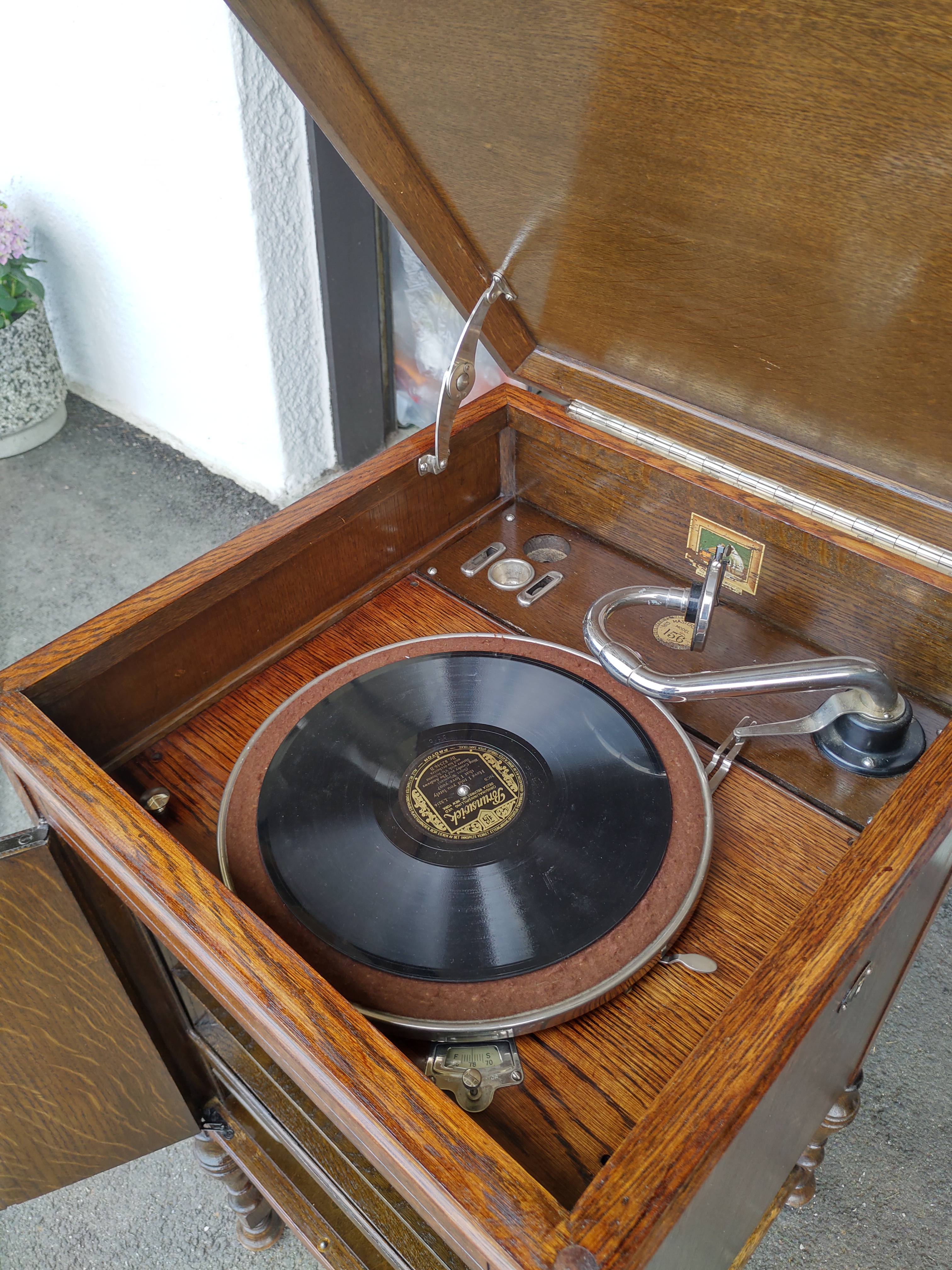

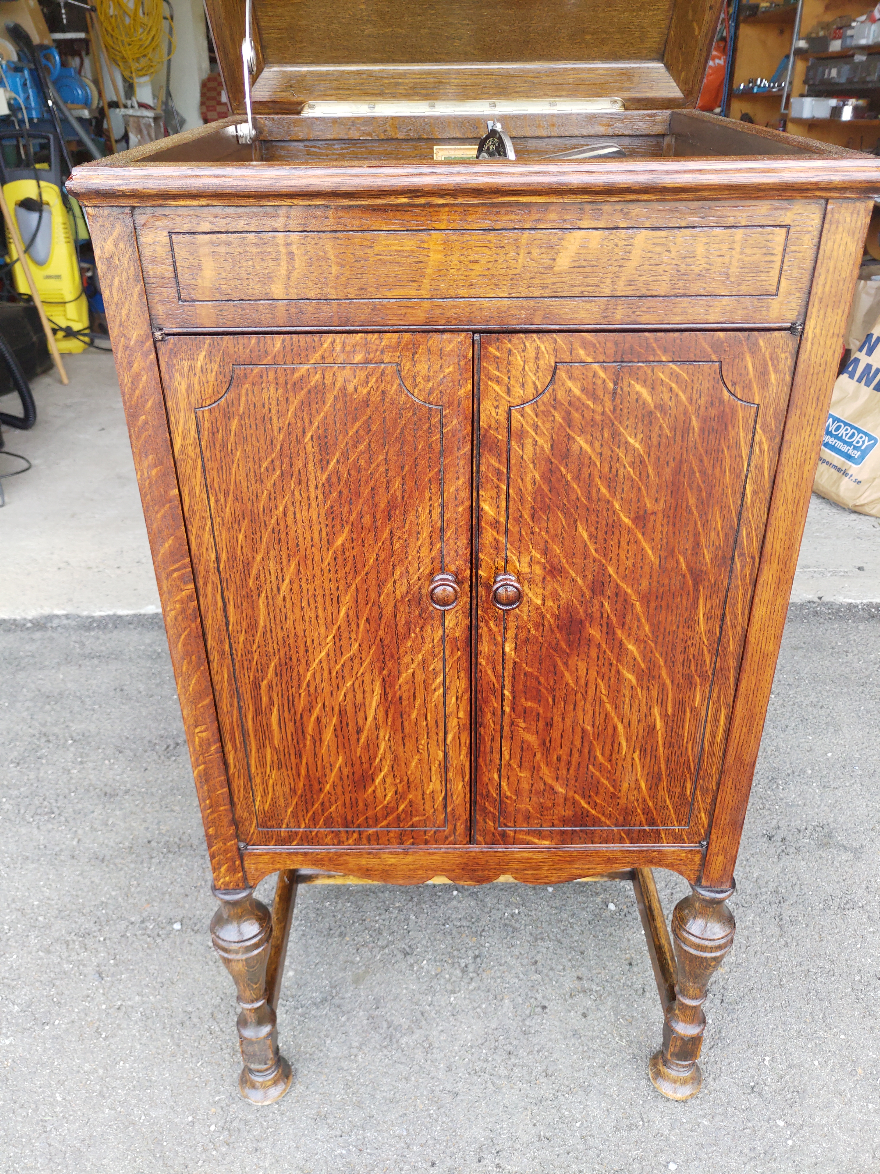

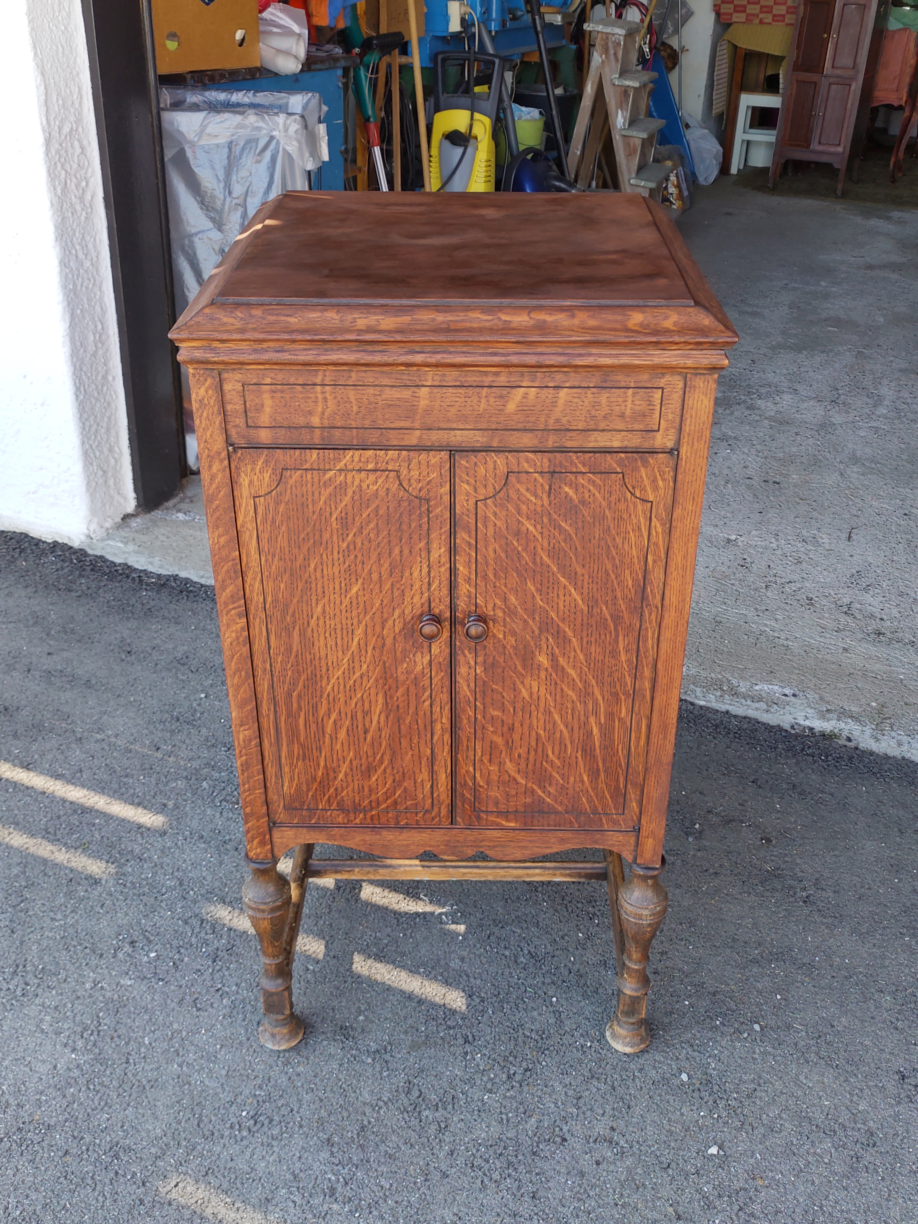

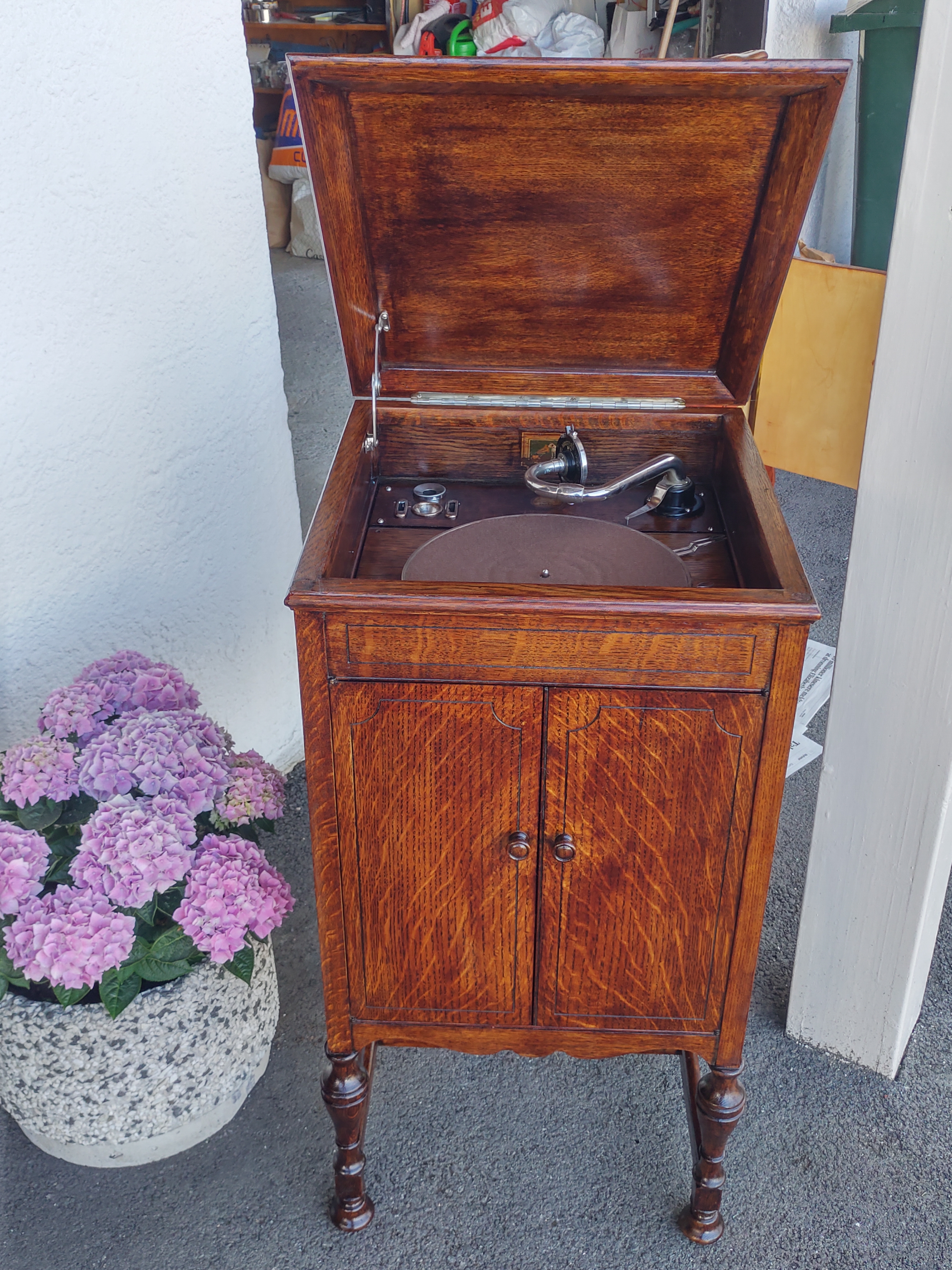

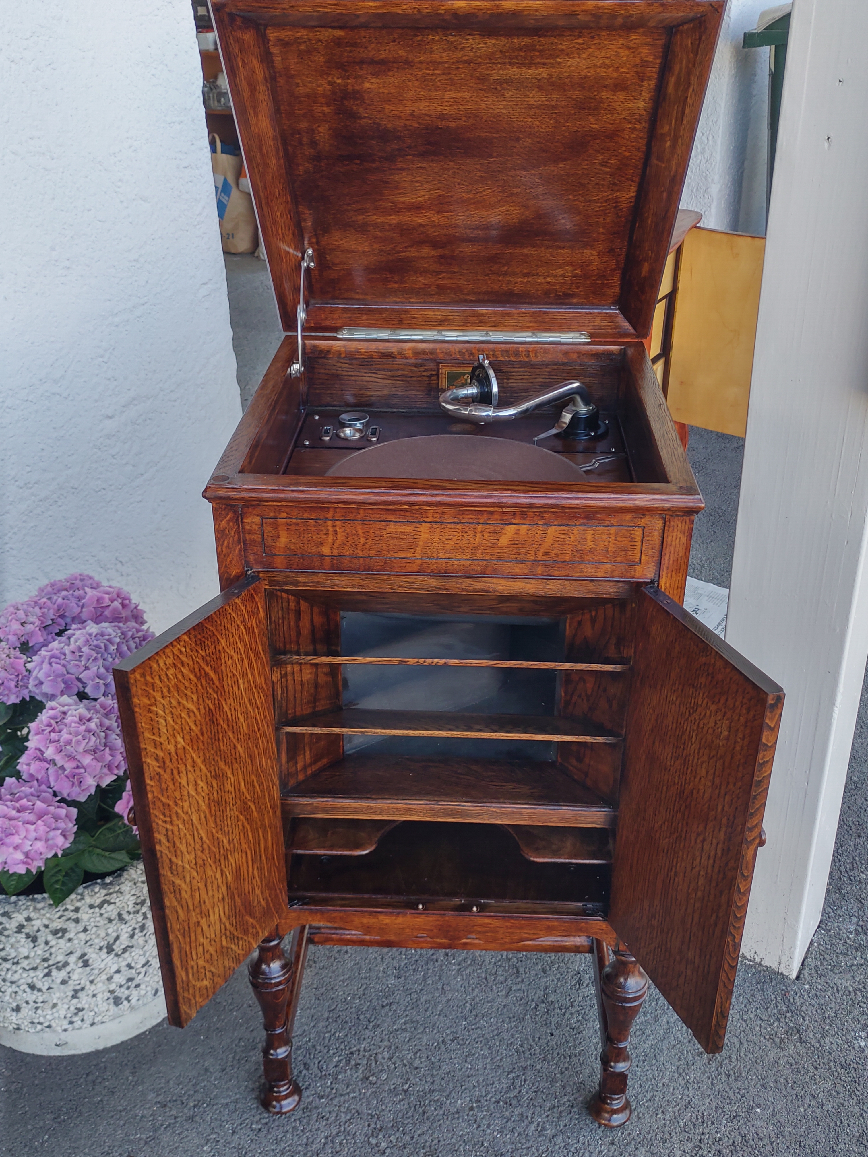

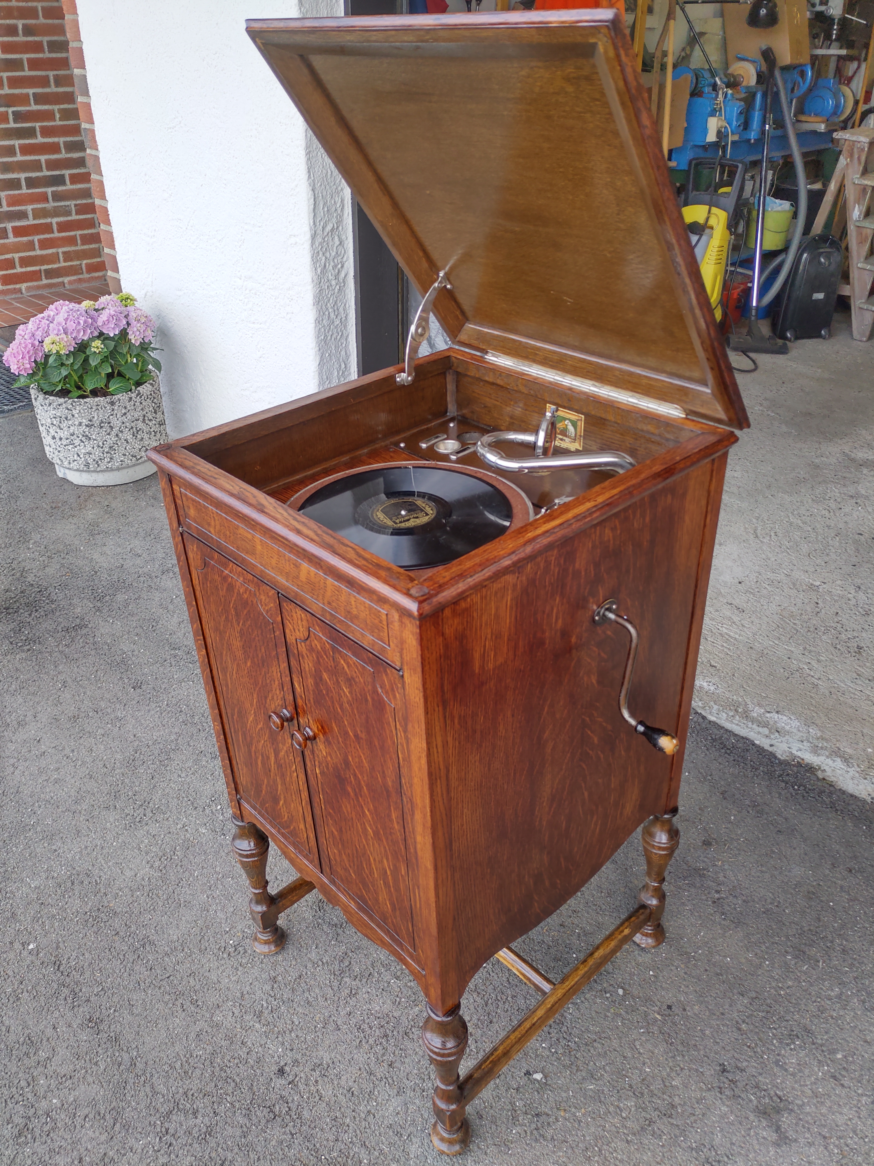

And here is the end result, after adding two layers of the shellack solution shown on page 1. This is the first time I have tested such a solution, the only thing missing now, is to add a layer of wax on top of the cabinet. I also added one layer of shellack to the interior and the legs of the cabinet.
There is a color difference, but apart from it I am happy with the result.
Any inputs, comments, negative or positive...or suggestions are as always welcome. I would have liked to find an exact color match, but the Oberon Dark Oak Spirit Wood Dye, have been the only reference I have been able to find as reference, when looking at stains to use on HMV oak cabinets.
And yes...it is tempting to also strip the board that surrounds the tone arm...
And the feet, but it is impossible to use a grinder down on those feet....I don't know if a paint stripper will work...liquid? I have never used one.

The problem you have with stripping the cabinets is that you invariably leave some of the original finish behind that remains invisible to the eye. Sanding is ineffective; the colour has to be pulled out with chemicals. The new wood dyes do not penetrate oak veneer enough unlike they would with say a piece of softwood.
You then get those patchy areas which show up when a finish is re-applied over the top.
No one to my knowledge has ever successfully replicated the look or colour of whatever HMV and others companies used on their oak or mahogany cabinets. The colour was in the finishing material, not the timber / veneer. Thats the problem anyone has when refinishing today. You simply cannot get that depth of colour build with anything on the market today.

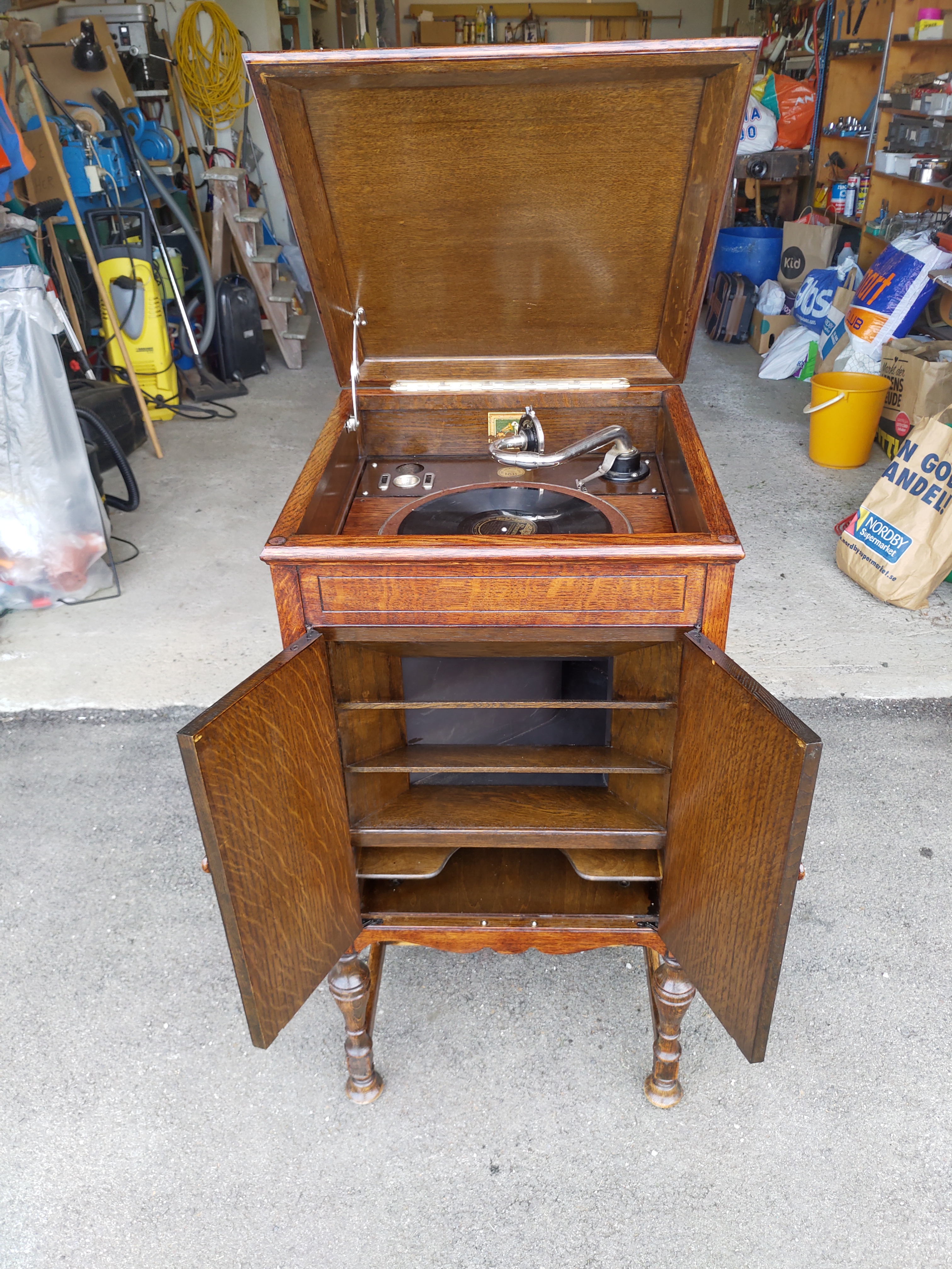

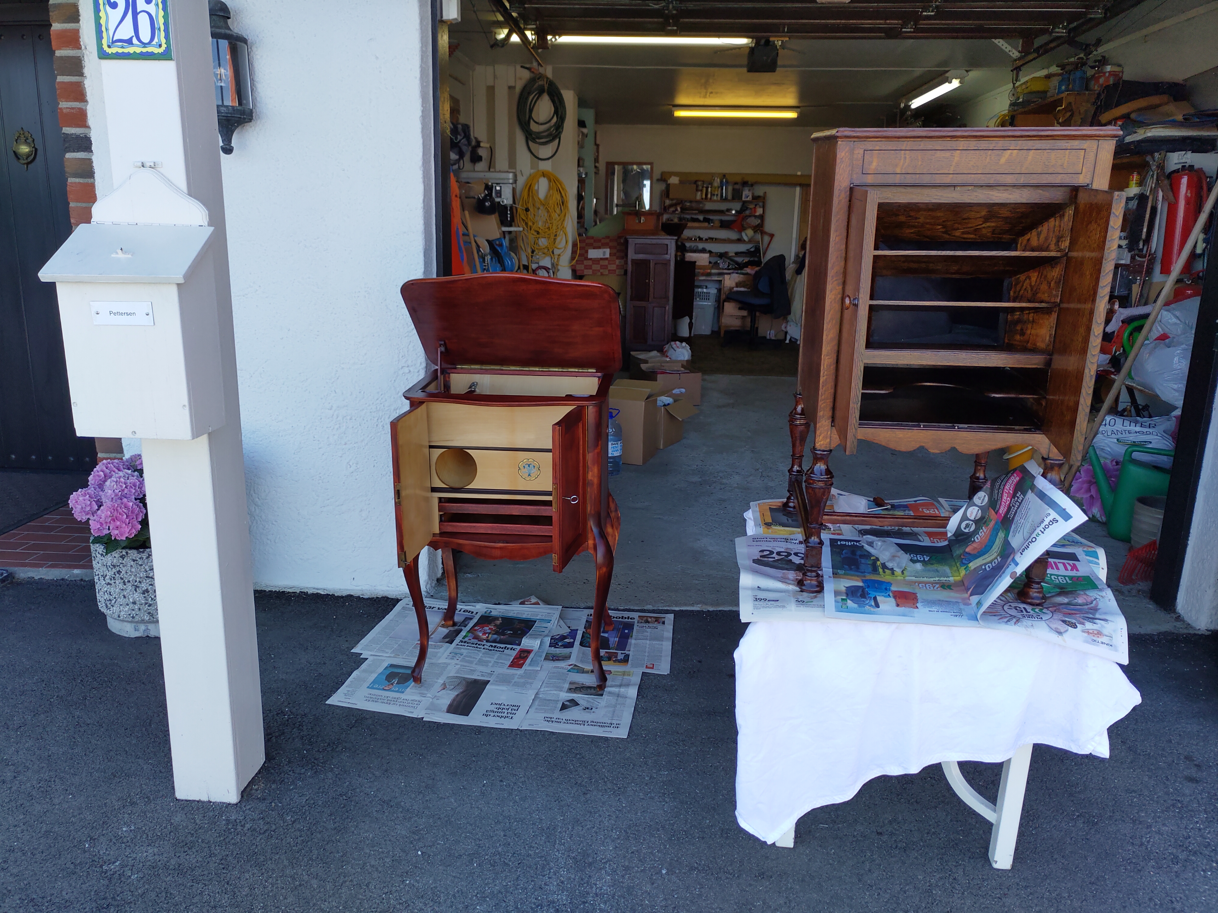

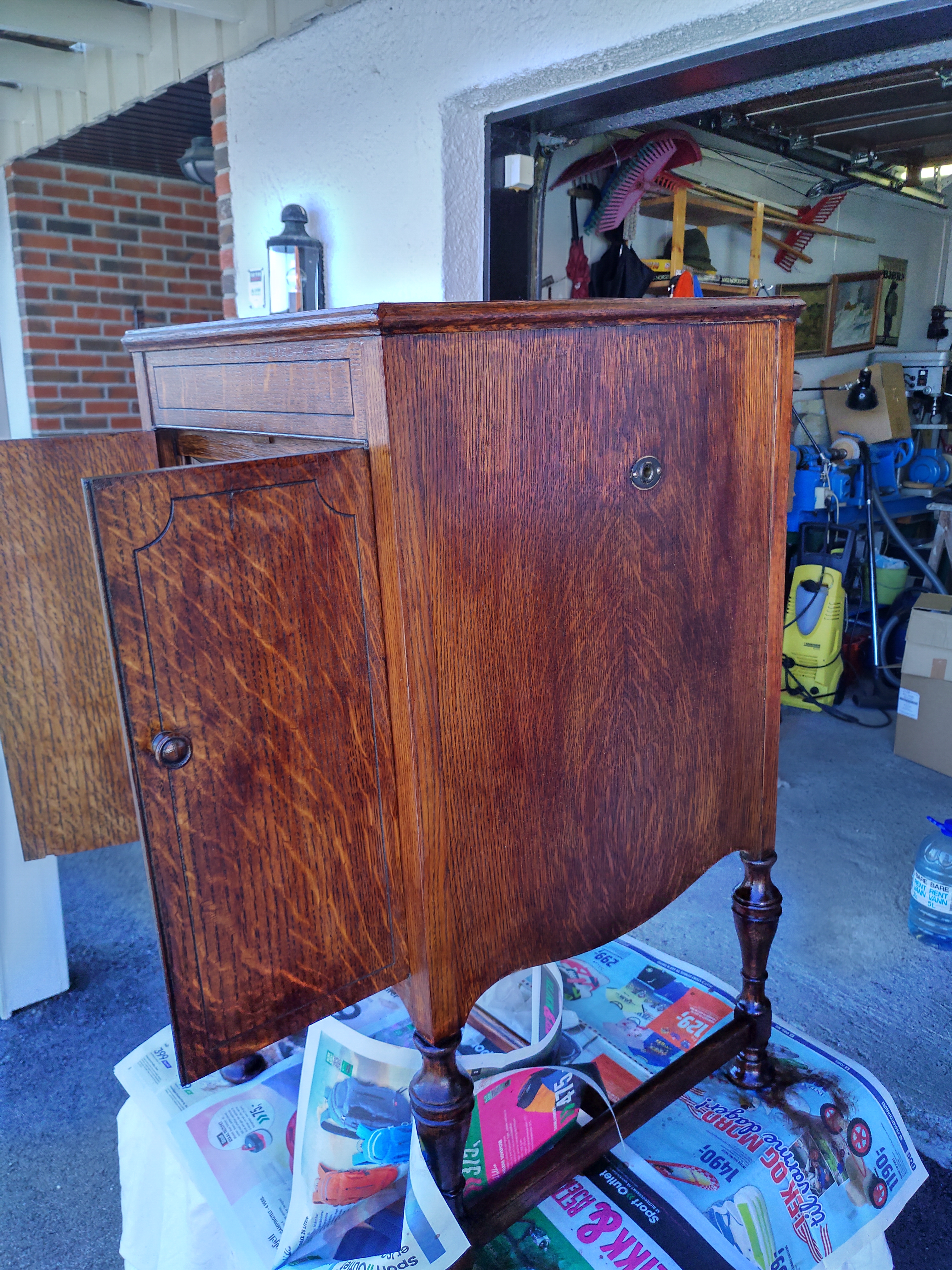

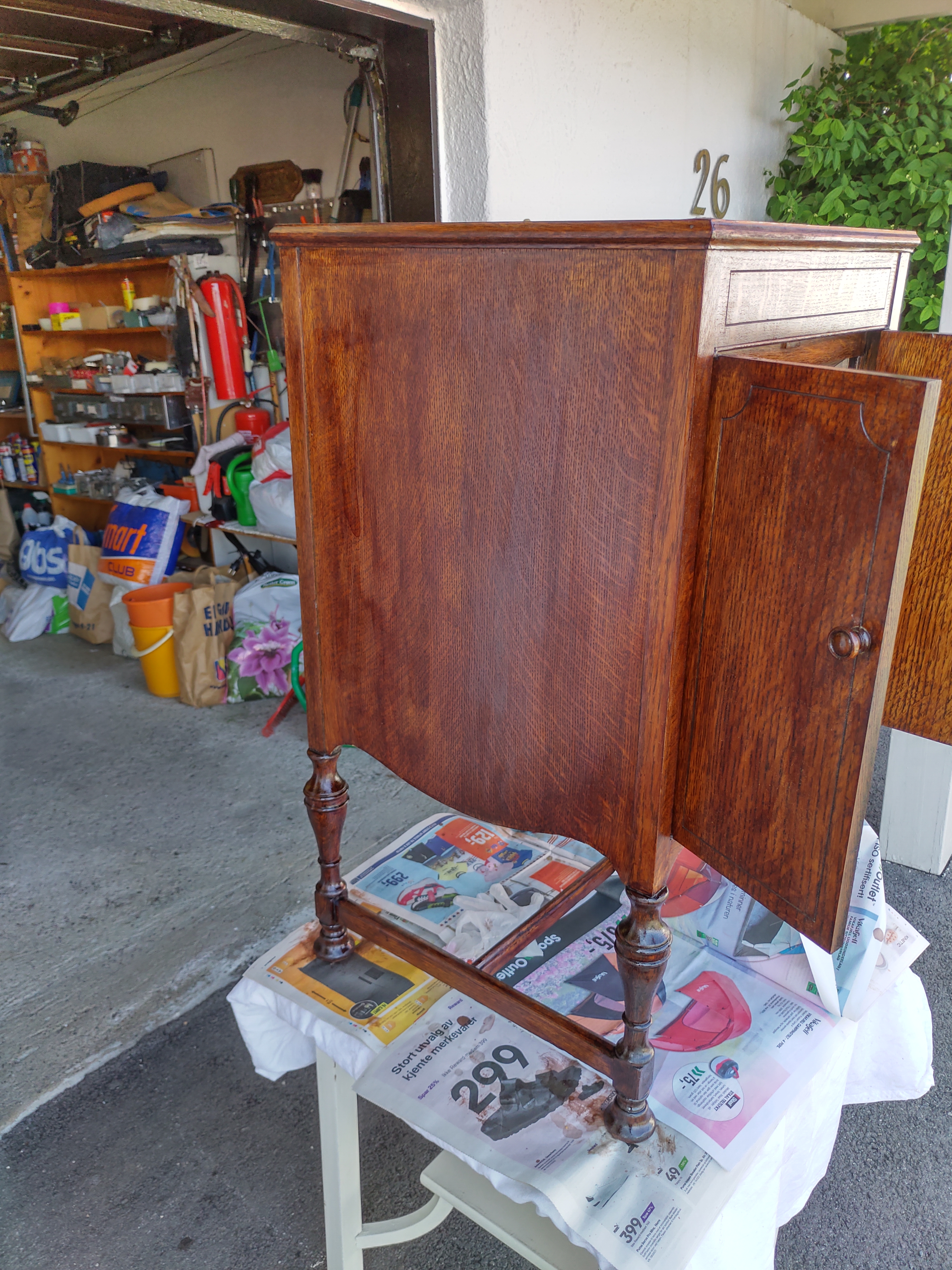

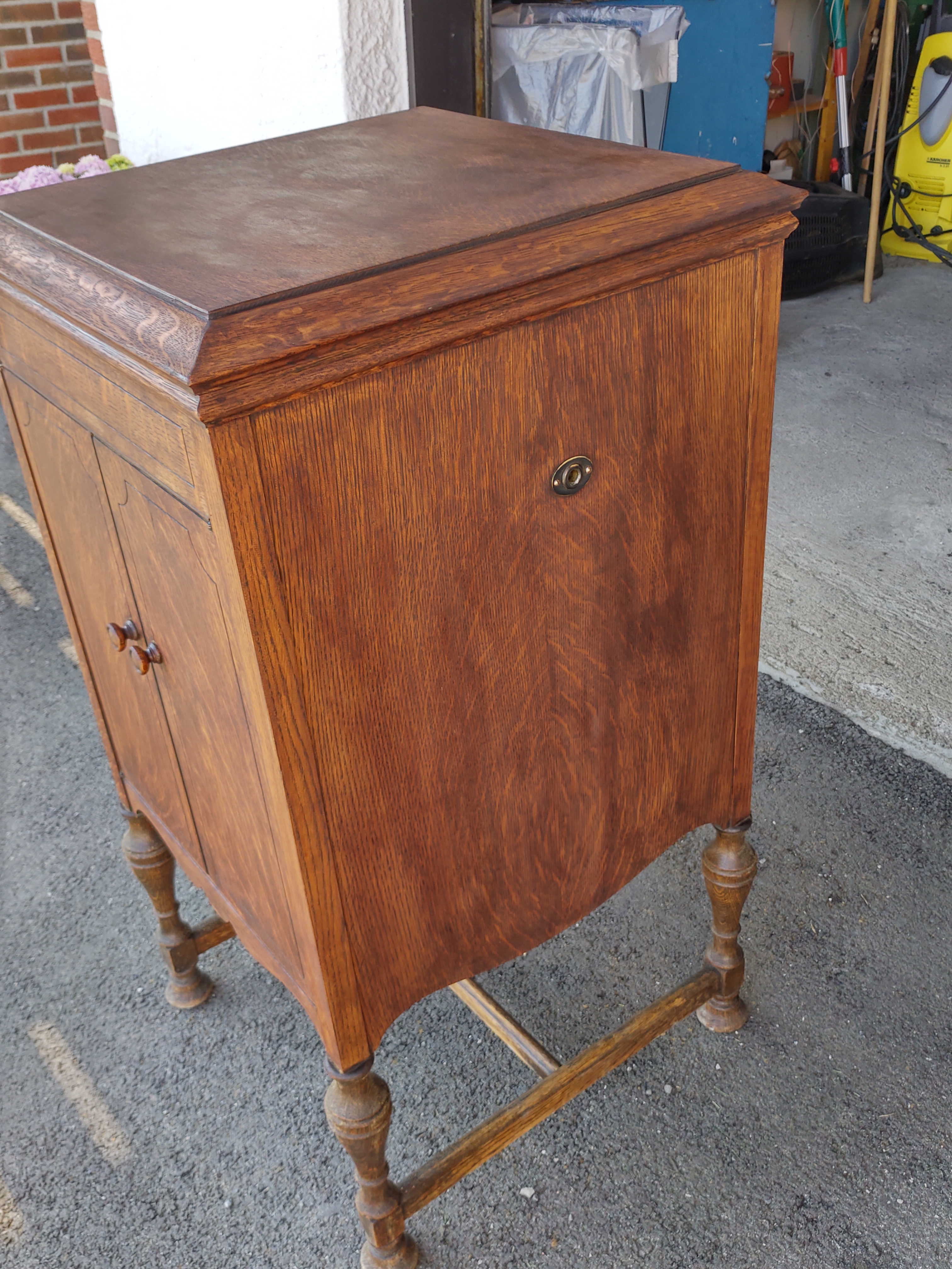

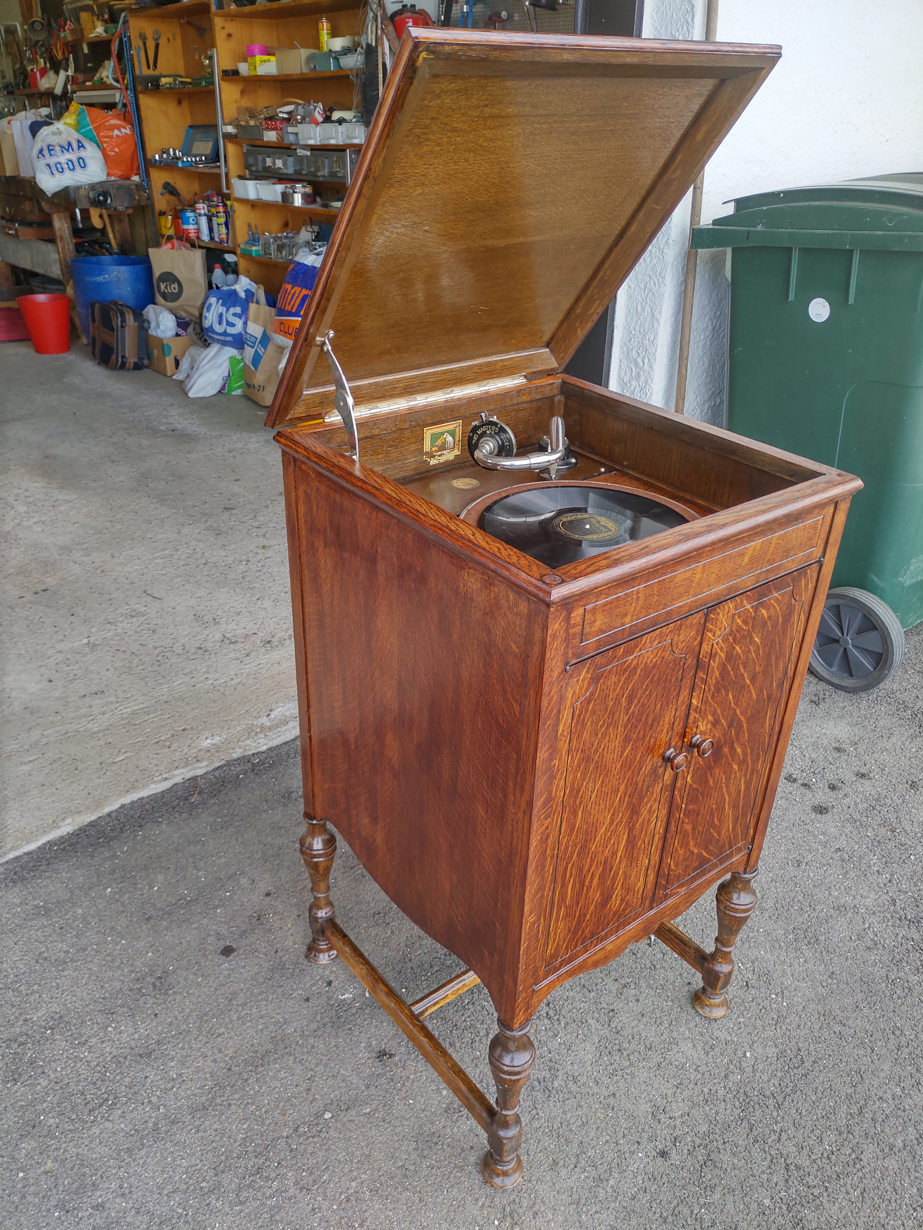

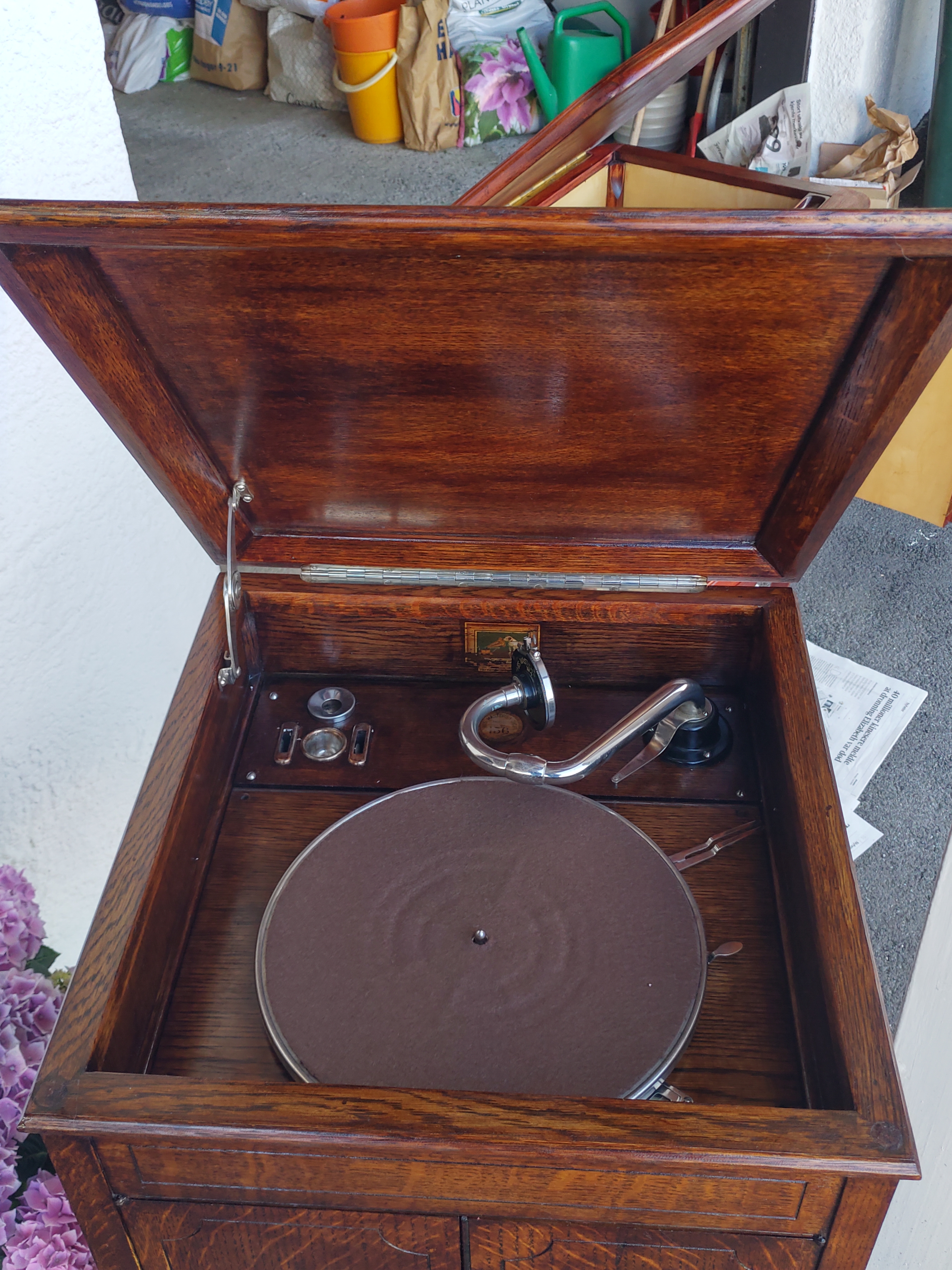

So, now I have stripped the rest of the cabinet (including the feet) with sand paper, no chemical paint stripper. 16 work hours later, the result is on the photo. In addition to the products shown on photo earlier in the thread,( 2 layers of Liberon Spirit Wood Dye, 2 layers of Shellach liquid solution), I also added Howard's Feed'n Wax as the last cover. There is now not much more I can do for the machine, apart from buying two decals from Peru, since the decals, that also was torn, did not survive well the transformation.
I have now lost count of how many hours I have spent on the machine.
It will be hard to sell it though, I will never get paid for the hours laid down in work, and I also now like it, a lot, even if it has been stripped. It also plays like a charm :geek: :squirrel:
Photos are showing part of the process during the last two days, and end result.
I now sit here with two 156 cabinets, I have decided to sell one, and keep one. Which one would you sell, the mahogany original, or this stripped down dark oak machine?

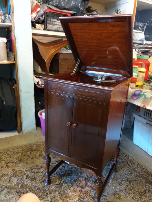

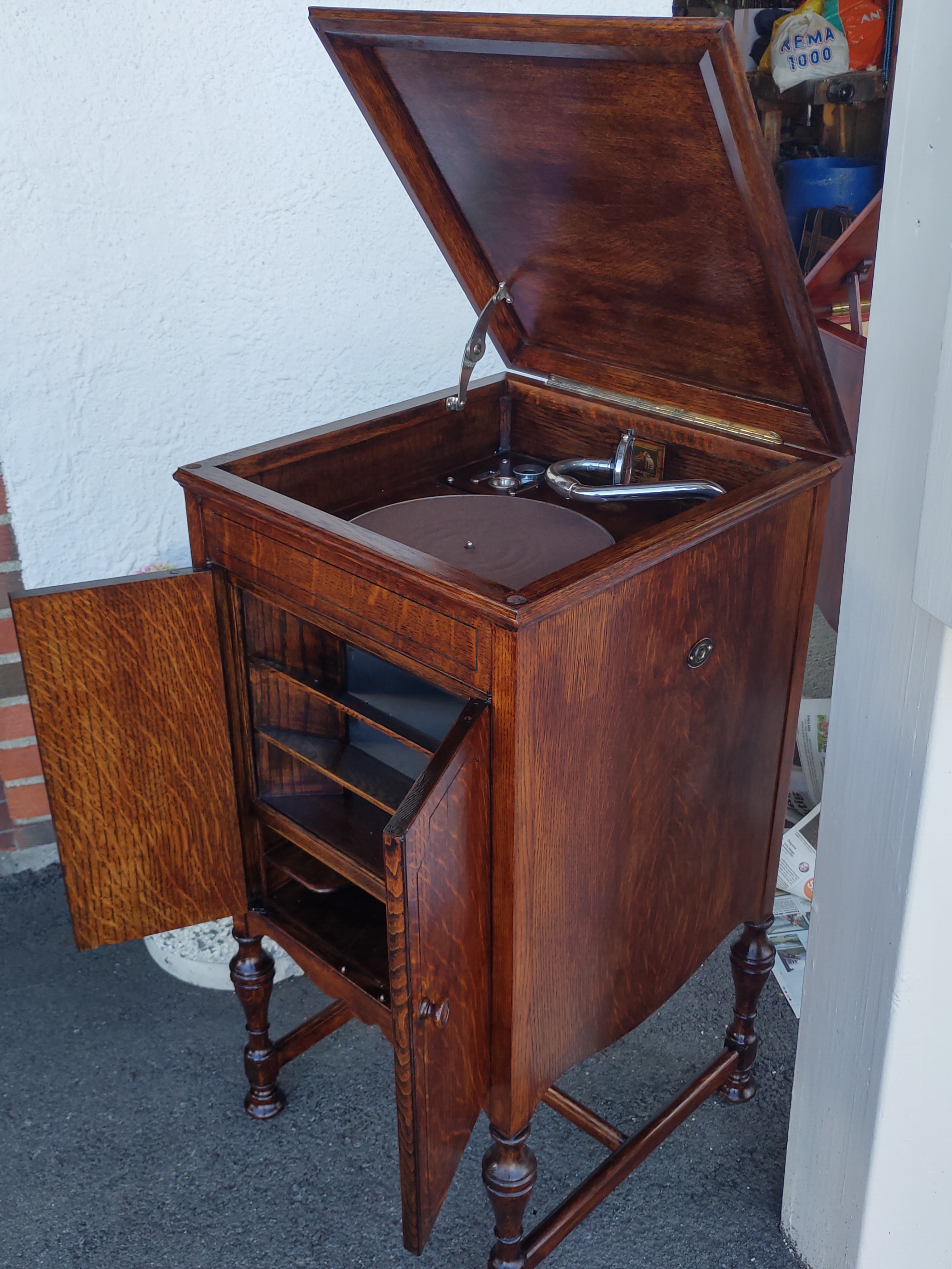

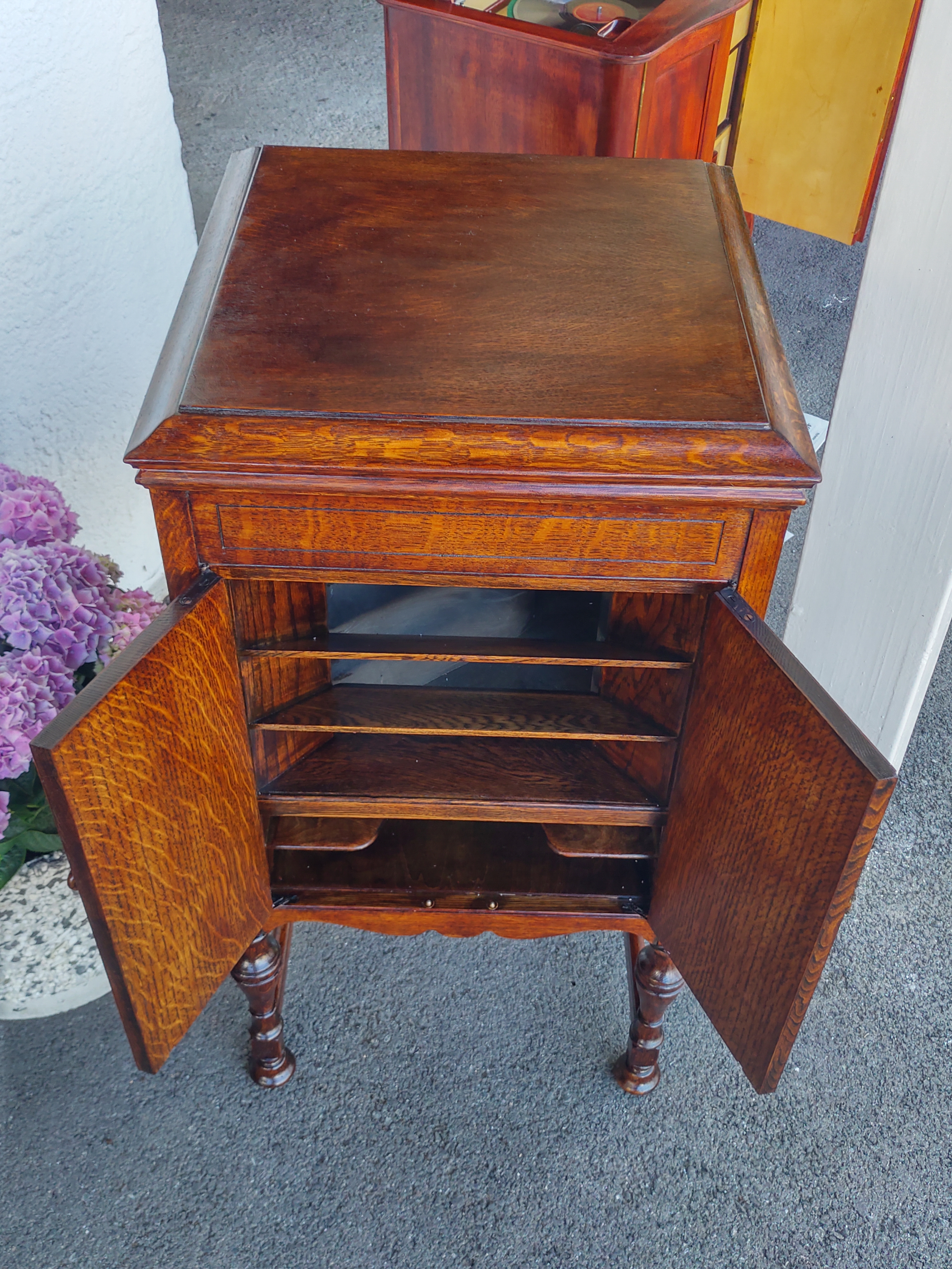

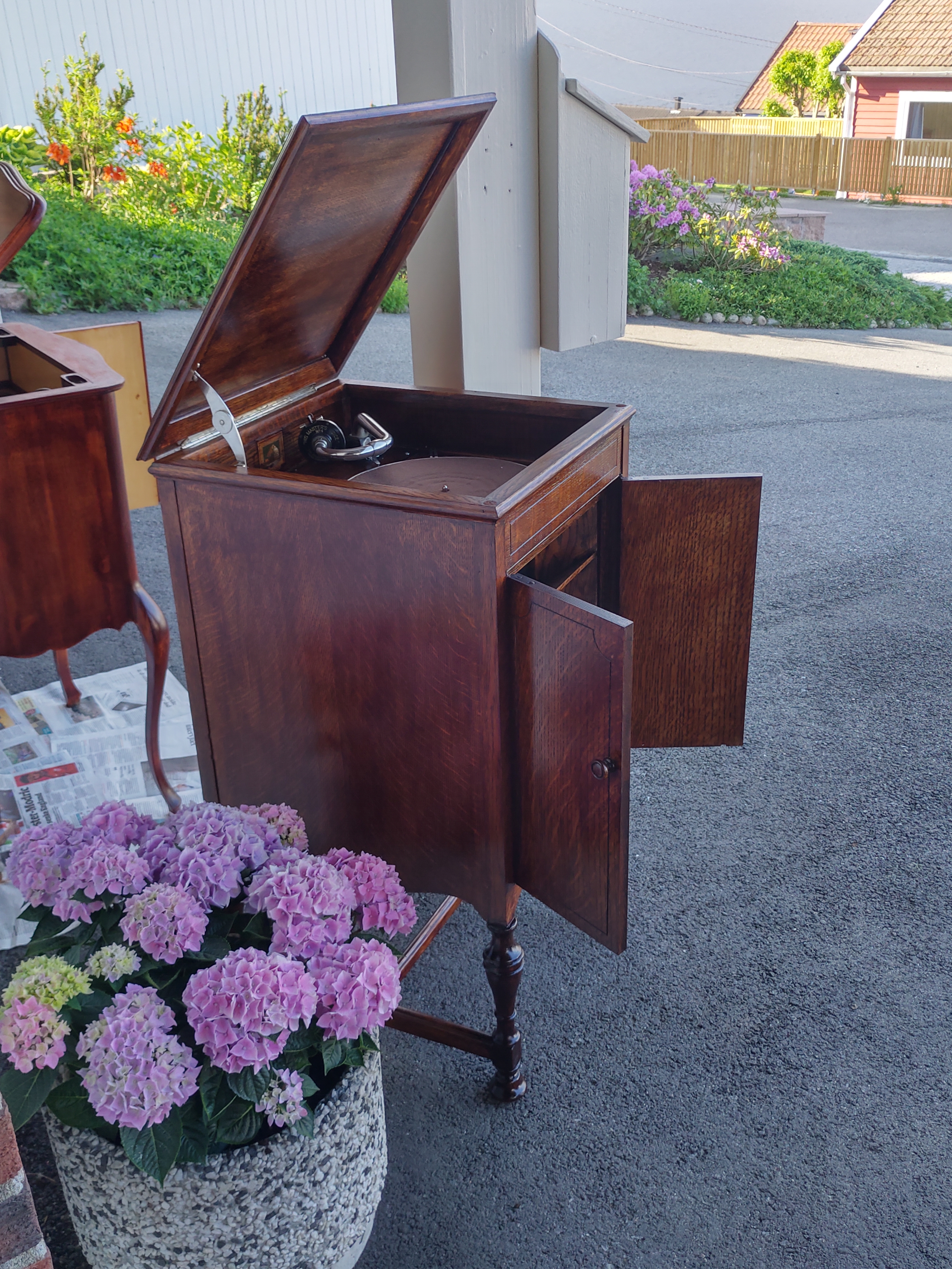

But I also have this choice to make..which newly restored Model 156 to keep. I am posting both here, so you can see them both in the same post. The mahogany model has been carefully sanded to remove some scracthes on the doors and on the top lid, but has not been stripped, only cleaned, and adding Howards Restor-A Finish and wax.
Mahogany 156.jpg (117.06 KiB) Viewed 1815 times
