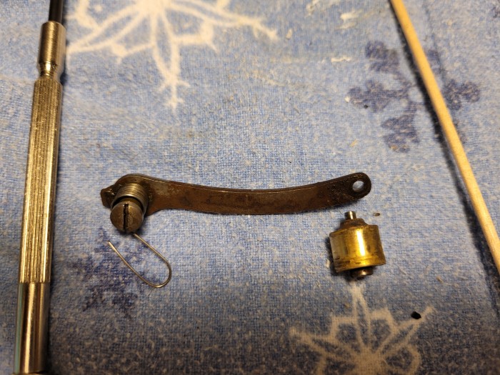

Next dumb question - is the idler wheel rotating on a shaft - the dimple in the center of the roller, or is the whole thing rotating together? I got it moving (took the bracket off), but I can see the shaft rotating inside the bracket, not inside the roller... Thank you

Well, the belt just snapped, looks like it was rotted in one spot for some reason... Ordering a new one.
The idler roller - its shaft moves a little in the bracket. When the flattened piece moves just a slight bit into the bracket, it gets stuck in the hole. Do I just flatten it more with some hammer tapping??

Can someone confirm that the shaft is indeed broken, and should not be rotating inside the bracket?
Well, it finally broke :(

Nonsense to have an axis and not rotate on it... I'd try to make the pulley unfreeze, maybe with penetrating oil, and free its rotation on the axis. Then, try to fix the axis to the lever again, maybe with a bit of soldering...

Inigo wrote: Wed Sep 08, 2021 5:35 pm Nonsense to have an axis and not rotate on it... I'd try to make the pulley unfreeze, maybe with penetrating oil, and free its rotation on the axis. Then, try to fix the axis to the lever again, maybe with a bit of soldering...
As I already said, I have tried two different penetrating oils, I tried soaking it in strong degreaser, and I also tried heating with heat gun. All I did was break that poor shaft off the bracket.
I am ordering new bracket and pulley, along with new belt.

zhenya01 wrote: Wed Sep 08, 2021 12:38 pm Can someone confirm that the shaft is indeed broken, and should not be rotating inside the bracket?
Good thing there’s still plenty of parts out there. I’ve had these incidents where I ended up spending more than I planned when I attempt to fix something so I definitely know how you feel. (Try to find a new tonearm bracket for a VV 2-60 I’m STILL looking for one of those) Trying to make a bump free belt is a bit tricky, which is why I use a GE water filter O-ring on a couple of my Standard machines and I’ve had 0 issues so far with those. I’ve also seen folks make belts out of duct tape but that’s never worked out for me…
