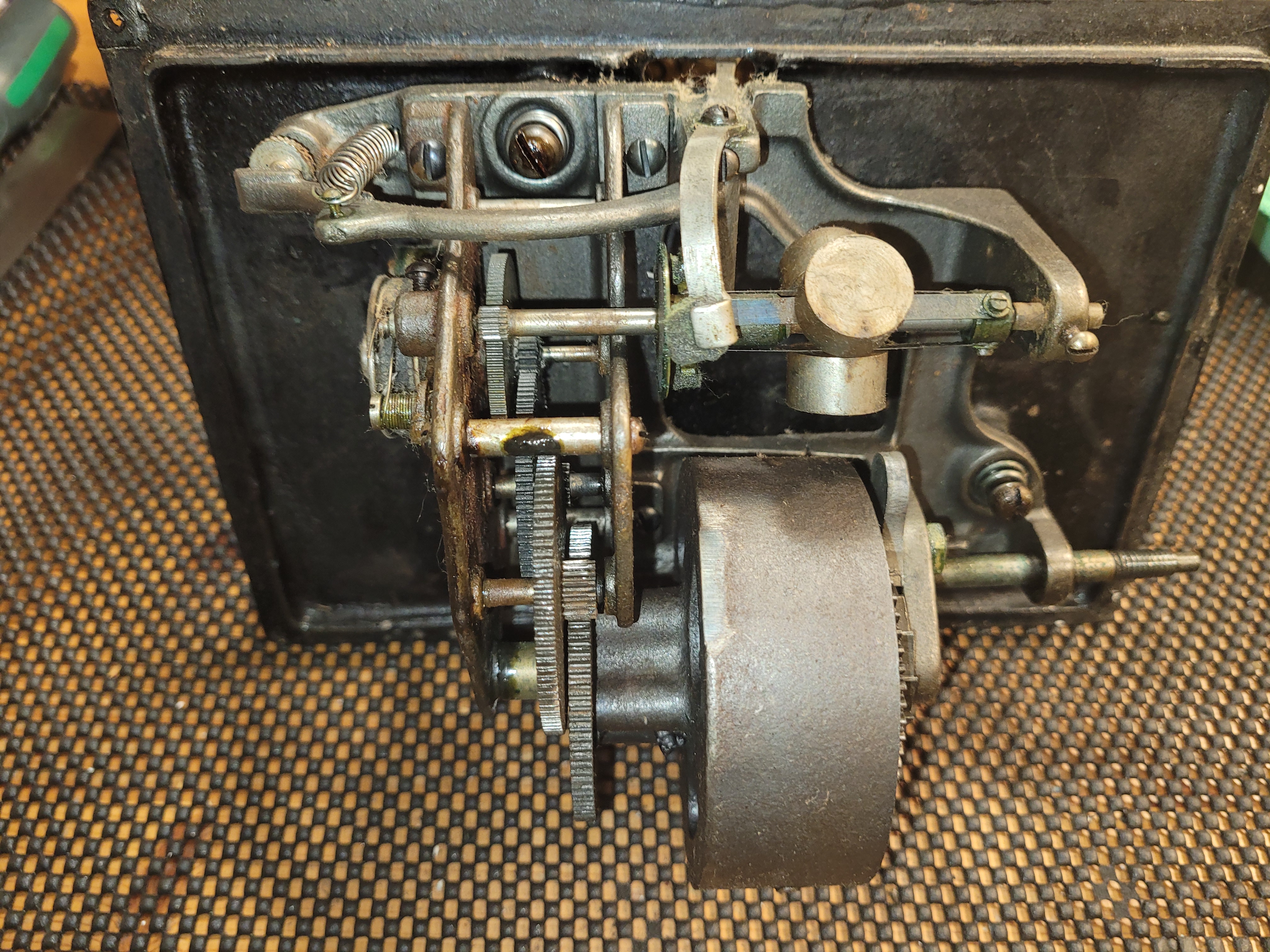

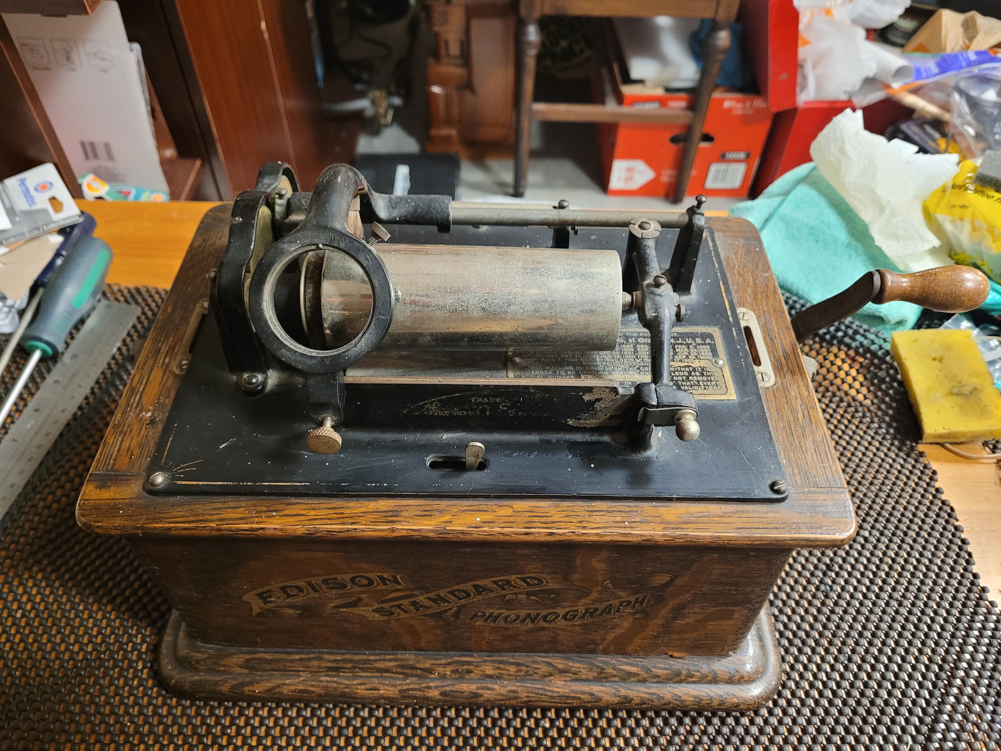

Hi all, I finally got to my Edison Standard Model B that I got a year ago.
Last Christmas I had Steve Medved from Florida rebuild the Type C reproducer, so that part is done.
I pulled the mechanism with bedplate out of the cabinet. It is pretty amazing, no rust, all oiled inside, and some dust bunnies.
There are no worn or damaged gears, belt feels to be in good condition.
The top part of mechanism definitely needs cleaning, polishing and oiling.
I have been reading instructions that Steve sent me, and Eric Reiss's book all evening yesterday to figure out what to do now. Also just started reading articles on antiquephono website, and will take a look at available stickies on this forum.
I'm a total newbie to crank phonographs, so any advice is more than welcome.

My advice for the top works is to make sure that the carriage can slide on that rod as freely as possible. If you haven't taken apart of one these before I would definitely recommend taking good pictures of it before hand so you know exactly how it goes back together.
Good luck!

Your machine looks to be in good condition, but the gears look dry. Instead of oil, use a good brand of automotive grease on them, synthetic is fine. Get it running as smooth as possible and if it makes any clunking noise while running, the springs will need greasing as well. Before you attempt that, read tips on the forum and ask for help, since working on the springs can be dangerous. Don't keep your machine completely wound up when not in use, but don't let it run totally down either, as it may cause the springs to unhitch from the main drive shaft. Good luck with your project.
Thank you for the detailed advice. Do I clean the gears before lubing them? They look clean and as you said, quite dry.
I assume, lube on the teeth, and light oil on the shafts/axles? That's what I did with my jukeboxes so far.
The spring is what scares me the most. I have read quite a bit about unwinding and lubing it, and it does feel intimidating.

Welcome! Welcome! Nice “banner B” there from either 1905 to mid 1906!

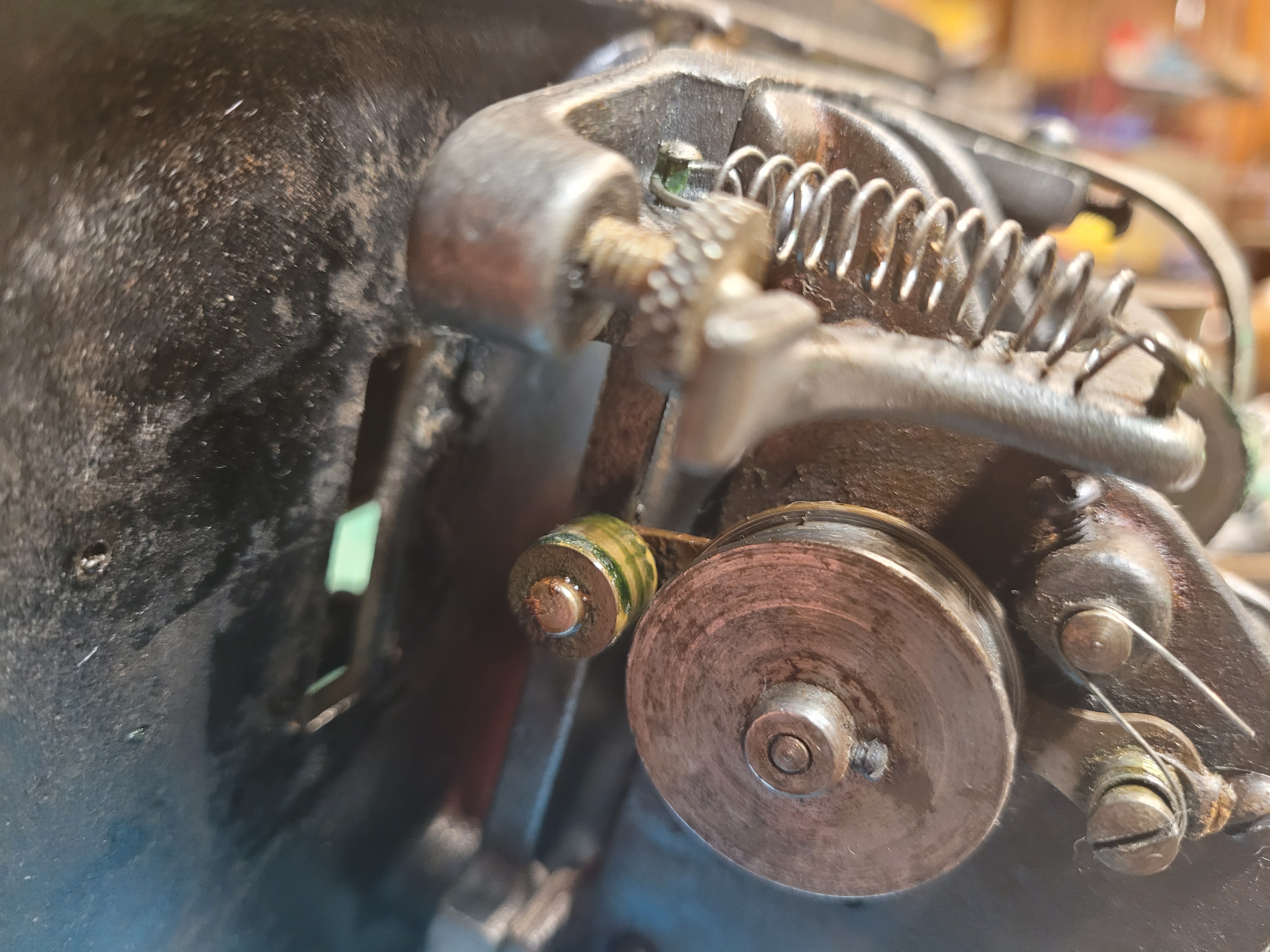

Correct me if I am wrong, but the smaller wheel that provides pressure against the belt (on the left in photo) should be rotating freely? Mine is not moving at all.
Lucius1958
Posts: 4108
Re: Edison Standard Model B
Post by Lucius1958 »
zhenya01 wrote: Mon Sep 06, 2021 8:24 pm Correct me if I am wrong, but the smaller wheel that provides pressure against the belt (on the left in photo) should be rotating freely? Mine is not moving at all.
The tension idler wheel should indeed move freely: try some penetrating oil in there.
