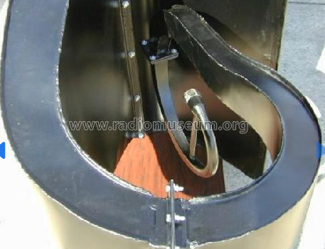

I wonder if anyone has the specifications (drawings, etc.) for the HMV variant executed in metal. I think I read somewhere that the HMV re-entrants included "narrower radius" turns in order to reduce radius lag and the consequent frequency distortion, but I can't recall where I came across it. As I recall, the outside radius wasn't necessarily shorter. The horn, in cross-section, was narrower for the same comparable radius, allowing less of a variance between the inner and outer radius of the horn's "bend", and that the horn's other dimension was increased accordingly to accommodate the necessary exponential rate of expansion of the total area. See image as an exaggerated example of the shape discussed. (Credit to the RadioMuseum.org for the illustrative image herein.)
