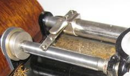

Ok, I did a Google image search for Edison Triumph Model B, and they all show the same nickelled plate that I pictured above.
It was on machines with a horizontal and angled carriage, so my conclusion is that you need to get one for your Triumph because yours is missing..
To be honest, if this was my machine I'd try and source a horizontal carriage, a Diamond B and an adaptor ring for your C and H.
That way you'll have a machine that's capable of playing any standard size 2 or 4 min black wax or celluloid cylinder.
If you eventually added a Model B, you could play brown wax cylinders too.
It would definitely be a worthwhile investment, and the good thing is you can pick up everything one at a time as different things become available and affordable.
You'll probably find the half nut you have is ok, and it's skipping now because there's probably only about ⅓ of the nut making contact with the rod.
Once you add that nickelled pressure plate, the whole surface area of the nut will be driving the carriage across and not just a small section of it.

Yeah. That’s probably my problem. I’ll wait until I get paid next week. And get one with that part still attached.gramophoneshane wrote: Sat Jun 18, 2022 2:06 am Ok, I did a Google image search for Edison Triumph Model B, and they all show the same nickelled plate that I pictured above.
gramophoneshane
- Posts: 3463
Re: Triumph problem #2 tracking.
This is one of the images I found, and as you can see, it has the same bar and half nut arrangement as yours, so all those parts appear to be correct.
Personally, I'd only get the pressure plate but just make sure the adjustment screw is present.

He's missing a part from the top of the half nut assembly so no amount of adjustment is going to fix the problem until the top piece with the pressure adjustment screw is replaced.

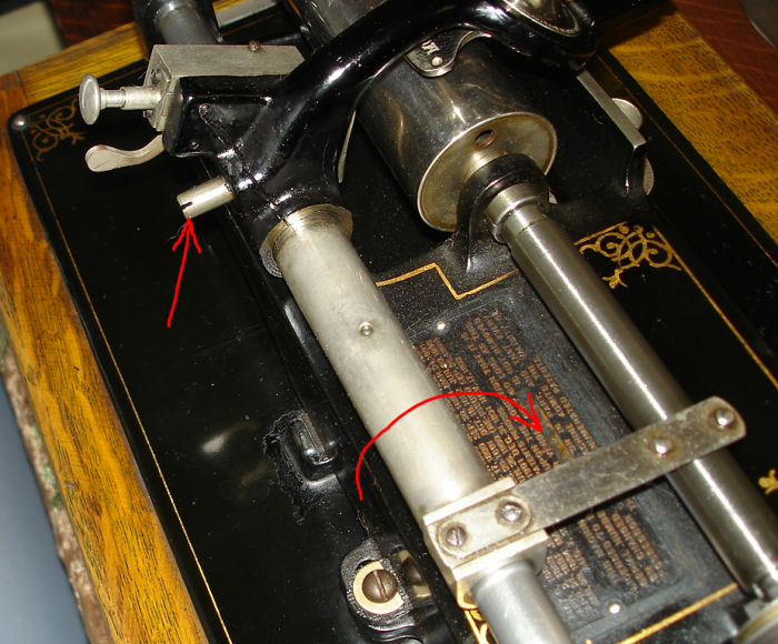

The video isn't very helpful since there is no cylinder mounted or play attempted and in the 4 minute play mode it's difficult to see the carriage moving but let us presume by the video that your carriage is not moving at all. So, this first suggests that the half nut is not making contact with the feed screw.
If you examine the picture from Jerry Van (repeated below) you must loosen that carriage screw which will allow the carriage "tube" to rotate within the black carriage sleeve. Rotate the carriage "tube" carefully and slightly downward within the sleeve and you will see the half nut begin contacting the feed screw while the carriage is in playing position. It will take some "playing with" to get the adjustment correct but it CAN be done with patience. Applying trial and error you will eventually get the half nut tension correct so that with the carriage in playing position the half nut will advance on the feed screw. Again, this takes time and patience but you can do it. When the carriage "tube" is adjusted correctly to play a cylinder you can tighten up the carriage screw on the back of the carriage and you're all set.
Doug
