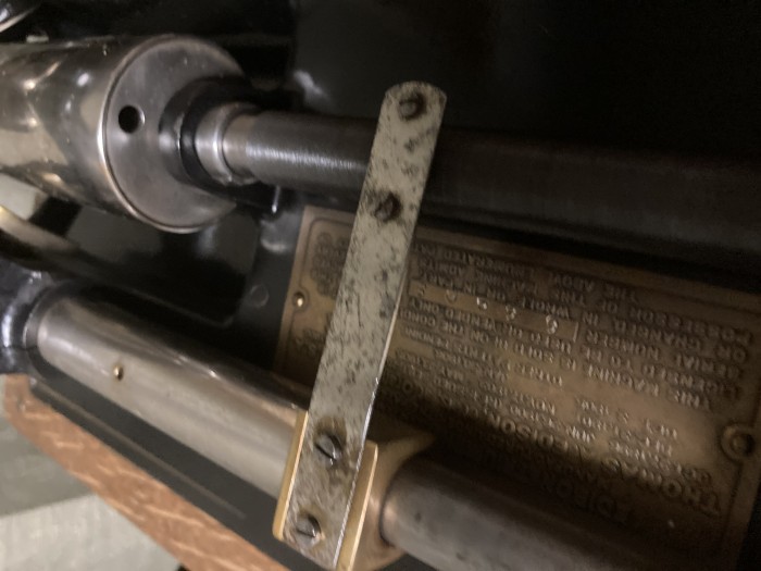

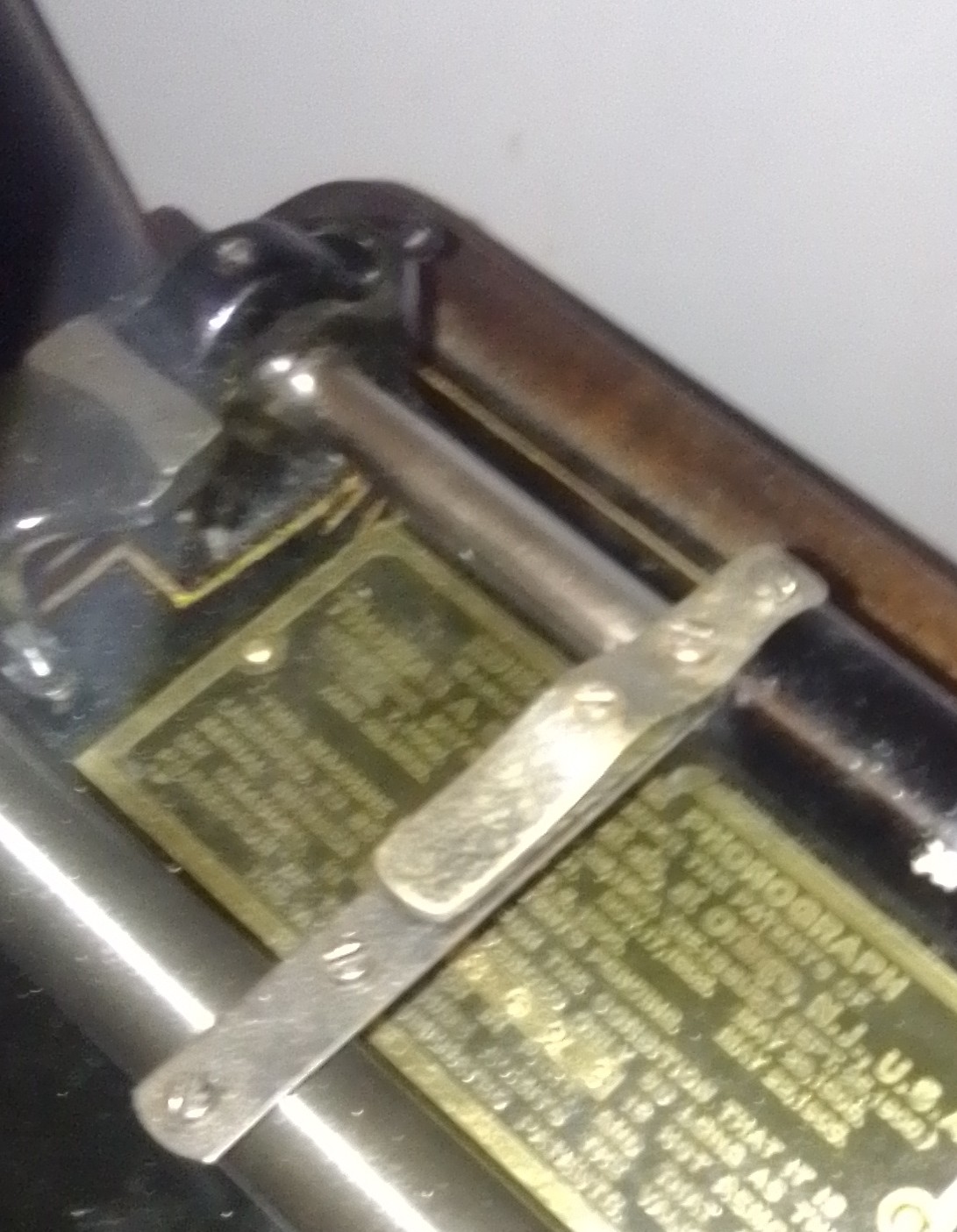

Here’s a photo of them.
gramophoneshane
- Posts: 3463
Re: Triumph problem #2 tracking.
Looking at your photo, I noticed the arm that holds the half nut is missing the nickelled top plate which holds the pressure adjustment screw.
Do you have that or is it missing?
It's that silver plate that ends in the middle of the half nut arm.
That holds the pressure adjustment screw that applies pressure to the arm so the half nut is pushed downward and stays seated on the threaded rod.

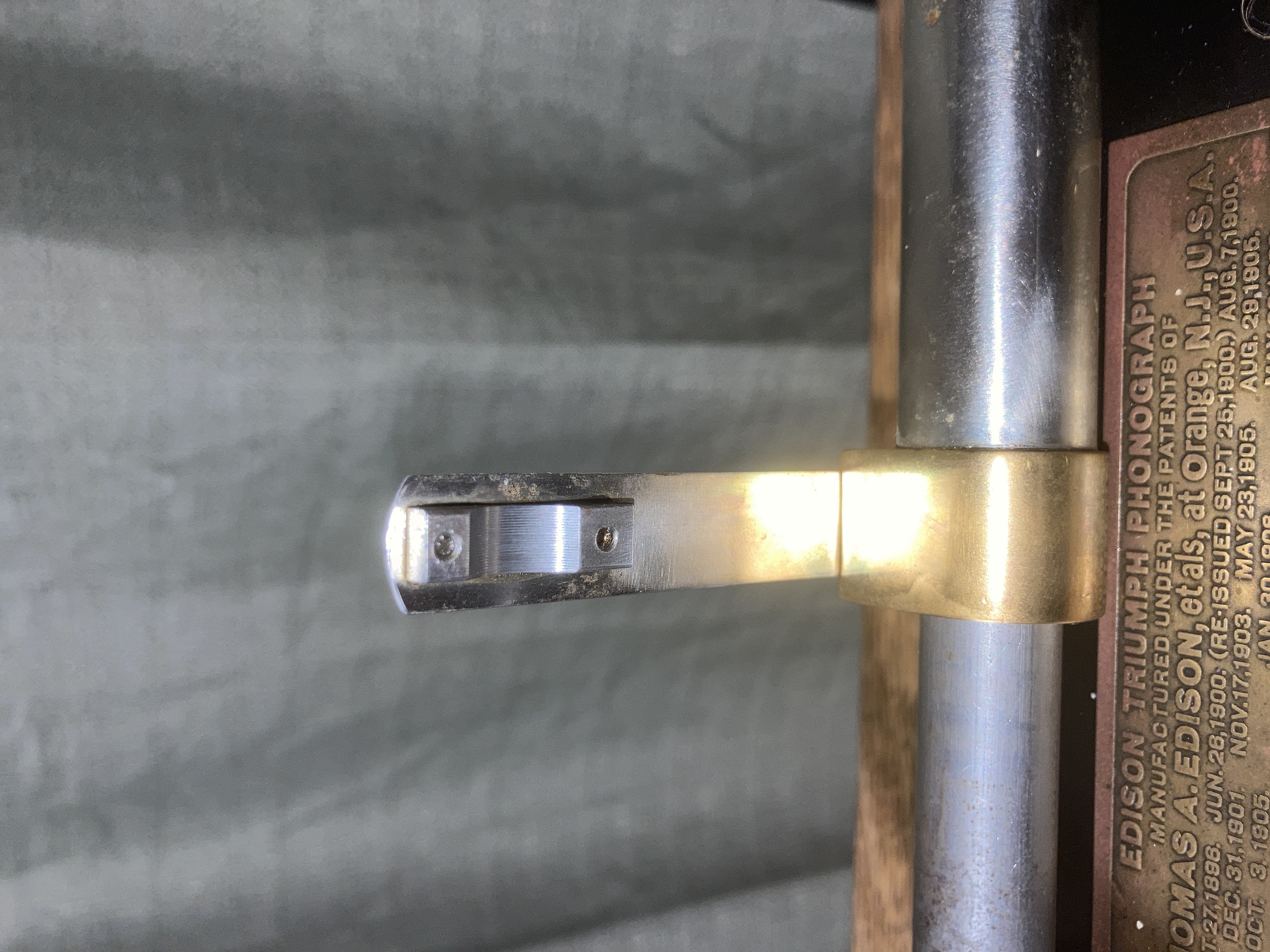

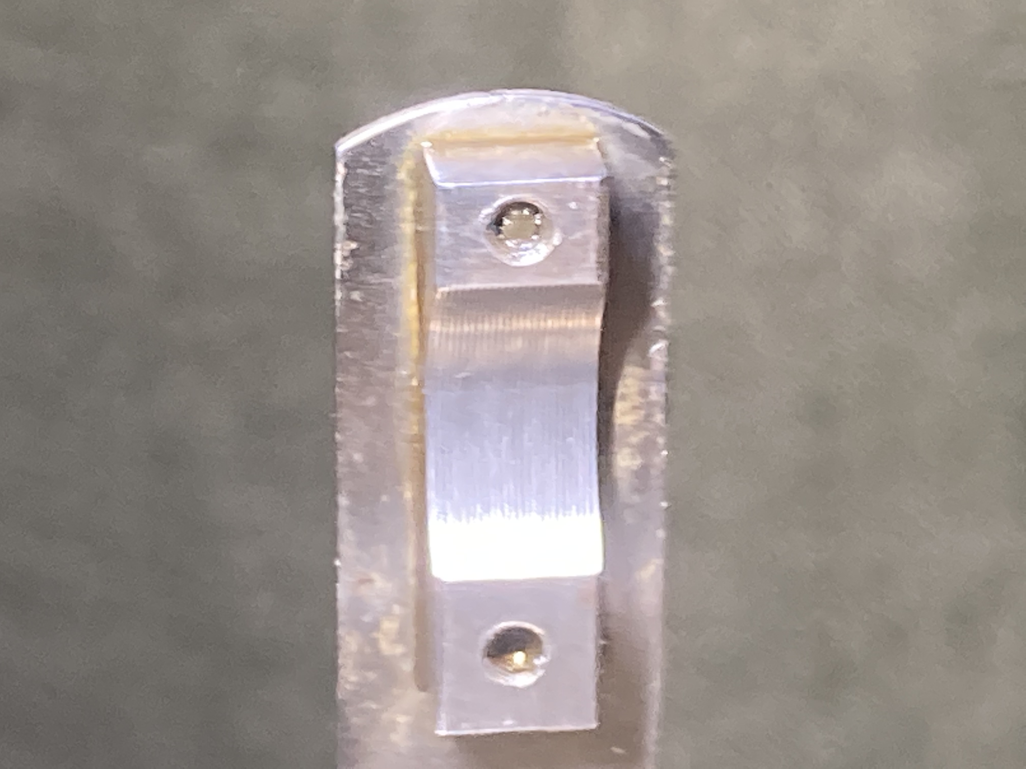

Here’s a closeup of the half nut

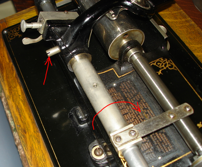

My picture above is actually my Home, but all my Homes and Standards, as well as my spare carriages all have the same or similar plates with the pressure screw.

It's pretty difficult to tell from a picture and even in person, how warn a half nut is, to me anyway.
Sometimes it's easy because half the threads are gone and it's warn smooth, but other times it's not so obvious.
I've never owned a Triumph, but looking on the internet, some Triumphs have that plate and others don't.
The ones that don't however, appear to have a different half nut bar to yours.
These have 4 screws holding the half nut, and the bar itself is kind of divided down the middle, so I'm not entirely sure if you're missing that top plate, or even if yours is the correct half nut bar.
It looks to me as if the 4 screws are really holding 2 half nuts, and that brass casting the bar screws onto is completely covered by the bar which means you bar is narrower than the 4 screw 2 nut variety.
