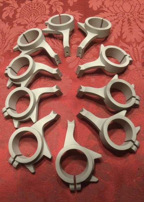

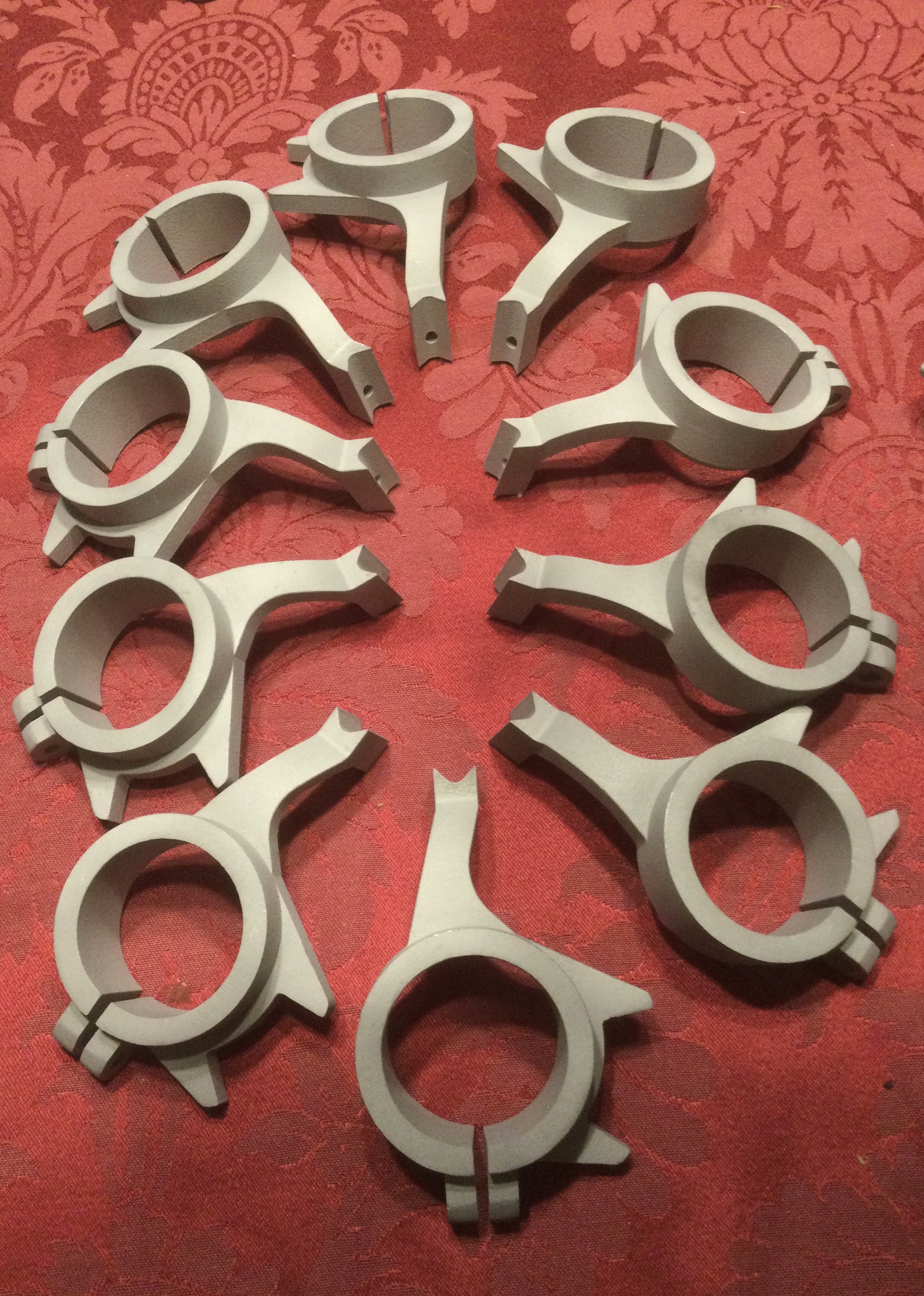

The other possibility is that the new tone arm collar casting is out-of-spec. The dimensions are critical to proper operation. As noted, this part controls many functions.
If you’d like to try a new casting I have perfect aluminum replicas available. They were designed to function correctly. Unlike other attempts they were NOT recast from swollen and out-of-spec original pot-metal parts. No-filing needed, ready to install!

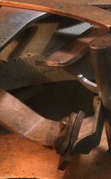

Here is a close up of the trip mechanism. The Victrola setting is accomplished by the ratchet pawl being lifted clear of the ratchet by sliding under the index cam. Note the rounded end of the pawl.
Regarding Seth’s index lever not pointing the right way. That is because the internal pot-metal index assembly is broken and disconnected. Seth has asked me to send him a new assembly. We hope to have his machine up and running soon!
