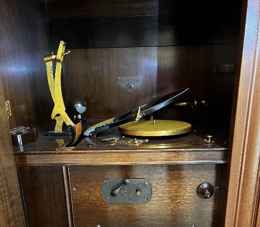

Hello all, just acquired a really nice Victrola 10-50x and was wondering if anyone still made replacements for the pot metal parts? My machine works fine, but the tone arm looks like is set on 12 inch records. the lever to change to a 10 inch record turns but there are teeth missing off of the gears in the back so it is not switching. Anyone know of a way to manually switch it to 10 inch records? Any help would be greatly appreciated.

You should be able to access the switching gear assembly by taking off the back panel. At the end of the switching assembly there's a plate with three notches (if I recall correctly) with each notch corresponding to 10-inch, 12-inch and "Victrola" (manual setting, with no record reject) settings.
You should be able to position this in the 10-inch notch with a little bit of figuring which is which.
I've sent a PM regarding replacement parts.
Good luck with your project!

For what it's worth- the indexing handle on Seth's seems backwards. Mine points the other way... e.g., the little pointer points to the 10, 12, Victrola, and not the handle.
While we are on the subject of 10-50s... mine works perfectly except when I select "Victrola" it jams the tonearm and I can't figure out why. Any ideas?
