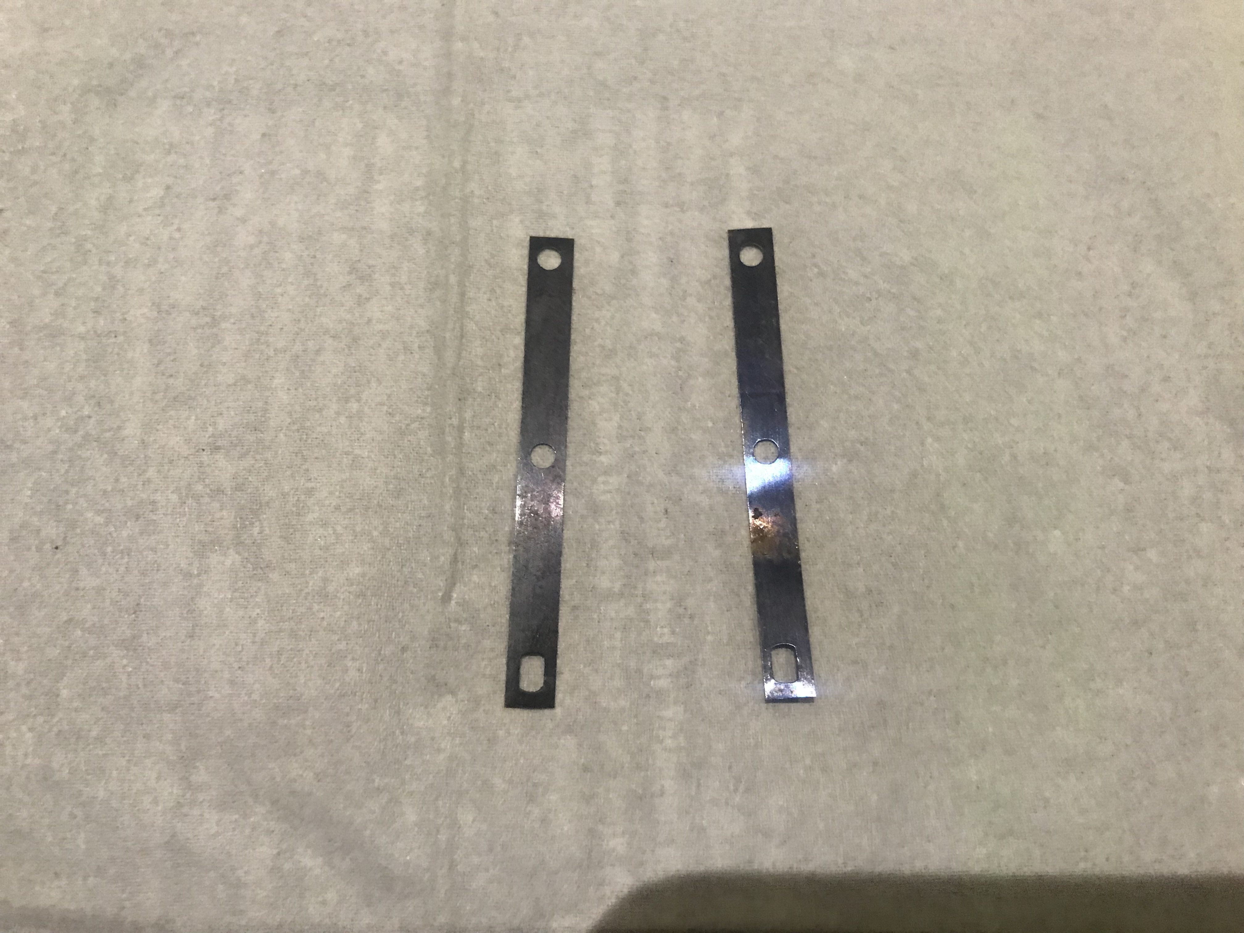

I’m all in favor of finding ways to fix things. The hardest part with the springs is learning how to re-harden and properly temper them after punching holes in them.
I’m forgetting the exact thickness at the moment, but all the governor springs I’ve measured thus far are the same thickness. When I get to my notes tomorrow, I’ll try to post here.

Hello friends, I am very delighted to see how my message has generated a discussion which, started from a trivial matter, has expanded to a range of broader issues of passion, aesthetics, functionality, culture, and values. It is great to read how we respectfully differ with one another and still offer space for a variety of opinions.
In my own right I feel like presenting you the context of my experimentation with the spring leaf followed by my opinion on some of these broad issues.
i. Of course, I understand simple economics and I am conscious of quality but governor spring for Swiss motors (533, single spring, double spring etc), commonly available in Pakistan, are not generally available on line.
ii. A few suppliers in Europe supply a set of 3 spring leaf for a minimum of Euro 15 + freight charges, and the total cost comes to about Euro 25. Most of the vendors have refused to supply the springs in ordinary envelopes. At least one vendor in Holland with a large inventory insist on insurance as well.
iii. Vendors invariably required the buyer to pay either through PayPal or a bank account. PayPal facility is not available in Pakistan. For Bank transfer, an equivalent amount is charged by the bank as the transaction cost. This means one has to spend about 50 Euros for a set of three springs.
iv. Often springs when received are found inconsistent with the required size. Returning the springs to the vendor means spending 30 Euros to recover 15 Euros.
The above points only deal with the mercantile aspects of procuring spares for gramophones and necessitates that an indigenous solution be found out. But there are other aspects of such DIY projects, which, many of friends here have already mentioned, encourage such ventures.
i. Understanding how a machine works, attempting to grasp the technology, and making a serious effort to do a near to perfect repair and restoration work is a hugely satisfying phenomenon.
ii. There is subtle difference between a hoarder and a collector. A collector lives through his/her collection. He/she knows inside out of the valuable possession. He /she does not sit idle when no support is there to help restore the aesthetics or functionality of the valuable. Then he/she creatively explores the ways of achieving the objective.
ii. In the process of doing the job, the tools (jig or a punching medium) one makes or uses are not always necessarily unprofessional in nature. For instance, the jig which I use is of superior metallurgy. I will share the pictures of my tools here soon.

anchorman wrote: Sun Nov 13, 2022 6:30 pm I’m all in favor of finding ways to fix things. The hardest part with the springs is learning how to re-harden and properly temper them after punching holes in them.
Governor spring material is thin enough that my punch will make a hole without the need to anneal and then re-temper the steel.

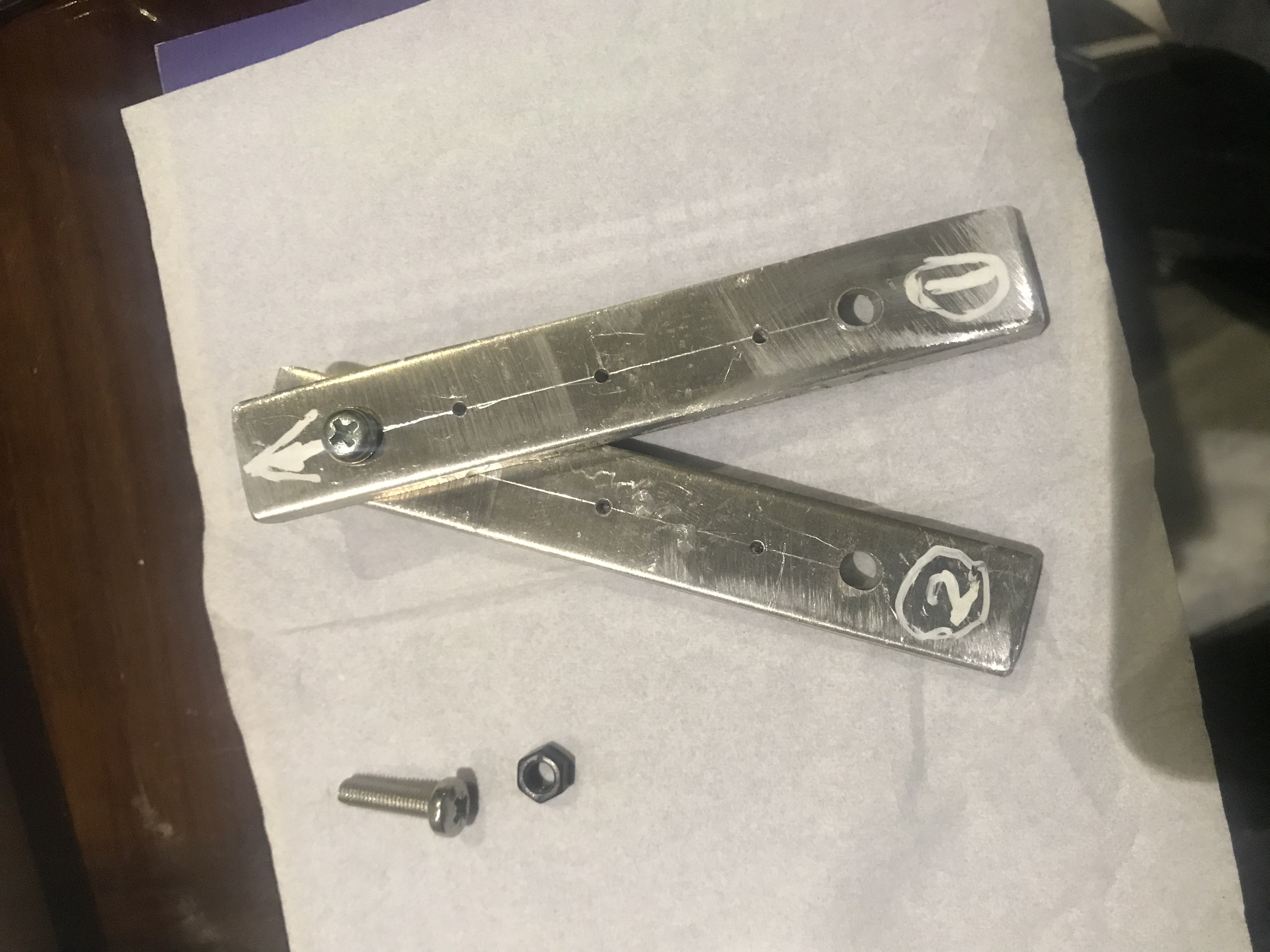

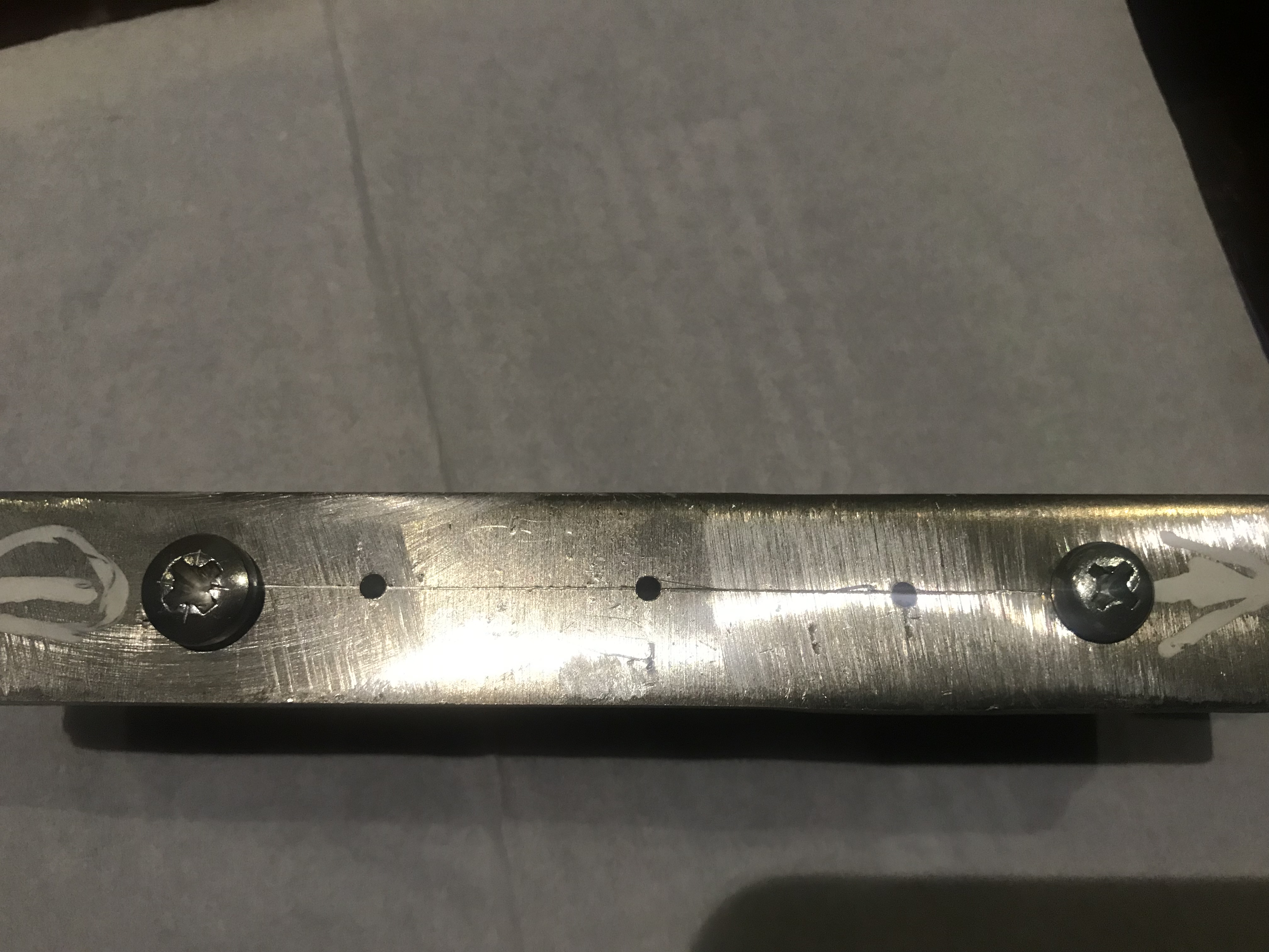

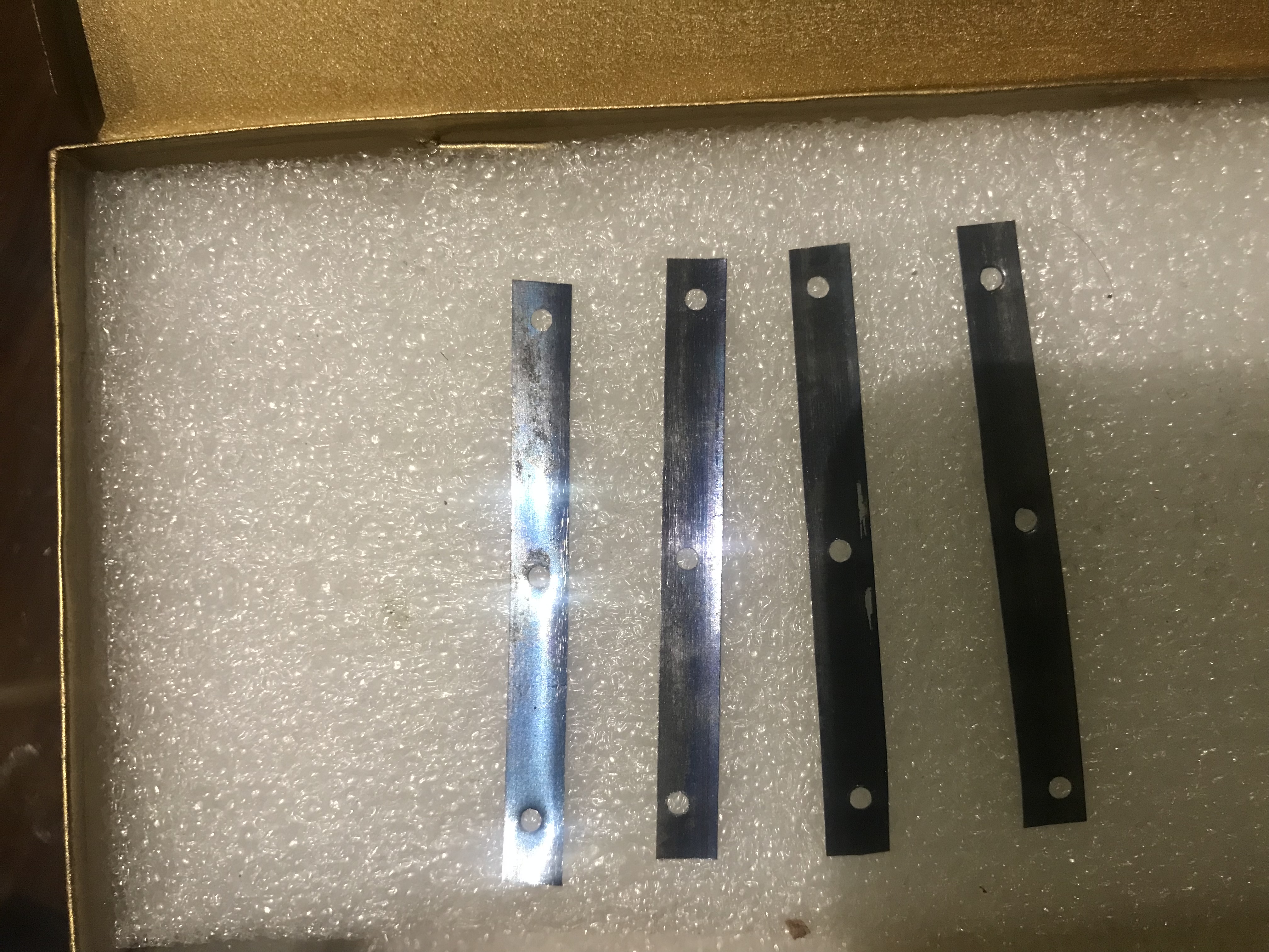

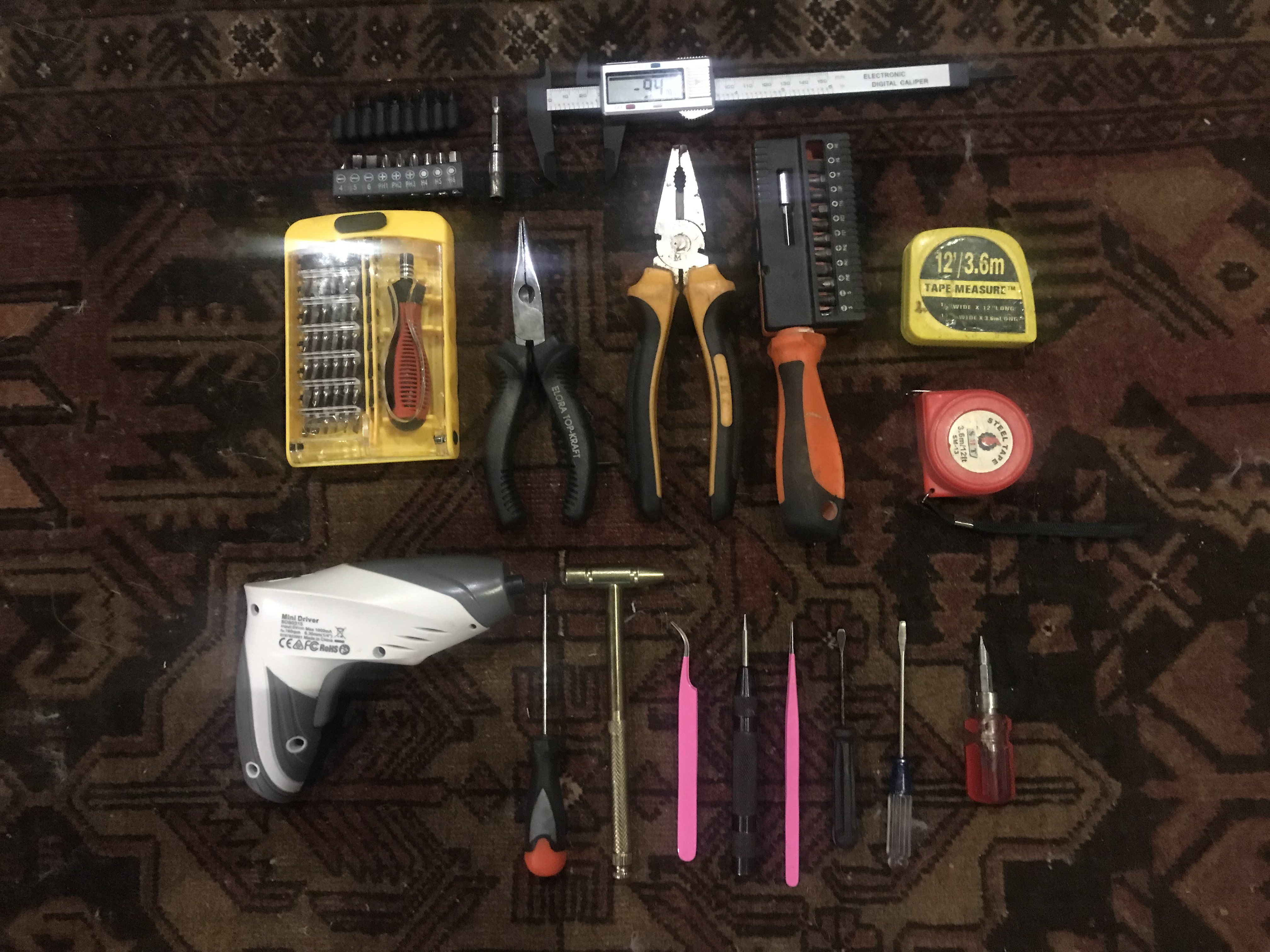

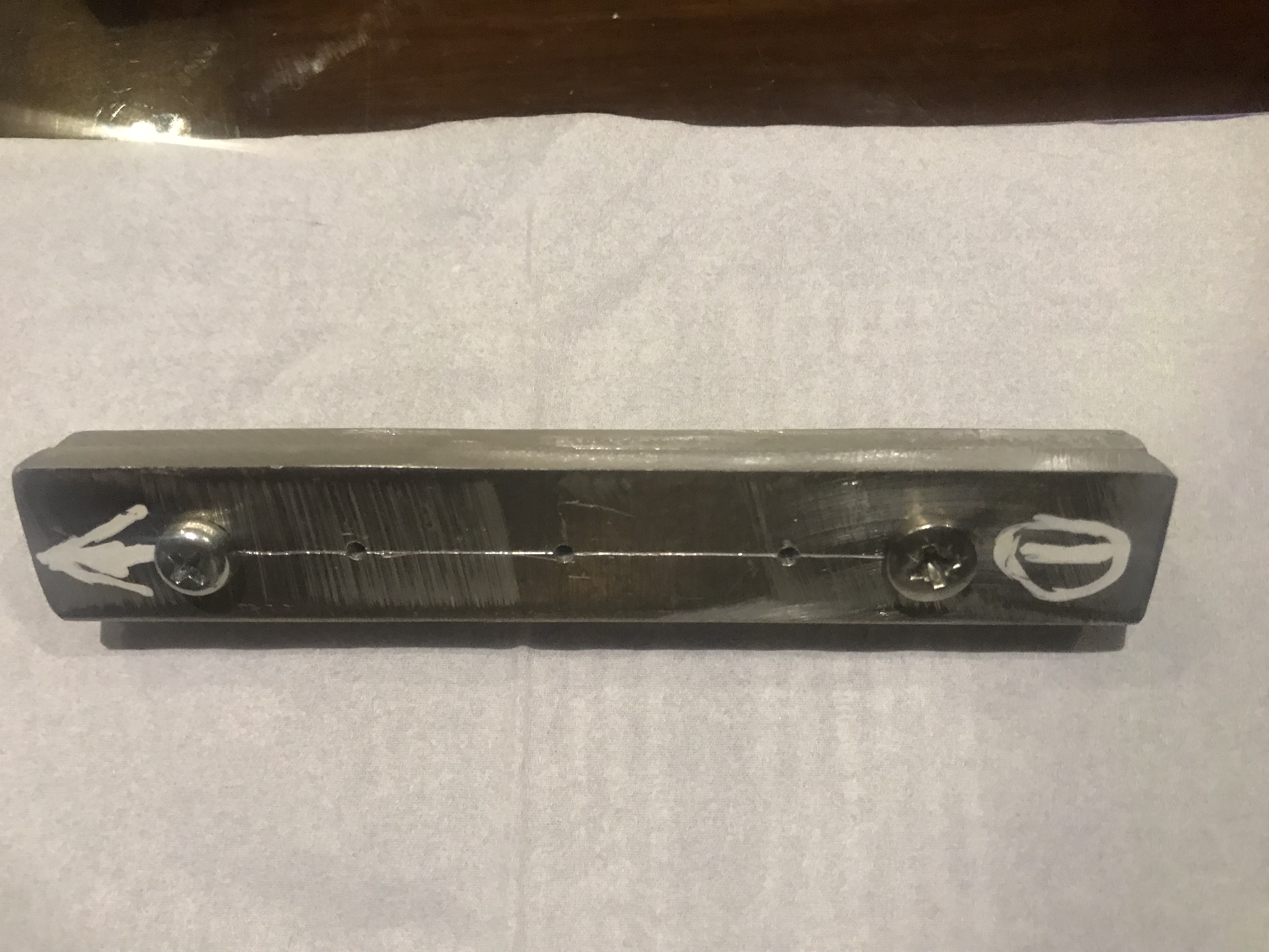

Here come the pictures which many of you have asked me to share
Tools
Tools
Spring leaves
Spring leaves
Spring leaves
Spring leaves
The jig
The jig
The jig
The jig
The jig
The jig

It's interesting that some people have poo-pooed the idea of making your own governor springs. Making governor springs in this manner is actually described in Reiss's Compleat Talking Machine book.
That being said, not all homemade governor springs are successful. I once bought a machine where a previous owner used aluminum strips cut from a beverage can for governor springs. That was a total failure. Those of us with affordable, convenient access to spare parts are fortunate. But it obviously is not that way everywhere on earth. :rose:

Those were amazing articles! As to your springs- I'm not an expert but they look top quality. Amazing craftmanship, if shipping wasn't so expensive, I would gladly buy from you.
