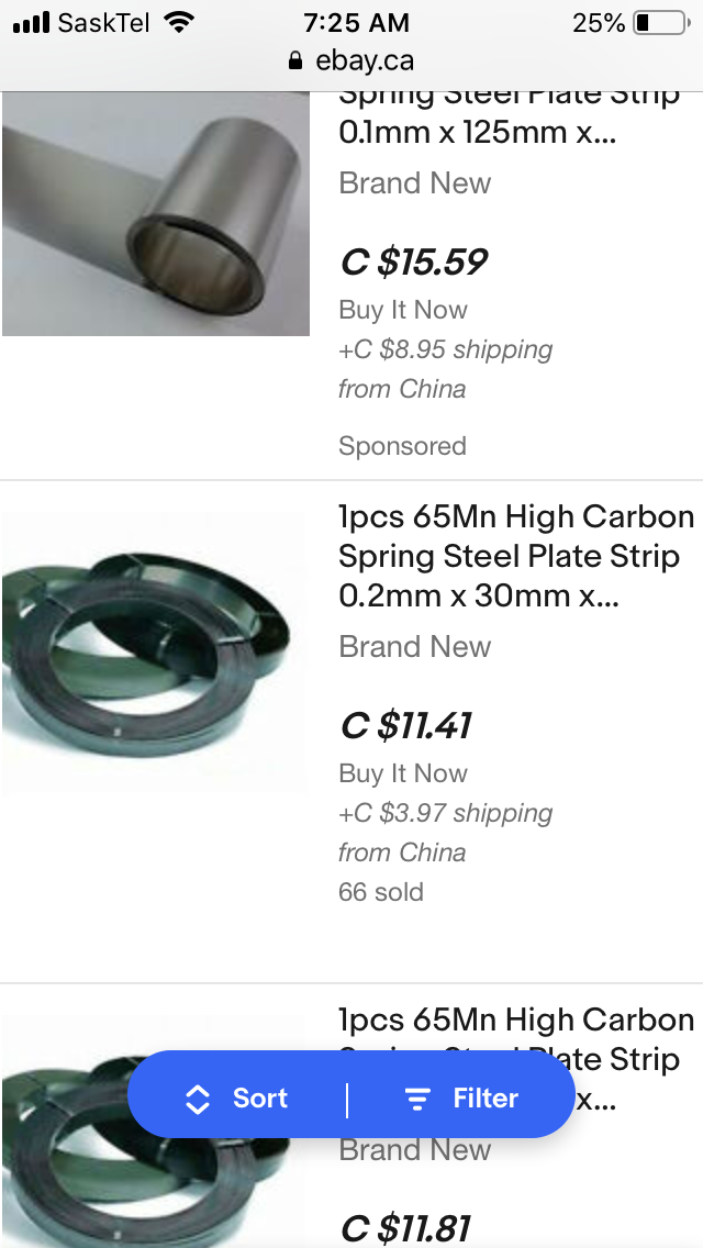

I forget the seller I bought my spring steel from, but just search for “spring steel strip” on Ebay, you will find all sorts of sizes and thicknesses for low prices and cheap shipping.
See screenshot.
See screenshot.
