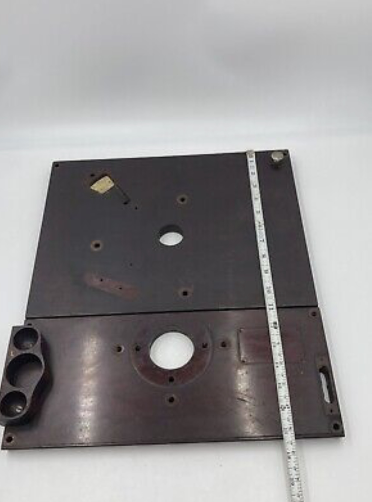

Sherazhyder wrote: Tue Nov 22, 2022 12:41 pmThere is no picture of the motor board above. I believe the motor frames were all machined for the speed indicator, whether they were equipped with them or not. However, since you say the motor board has the cutout for the indicator, then I suppose yours truly is missing.JerryVan wrote: Tue Nov 22, 2022 12:04 pm
You are certainly right but I think that the speed indicator mechanism was once there as the motor chassis has holes for its screw. The motor board (see the picture attached) has also cut out for the speed indicator.

Here comes the picture of the motor board which I forgot to attach last time.
If I correctly understand the arm is a link to the speed adjustment screw on motor board and speed regulator is for monitoring the speed via the pointer. Is this a correct understanding?
[/quote]
Hello , thanks for your assistance. I just uploaded the picture.
[/quote]

I believe your machine must have the speed indicator too. They added the celluloid scale for the speed, this is likely that it HAD a speed indicator. It's an independent set that can be completely detached from the machine without affecting its work, so likely someone disassembled it in the past, and it got lost.
