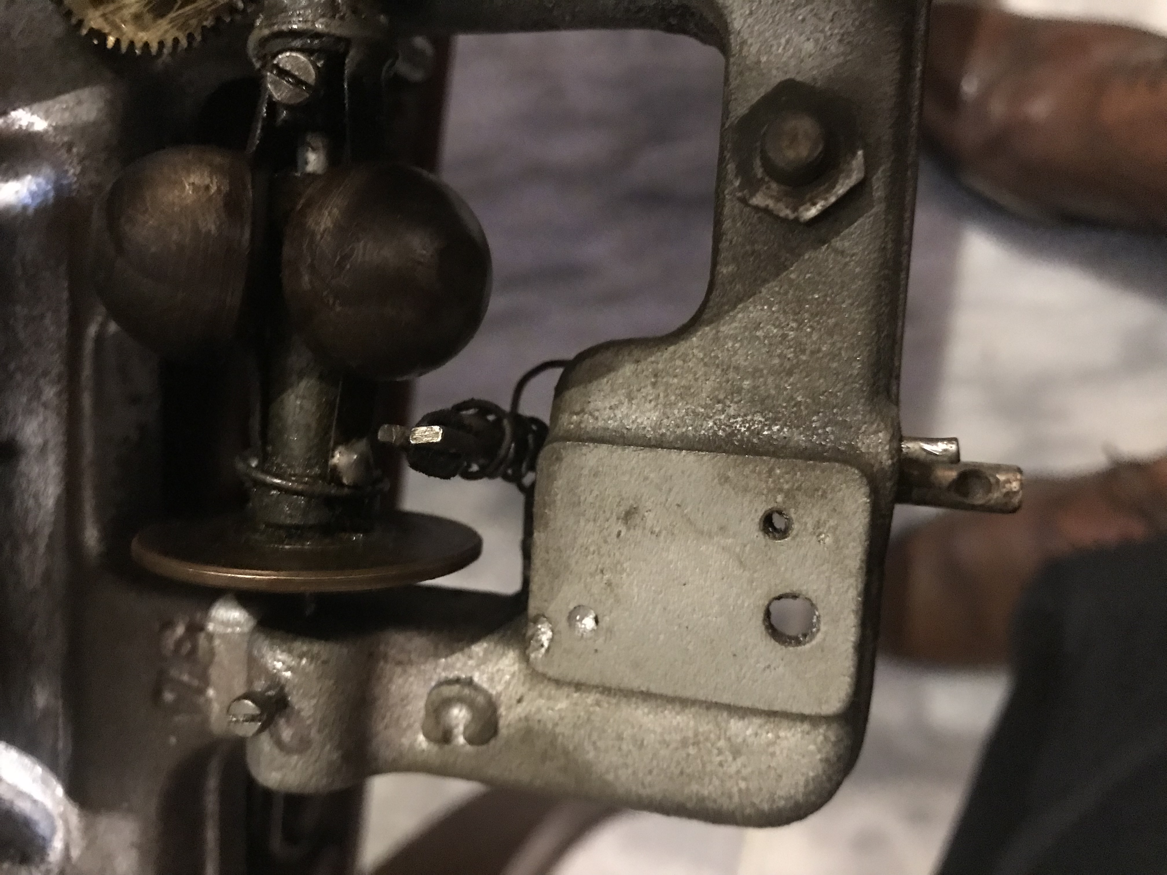

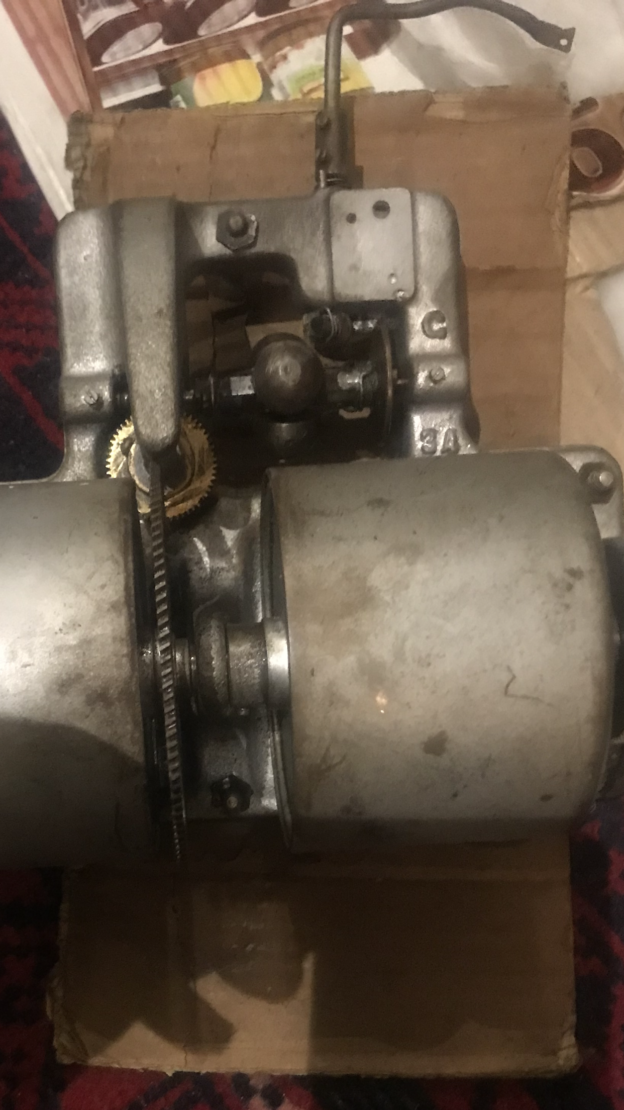

Here is the motor. You can see the regulator housing is missing and I am going to buy it. The spring arm linkInigo wrote: Wed Nov 16, 2022 5:12 pm A photo of the motor would help to settle things right... At least we'd know which motor is it, and what speed control it has...
has a broken spring and I do not know how does it work; how is it taken out and how is this spring replaced and arm installed in the motor. Your help will mean a lot. Thanks and regards

The speed indicator mechanism is not there, as you say. That doesn't mean it's missing. Not all motors/phonographs were necessarily fitted with speed indicators.Sherazhyder wrote: Tue Nov 22, 2022 11:01 am Thanks for your note. I have tried to remove the governor but its bearings have probably never been taken out and are jammed. I will use some lubricant spray to loosen it. Then it might come out.
What do you think about the board and machine? Is it not of Victrola XVI?
Will you please further enlighten me on the role of regulator (on the chasis) and of the arm with leather brake? Which of the two is tied to the adjustment screw and to the speed indicator? Any manual or photographs will certainly help. Your assistance means a lot to me since this is the first time I am trying to work on a Victrola. Thanks and best regards
Sheraz
The governor end bearings will be frozen in place from old, dried oils. Penetrating oils may help, but gently warming up the motor frame will allow the old lubricant to melt and release the end bearings.
As to the arm with the leather pad... Your leather pad is missing. The bit of leather is supposed to be clamped/pinched in the forked end of the speed regulator arm. A small piece of leather from a treadle powered sewing machine belt is usually ideal.
The spring that keeps tension on the speed control arm is there, but appears to be badly distorted. You'll need to reshape it so that at one end, it wraps around the control arm and the other end should hook onto the motor frame. The spring tension should act to push the leather pad against the governor friction plate.
The governor itself has been somewhat trashed due to previous attempts to repair broken governor springs. You'll need to do some of your "measuring tape" repairs here.

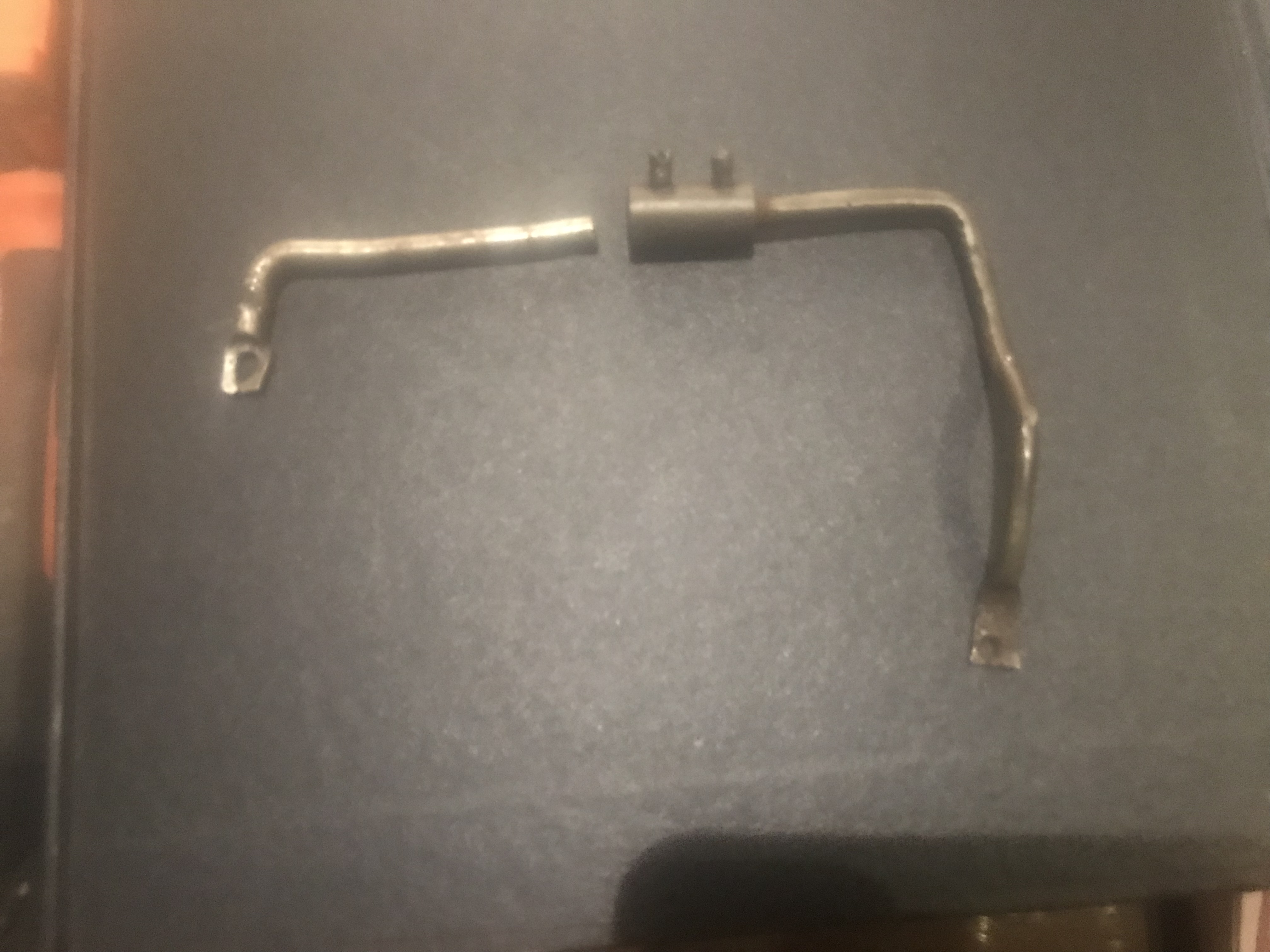

I have taken out both parts of the arm link. It seems damaged for the hump in the center and a hole on one side. I guess this requires replacement. I will buy both the arm and spring. But commissioning the spring will be challenging for me without any idea of it. Your assistance will be of immense value to move further on this project. Thanks
