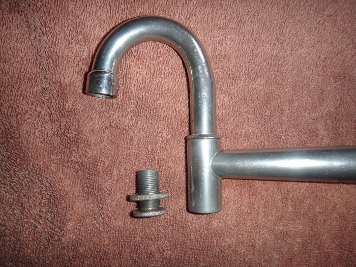

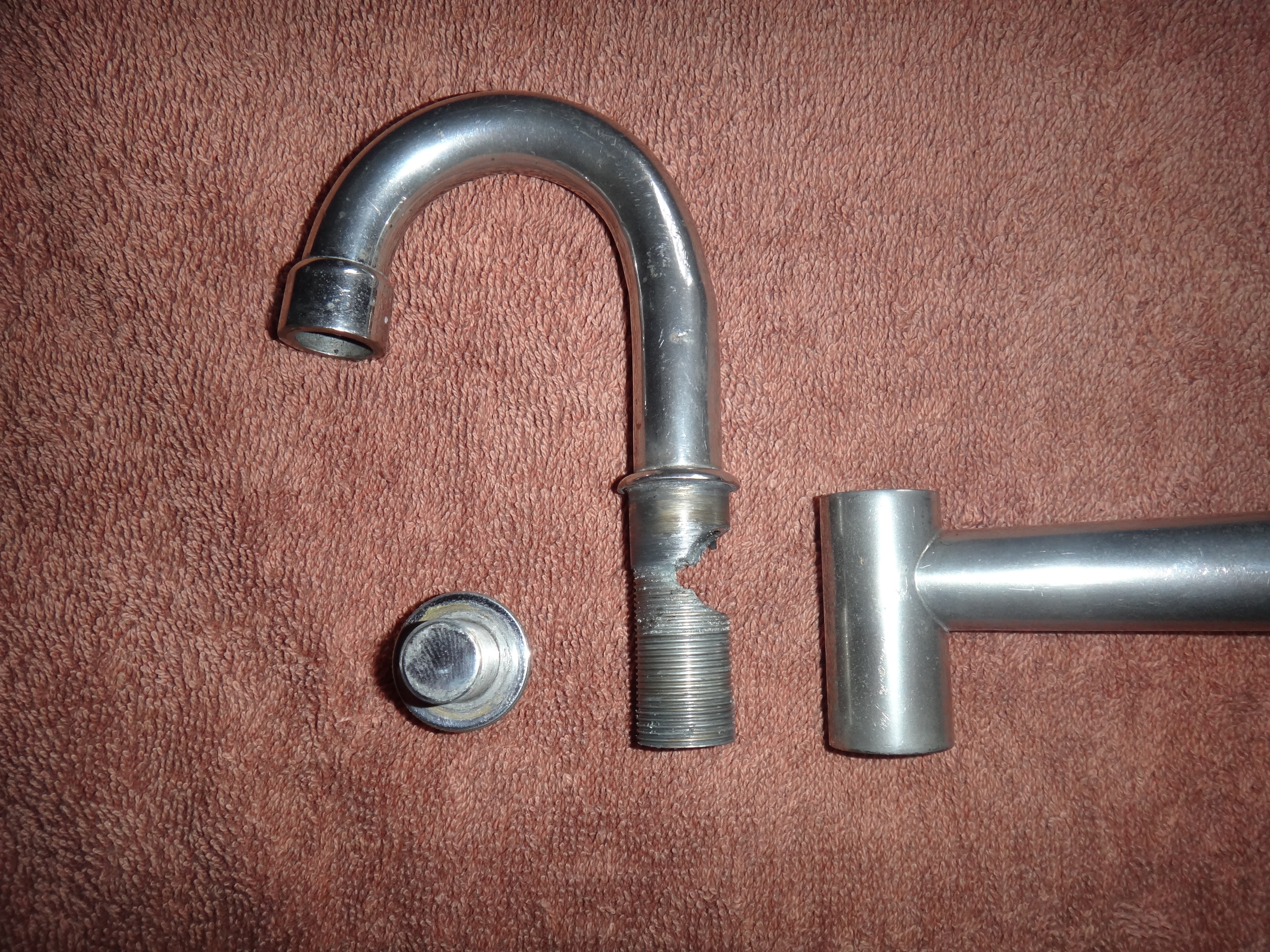

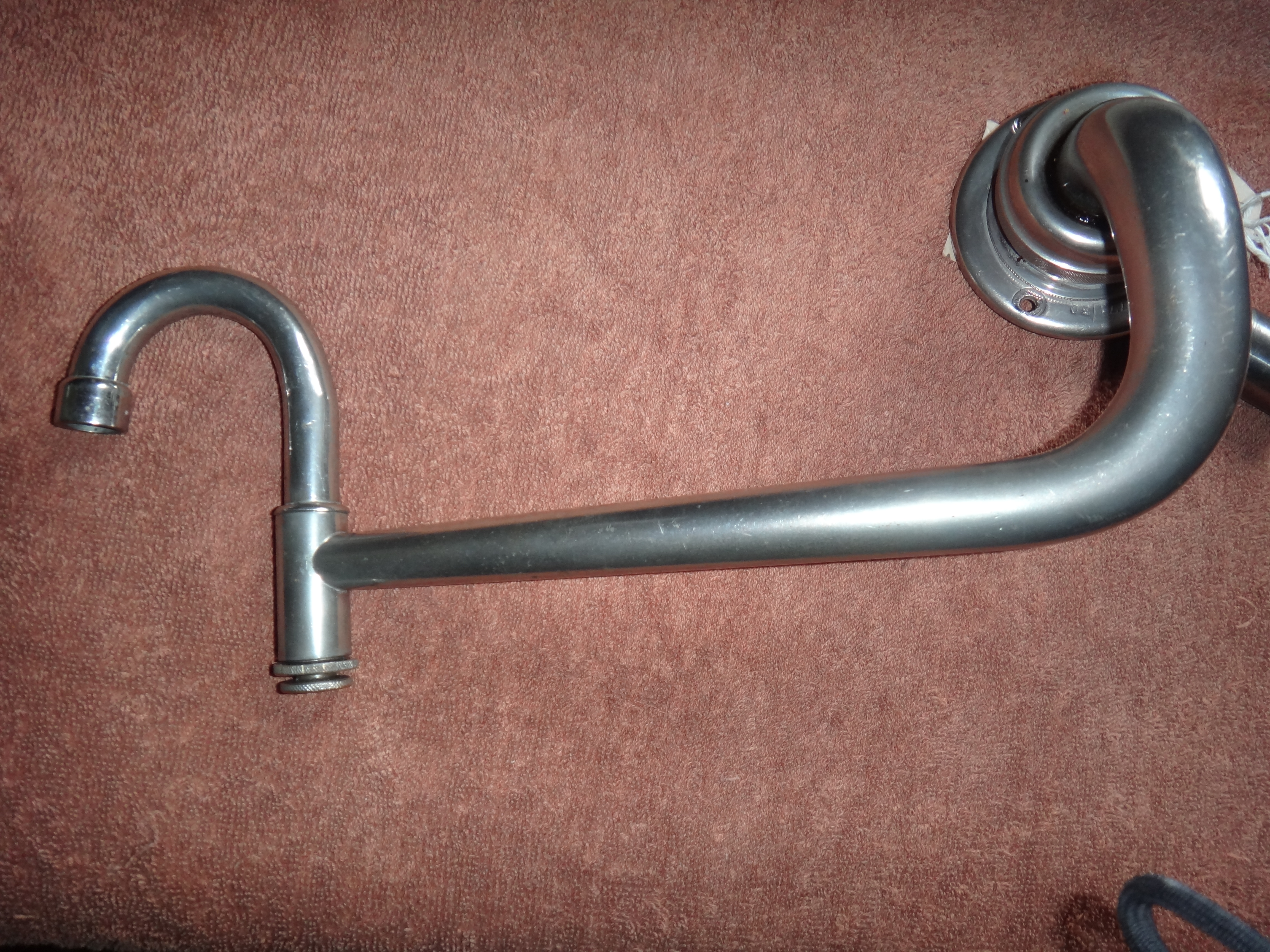

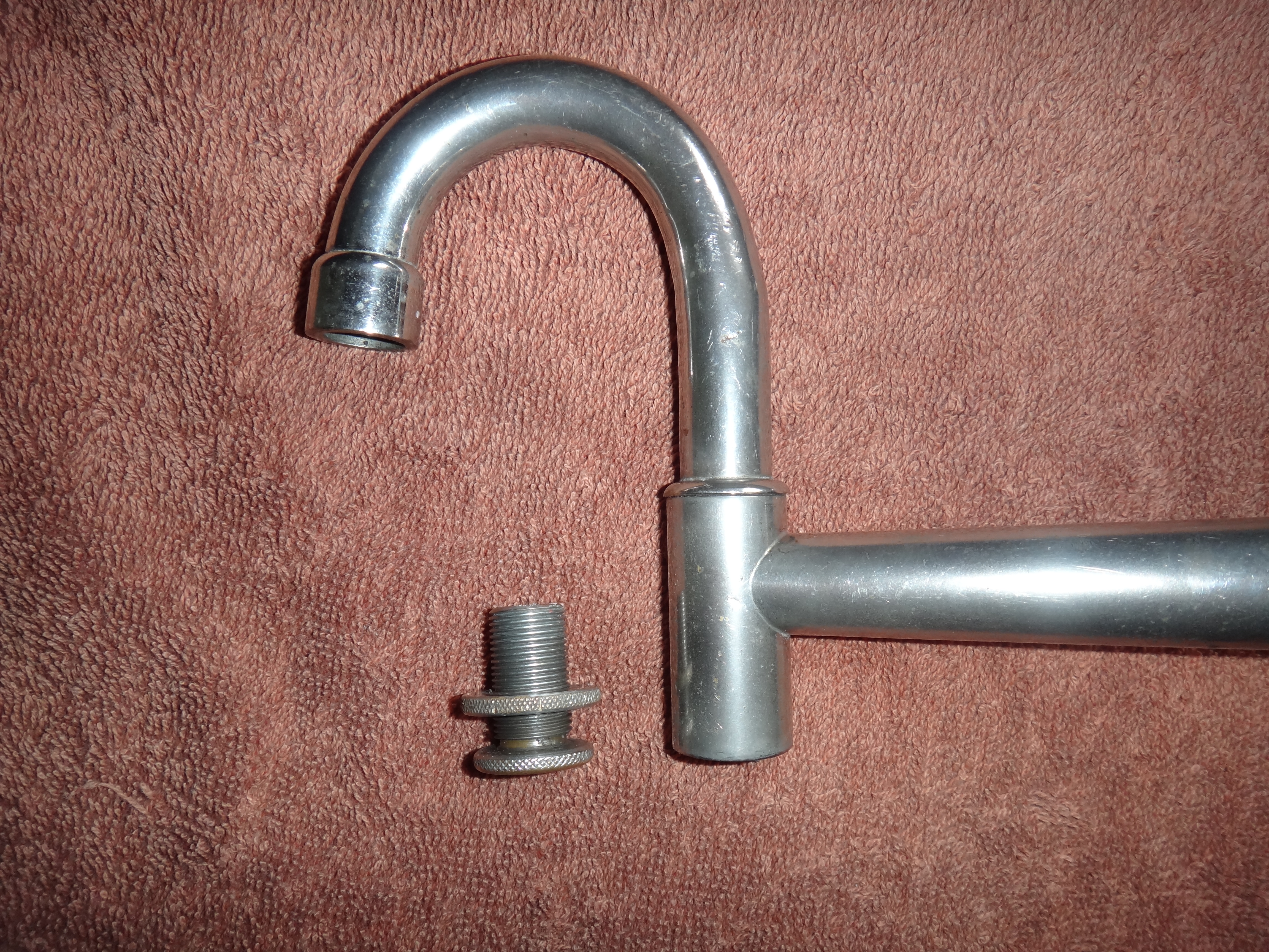

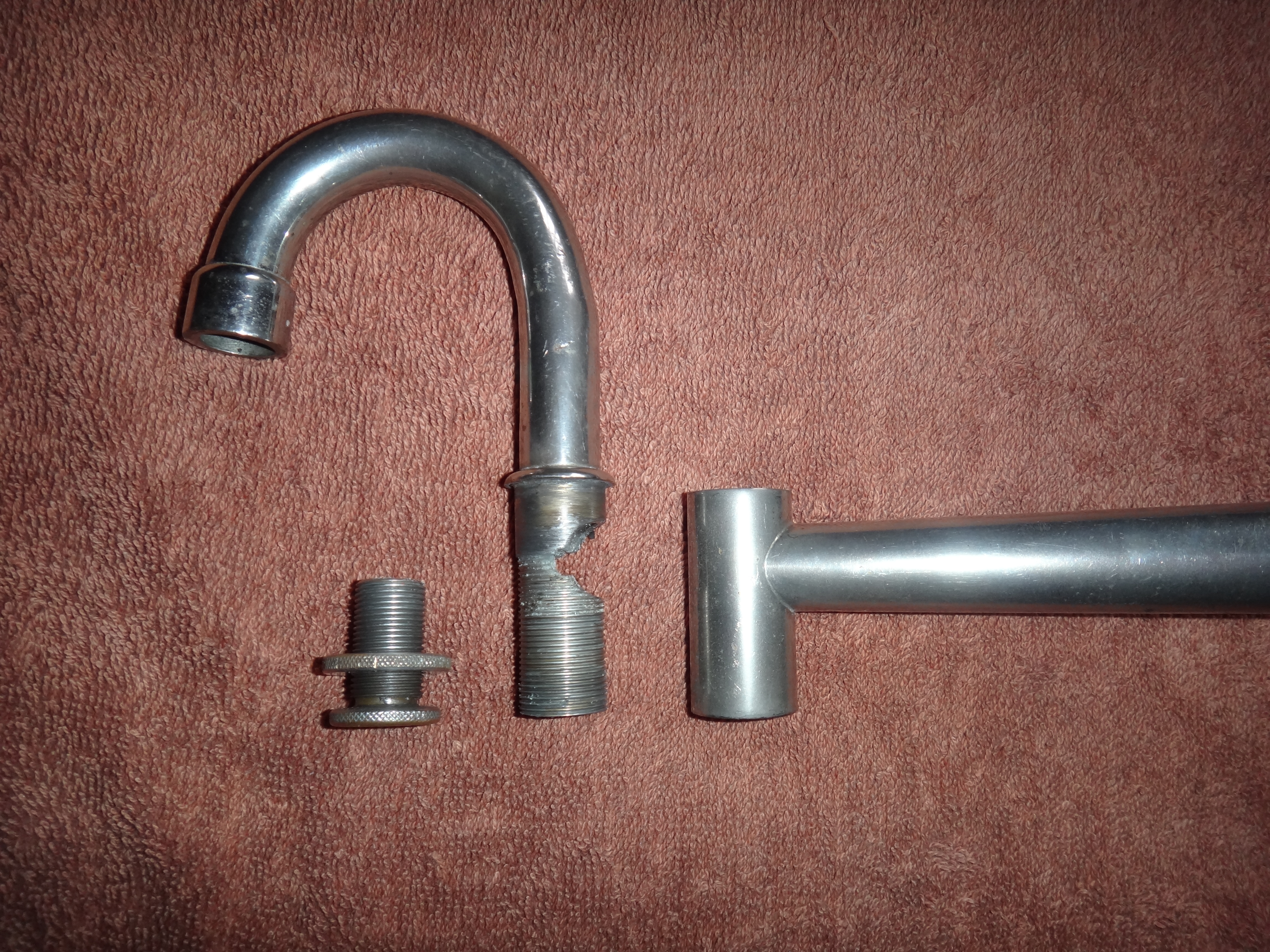

Here are the details of an Expert All Range tonearm complete with "Quincke tube".

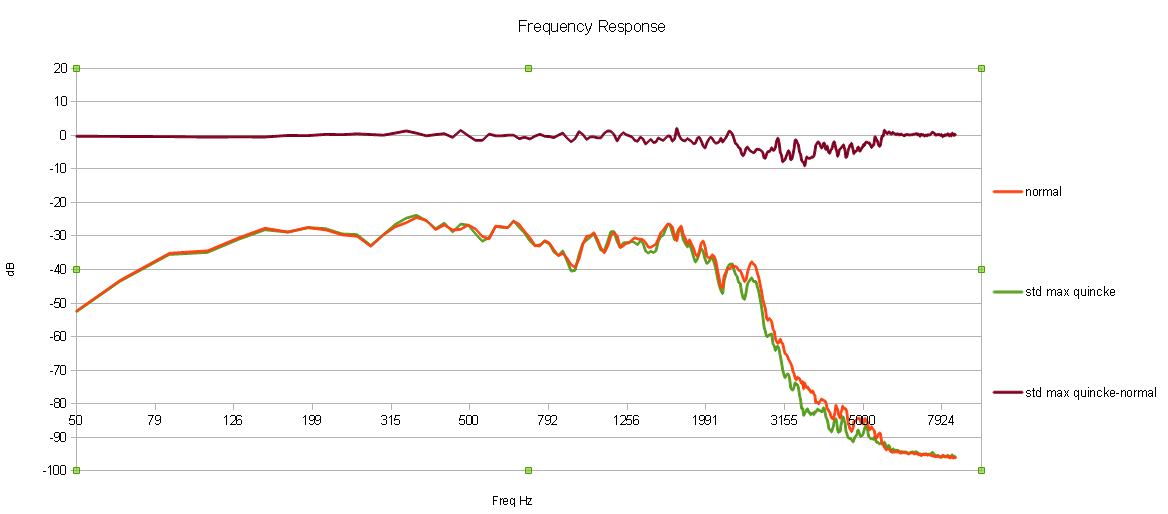

I should also point out that the shape of the notch filter is affected by the ratio of tube length to tube diameter. The notch will be sharper for longer tubes. This means that for the normal shorter EMG/Expert "tube", where the effect is at higher frequency, the loss is spread over a much wider frequency range and there is less signal reduction.
The attached spectrum shows the effect of the maximum tube length of a standard EMG/Expert Quincke tube. As you can see, there is minimal effect in the frequency range of actual signal on the record.

emgcr wrote: Thu Jan 26, 2023 7:17 am Here are the details of an Expert All Range tonearm complete with "Quincke tube".
So that is why E. M. Ginn used the old-fashioned style of tone-arm with a T-joint, instead of a smooth curve, between the swivelling section and the main arm! (emgcr's images show that the Quincke tube screws into the outer end of the crosspiece of the T.) I have always been puzzled by this, thinking that the abrupt right-angled joint must surely have a damaging effect on the sound, especially at lower frequencies.
