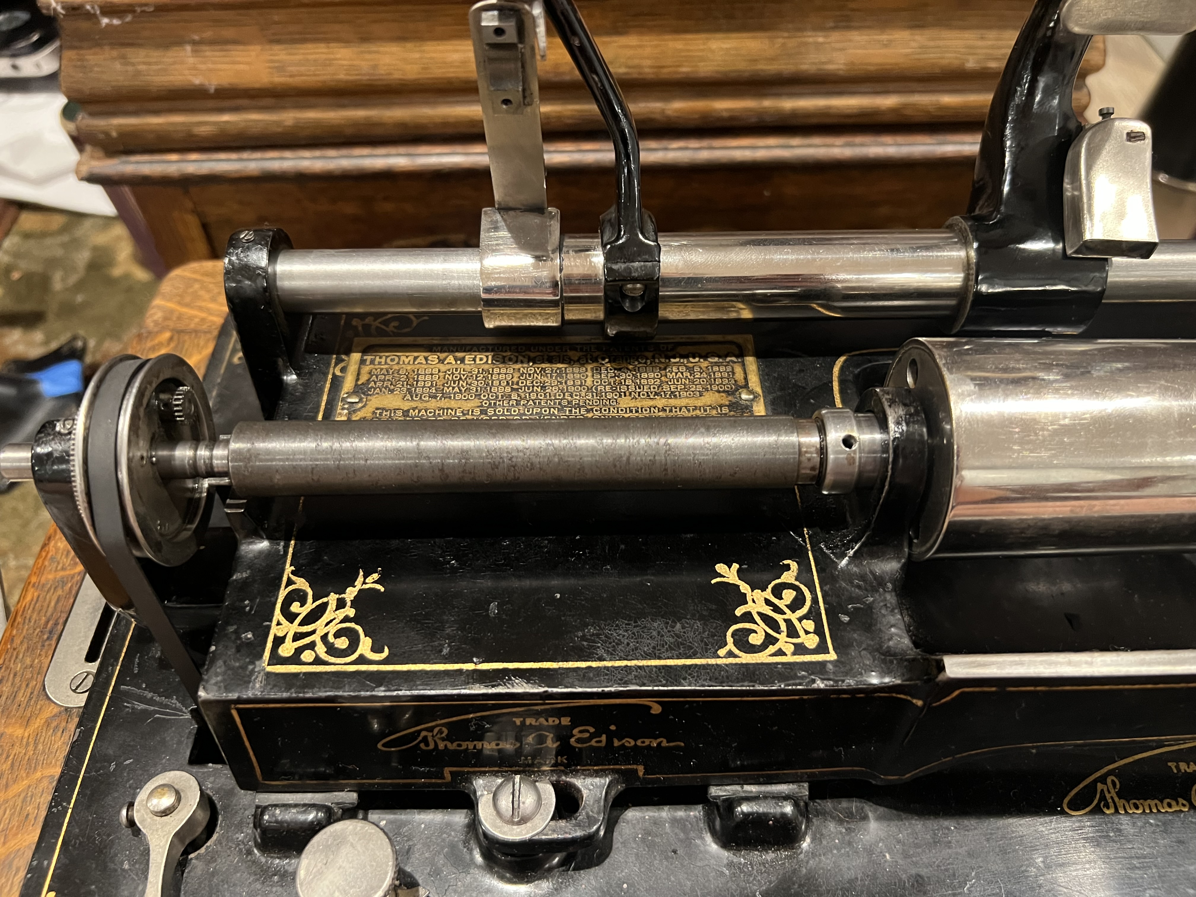

To add a little to Jerry's helpful comments and pictures, I'm sure that you realize that your model D repeater is comprised of quite a few more parts than are shown in the picture. Drilling and tapping the two holes in the top casting MUST be pretty precise to position the worm gear carriage lift/return assembly correctly (not shown in the picture).
Your 2/4 minute clutch assembly is the earlier style without the clutch shoulder to permit movement of the clutch. So, as Jerry also alluded to, the 2/4 minute switch that attaches to the carriage end boss and the feed screw should be present to enable moving the clutch. The planetary gear inside the pulley has to rotate easily in order for the 4 minute setting to operate correctly. Sometimes the gear is gummed up and sticky which leads to a halt when in 4 minute mode. Can you create and post a quick video of what's happening? It may be helpful to us to help you a little better. :)

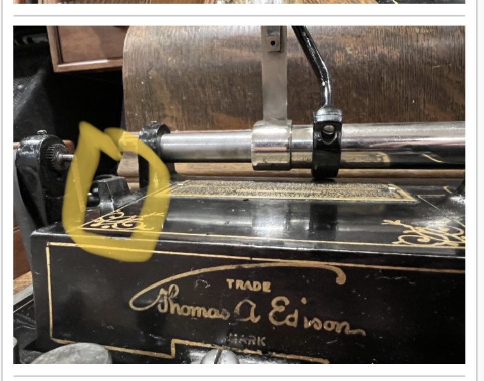

Thank you both for writing. I really appreciate your time and thoughts. I’m not sure what that little bump is in the plate. There is no paint over it. Was something cut when it was changed from two to a combination gearing? I thought maybe it was supporting the lead screw. Should I dremel it off? More pictures to come.

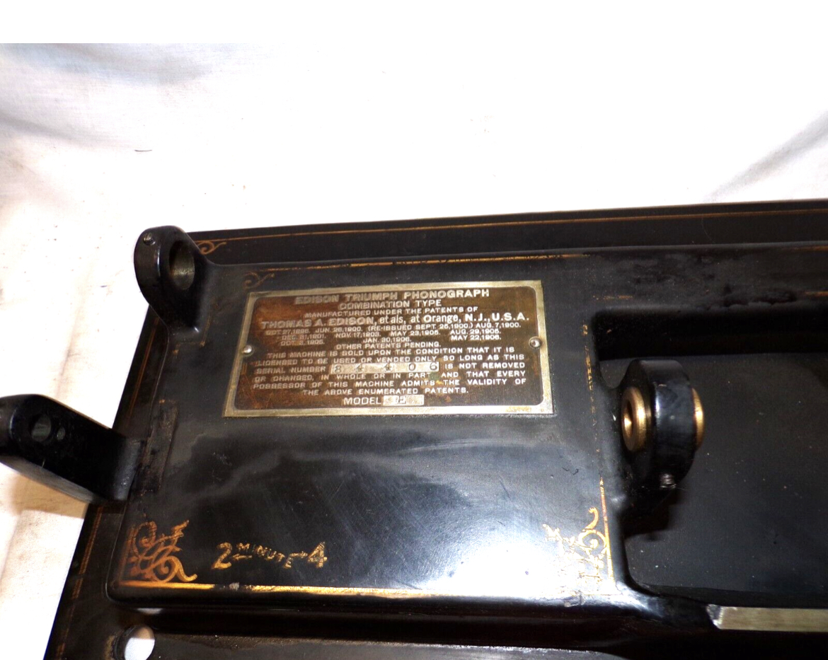

There’s a Triumph bed plate on ebay. I was looking around at other machines. This one has a similar protrusion if you look closely, but it appears that it’s been completely filed off.

Here’s the photo of the eBay listing.

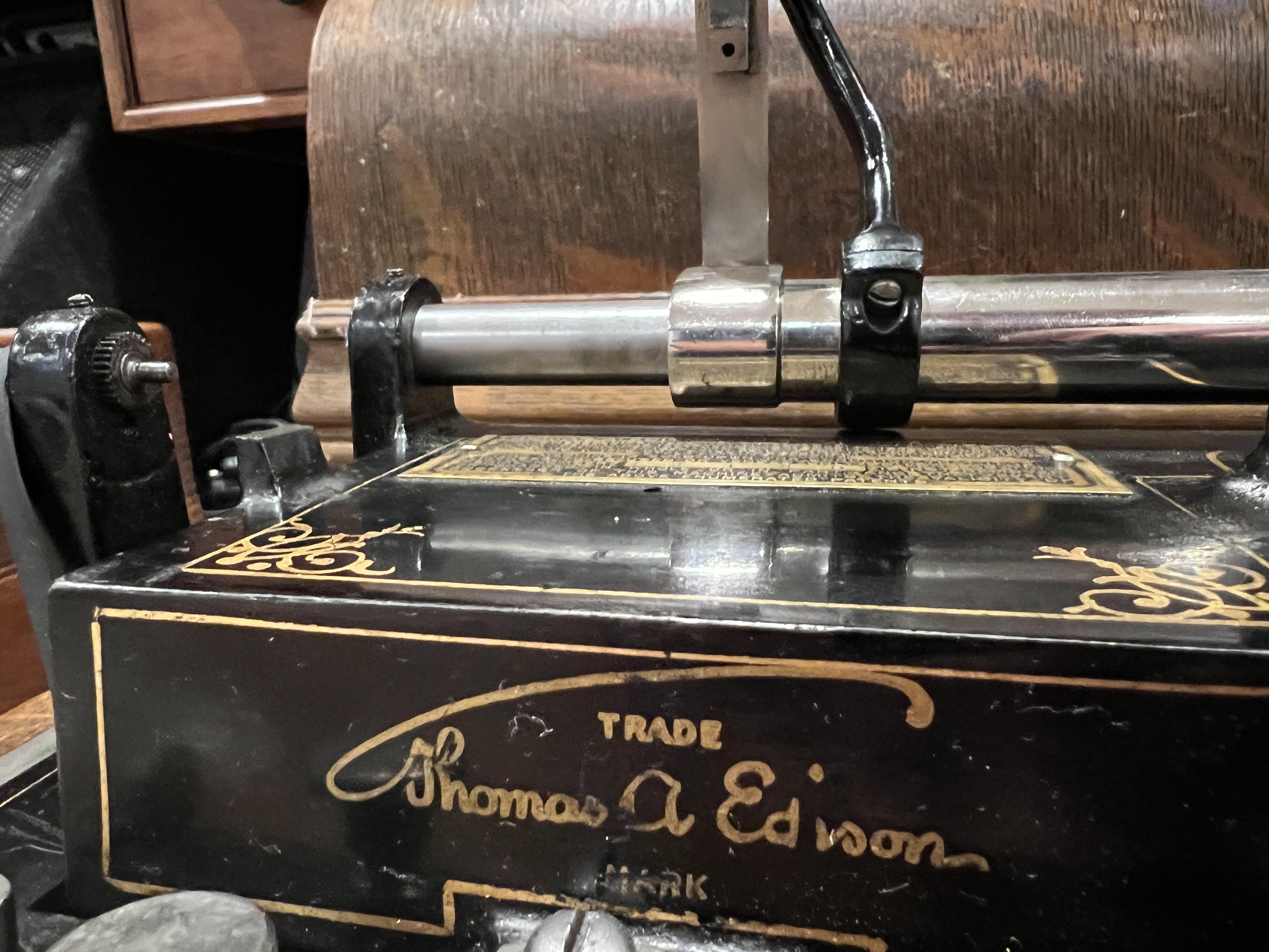

Posts: 6825
Re: New 2 4 minute Edison parts
Okay. Your additional pictures make it more clear. The lug looked odd due to the shadow of the 2/4 minute gear change hub.

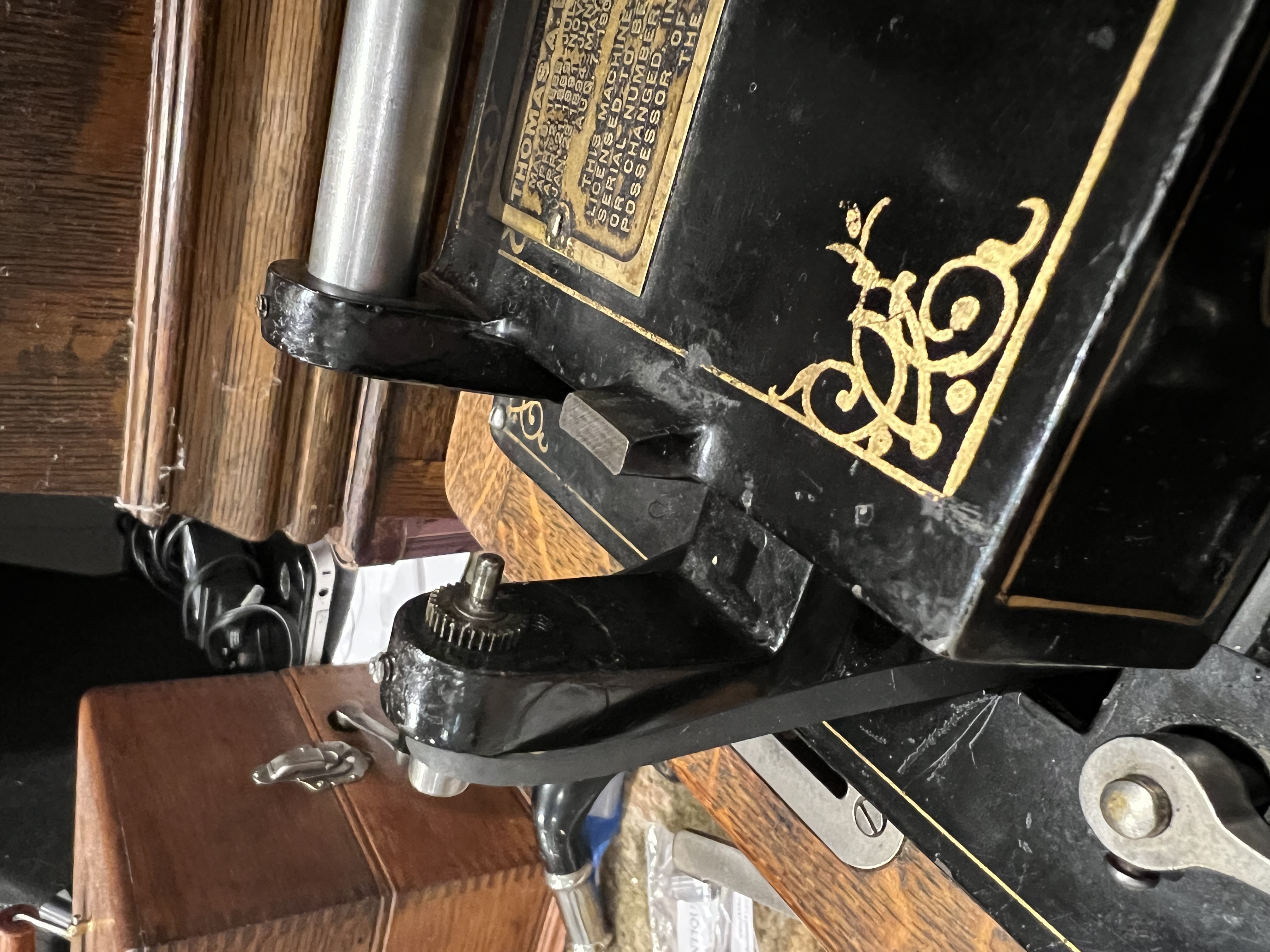

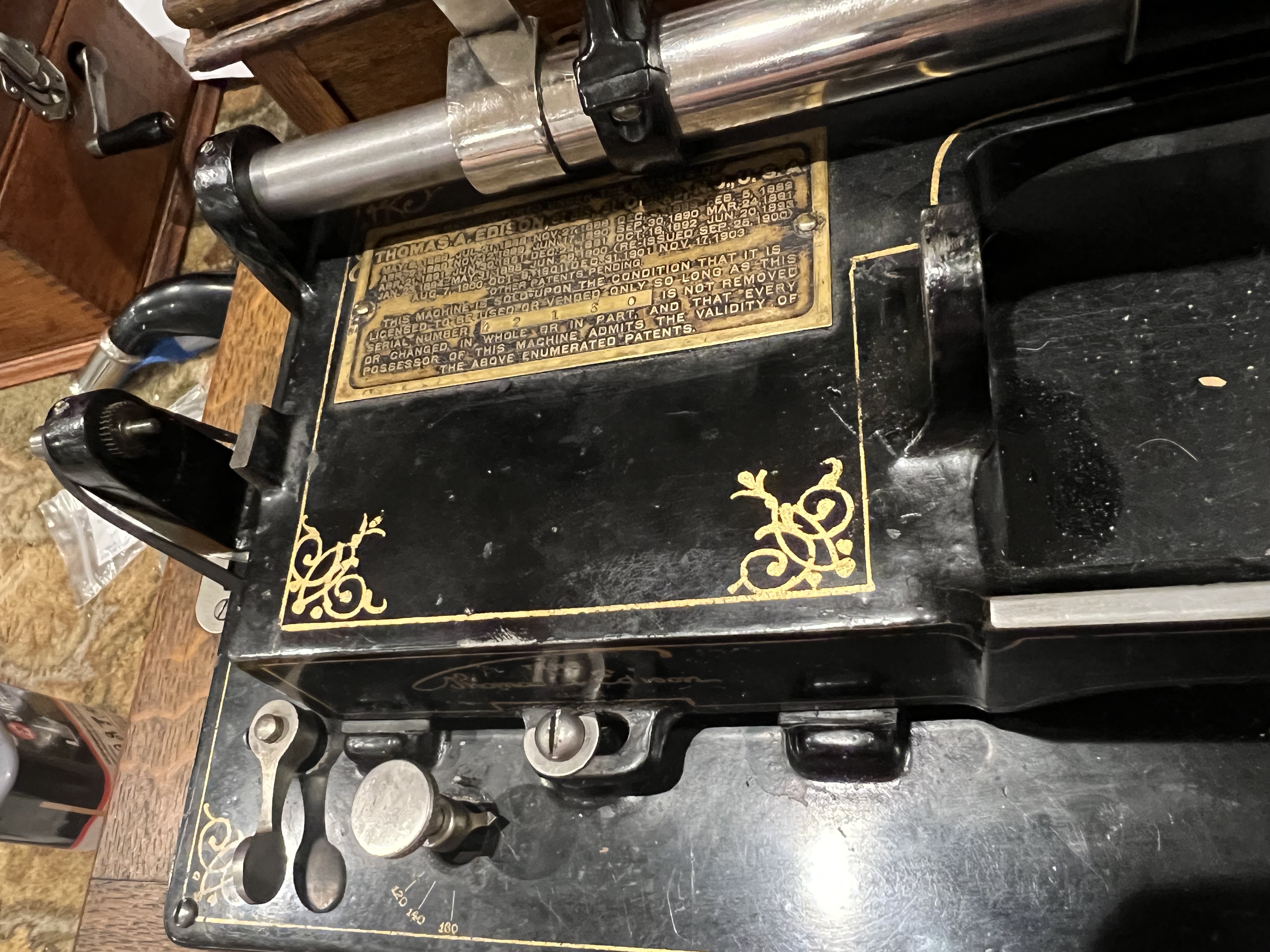

Thank you for the advice. One of the issues I think is contributing to the problem is till this protrusion from the bed plate. See the attached picture. It does get in the way of the clutch adjustments. My guess is that this piece was cut from the original bed plate and this is what is left. Am I ok to file this down flat? From the above eBay listing it looks like that’s what someone did long ago. I just don’t want to do something harmful ti the bed plate. Any thoughts?
Posts: 6825
KCW wrote: Wed Jun 07, 2023 8:40 am Am I ok to file this down flat? From the above eBay listing it looks like that’s what someone did long ago. I just don’t want to do something harmful to the bed plate. Any thoughts?
I would really encourage you to NOT alter it. It serves a purpose* when the Triumph Model A is used in its original form. Later examples may appear to have it "removed", but I'm certain it was at the factory and was done because it was no longer needed in later models. The photo you posted, showing a much shorter lug, is in fact a much later model than your "A", (a Model E, apparently). To remove or alter yours would do harm to it and to its value.
*It is intended to limit the sideways movement of the mandrel when you open the end gate. When the end gate is opened, it butts against the mandrel pulley and keeps the mandrel from drifting too far to the right. Without it, the mandrel shaft will fall off of the left end mandrel bearing. Again, this is the case when set up as a "factory" 2 minute Triumph "A". If it interferes with the function of your 2/4 minute set-up, it only proves Larry's point above, that a Triumph "A" needs a Triumph "A" conversion and yours is not likely a Model "A" conversion.
