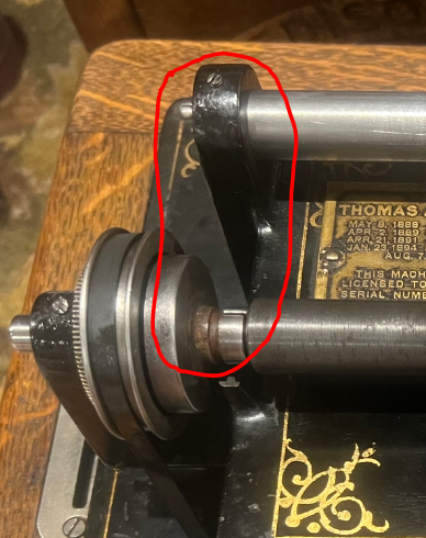

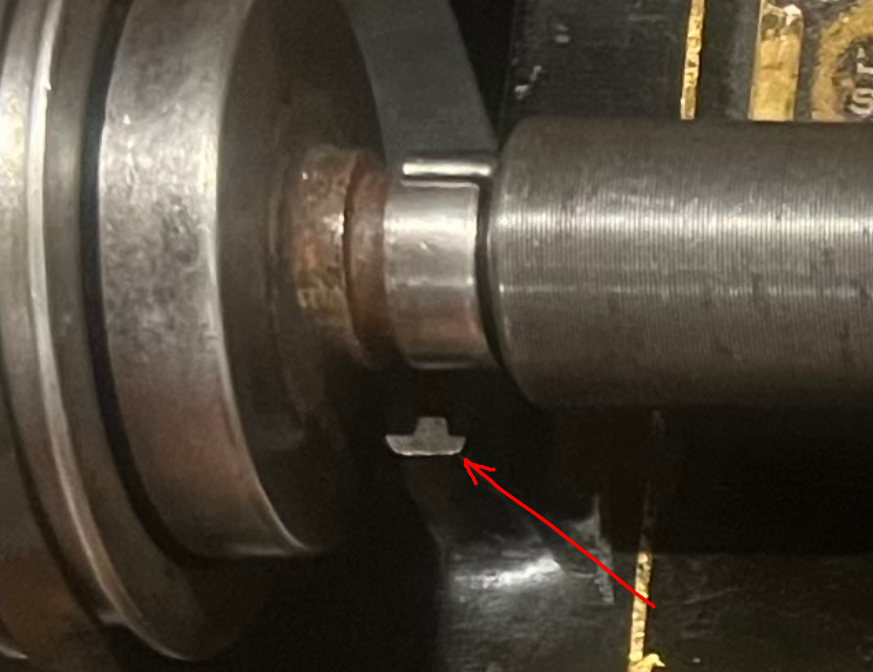

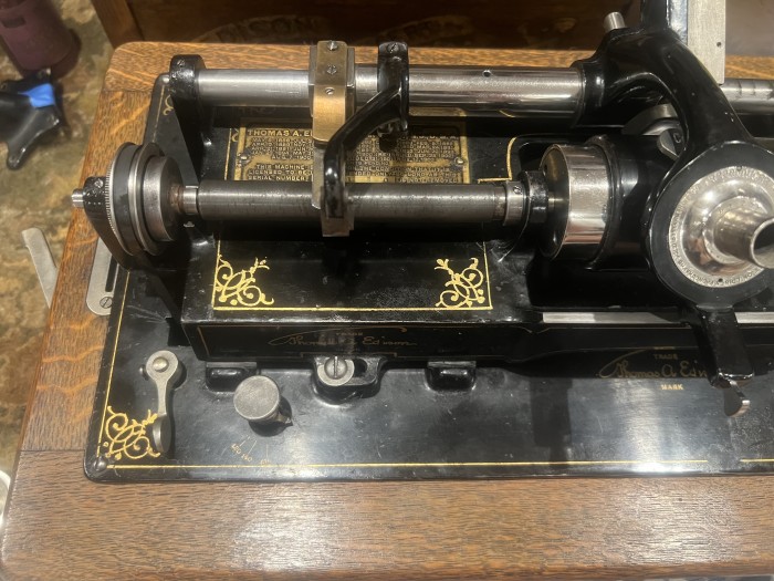

Here’s what I’ve got: I installed the 2-4 minute gearing . It’s got the repeater gear in the far left. I think everything is installed correctly. When I rotate the mandrel (by hand) in 2 everything rotated together. When I switch to four and rotate (by hand) it appears that the mandrel rotates correctly in 4 minute mode. The big problem now is that when I have it in two minute mode and spinning but not playing a cylinder it rotates fine. When I lower the carriage down the cylinder won’t play and everything stops. Furthermore, in four minute mode the mandrel won’t spin at all. I’ve taken it apart and our back together a dozen times with no luck. Everything is oiled too. Picture attached - this is tougher than I had expected!
- Posts: 6825
Re: New 2 4 minute Edison parts
Not sure where to begin here. Do you have the 2/4 minute shift lever that goes here...
I'm not sure what I'm seeing here. What is this lug(?) about? I looked at both of my Triumphs and neither one have anything like this. Is any of the leadscrew assembly hitting this?

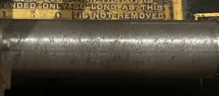

Your leadscrew appears to be very dented or pitted. I'm wondering if your ½ nut is able to ride on it without dragging down or skipping. How much pressure does your ½ nut have against the leadscrew? Is it pushing so hard that it drags the mandrel down?
