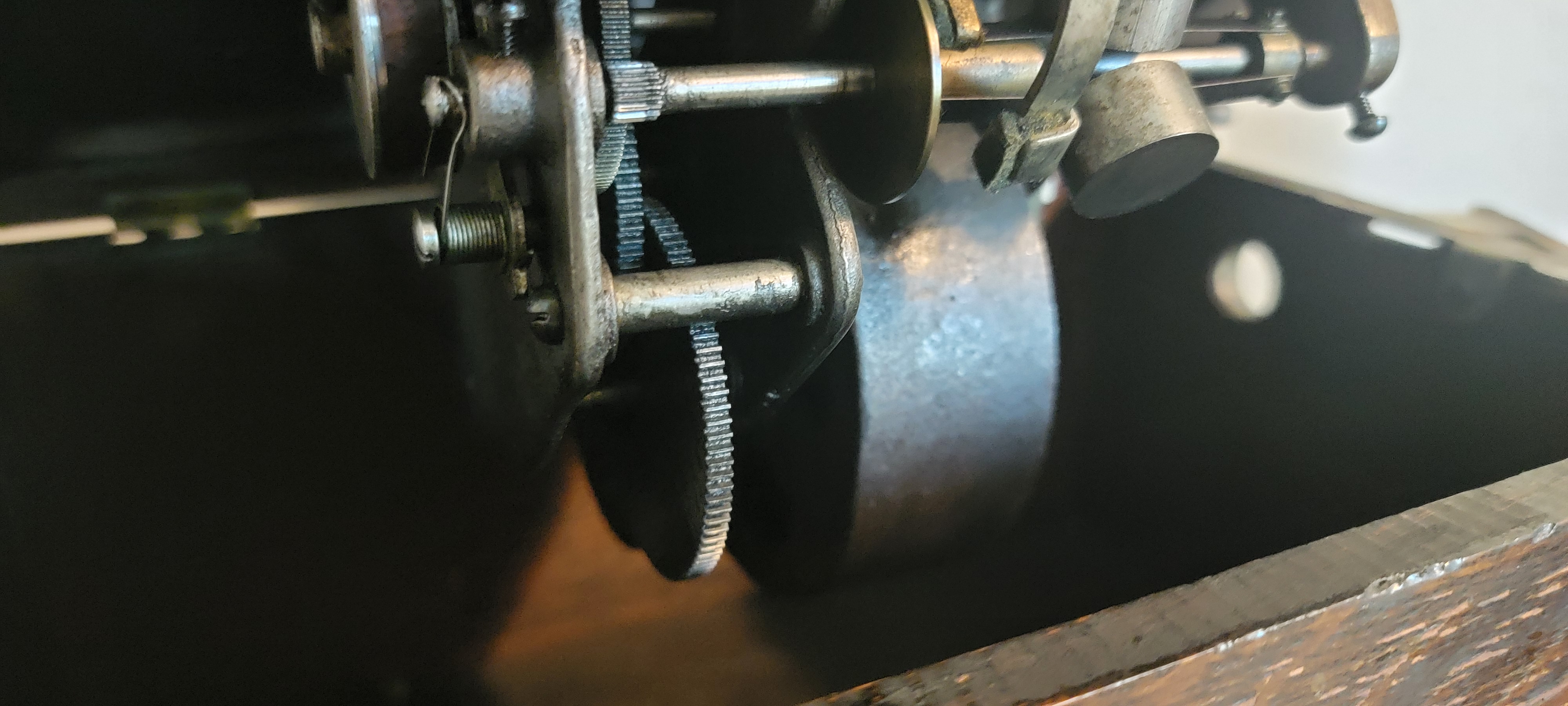

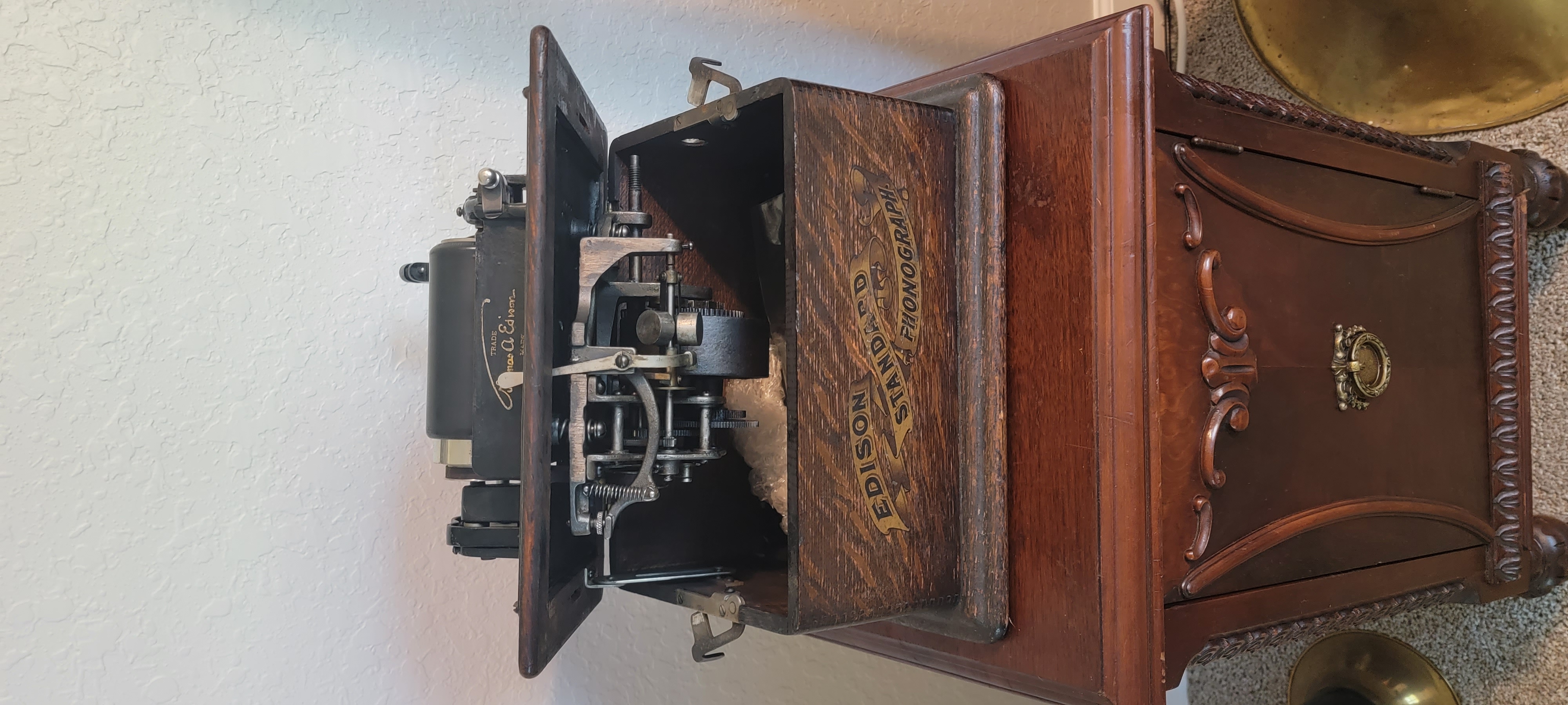

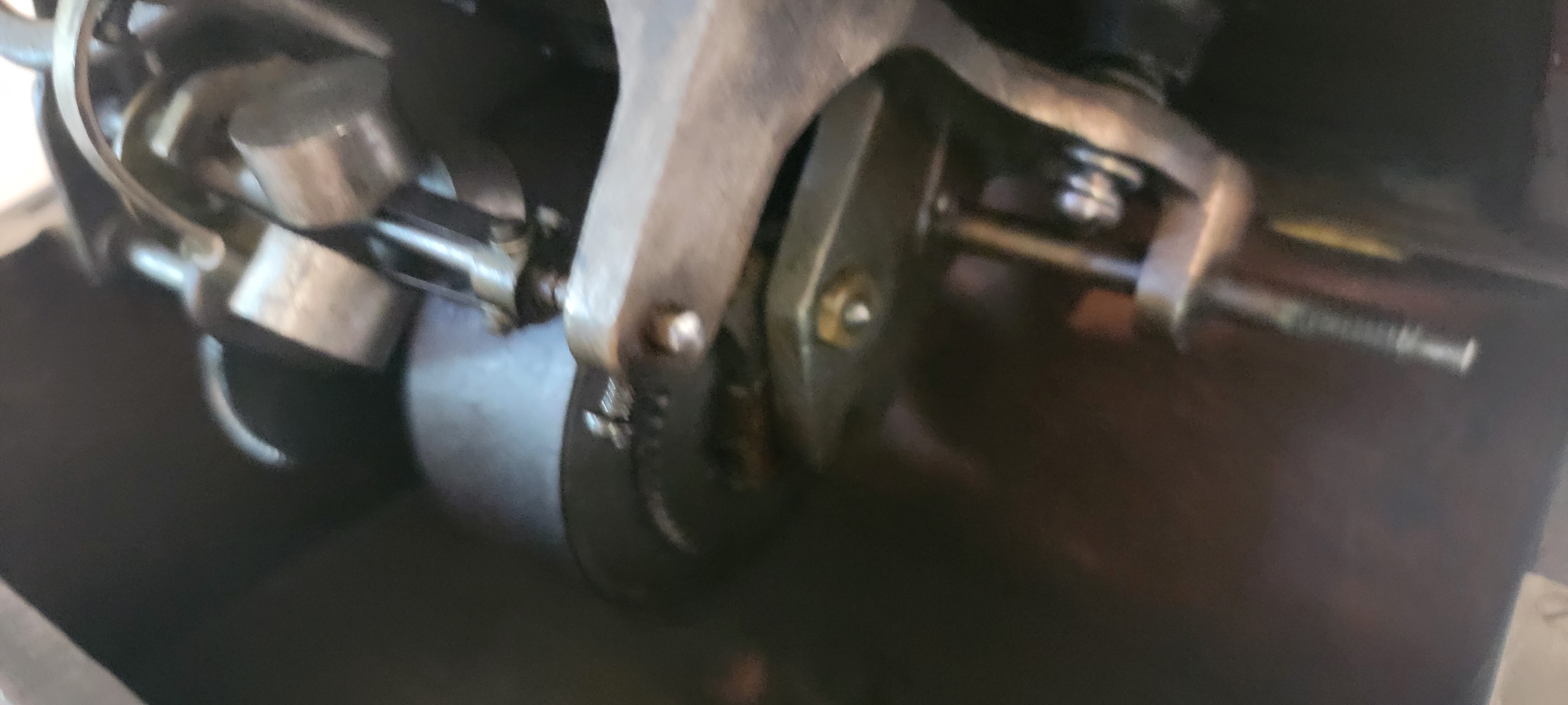

Well whaddya know, a crank was in the cabinet! Additional pics of the mechanism in case you see anything that needs attention. To me it all looks really clean and in good shape.
Thank you so much for all this help, I'm so excited!

You'll probably want to have the reproducer rebuilt, for best sound. Wyatt Markus is a great person to do that: he can replace the gaskets, check the stylus (or replace it if needed), at very reasonable rates.
- Bill
