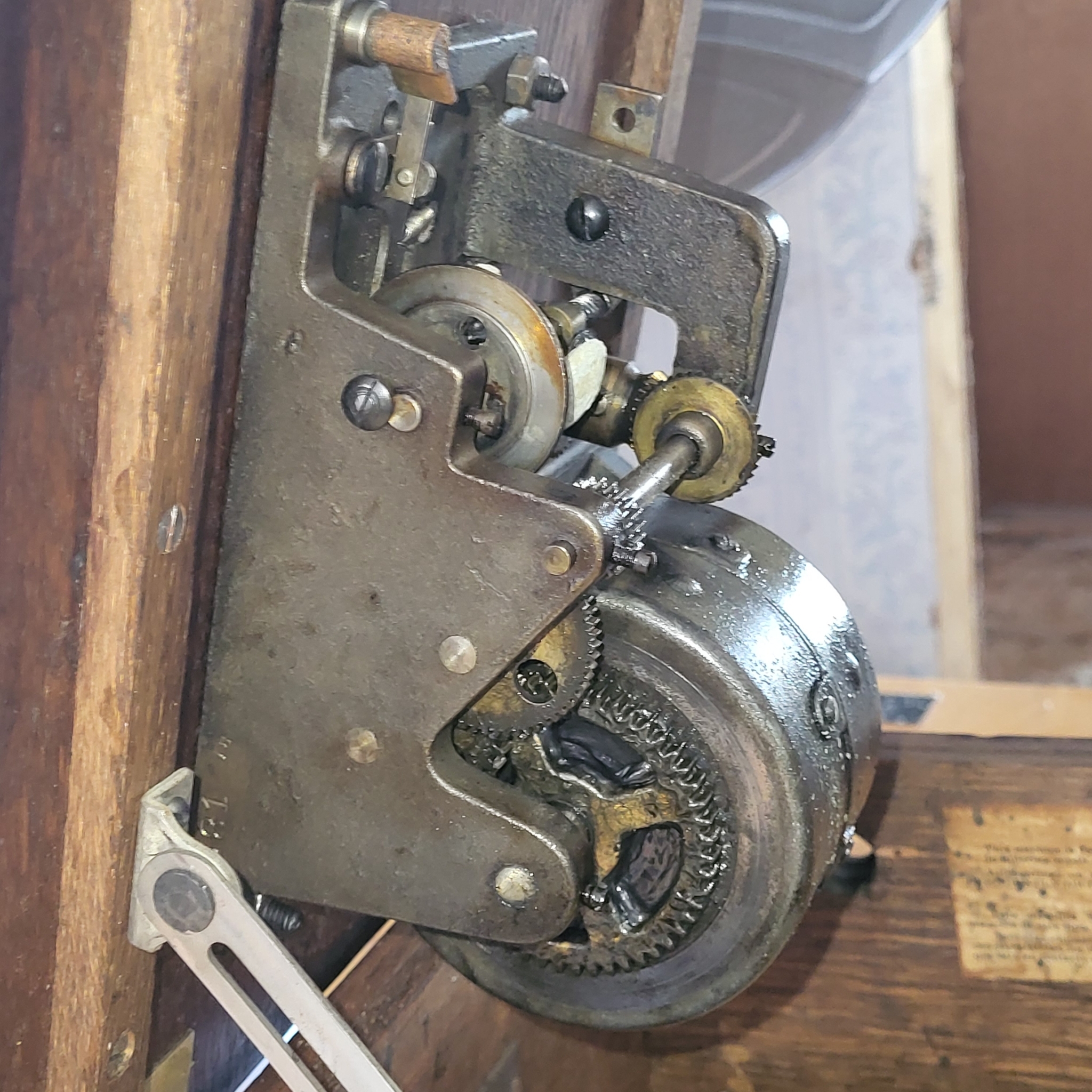

Here's the inside of the machine.JerryVan wrote: Sat Nov 04, 2023 9:38 amFirst, remove the crank by turning it backwards. Doing so should unscrew it from the motor. Then push in the little button just above the "Columbia" logo. You might have to push fairly hard. The lid should then hinge open. Send us a pic of what you find in there.alienj wrote: Sat Nov 04, 2023 3:17 am I can't get it to open. Are you supposed to push the little button (for lack of a better word) in? Pull it out? Turn it?

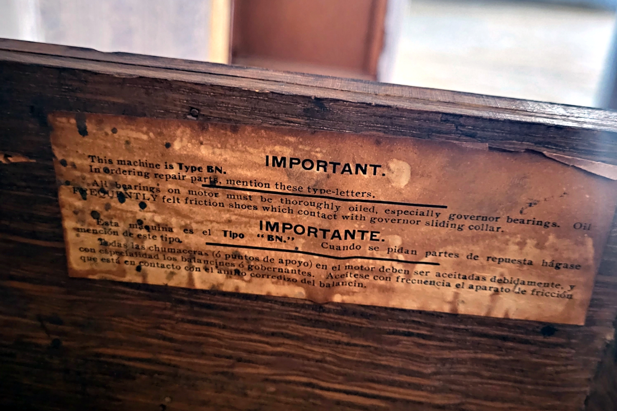

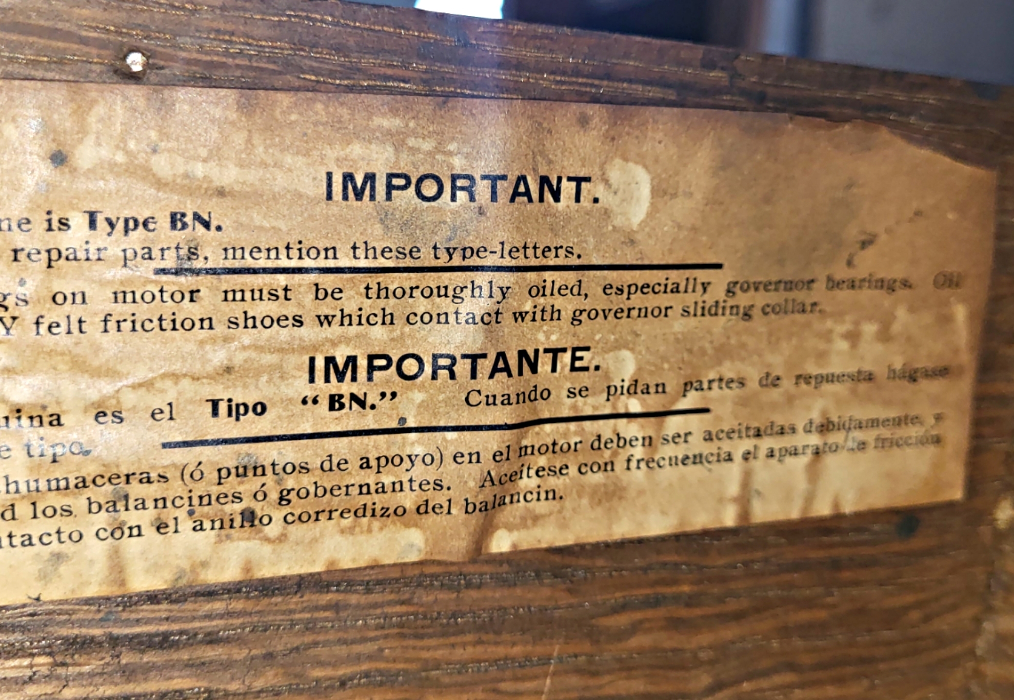

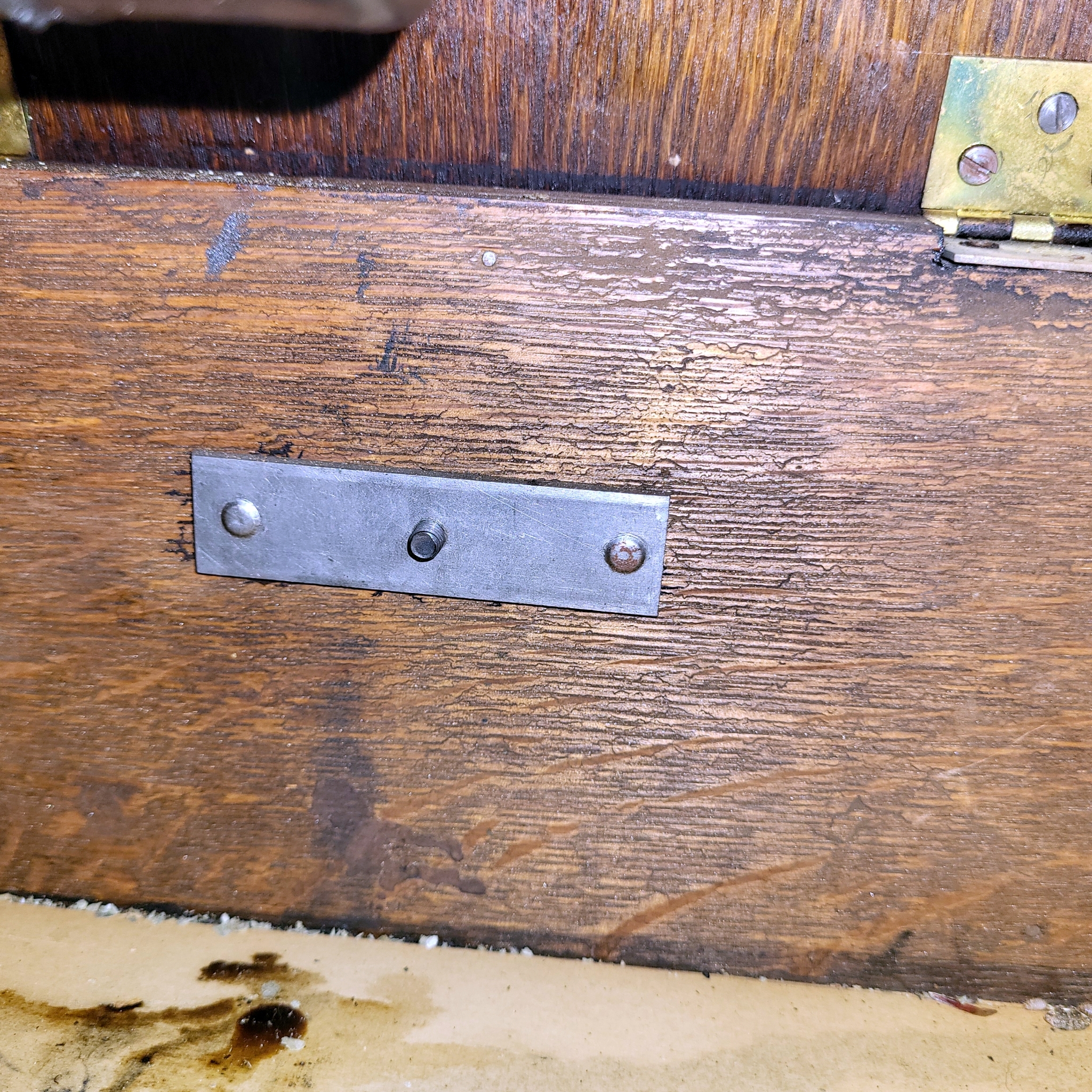

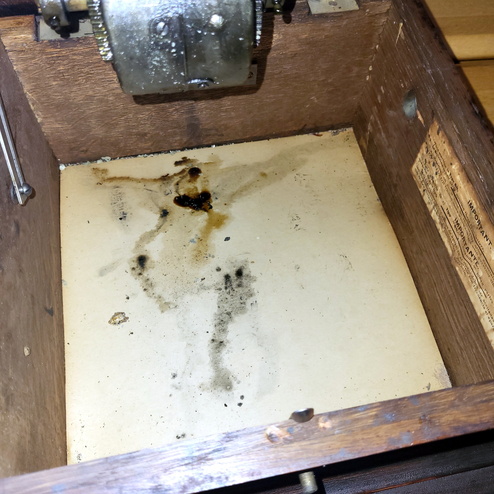

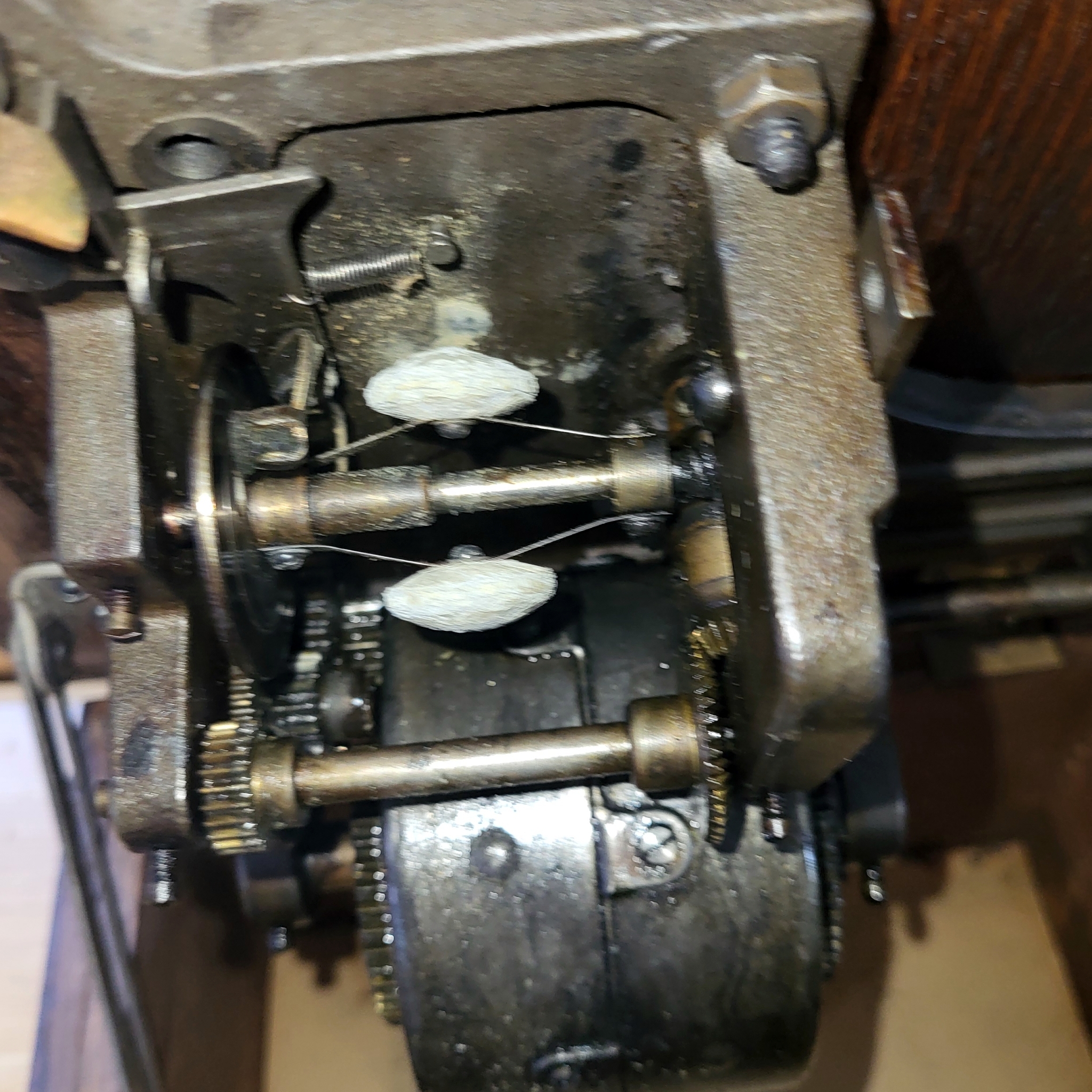

These are the pictures of inside my machine. Thanks for the instructions on how to open it, @Jerry Van.
